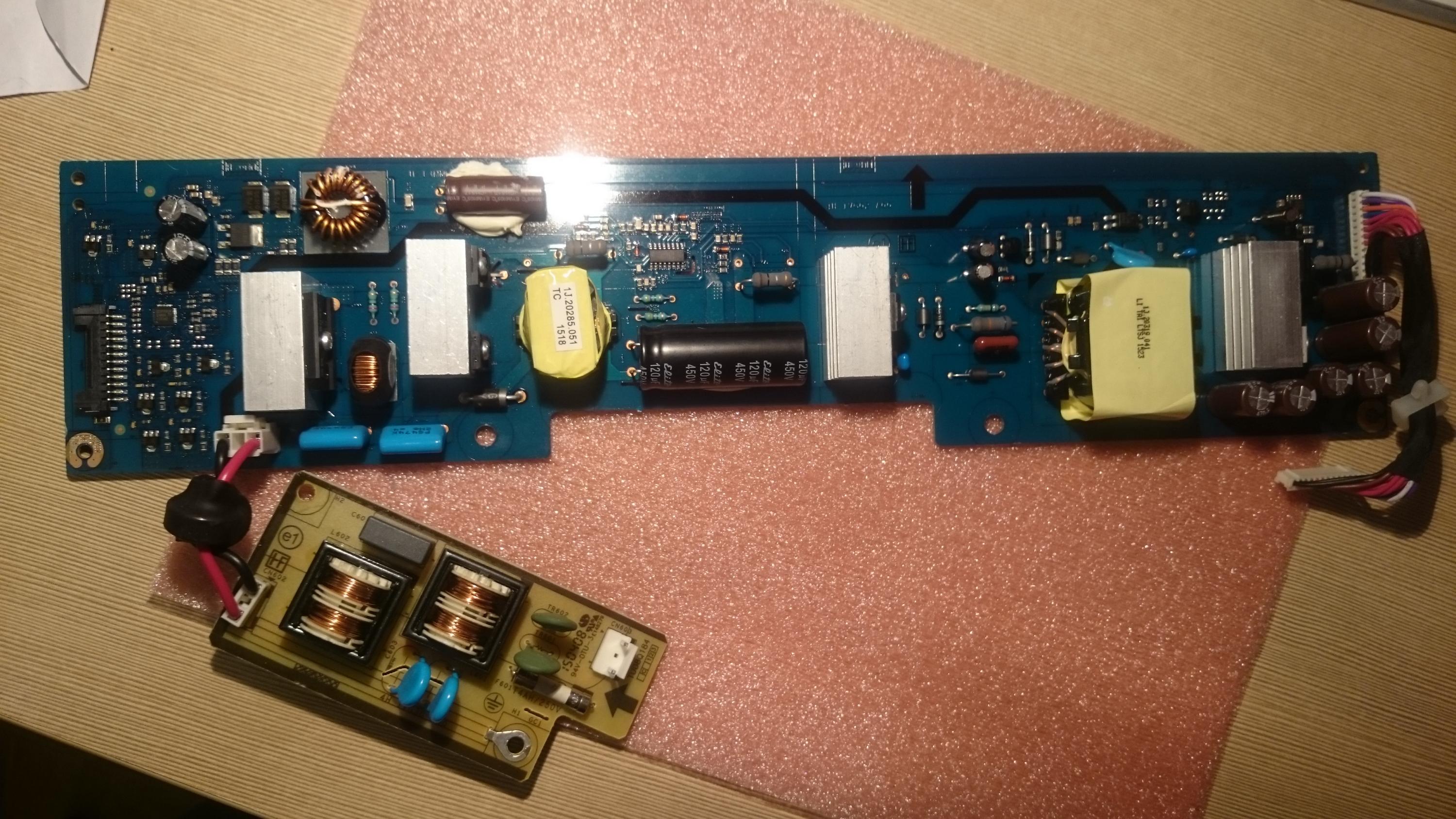

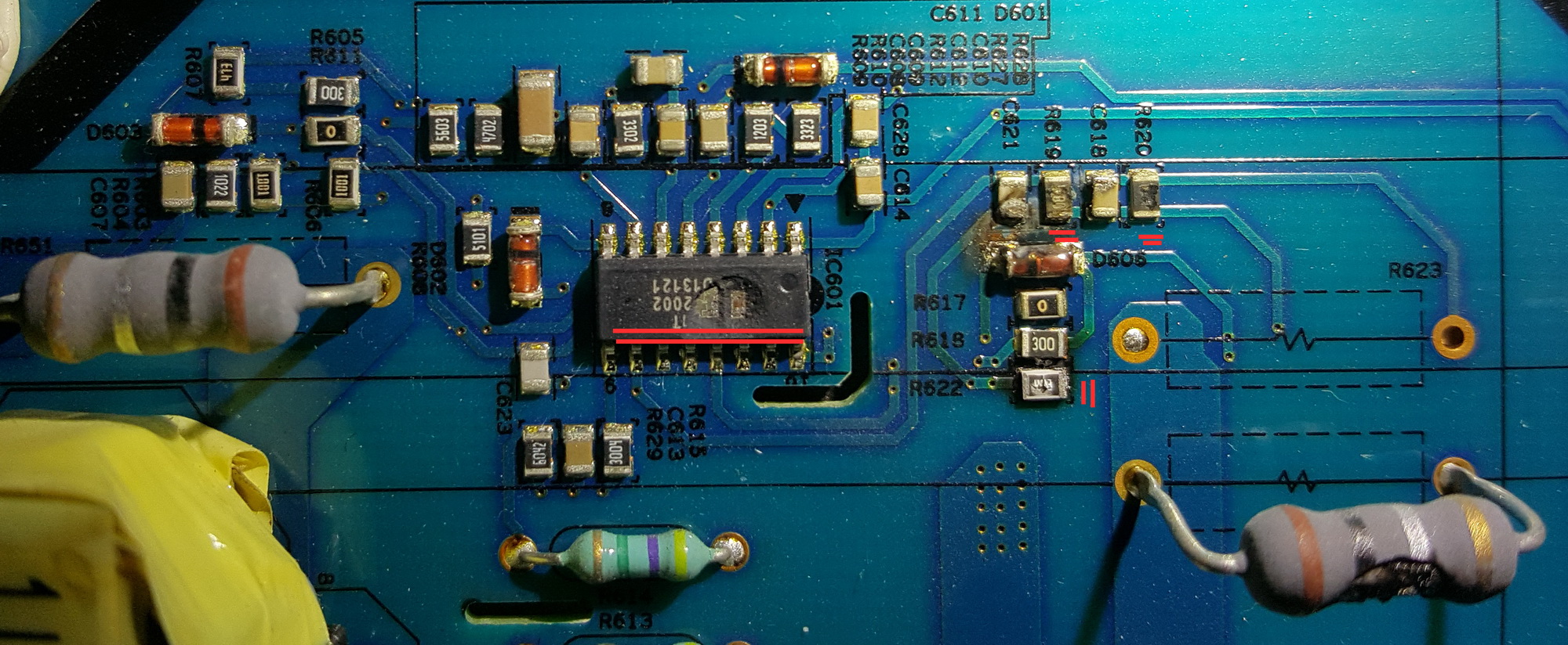

    Hello, if i can ask for some kind of help through your kindness i will be grateful, because i cannot afford at this moment new monitor .
    After short circuit in the power strip my Dell is not powering on .
    After i have opened him i 've noticed that none of the power supply board elements is damaged,

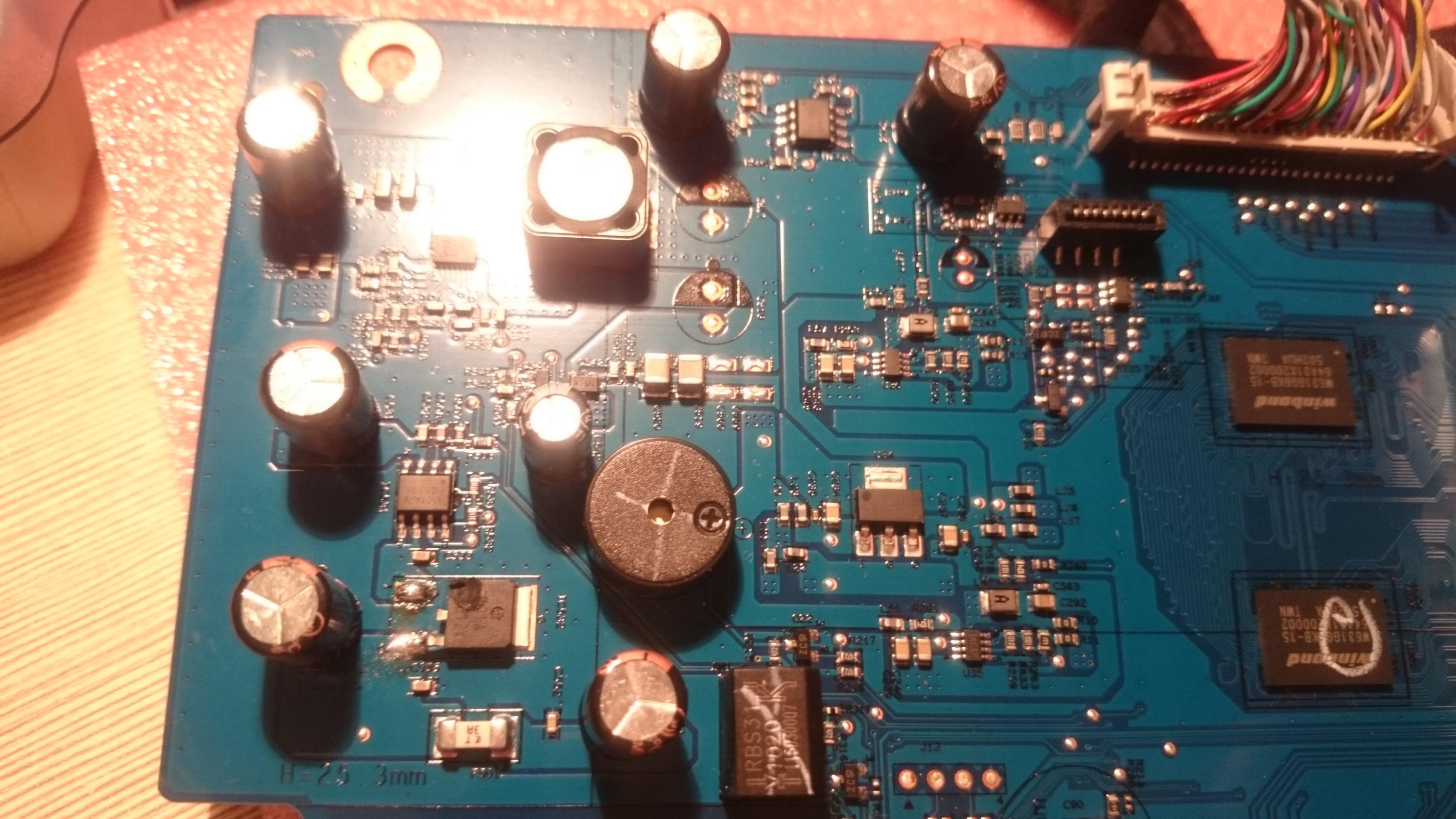

    After checking other boards i saw damaged element on "inverter" board ( picture : 3.jpg ).
    I got few questions about that.
    Can i measure inside boards without lcd panel connected ( this is most expensive part and it is probably good...i hope ) ?
    Do i have to replace that element before i will do any measurments with power cord connected ?
    ... I do not want to damage it more, that is why i am asking, but probably few more elements are damaged that does not have any visible damages.
    But strange is that every fuse is good...and that voltage came such a long way
    Can someone help me to figure out what that element is and how to make measurments ?

    Probably the gate driver is toast too. If you put a new FET on there, change that ic next to it too. What do you mean under not powering on? No backlight? Totally dead, etc?

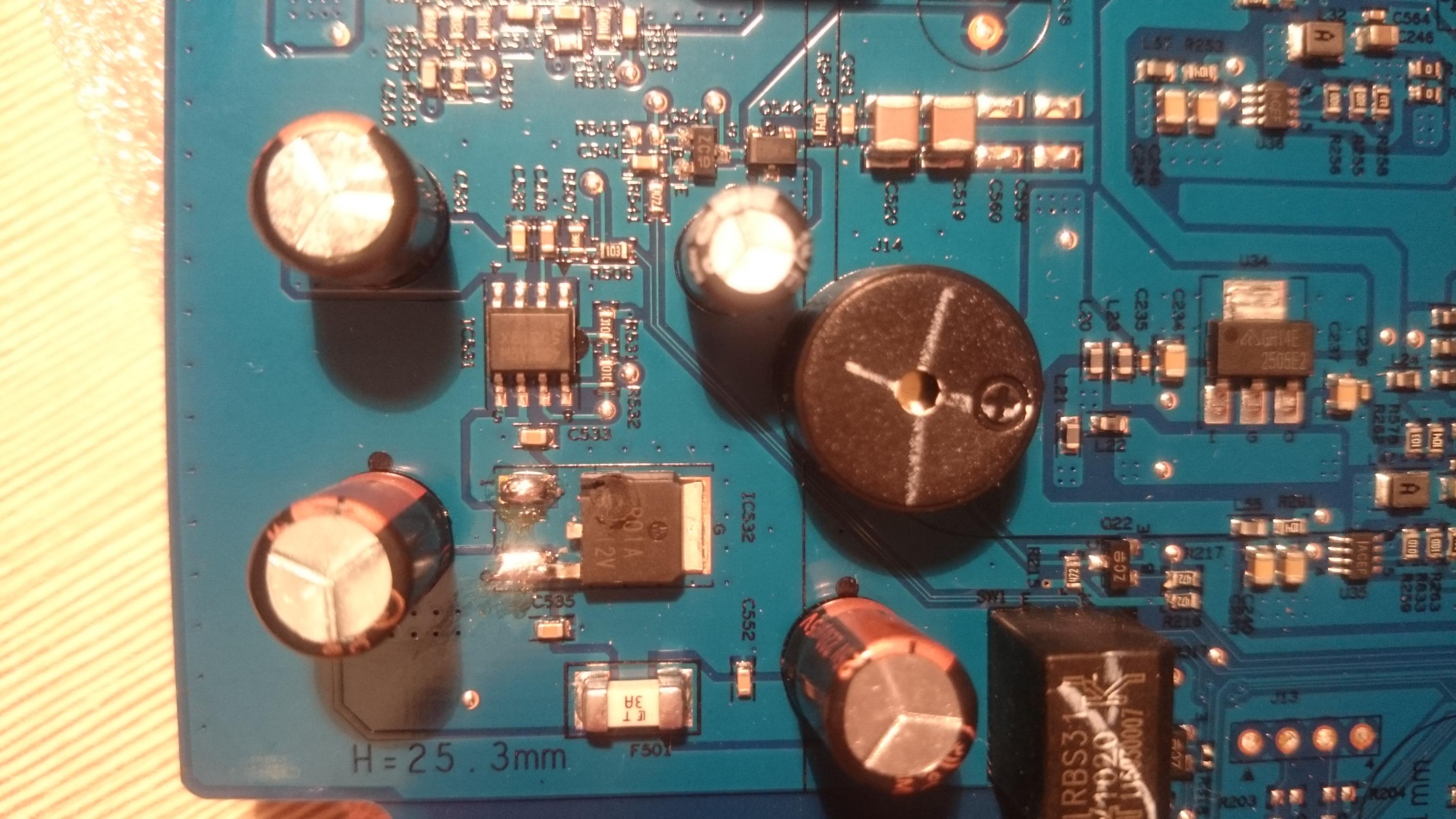

      You are talking about that 8 pin ic near that damaged part right...because that is what i was thinking also that needs to be replaced.
      But what that damaged part is ? The label is not readable because of explode
      Do You have any suggestions what it might be ?

        The item, that you looking for has a number:
        0282
        G9212V
        It is looks like linear VR or some MOSFET (hard to say).

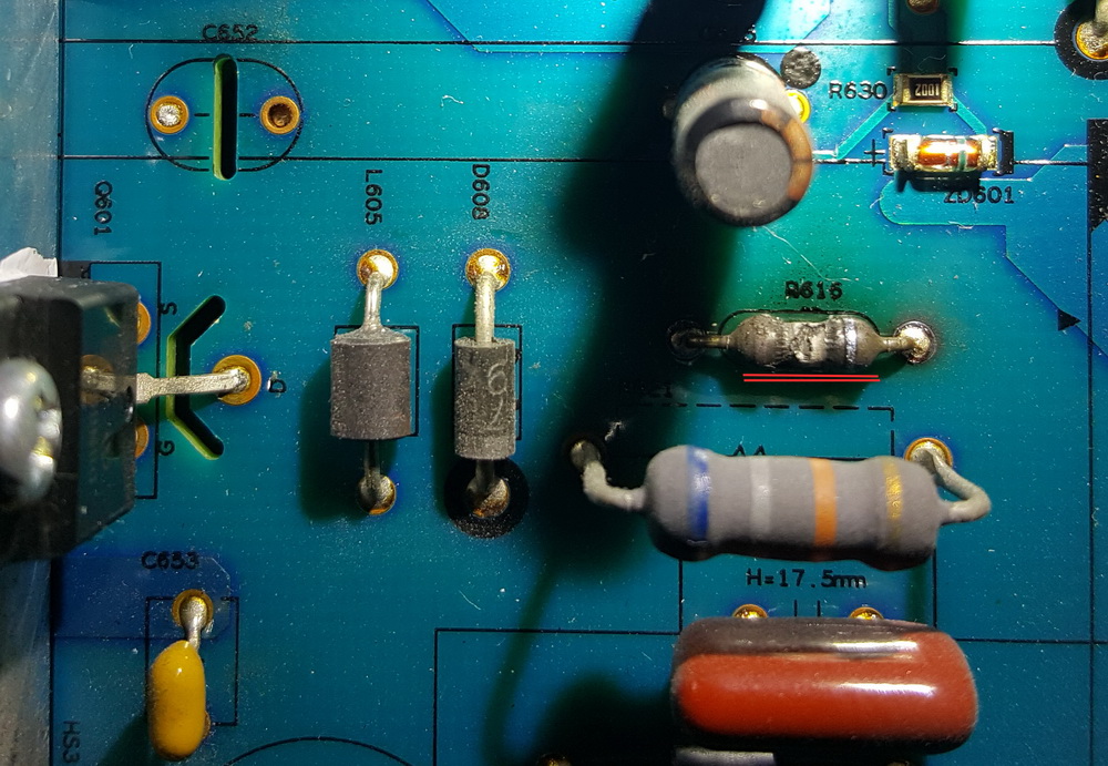

          Did you guys ever make any progress on this? im trying to identify R616 but i cant see the colored lines on it in your photo Madfreak

            The R616 from left to right: brown-black-orange-gold so 10k Ohms
            Good luck!

                G9212V is not a mosfet, but a voltage regulator from 13.xV from a diode to 12V to the connector to the logic board. I made a mistake by replacing it by a mosfet until I lost the 12V to the logic board.
                Actually i replaced it by a 7812 which did the job.
