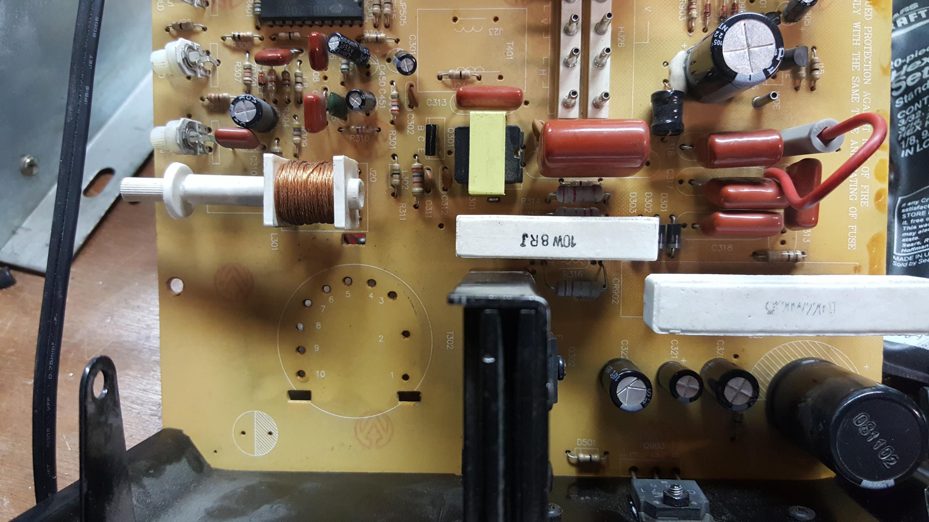

    Hi Forum,
    I can certainly use some help.

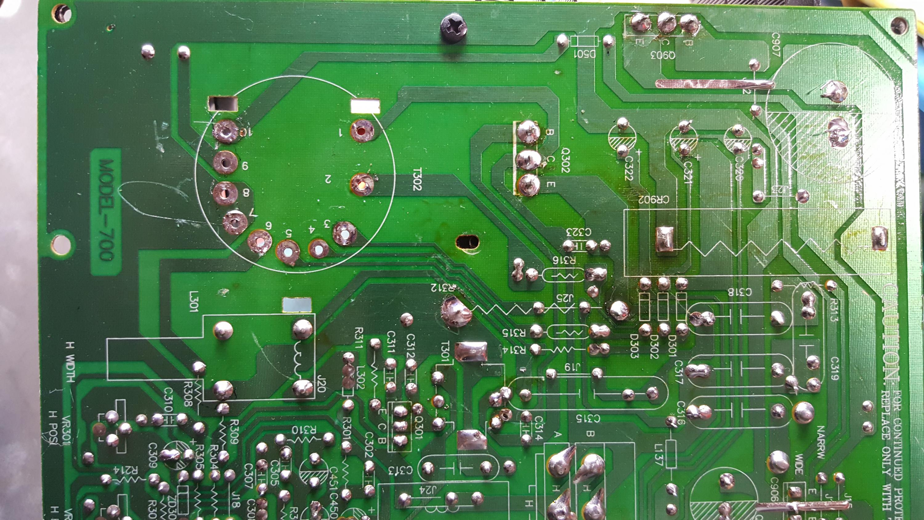

    I was kindly offered an upright arcade video game "Street Fighter" with a 19" color CRT monitor with a name brand "Yatta". I have reached out to many arcade parts houses and with the search in Google, I cannot find anyone that is familiar or have heard of this brand so I would like to reach out to all of you.
    First, I need to locate a set of schematics of the unit – Second I am in need to locate a Flyback Transformer BSC23-F1412A

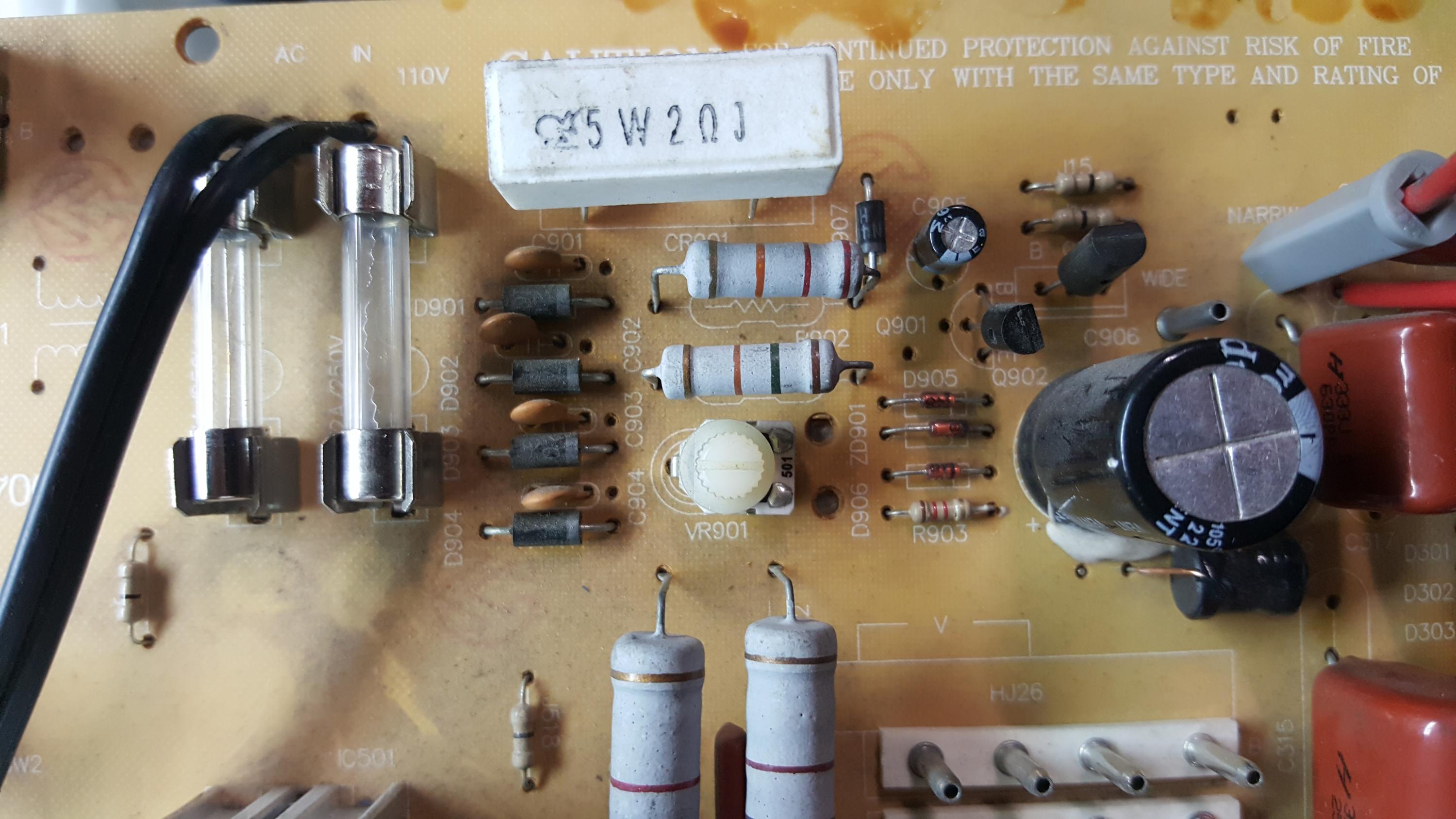

    I started to troubleshoot the monitor and found that the 2A fuse was open (Note: Someone added an external wire instead of the fuse across the terminals) – I started to do more troubleshooting and located the following bad parts;
    1) Shorted - Main NPN Power switching transistor for the flyback
    2) Open – Power Resistor 8 Ohms Attached to the Emitter leg (Current Limiter)
    3) Shorted - A series pass NPN Power transistor
    I went around thoroughly with my ohm meter and started to probe all the resistors, transistors, capacitors and diodes on the board to see if there are any other parts that have fatigued – Conclusion is no other parts to me seem to have died however if there is a “Walk and Wounded” part – that may be.
    I located and purchased all the parts (Except for the flyback) and replaced them all including the fuse – after applying 110VAC power I heard a faint arcing noise and the repeat of the 2A fuse open. I went straight to the resistor and it was still measuring 8 Ohms. I checked the 2 previously shorted transistors and found they were still measuring good. I suspect the flyback at this point. What is interesting is that the high voltage retained a charge in the CRT Picture tube since I discharged that path – I heard it. Perhaps an inner winding (High Voltage Breakdown) problem in the flyback.
    Here is where it gets tricky and this is where I turn to the community for help. – Hopefully I haven't lost anyone yet –
    The flyback is getting tougher to locate since the phasing out of CRT's – You still can locate flybacks from China and Ebay but they are getting scarce by the minute. The one particular part that I need I cannot locate – I am on a mission to substitute with an equivalent part – I am strictly challenging myself to see if this can be achieved – No other reason.
    The PC board backside doesn't help me much since it doesn't include silk screening with descriptions which means I went strictly on trace to trace from part to part to give me an approximate destination and output.
    I have attached pictures to help with my story and quest. Any help is greatly appreciated – If I have left something out please tell me so I may provide it.

    I would try and check what the B+ voltage is going to the horz. output transistor, If the B+ regulator circuit is bad it could be giving too much voltage to the horz. circuit. The voltage is usually around 120 volts, If the regulator is bad you could be getting 160 volts to that circuit and there would/could be arcing due to too much high voltage
    Any other names or numbers on the pc board? What are the numbers on the transistors you replaced?

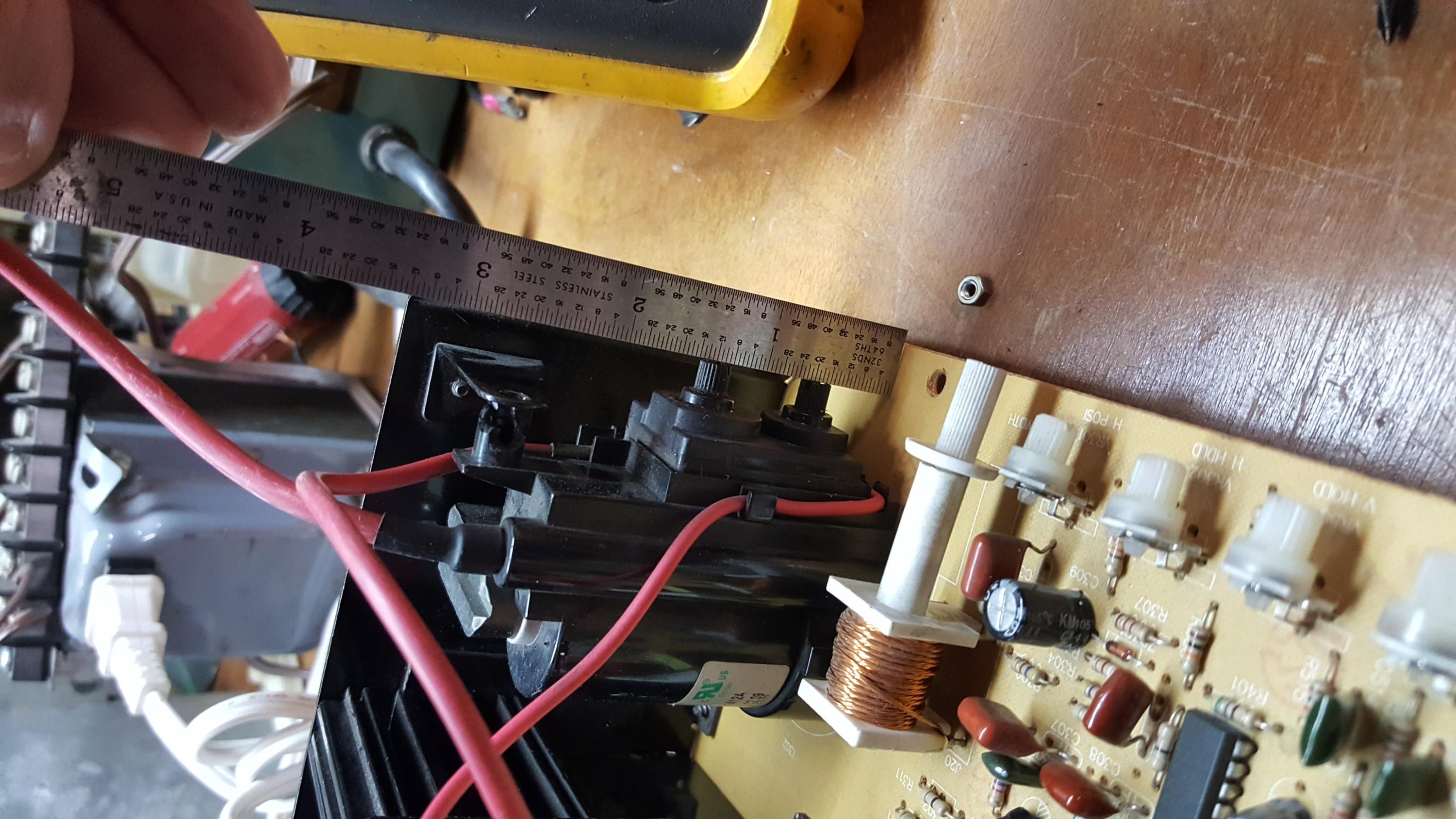

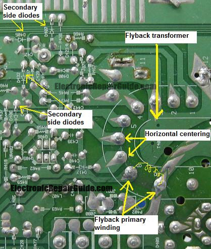

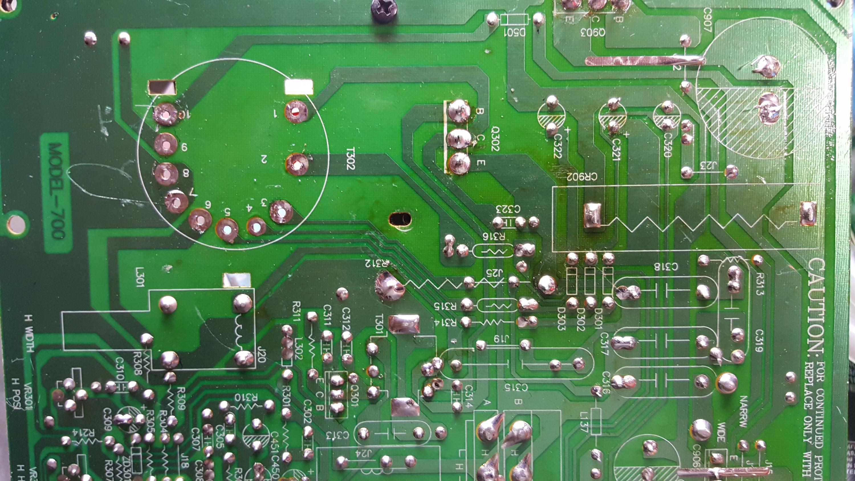

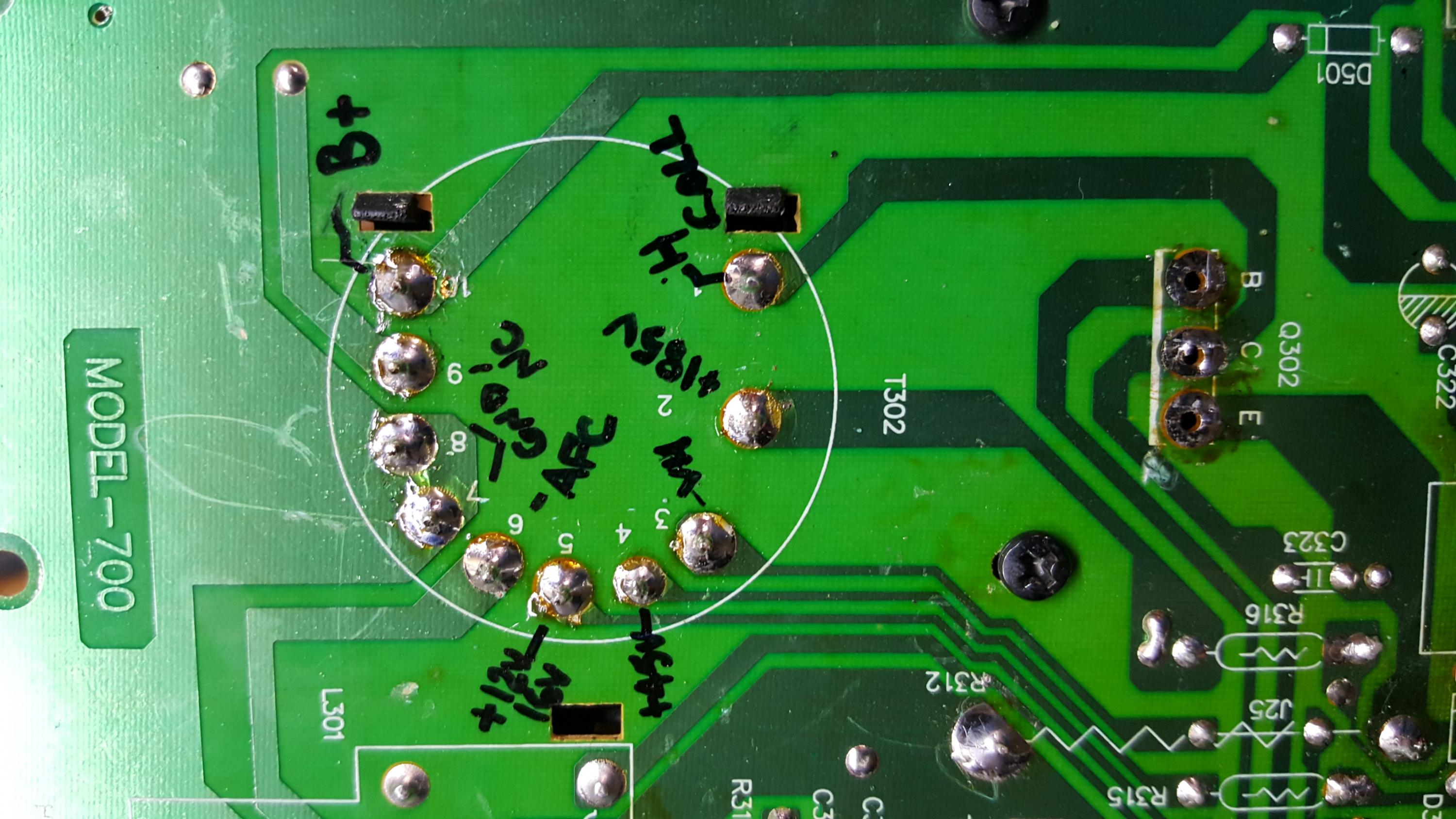

        Regarding the schematic I notice the flyback illustrates pin configuration to 12 - I only count 10 plus I don't see a pin 1 on the schematic. Pin 1 when I trace the back side it connects to the collector of the Main Switching Transistor. Pins 7 & 8 are tied together via a trace and it connects to the collector of the series pass transistor.
        I am drawing up a diagram of the flyback winding -- Just by a quick measurements with a DMM
        1-2-10 appear to be common winding
        3 -4- 5- 6- 8 appear to be common when measuring out of the circuit inner winding.. 7 has no inner connection to anything beside possibly being common to the secondary side.

          They usually count all the pins, even the missing ones, on your flyback pins 11 and 9 (or 2 and 4 depending on how they number it) are not there but if counted you would get 12
          In that schematic Q903 collector should be connected to ground (line missing in schematic)
          This looks like it may have been one of those China replacement chassis. not the original that was in the game
          The schematic came from arcade-museum.com

              Today I was studying the schematic especially the Power Stage Q903 and was scratching my head with how in the heck can the regulator operate with the 2 collectors going to no where. I am more familiar with series pass transistor circuits when the collector is ties to the unregulated side and the emitter is the output regulated side - I will study it more with the grounding of the collector.
              I am not quite following your flyback approach - Can you please elaborate a bit more?
              Also, How would you approach the checking of the B+ circuit when I need to power up the winding or were you thinking to test the Q903 Regulator circuit for a bad reference voltage to the flyback 120V, would this be in open circuit?

                Re: Need assistance -- Video Game CRT Color Monitor
                I had this in post #5
                In that schematic Q903 collector should be connected to ground (line missing in schematic) I checked another diagram that had it corrected
                You unsolder the B+ line going to the flyback transformer or remove the horz. output transistor and measure the voltage from the regulator. It should be regulated even without a load
                The flyback/horz. circuit does not need to operate for this. The regulator ciruit regulates the B+ which controls the amount of high voltage, too much B+ and there will be too much high voltage which could start arcing.

                  Regarding the Flyback - There are only 10 solder pins on the underside of the flyback and you had mentioned it can be a count to 12. I was just wondering how is that possible and how do they conventionally tailor those assignments? Looking at other transformer layouts I just see the typical clockwise counting pin to pin.
                  OK -- I can do that check with the B+ verification to see where its voltage currently regulates too.

                    I just remember some boards numbered them that way (ask me 20 years ago) I can't find an example so go with the way you were counting them, one and two being the primary winding as they like to keep a distance between those pins
                    sometimes they will number all the spots (holes) on the pc board but have one not used. that unused pin can be missing on the flyback, so if you counted the pins on the flyback itself and skipped over the missing pin the numbering would not match the board. Its no big deal, I just remember seeing it

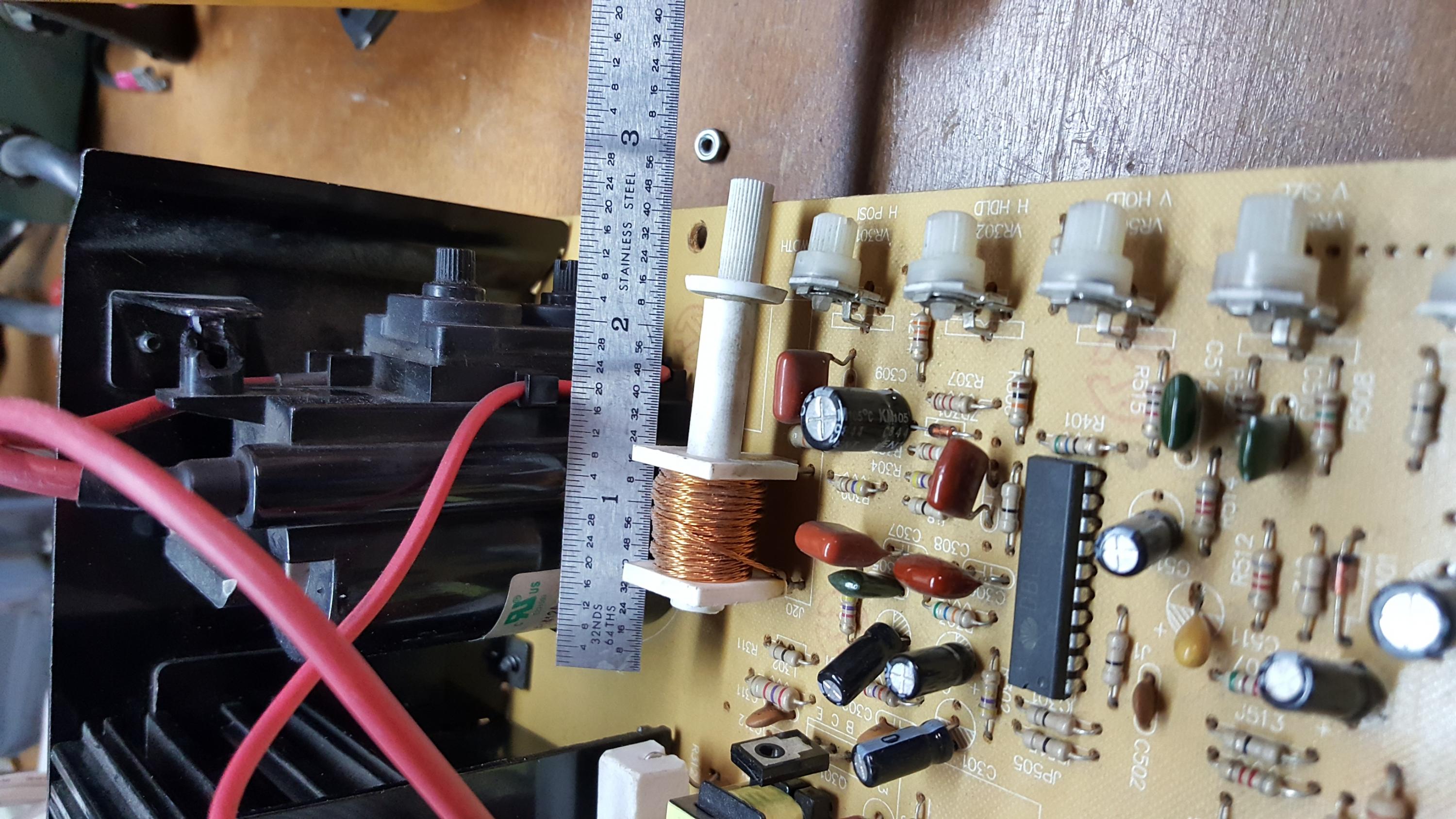

                        That will be my weekend test -- Currently I have the flyback removed so I can test it easily. I will add a light bulb as a load.
                        I uploaded a few photos of the top side and bottom side.

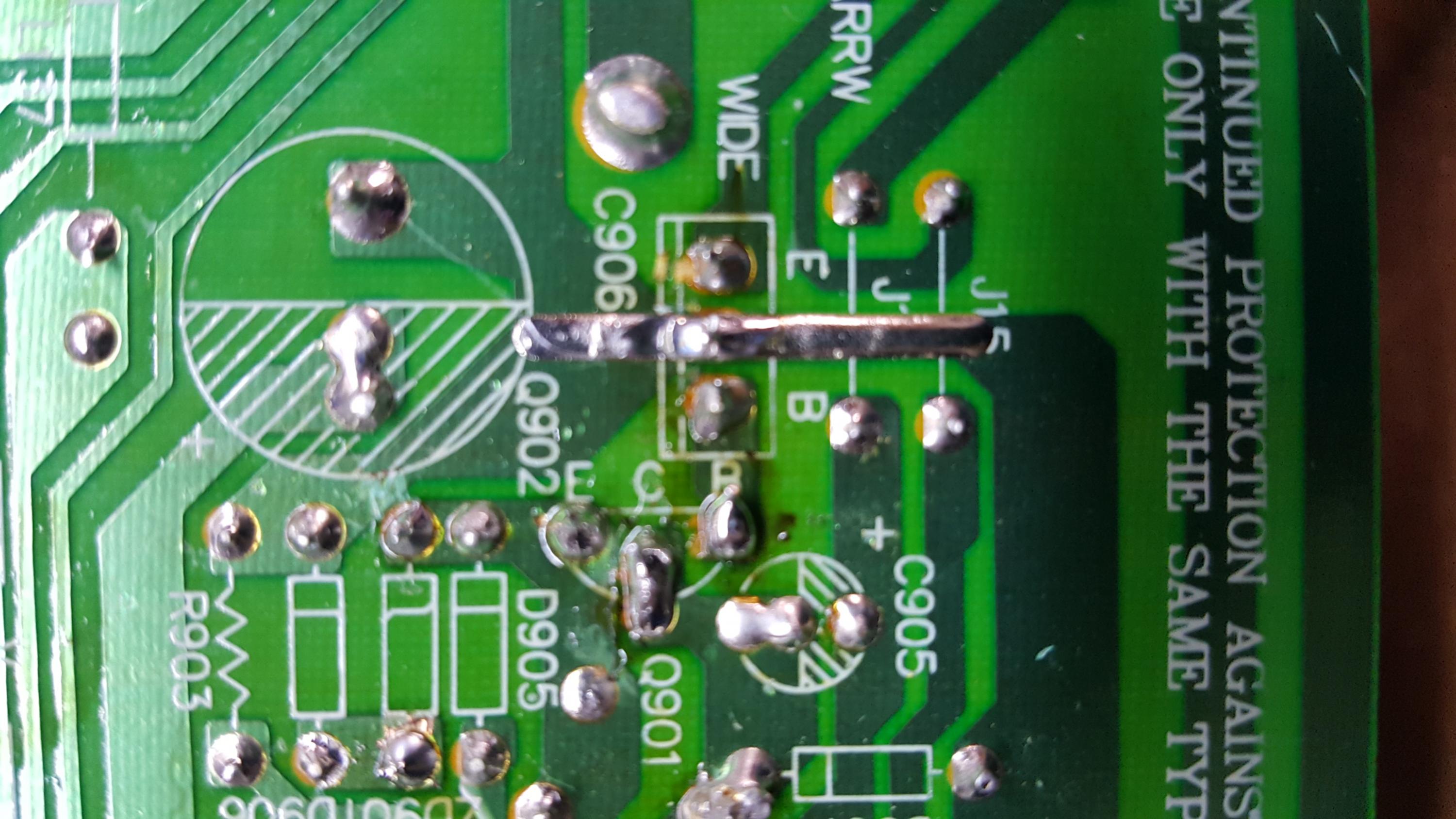

                                After replacing Q902 with an equivalent, I noticed the voltage was still in the upper range of 161V +/-3V at which it tells me it still was not regulating.
                                I visually checked the traces and noticed the silk screen on the bottom and top appear incorrect with the actual trace and reference to the schematic. The Base and Collector markings are reversed. After kludging the Q902 leads around to match the schematic and the traces, I powered up the Power Supply section only and the voltage was in the order of 154V with a 7W light bulb load. I replaced the 7W load with a 60W load (Light Bulb) and the voltage dropped to 140V. Now with turning the pot VR901 for fine tuning the 140V, the voltage was changing but not grossly. 140V vs 165V is a big difference when you stack up the turns ratio and output voltage on the High Voltage side.
                                But I am not sure what is the magic voltage number, can someone help with that ?
                                Also what other checks do i need to do before going for smoke test by including the Main Switching HV transistor? I am guessing the HV short on that side took out the regulator circuit. Do I need to go for a 100W bulb test and see what the voltage will yield? Are there scope waveforms to collect such as the HV driver circuit?
                                I tried to look everywhere for a flyback and I can't find the original piece - perhaps an equivalent - Does anyone know how I can obtain that?
                                remember -- When I power up for the initial short period, there is high voltage as i felt it and had to discharge it at the tube with a ground rod so it does attempt to power up but something takes out the Main Drive Transistor -- Q302.

                                  I did attempt to power up the board again after adjusting the B+ Voltage to 112V. I did place a 60W bulb as a load and swapped out the 60W to a 100W to be sure the load current difference would regulate the bus. And sure enough that delta was about 0.3V difference. I was impressed!
                                  Next I "placed" the Main switching HV Transistor and once again the High Voltage started up as I hear the static charge but shortly after the 2A Fuse cleared and this time the HV Transistor shorted and this time it took out the Regulation Transistor - Q903.
                                  I am suspecting the Flyback now as being the problem. What do you think fellas? Any ideas or suggestions? I am at a road block here..

                                    Here are some pictures of the bottom board with my figures to the flyback pinouts along with other back side and top side pictures--
                                    Any support is appreciated.
