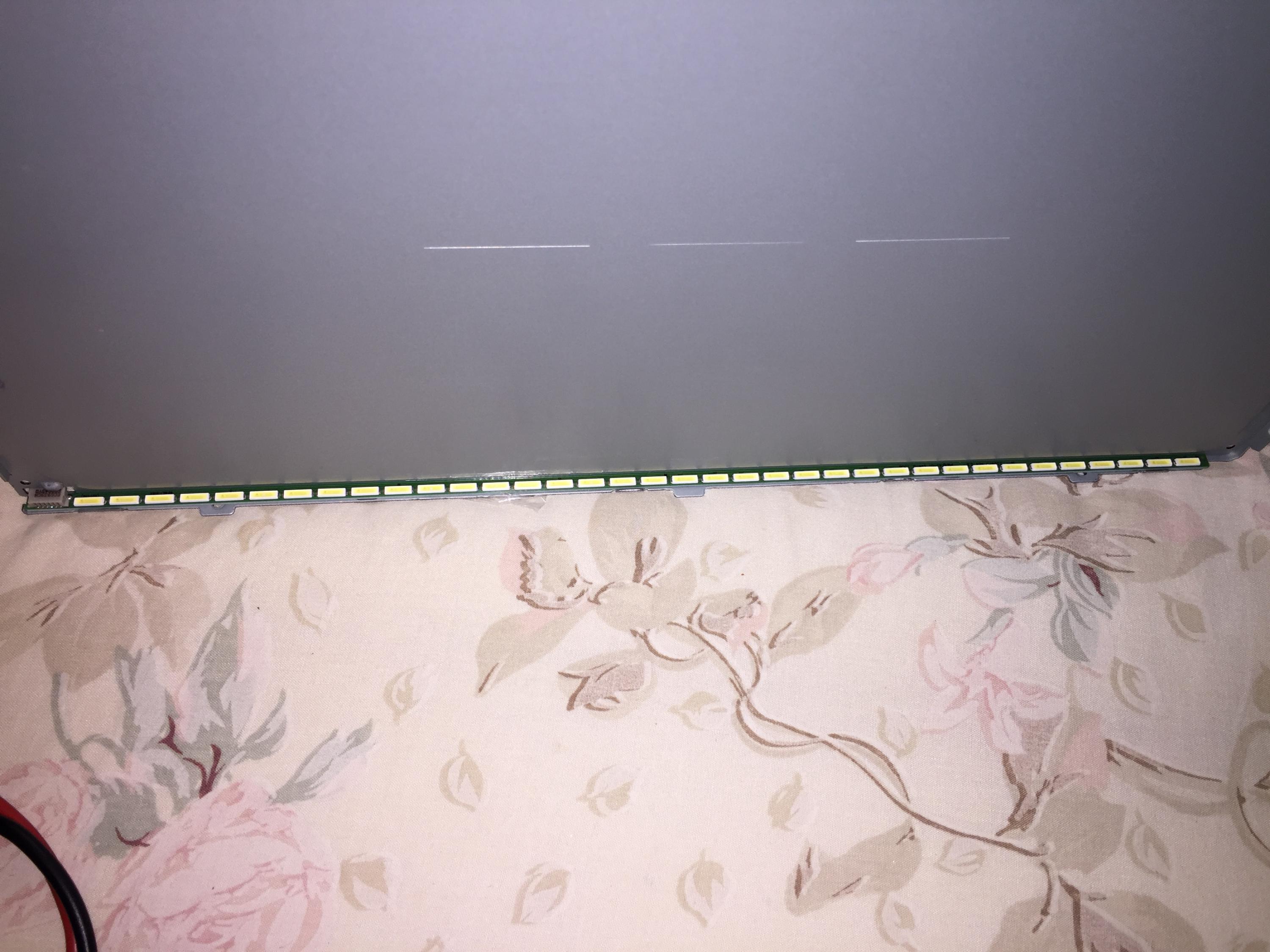

    I need help with this one.
    When i turn it on it has no backlight, but with source connected image is visible with help of flashlight .
    So, 19V going to the mainboard are present, on/off pin is going from 0V to 2.8V when power button is pressed. DIM pin is 3.2V all the time.

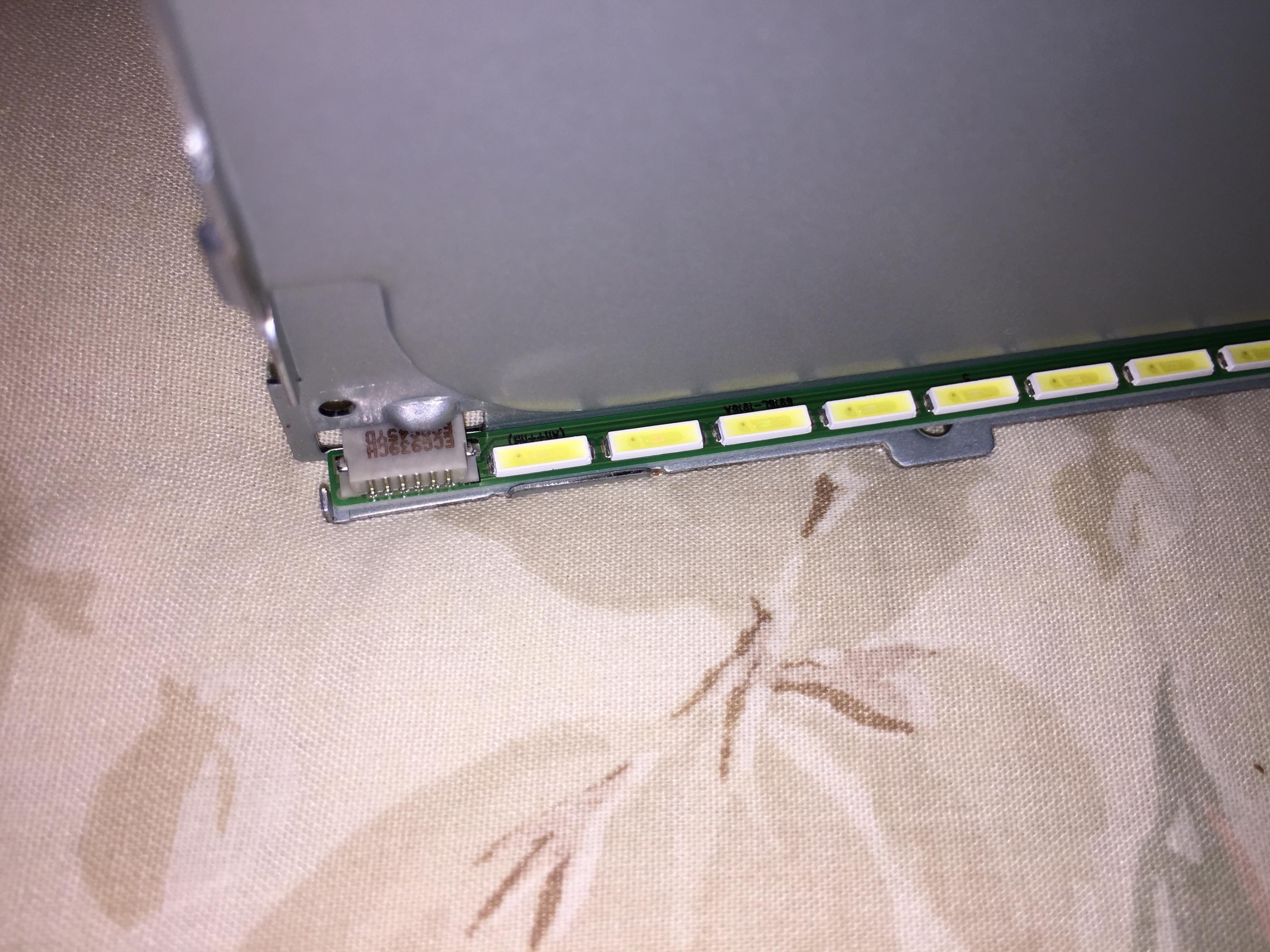

    I dissmanteled LCD to reach LED string. Measured one by one LED and they are all OK. From power supply to the strip is going 19V, 2 lines, each feeding 18 LEDs and it has 2 current sensing lines going back to LED driver OZ998B.
    Q801 voltages with refference to GND are G:0V, D:19V, S:0V, does not change with pressing power button.
    Same is happening with LEDs connected or disconnected, does not change anything.
    Pins 8 and 10 of U801 on turning on goes from 0 to 6V.
    The schematic is more or less this one, difference is 19V power supply and 2 led strips:

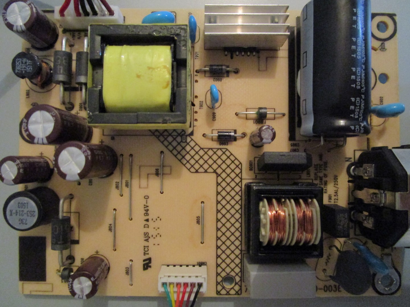

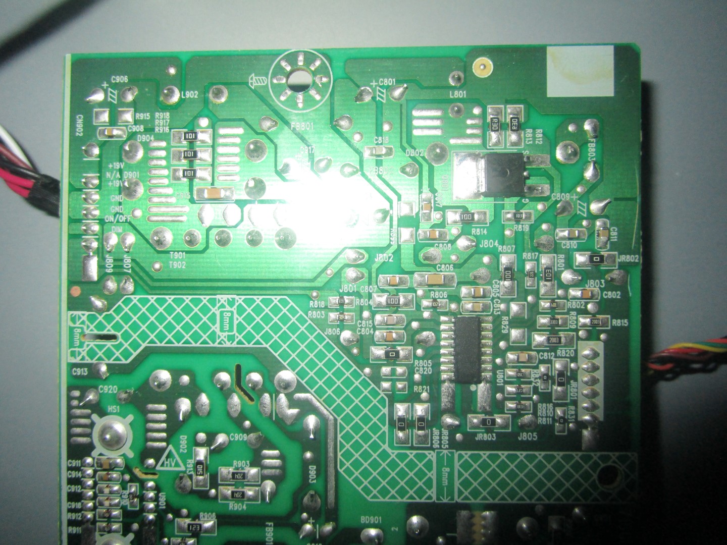

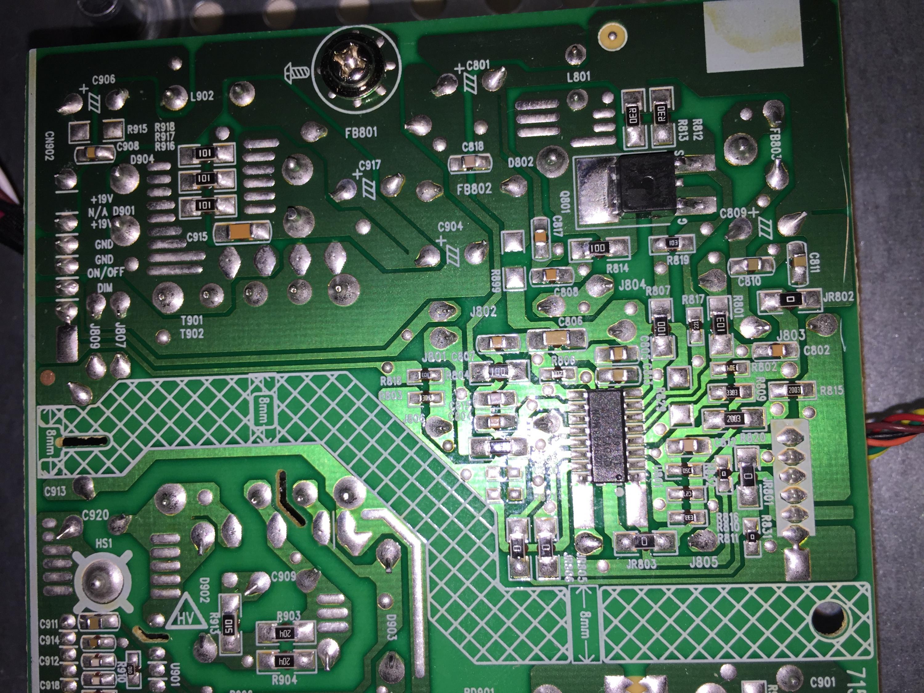

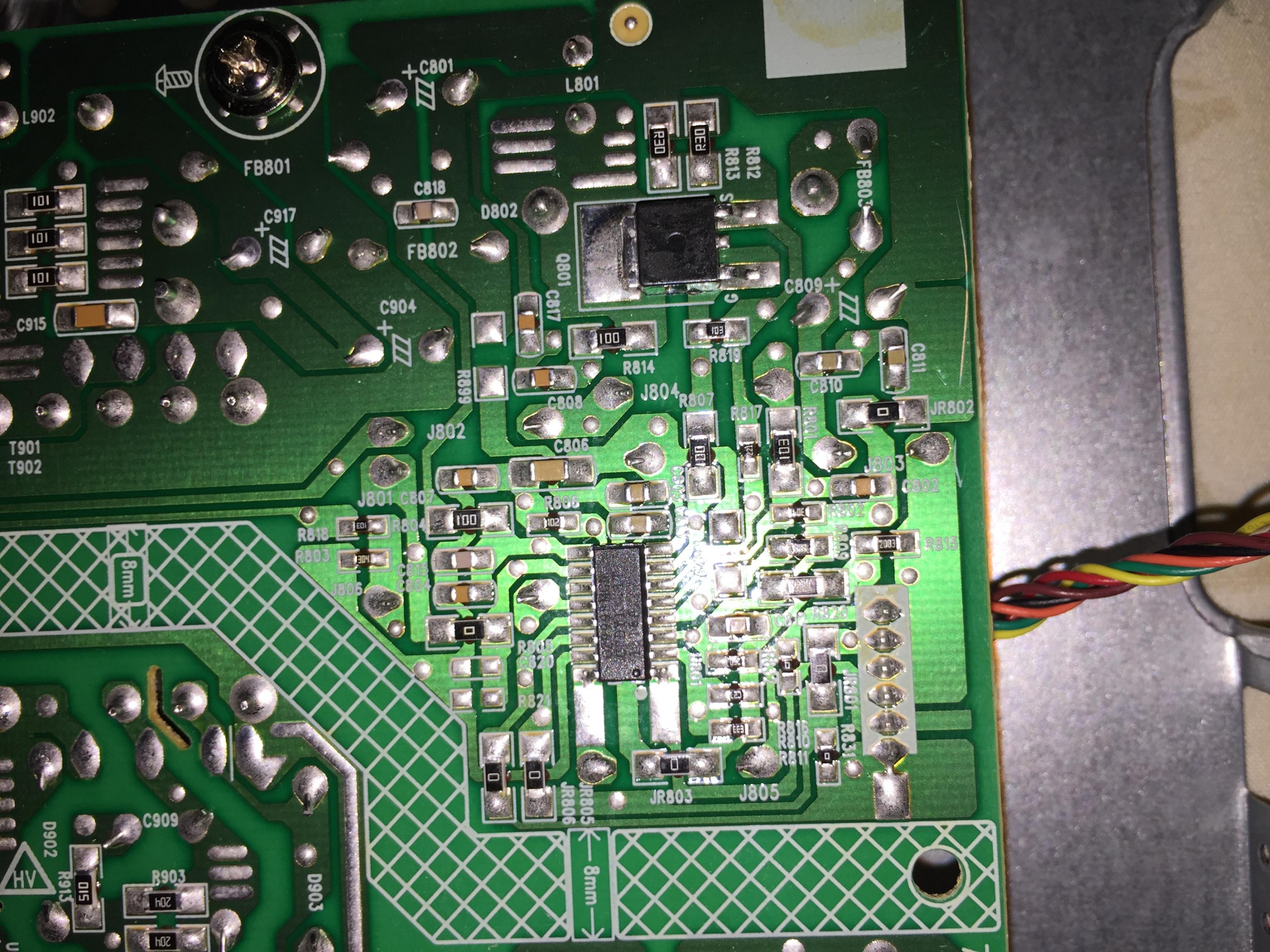

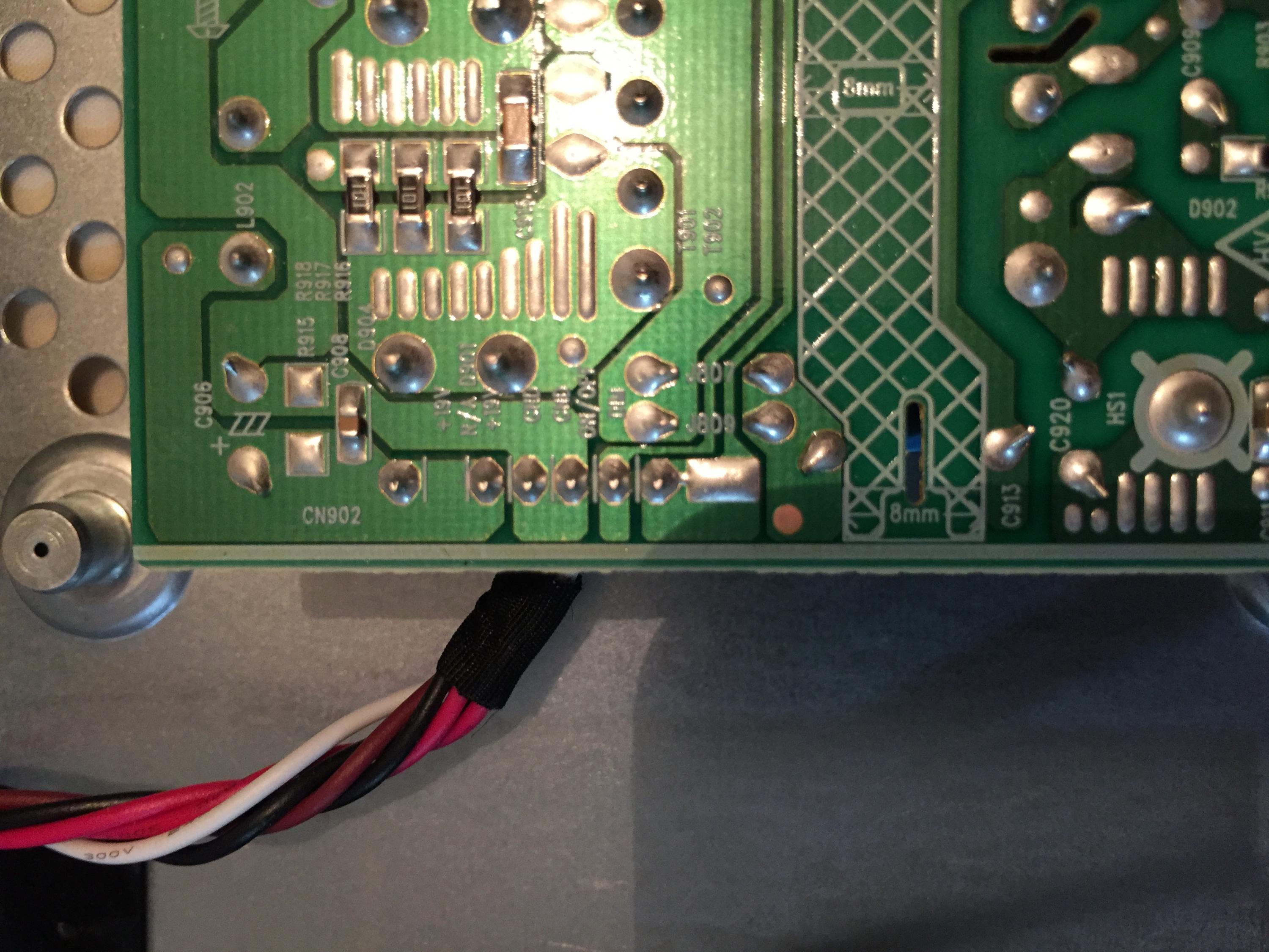

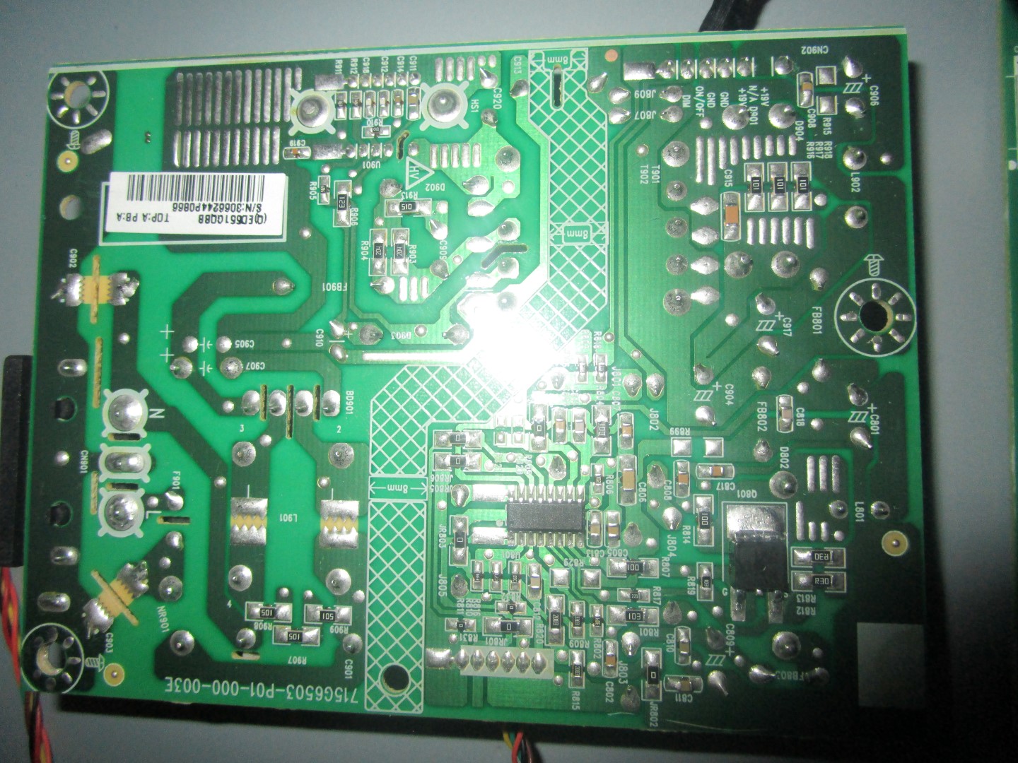

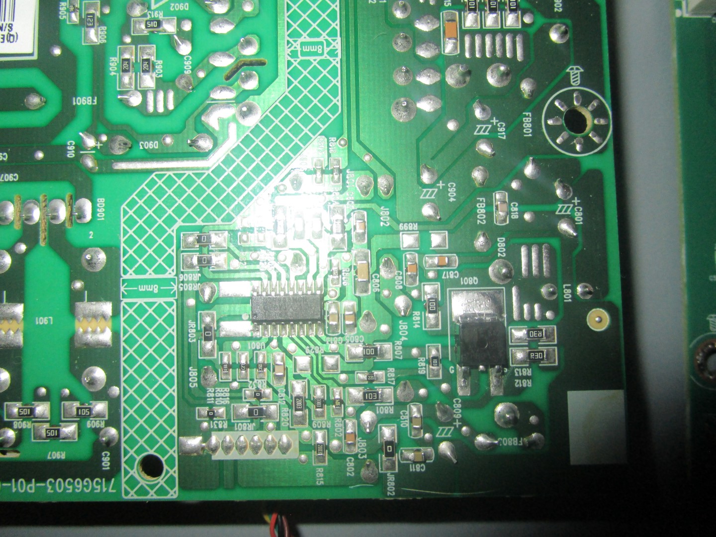

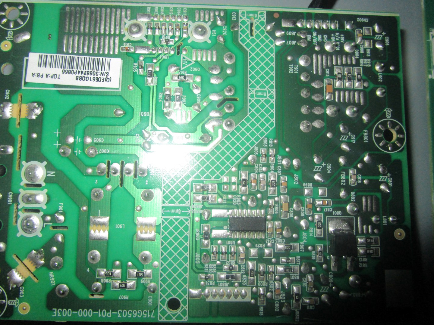

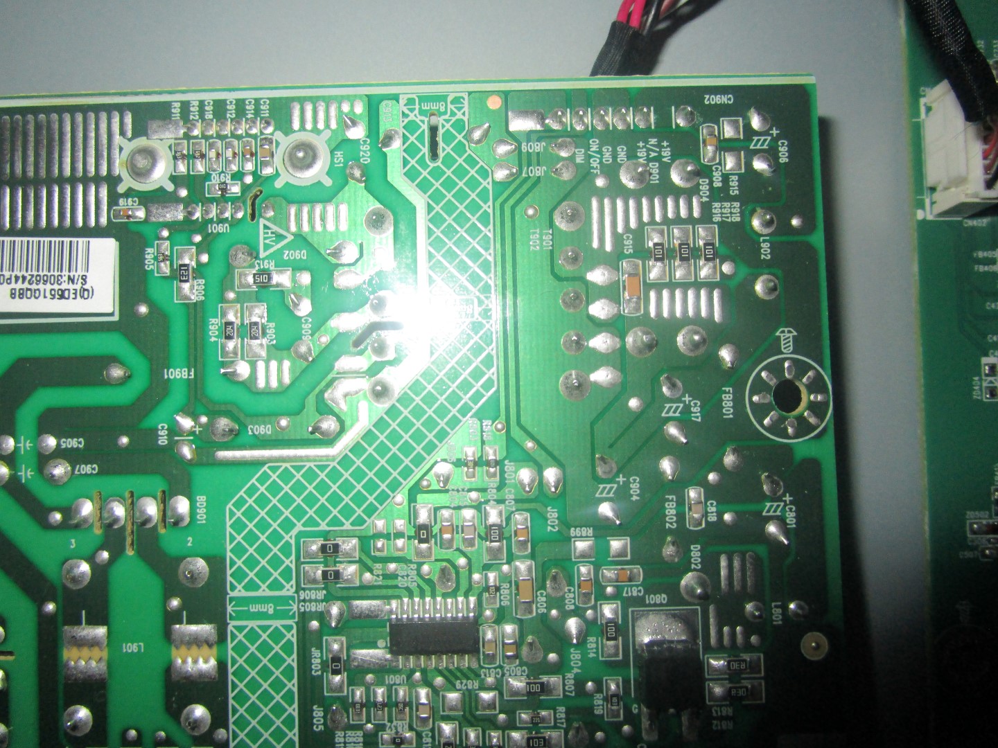

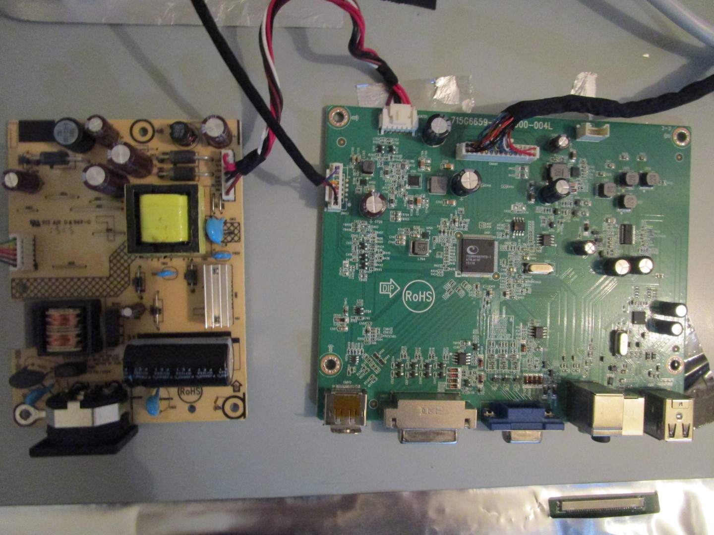

    Can we see good clear straight shot pictures of the top and bottom side of the board? And pictures of how all the boards are connected together?
      Re: Fujitsu B23T-7 no backlight
      I hope these are good enough
      Thanks Bud!

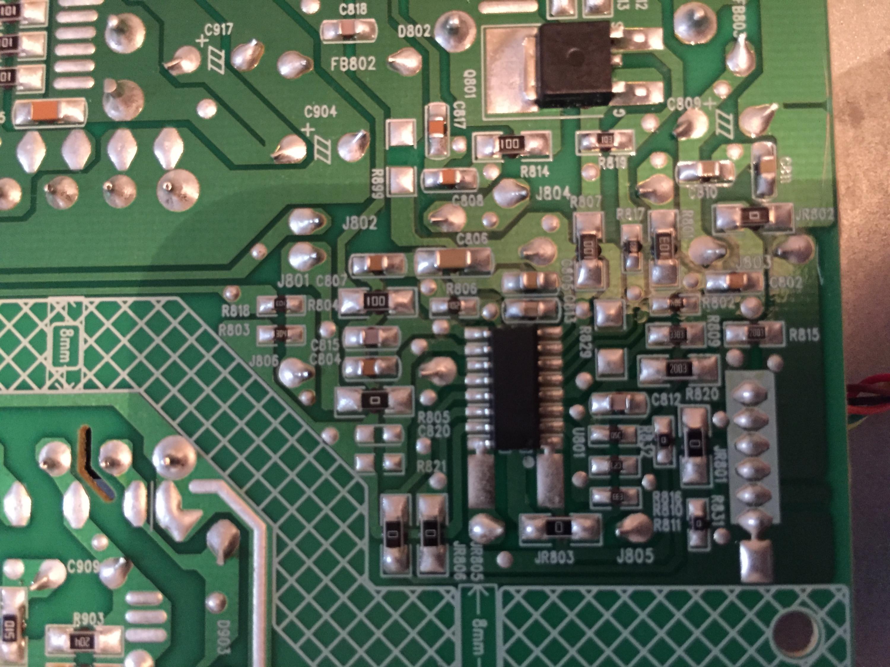

        OK, diode D802 SB5100 is shorted (conducting in both directions)
        Why and how it happened i have no idea. I will try to change it tomorrow and then hope it will not go bad again
          MOSFET Q801, D802, L801 are part of the Voltage booster circuit to boost the incoming 19VDC to higher Voltage level to feed the Anode of the LED strings, so when D802 shorted out you then will not have the Boosted Voltage only an incoming Voltage.

            Fixed!
            Replaced diode and everything is as it should be.
            Only thing is that i couldn't find proper diode, not even near replacement, because i am far from home and am happy that i could at all find some 30W soldering iron
            So, i gambled and took out D901 and now this line is relying only on D904.
            I don't know how long it will last but so far so good xD
