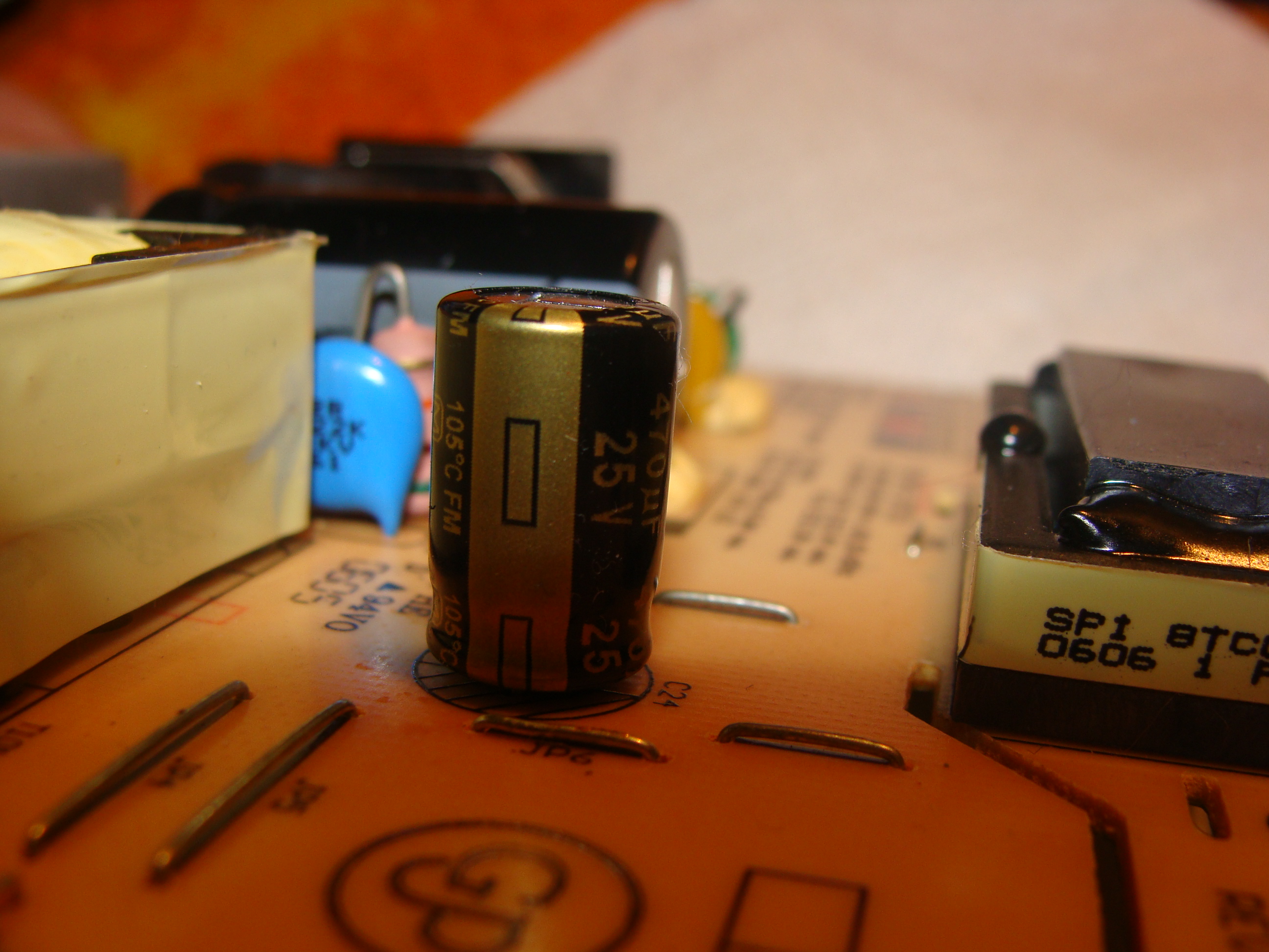

    Hi guy's,I have done the repair on a Viewsonic VX922.Worked great for months,now all of a sudden the OSD contrast pops up on screen and lowers the contrast all by itself,and I can't stop it.If I shut down the monitor,hold power button for 30 sec. and then start up the monitor,it works ok with no problems for about 5min. or so and then the contrast pops up again,and lowers contrast,and I can't stop it,I can raise the contrast and as soon as I let go of the button,it lowers it all the way down all by itself?? any help much appreciated.Thankyou.
    Had 1 bad cap bulging a C242 470uf 10v cap,I replaced it so far,can't find anything else wrong,all panel buttons are good,wiring to board ok.Anyone have a idea on this one? Much appreciated,Thankyou.
    Other than that the rest of the monitor works great.

    Re: VX922 Contrast popping up and lowering it all by itself?
    If you replaced only one cap (in a monitor that is likely filled with other bad brands or more of the same), that's not a good thing.
    Also, see my post here as I don't feel like retyping it:
    https://www.badcaps.net/forum/showpo...6&postcount=23

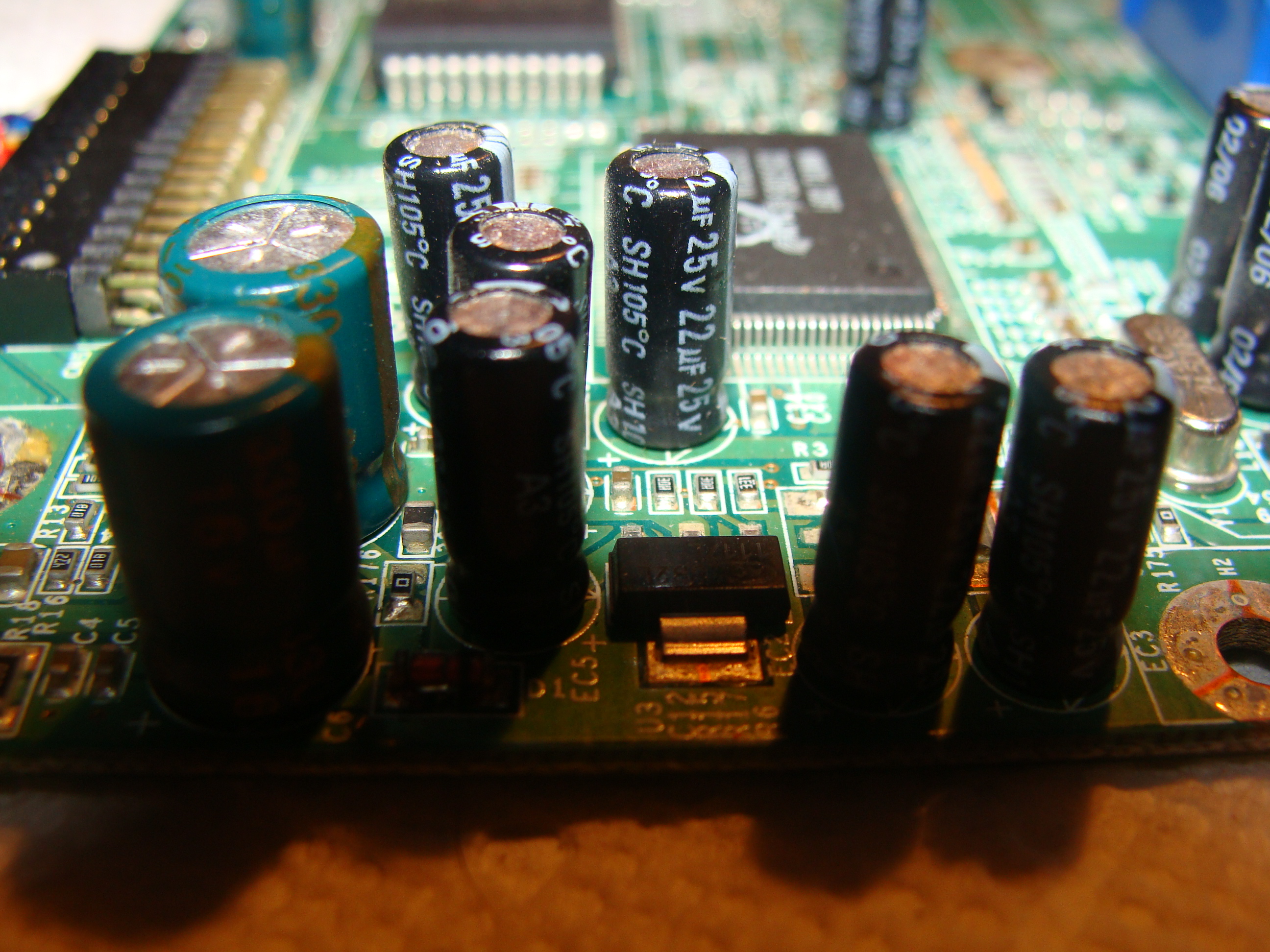

              Hi,the vid board ,the one where the DVI plugs in has like 10-22uf 25v caps and 1-100uf 25v and 2-330 16v caps.should I replace all of those to for this problem? they all look good,not swollen.Do you think this will help the problem I'm having? Thankyou for all the input.
                First try what lti and R_J suggested. If that doesn't work, post some pictures of your video board. It may be those bad caps, but it is better we see a picture first. Typically, it's the caps around the linear regulators that tend to dry out due to heat in that area.

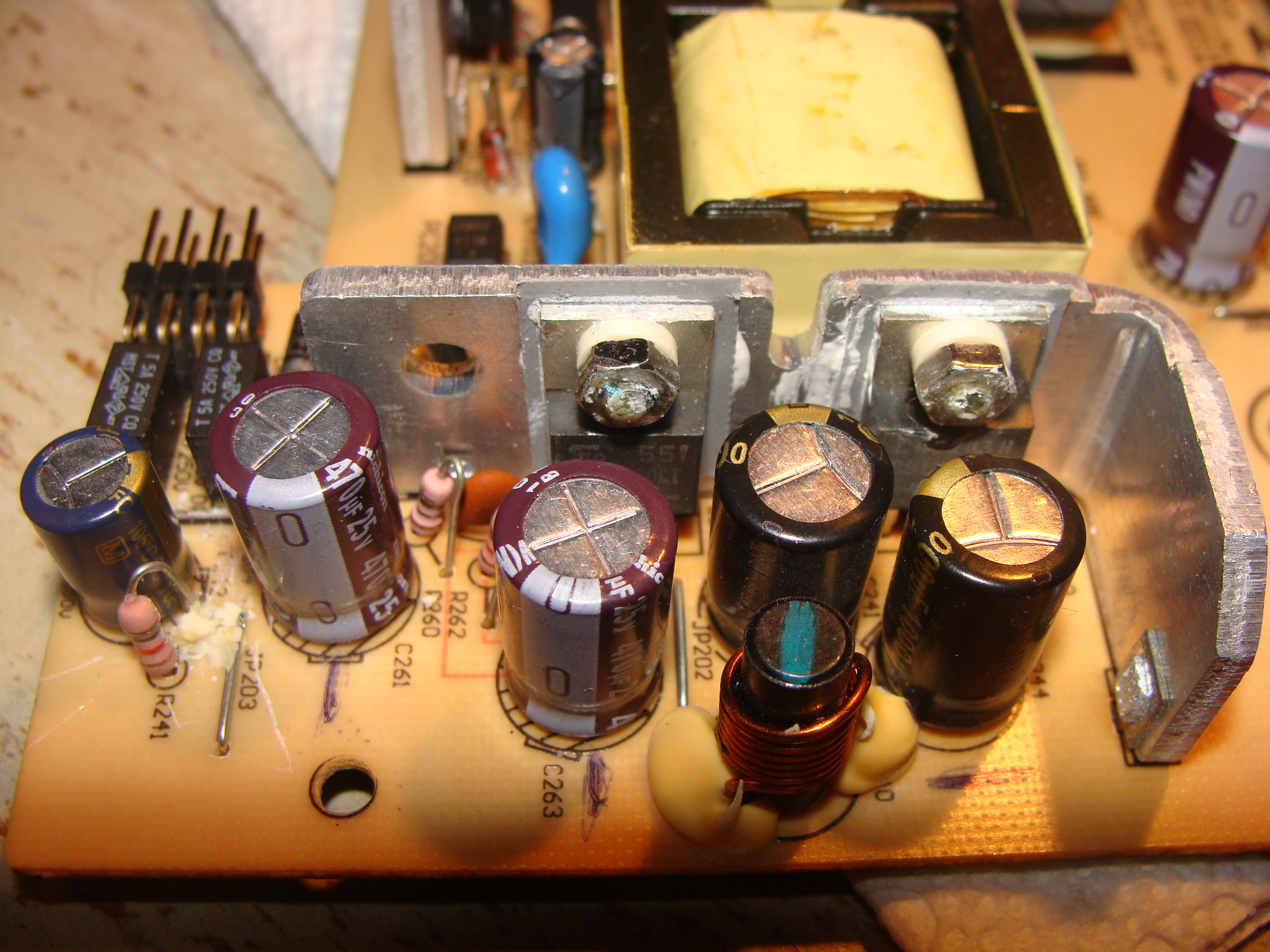

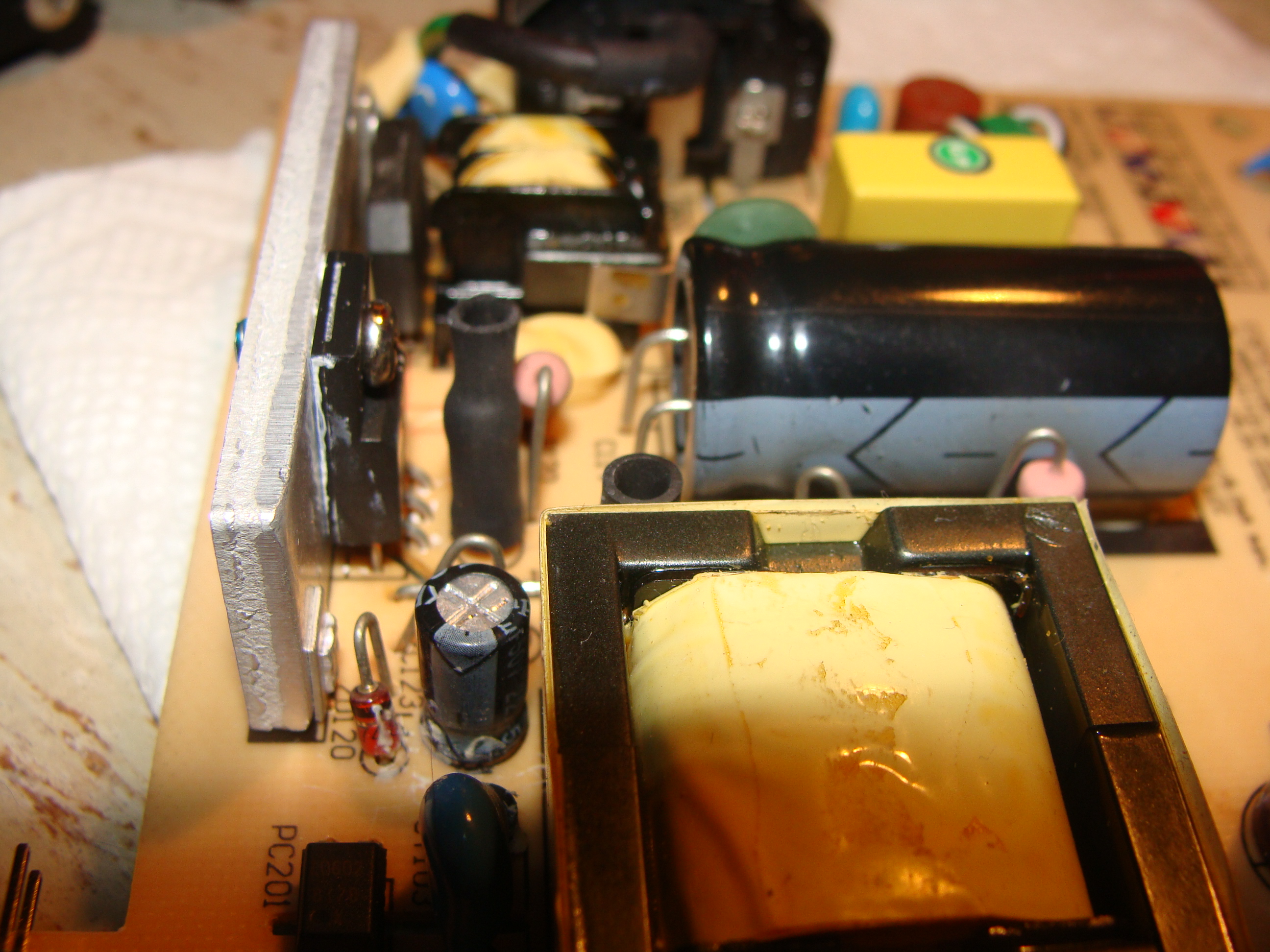

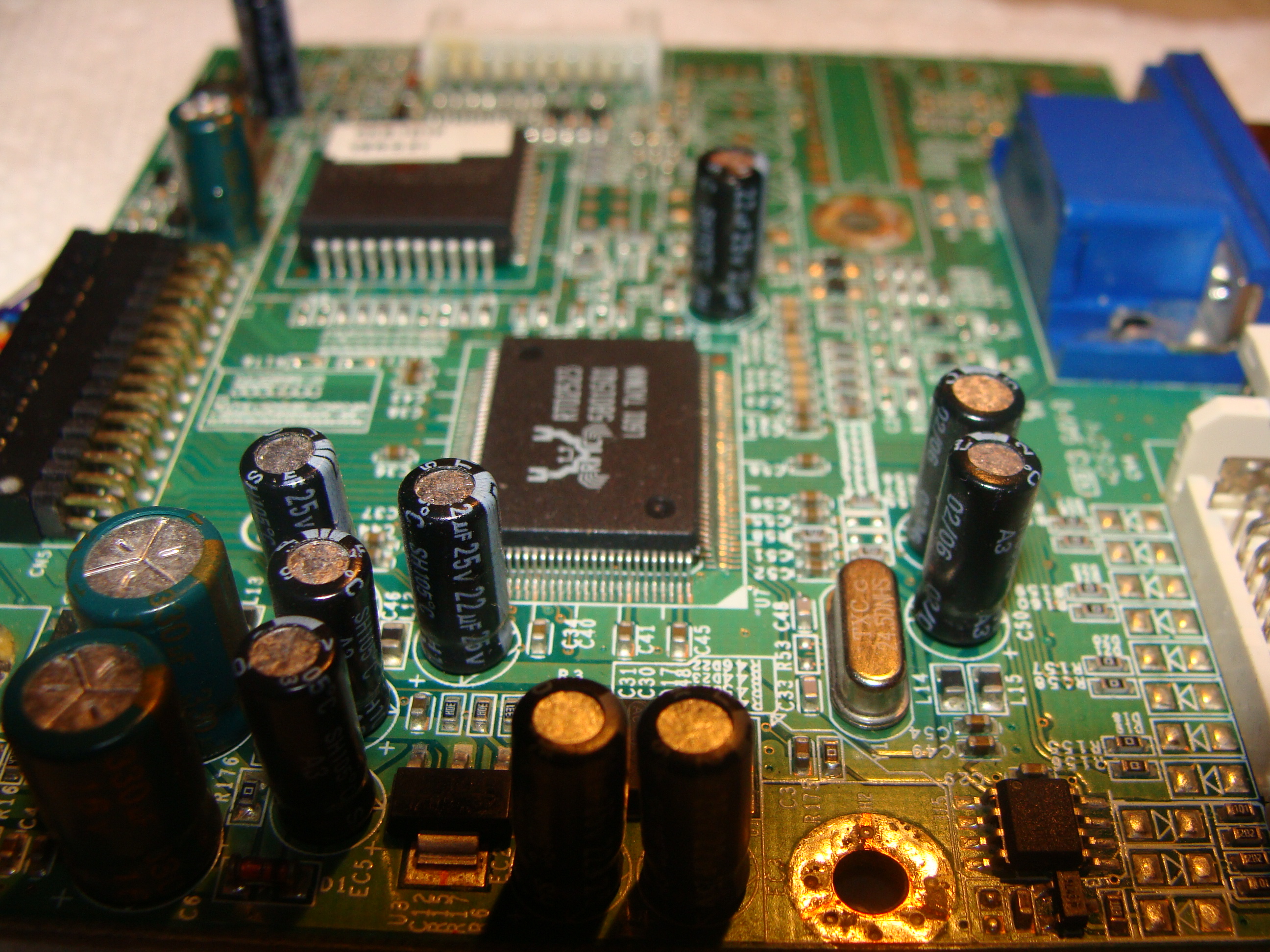

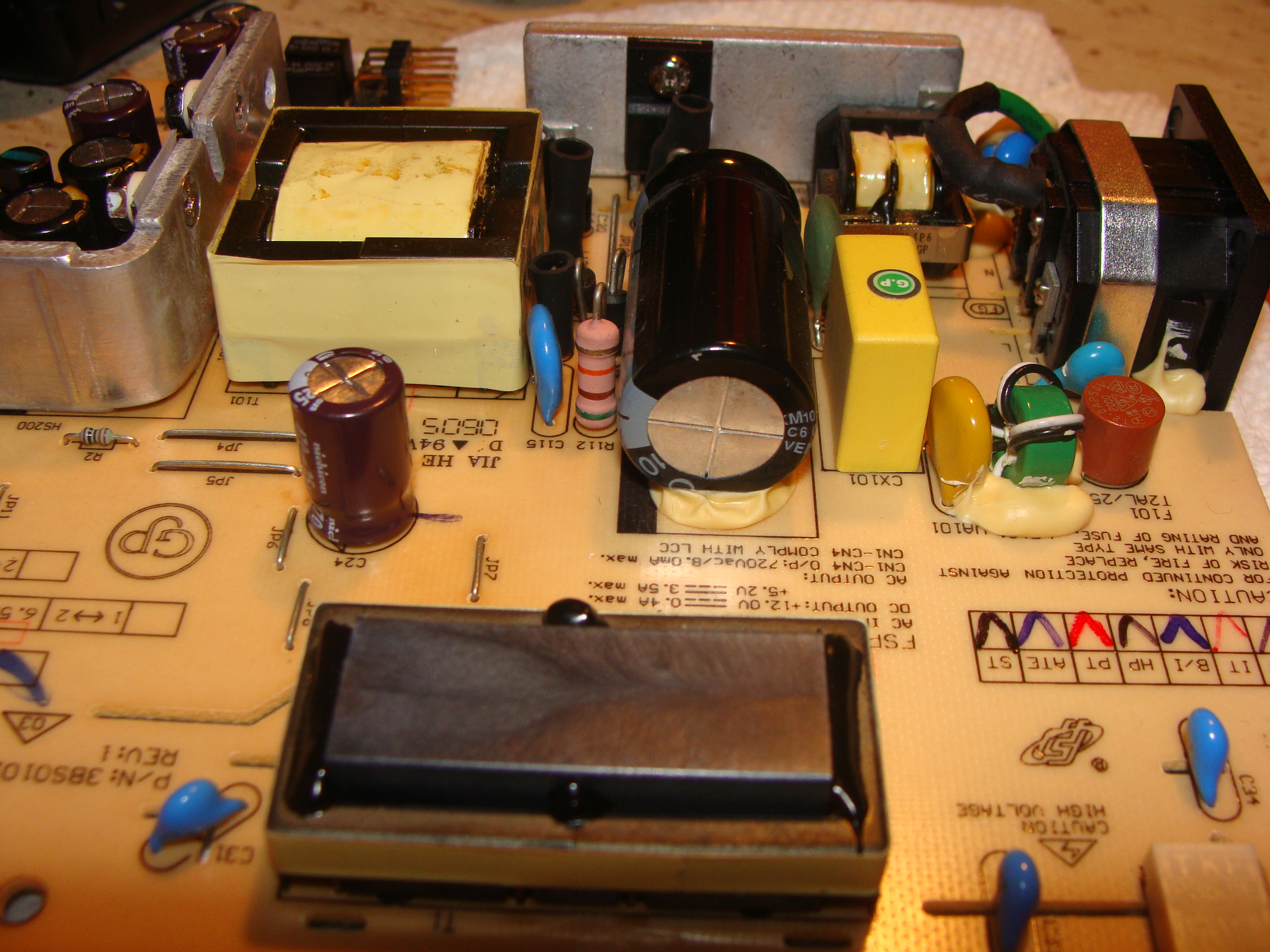

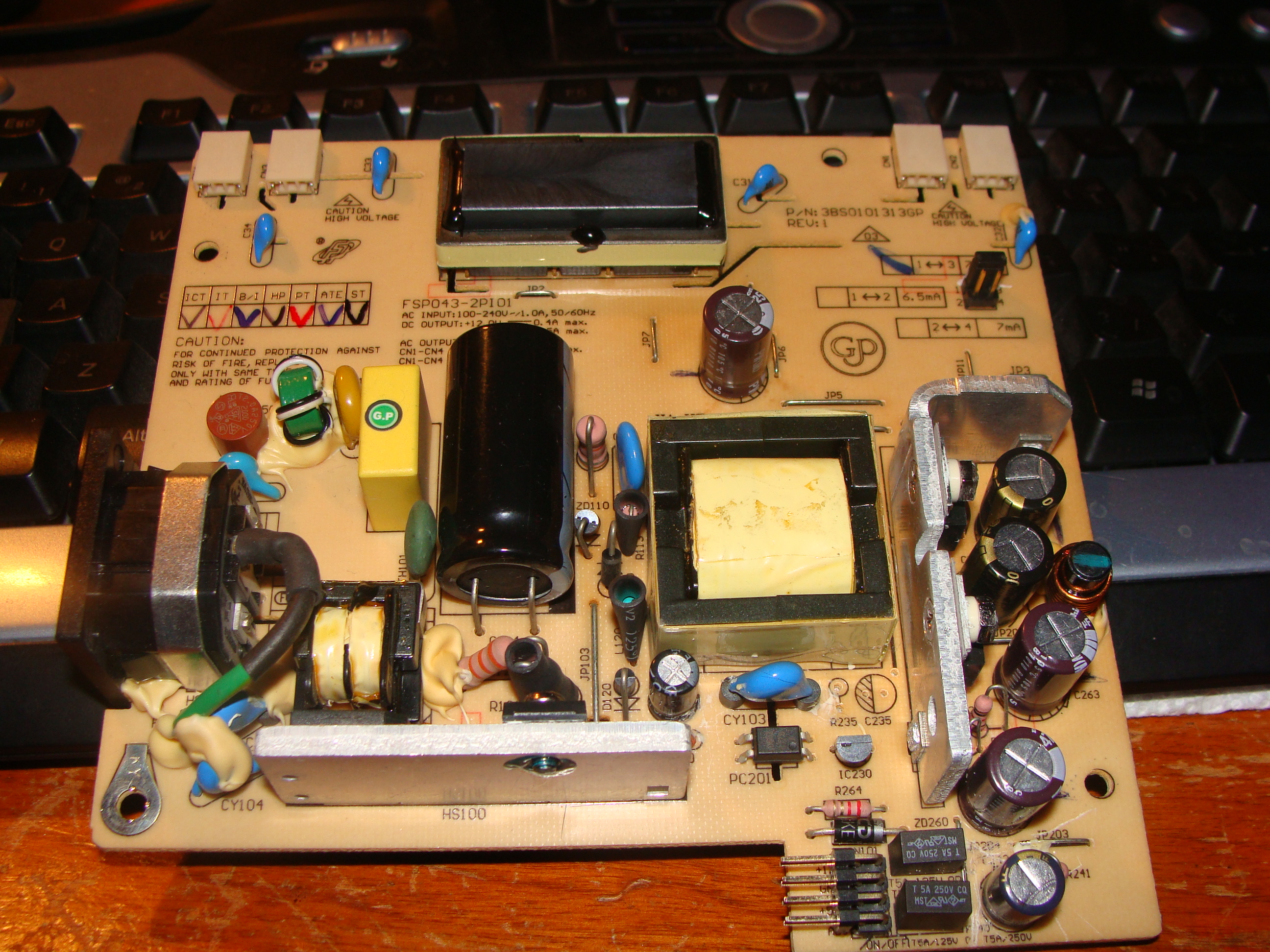

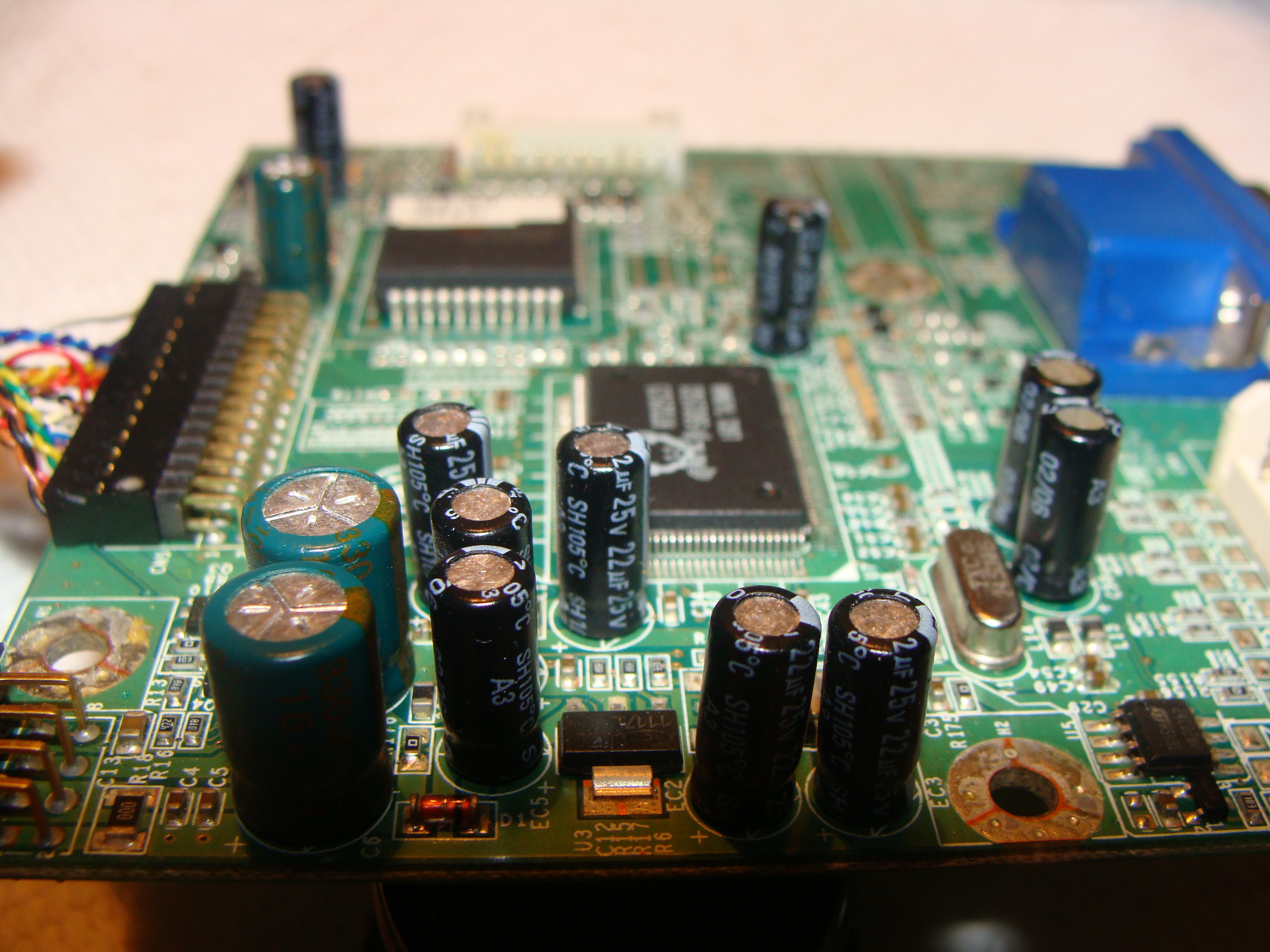

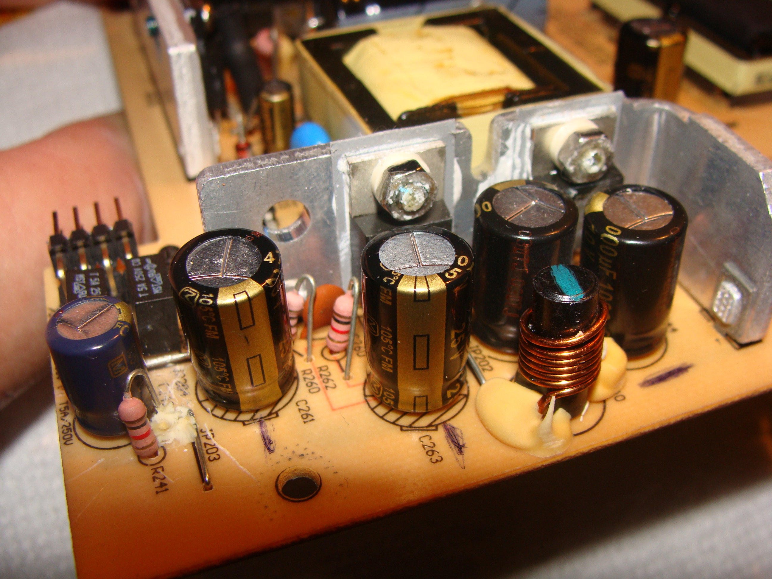

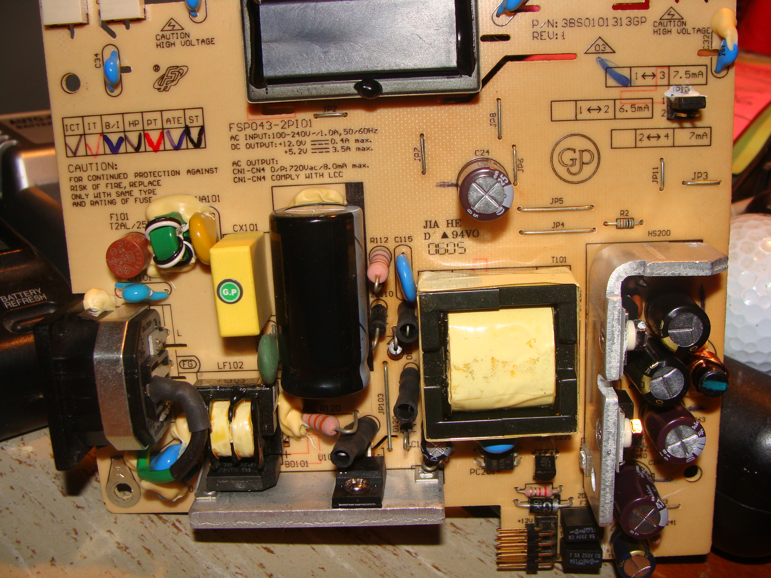

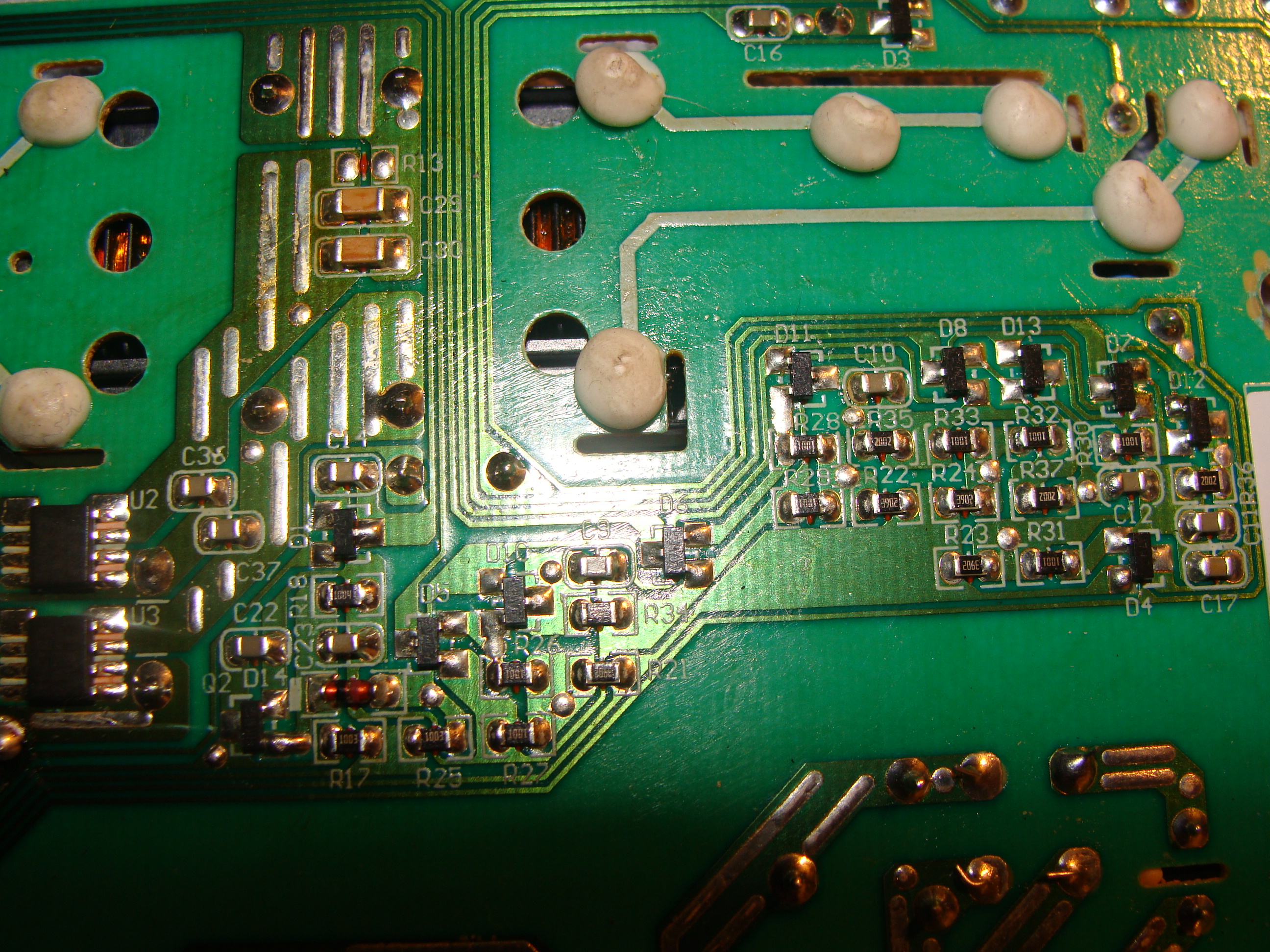

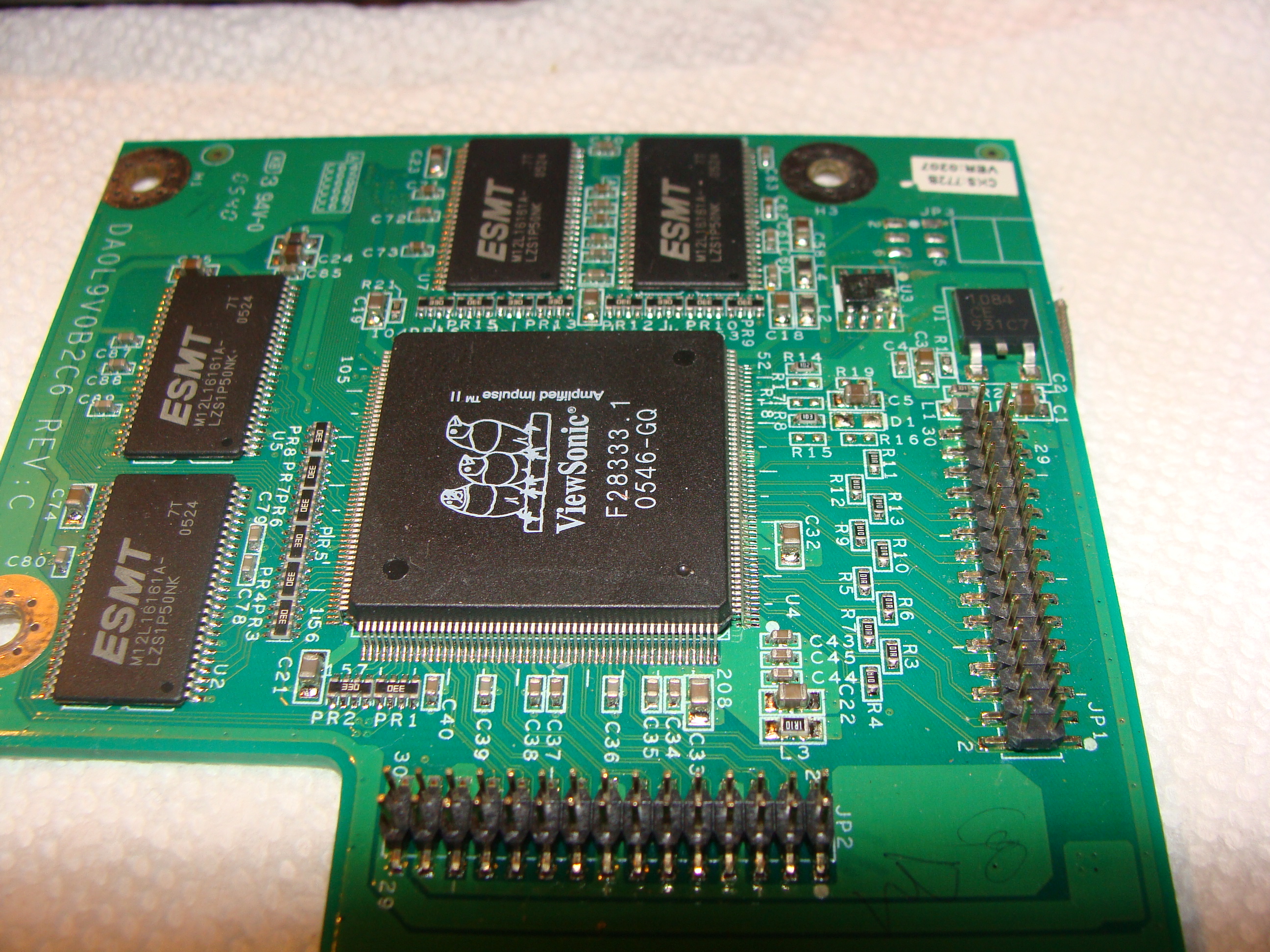

                  ok,here's some better photos of my Viewsonic VX922 power supply and video board.
                    master hoarder
                    • May 2008
                    • 12175
                    • Bulgaria

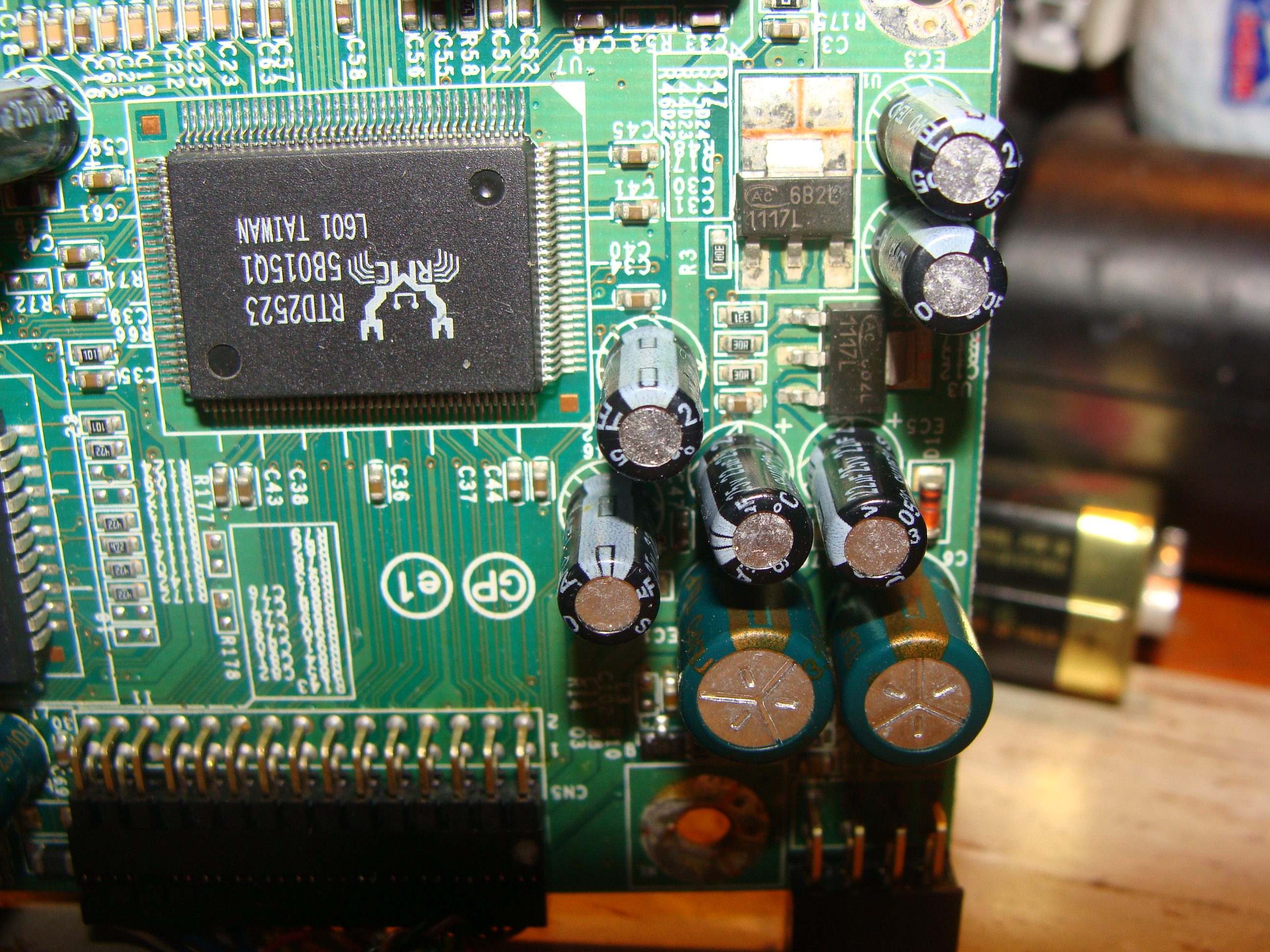

                    Ah okay, looks like you did do a full recap of the power supply board, and the capacitors you got from eBay do appear to be genuine Nichicon PW and Panasonic FR/FM/FC. So the power supply is okay.
                    As for the video board, looks like you have two Teapo SC (the green caps). Those are the ones that I would be most suspicious of. But in general, all of the caps around the regulators in this picture could be affected:
                    https://www.badcaps.net/forum/attach...7&d=1480215169
                    That said, I again urge you to try the tests that members lti and R_J suggested above... just in case this menu problem turns out to be a button issue.

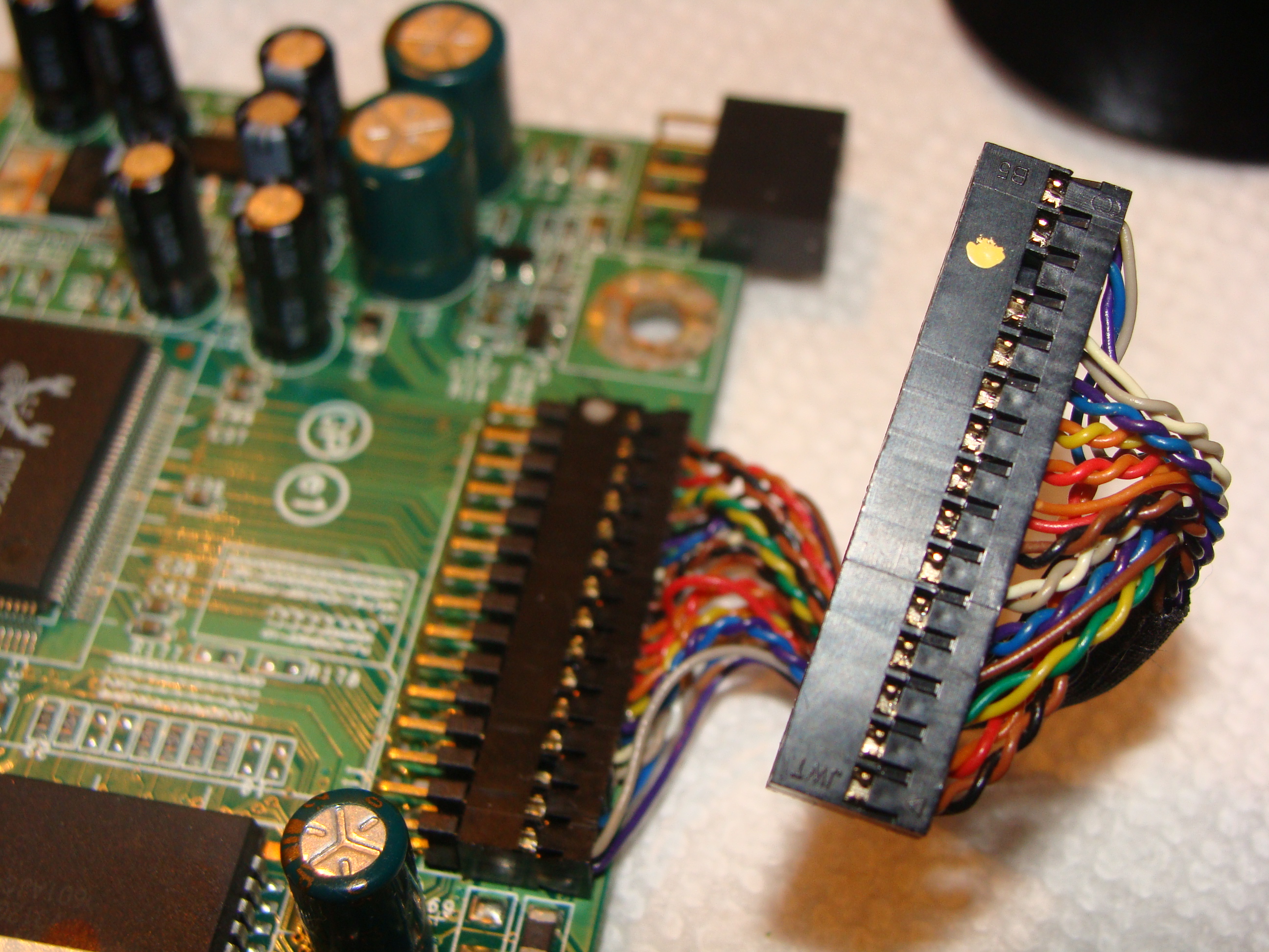

                      Hi there,Now what am I doing wrong now,It turns on ok,power light stays on,screen is bright white no signal on screen from pc at all.did not replace anything on video board,or the other board.Now I get nothing on screen.Man bumming me out now.Don't know what happened now? I wanted to try unplugging the buttons to see if it was a button problem,now I get nothing but white screen,green power button comes on ok,when starting pc,and stays on ok,but bright screen,and nothing on screen?
                        Check LVDS cable connection between video board and T-con board. It's easy to forget to plug that cable in when you take apart the monitor and it's also easy to damage it if not very careful with it.
                        The T-con board is the one on top of the LCD panel, typically under a metal cover. Just make sure the contacts on the connector between that board and the video board is clean and the LVDS cable is plugged in fully.

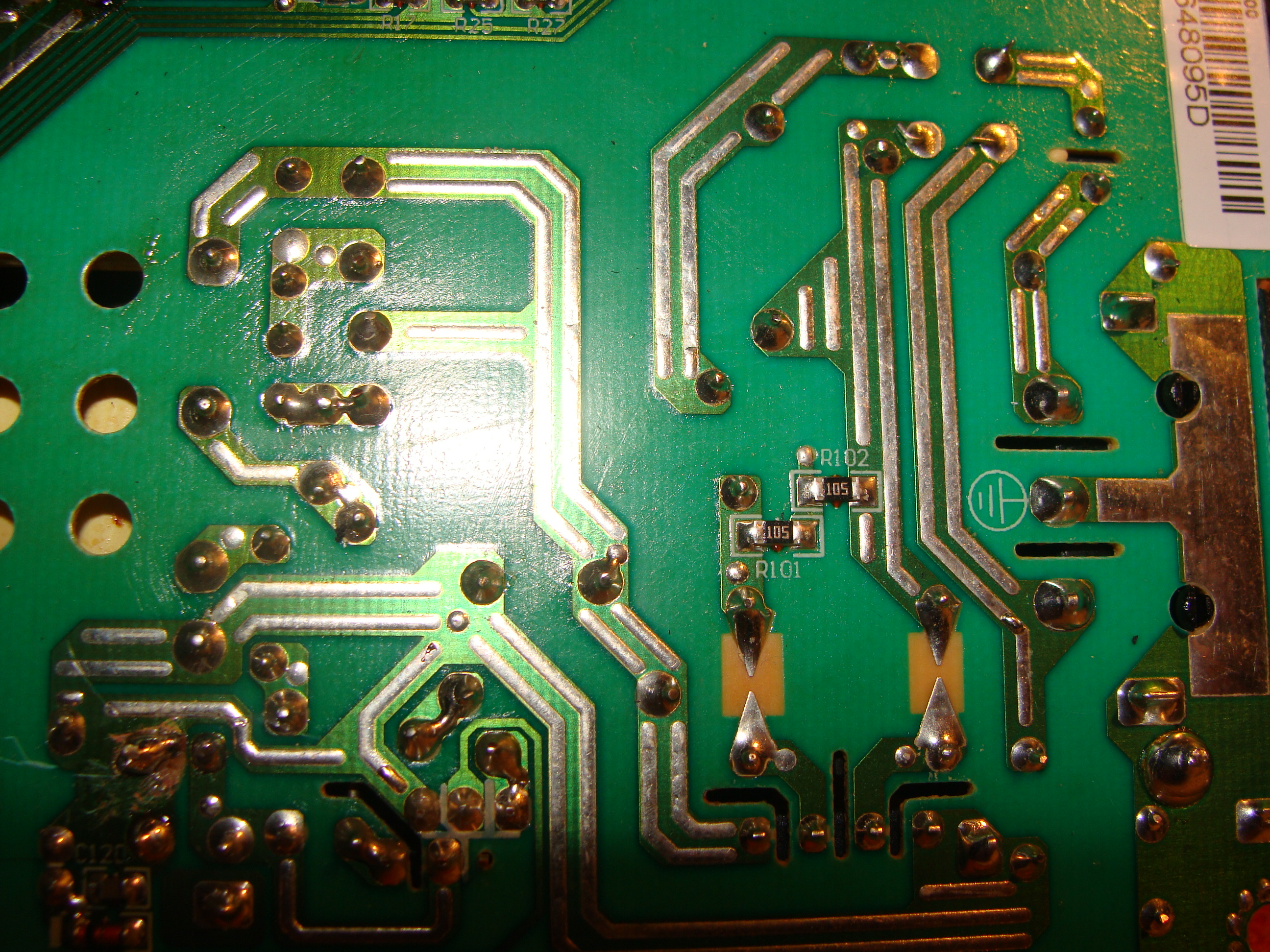

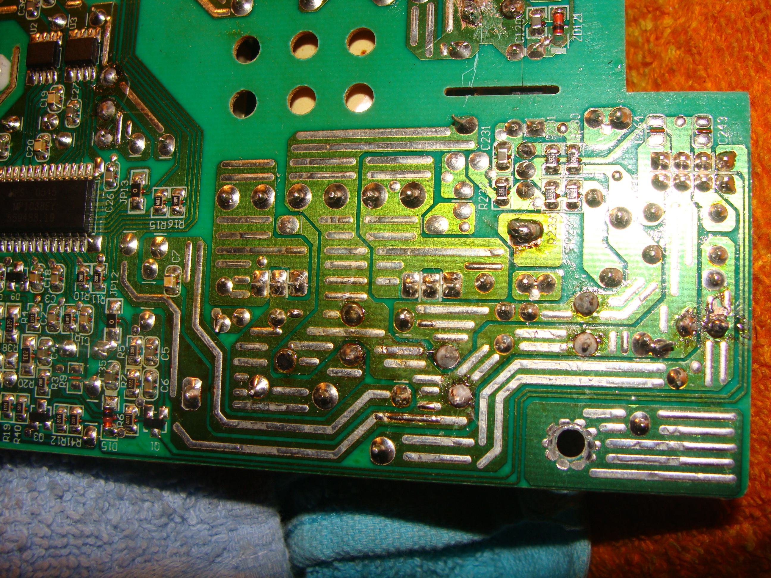

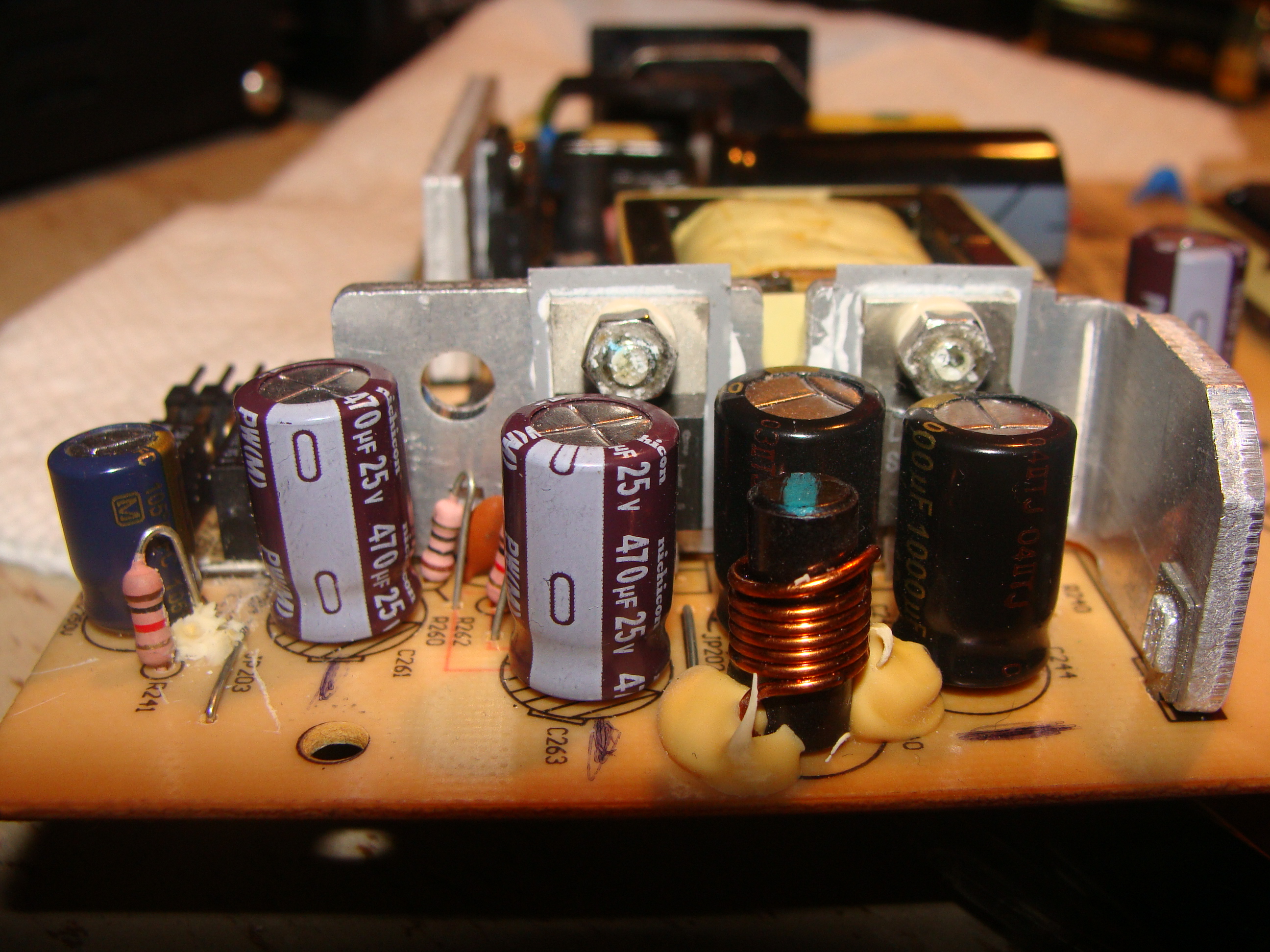

                          Checked all connectors all plugged in tight,I replaced those 3 brown caps on the power board with new ones with the T on the top,also the little cap behind the regulators.All values are right and installed correctly.Could this be a problem? the power supply? That is all I did,no other changes.I have not pitcher,and no menu at all.Just a white bright screen.
                          • lordgalla
                            • Nov 2012
                            • 13
                            Here's some more photos of those caps I replaced on the power board,3 4 I replaced with T on top ones.That was all i did to this.Now I get that white full bright screen and no display from computer,power light stays on green,no menu at all also.God help me,what am I doing wrong here? I just want to thank you for helping me through this,much appreciated.

                                    Thanks guys,I am done.This video board is bad,not available any where online for this Vx922 monitor.Ebay etc. nothing anywhere.Not worth spending more time with it.Time to get rid of the rest of it.Thankyou all for your professional help on this.Unless you guys know where I can get a video board for this monitor with DVI and VGA connections on the board?

                                      There should indeed be a fuse on top of the T-con board, near the connector. It is SMD type, so it's not a "regular"-looking fuse. If the T-con board has designators, it will have a "F" prefix, followed by a number (i.e. F1, or F101, or F001, etc.) If that fuse is okay, then we have to check if power is getting to the T-con board. Since the video board was suspect to begin with, it is possible that it is not giving power to the T-con board.
                                      So if the fuse on the T-con board measures OK, then recap the video board. Those green Teapo SC capacitors that can be seen in this picture
                                      https://www.badcaps.net/forum/attach...6&d=1480521220
                                      ... are definitely the first things that should be replaced. Probably not a bad idea to replace the small caps around the regulators either. Only that way we know for sure that any problems this monitor may have are not due to bad capacitors anymore.
