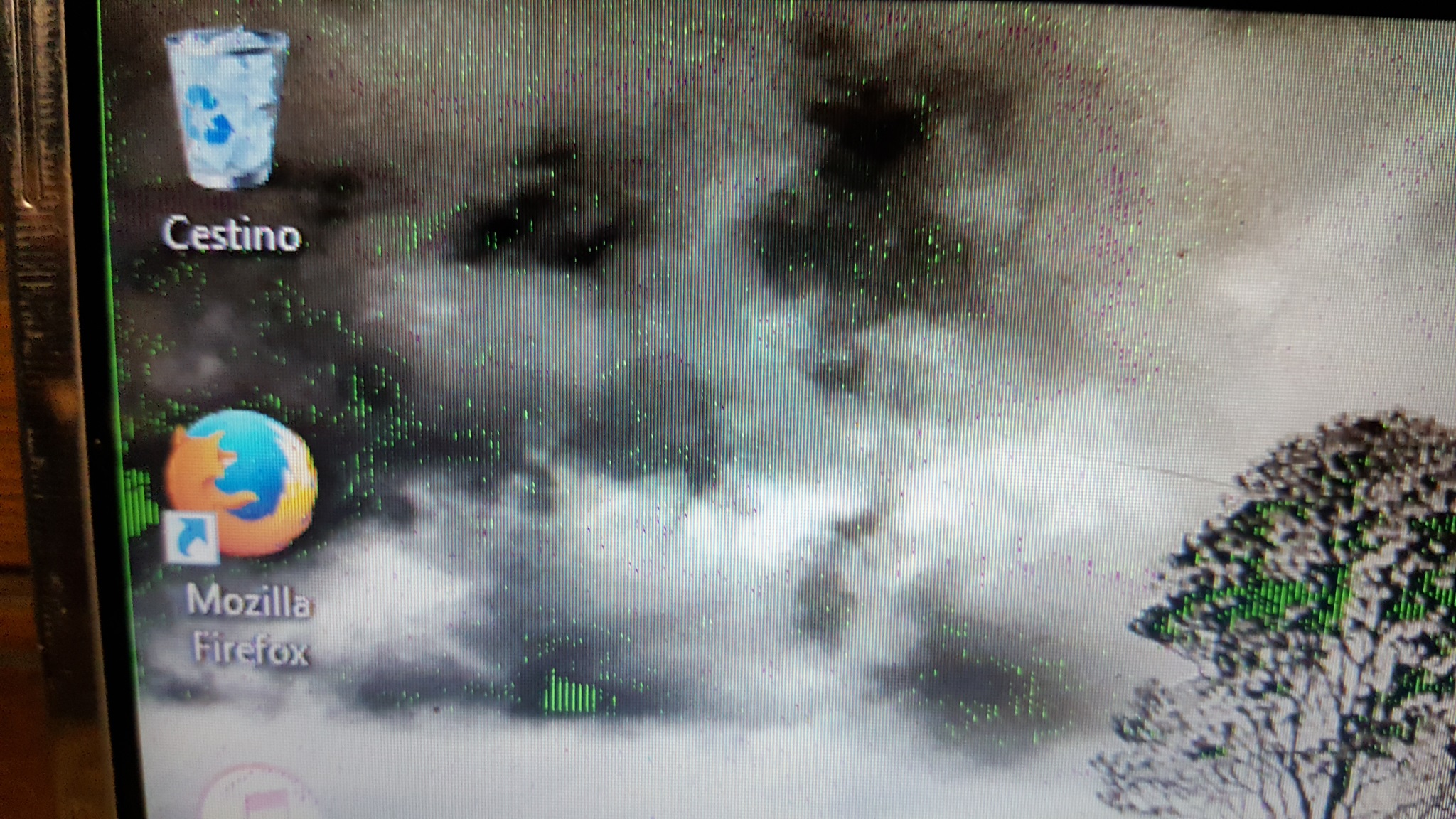

    I have and old vaio laptop with nvidia 7600, no issue on external LCD but the 17.3 panel show strange colors.
    LCD cable (I have tested every wire with tester in ohm) seem not have problem
    I have changed LCD but the situation remain the same
    Prior to change the GPU chip the question is:
    it's possible that a faulty gpu work well with an external lcd and has an issue on lvds signal ?
    It's possible to test lcd signal with oscilloscope when the unit is running ?
    thanks

    may take a photo from strange colors?how about testing lcd panel?
    when picture is right in VGA output So GPU chip is fine.

      Re: VGA and LVDS on laptop
      These are two pictures of the LCD issue, I have tested the lcd cable with meter in ohm and check continuity pin to pin.
      thanks
        As we know, the LVDS signal and the CRT signal have the balls separated on the gpu. If we assume that the graphics chip is working well, but some of the balls about the LVDS signal are unsolder , why it is not possible that this is the cause of the problem? it is also possible that some components that manage the LVDS signal are faults. In these cases we should have a problem with the graphics driver?
        Not always the vision of external monitor exclude a problem on the graphics card, if I'm in error someone can explain why?

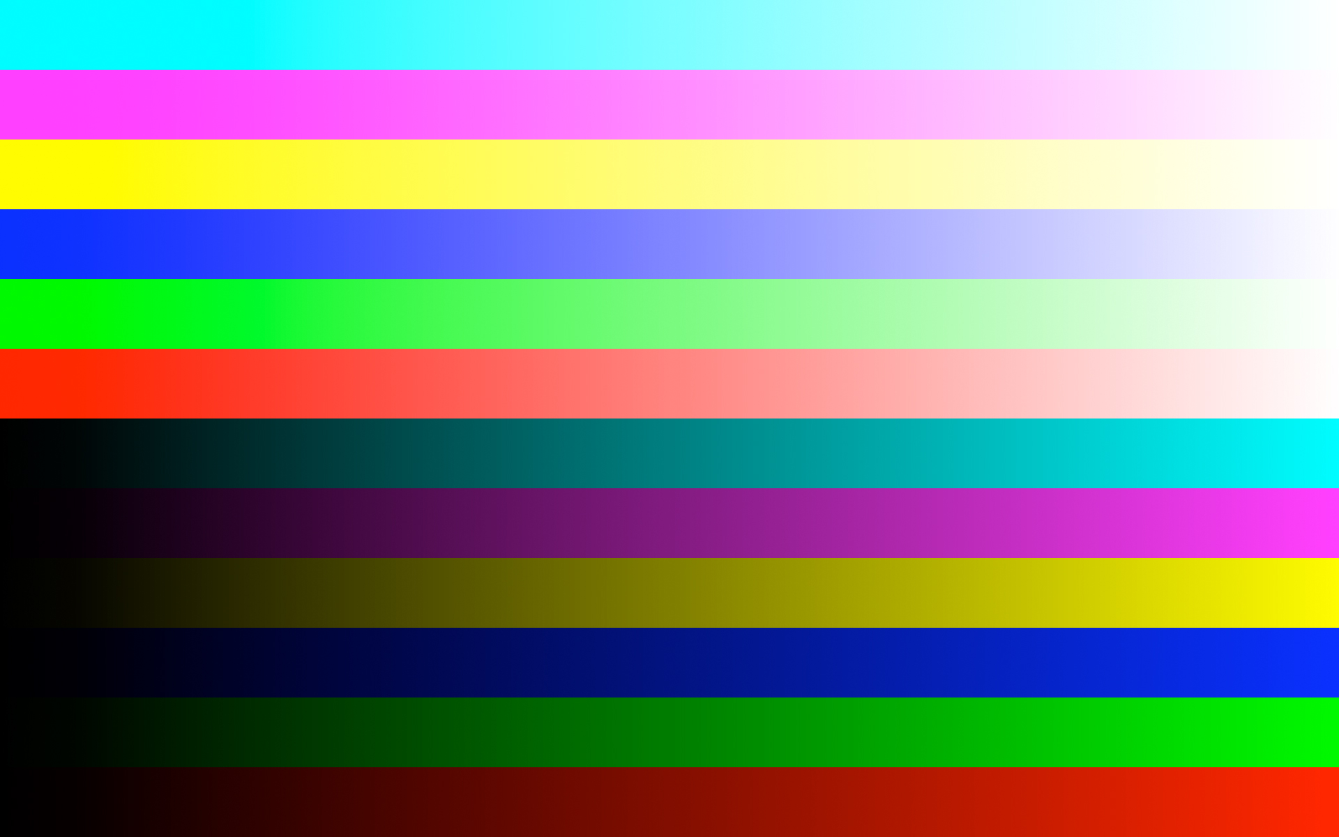

          Just for curiosity, how does it look with this test image?
          • jasko_jacker
            • Oct 2014
            • 1140
            • italy
            if I understand the question, this seems ok

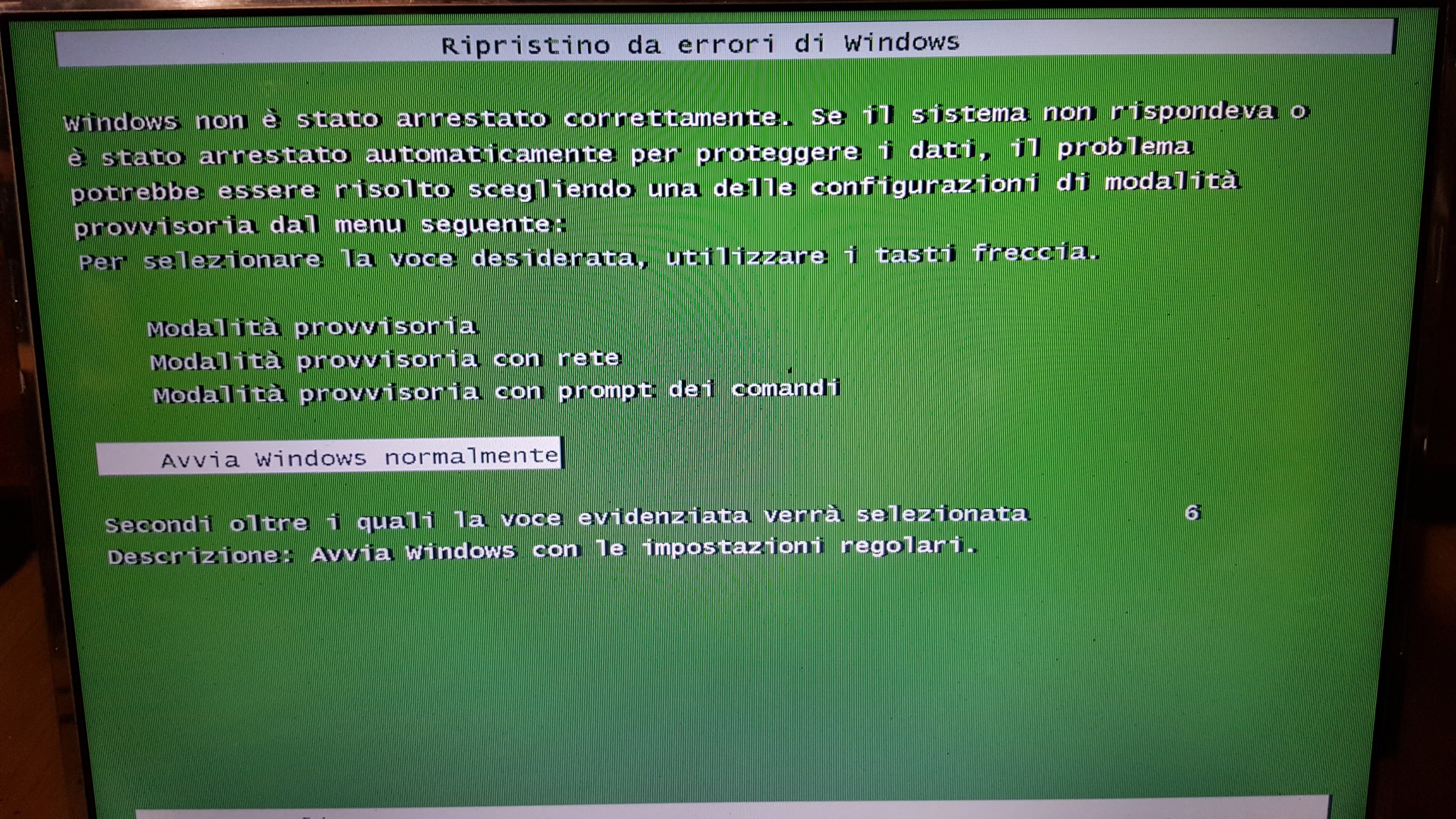

                The owner told me that the problem was the lack of a video signal, but when I turned on the notebook, the screen was working properly. After I installed the entire operating system and run the tests on temperature, the day after the screen showed artifacts. I thought immediately that it concerned the video card failure, but changing it now the screen does not turn on at all.
                The laptop is an asus g73sw it has two lvds socket ,one for 3d (5 volt) and one non 3D (3 V) .
                I have tested the flat cable with a signal (square waveform ) pin to pin to see with oscilloscope if the wave is distorted but all seems in order.
                I have changed the videocard with no result.
                I have detected that the 5V switch mosfet it's in order but the signal on the base is missing, if I connect the 5v directly on LCD (it's not a good practice ) the voltage on mosfet's drain disappears and comes back only after removing power adaptor. If I connect the 5V with an external power source I see 0.75 A.
                At this point because the lcd has a 50 pin connector (3D) in this moment I haven't another lcd to test or a laptop to test it.
                Now I am in doubt whether to buy a LCD flat cable or the entire screen.
                What other test could I do?
