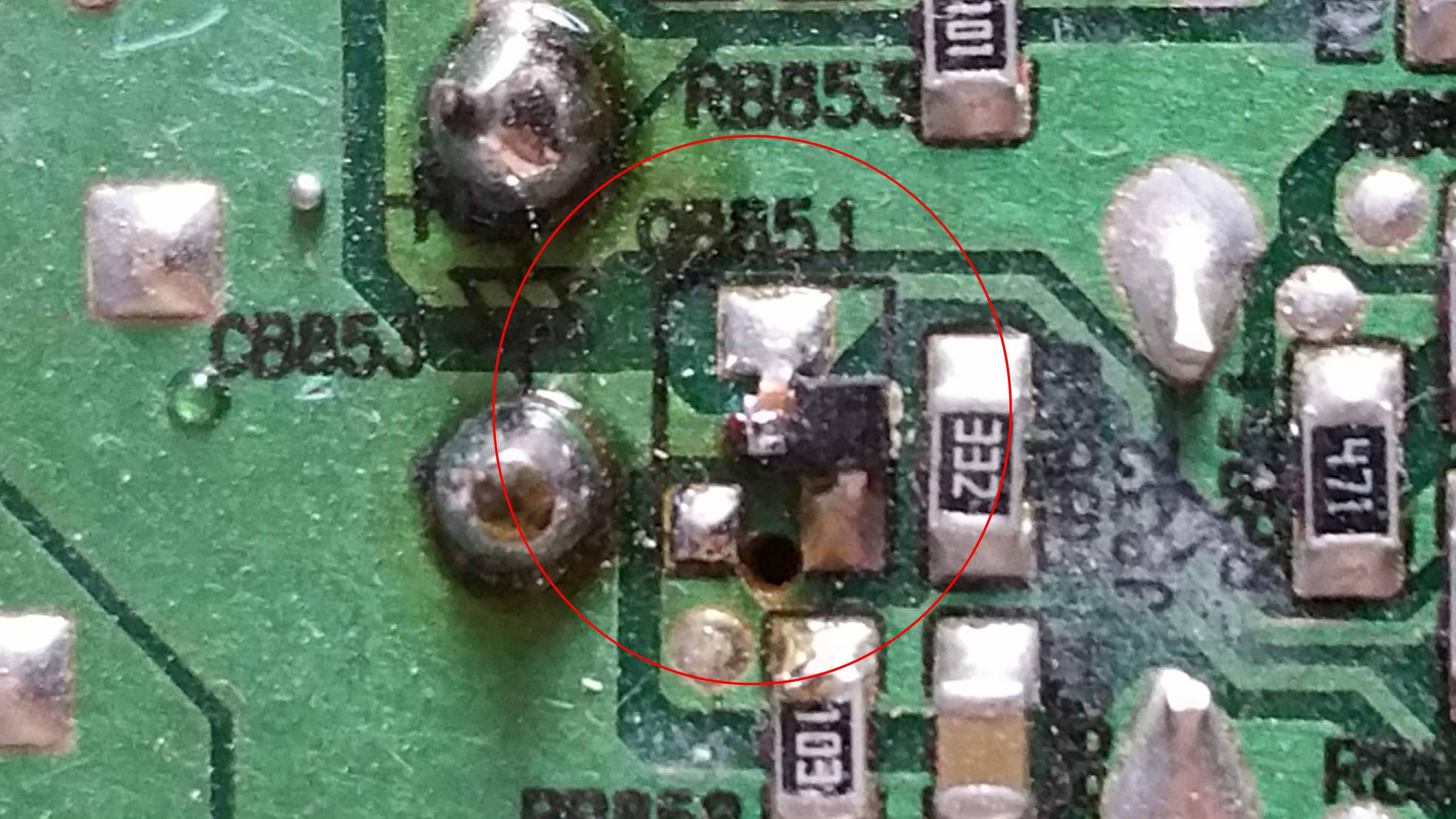

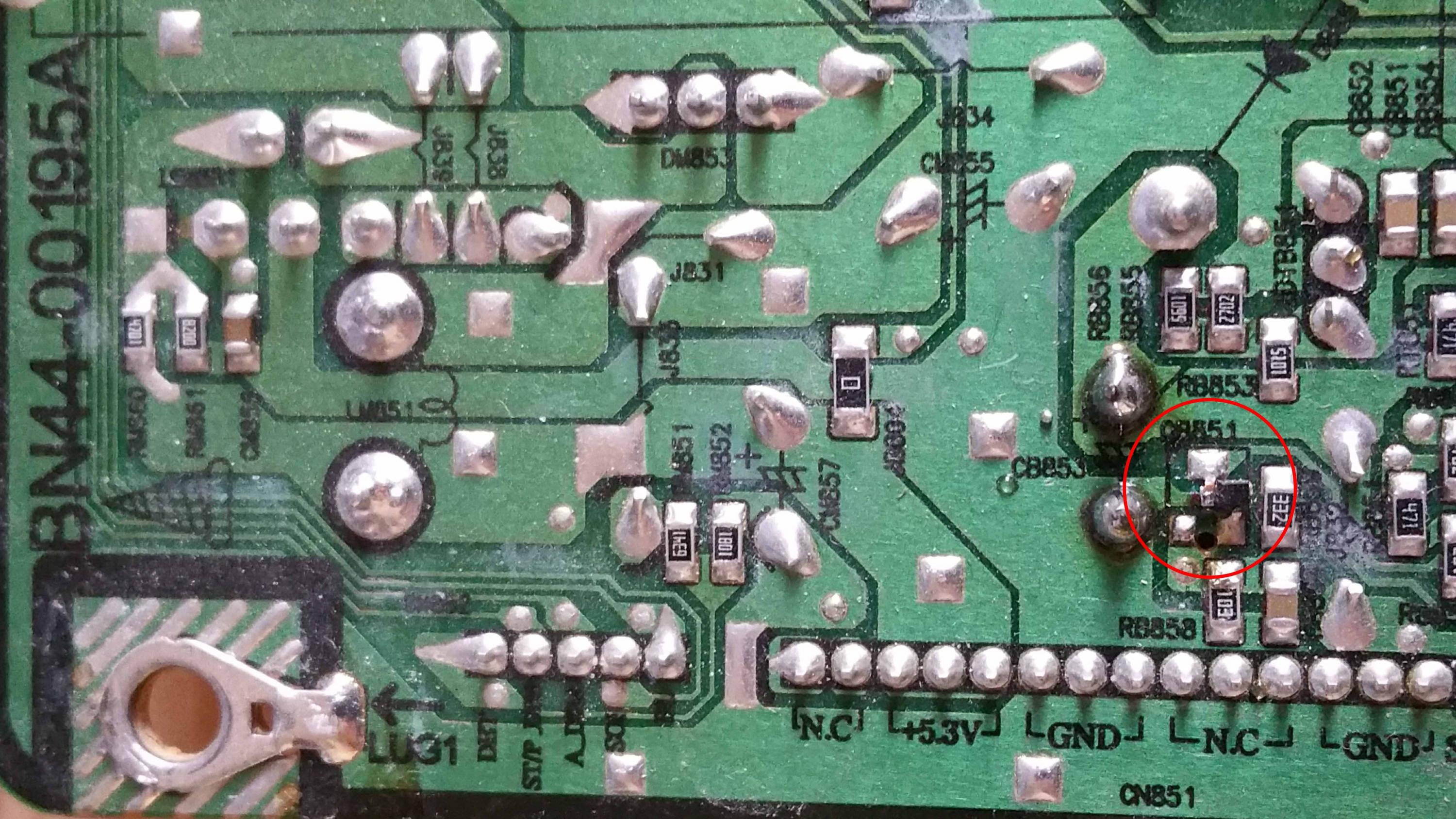

    Hi guys,
    I think I damaged a transistor when I replaced a bad cap on a BN44-00195A board. Can anybody identify it from the pics and tell me what to replace it with? If that's possible at all...
    Thanks a lot!

    Re: Identify SM transistor on BN44-00195A
    LMBT2222ALT1G
    Assuming that this is the right schematic.
      Here is a link to the diagram https://www.badcaps.net/forum/showthread.php?t=22008
