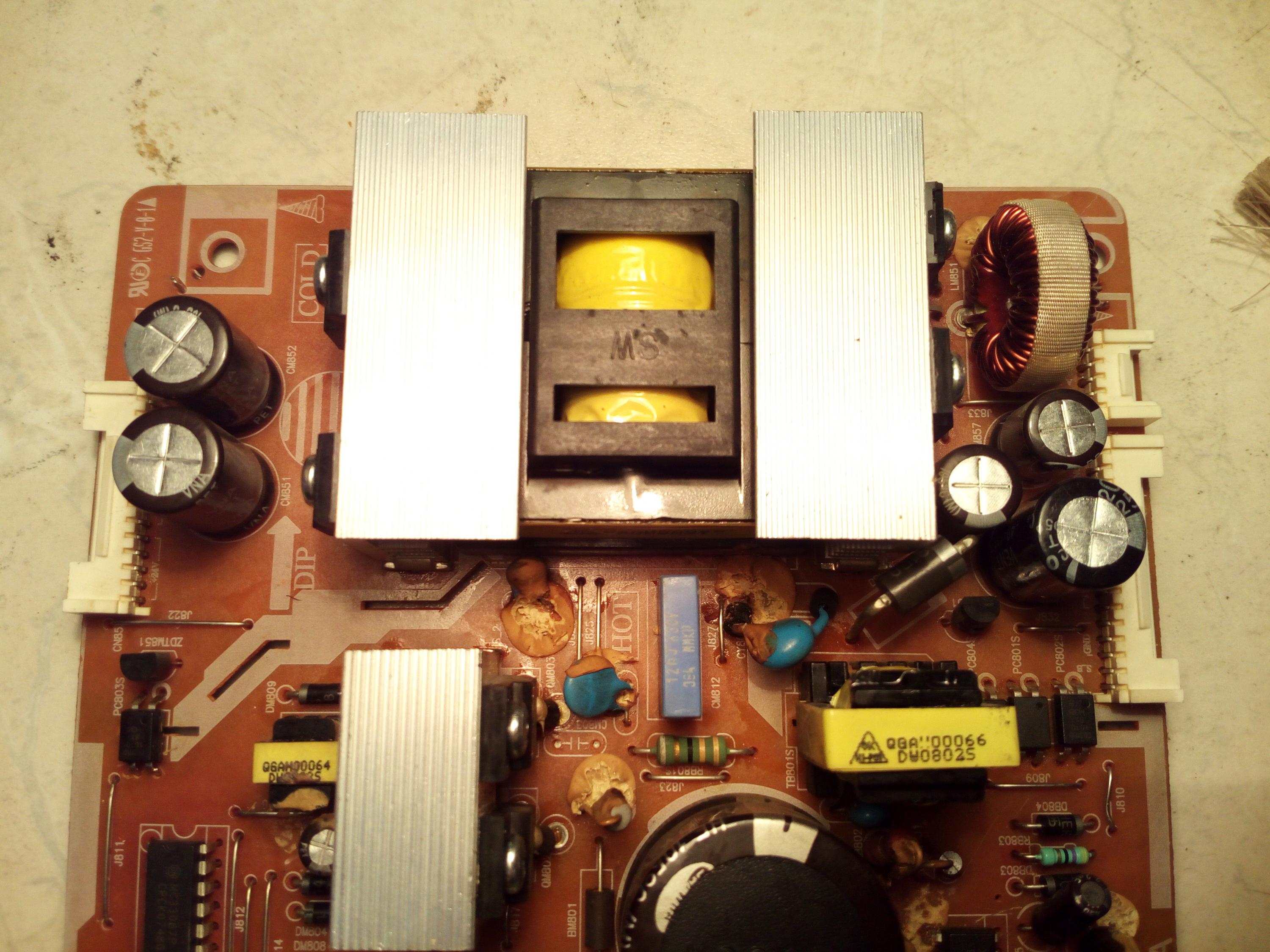

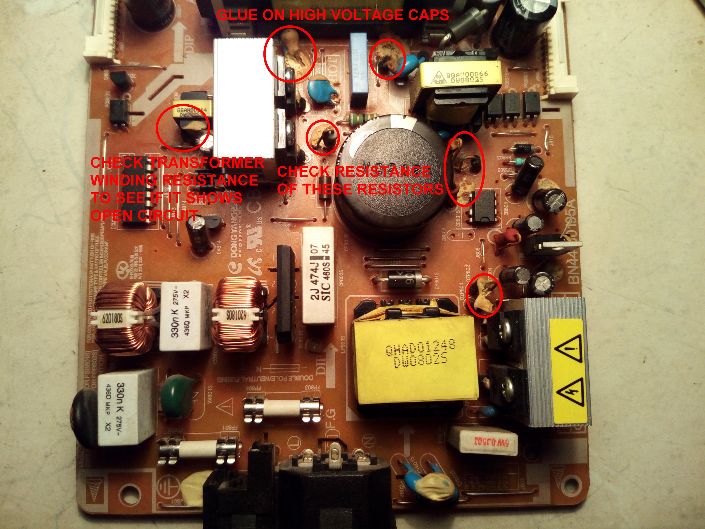

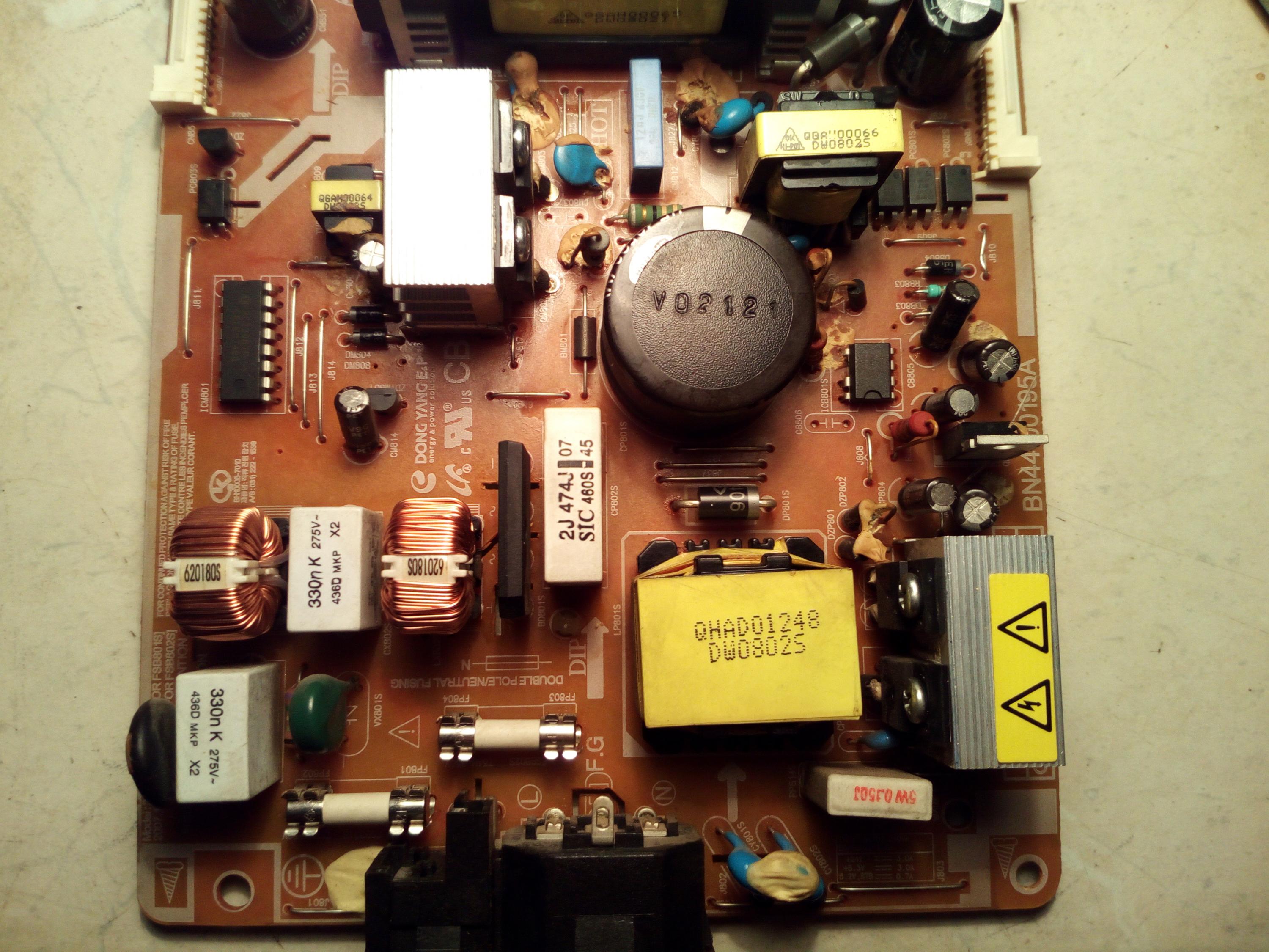

I have a samsung 2493HM Monitor which have a black screen and blinking blue led.
There is no bad caps whith cisual inspection and no burning marks on any component.
I checked 5,3V and 24V and I have no voltage in any of them
Can someone help me?
