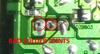

            Re: Samsung 2493HM Monitor
            https://www.badcaps.net/forum/attach...0&d=1468428226
            ICP801S is the IC, the PFC IC, QP801S, DP801S are also for the PFC.
            You have bad solder joints on the transistor QB801 which is used as the Linear regulator/switch to supply the Voltage to run the PFC ICP801S.
            BTW, you need to inspect the bottom side of the board real well for cold solder joints, as you can see, one of the leg of the QB801 cracked solder ring around the left leg.
              There is no bad joind in QB801.Maybe its something in the photo. I resolder the joints of the transistor just in case.
              What voltage should I have in DP801S or in transistor QB801?
                Report what DCV you have on all 3 legs of QB801 when PS-ON is present, make sure to use the negative leg of the main filter cap as the GND ref. for your meter because it is in the HOT side of the circuit.
