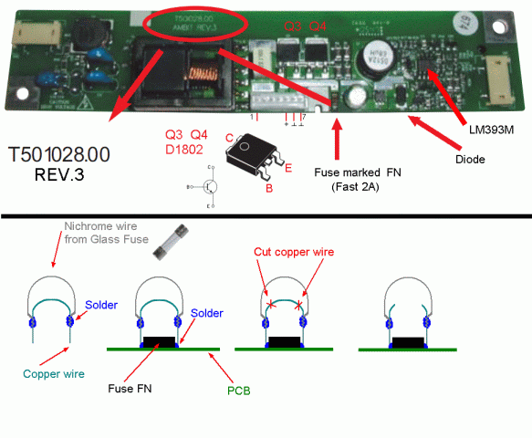

    My Dell monitor had a comum problem on this model: no backlight. The problem is in the inverter board Ambit T501028.00, in my case REV2.
    I just replace the SMD fuse "F1" near the XA connector and the LCD backs to life.
    I hope it can help some one with the same problem.

                        I've got DELL E151FPp monitor with T501028.00 REV.3 inverter, I had replaced fuse FN with a wire from glass fuse, instruction in attachment.
