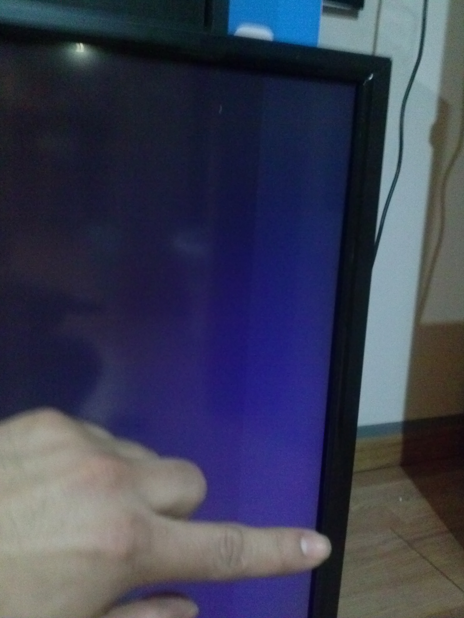

    Anyway Monitor turns on we can see the backlight in the back but screen remains black. Completely unresponsive only turns on and off. I also was able to see a faint discrepancy in blackness on the left side of the monitor. A lighter section from top to bottom and about 3 inches wide starting on the corner. (PICTURED)

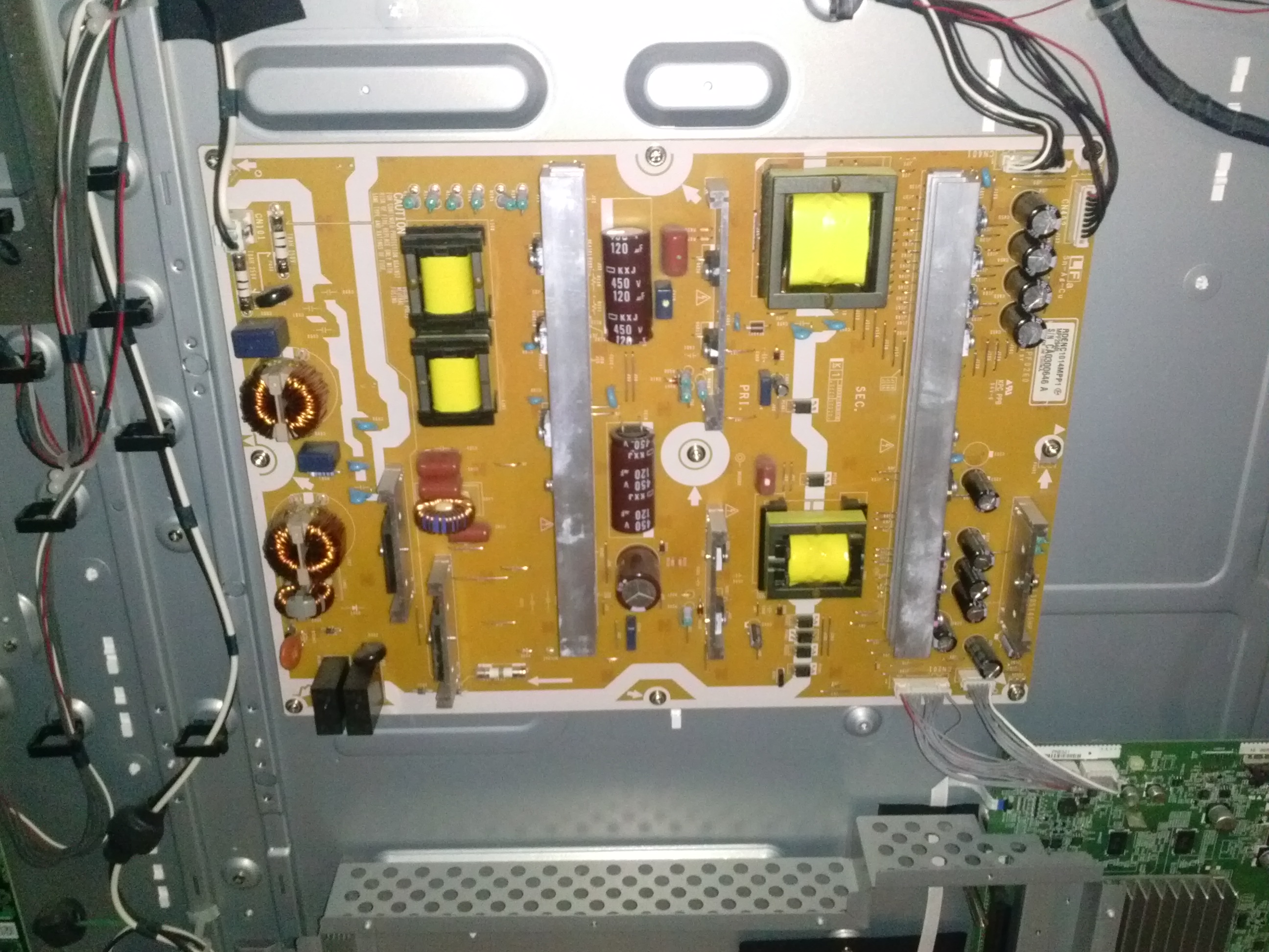

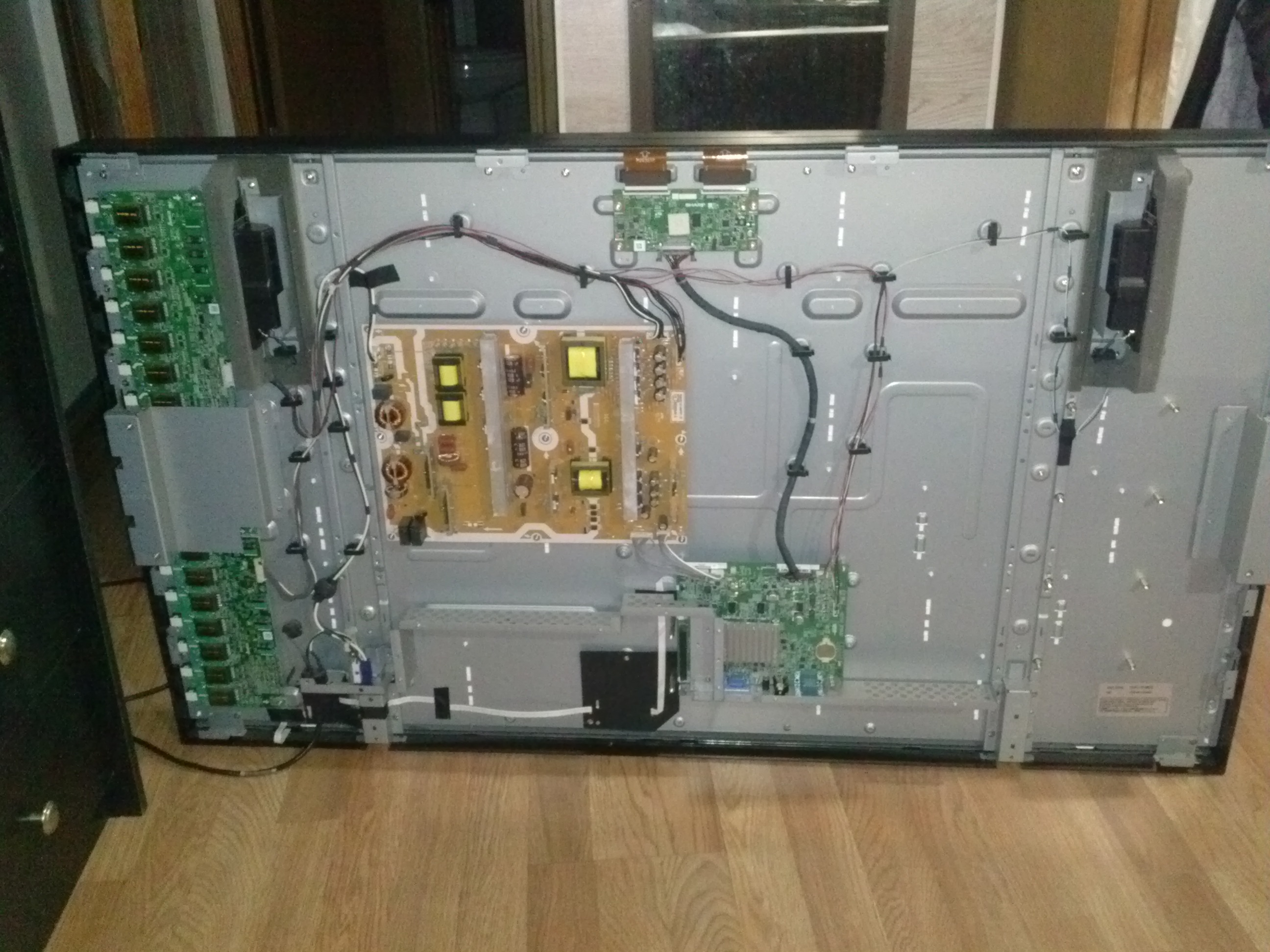

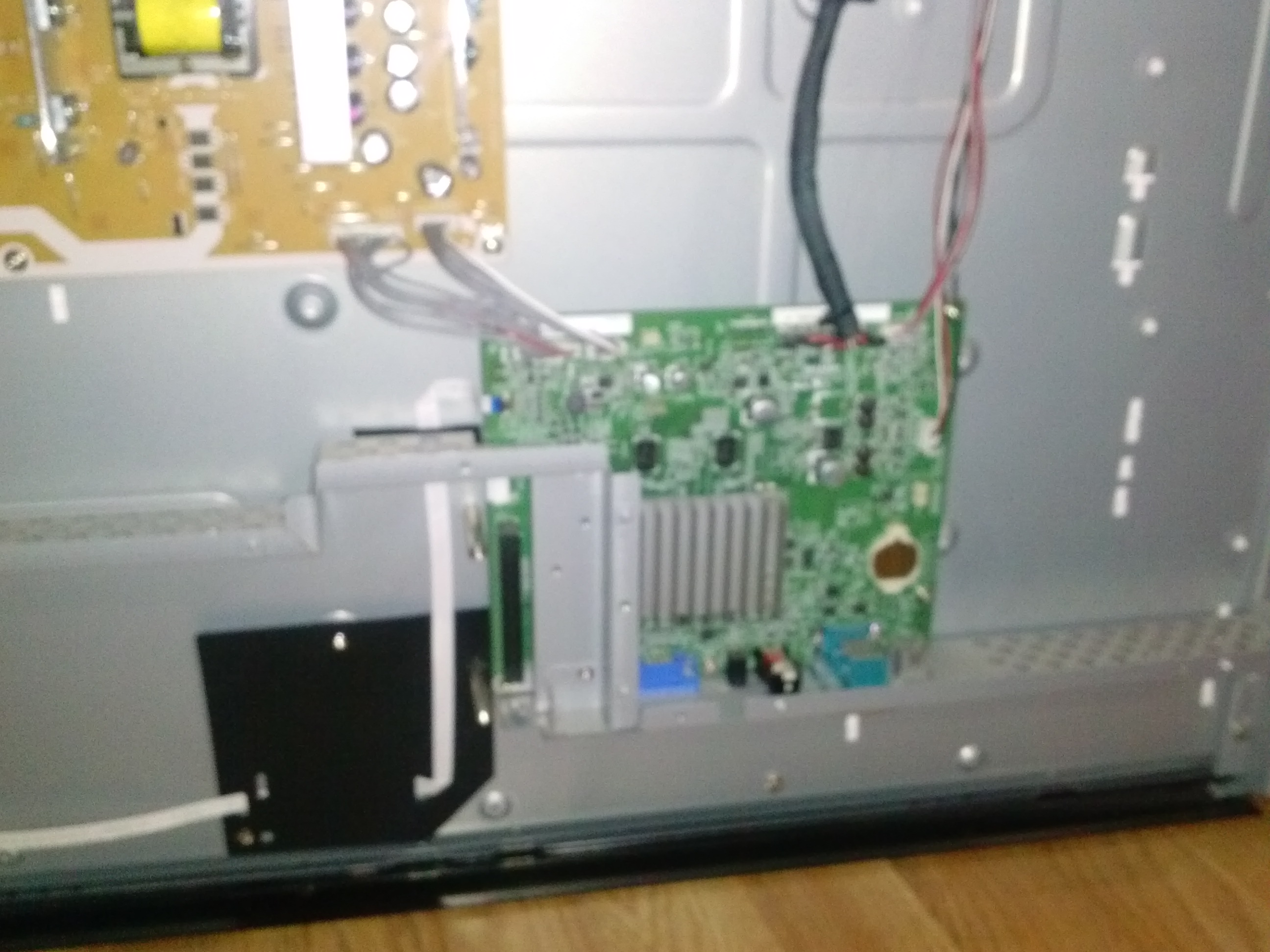

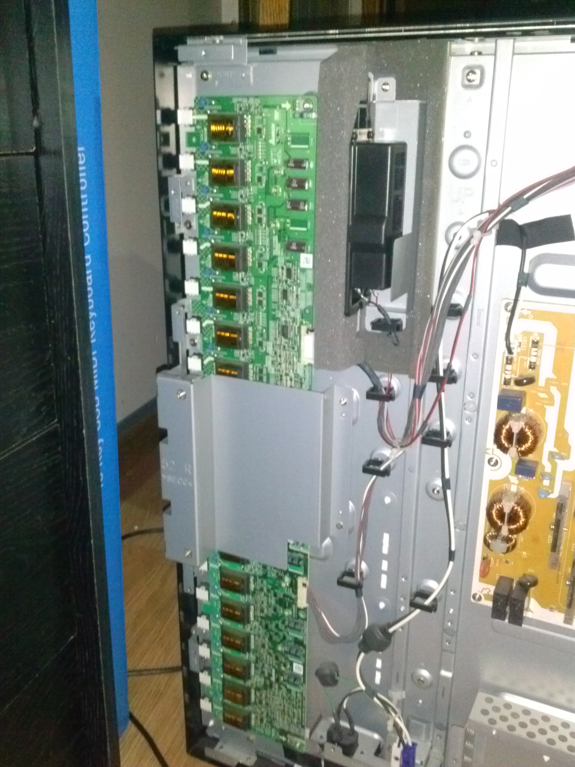

    Well I opened it right up and was quite impressed by the quality. Also never before have I removed this many screws on a screen this size.
    Unfortunately I see no visible damage and no bulging caps.

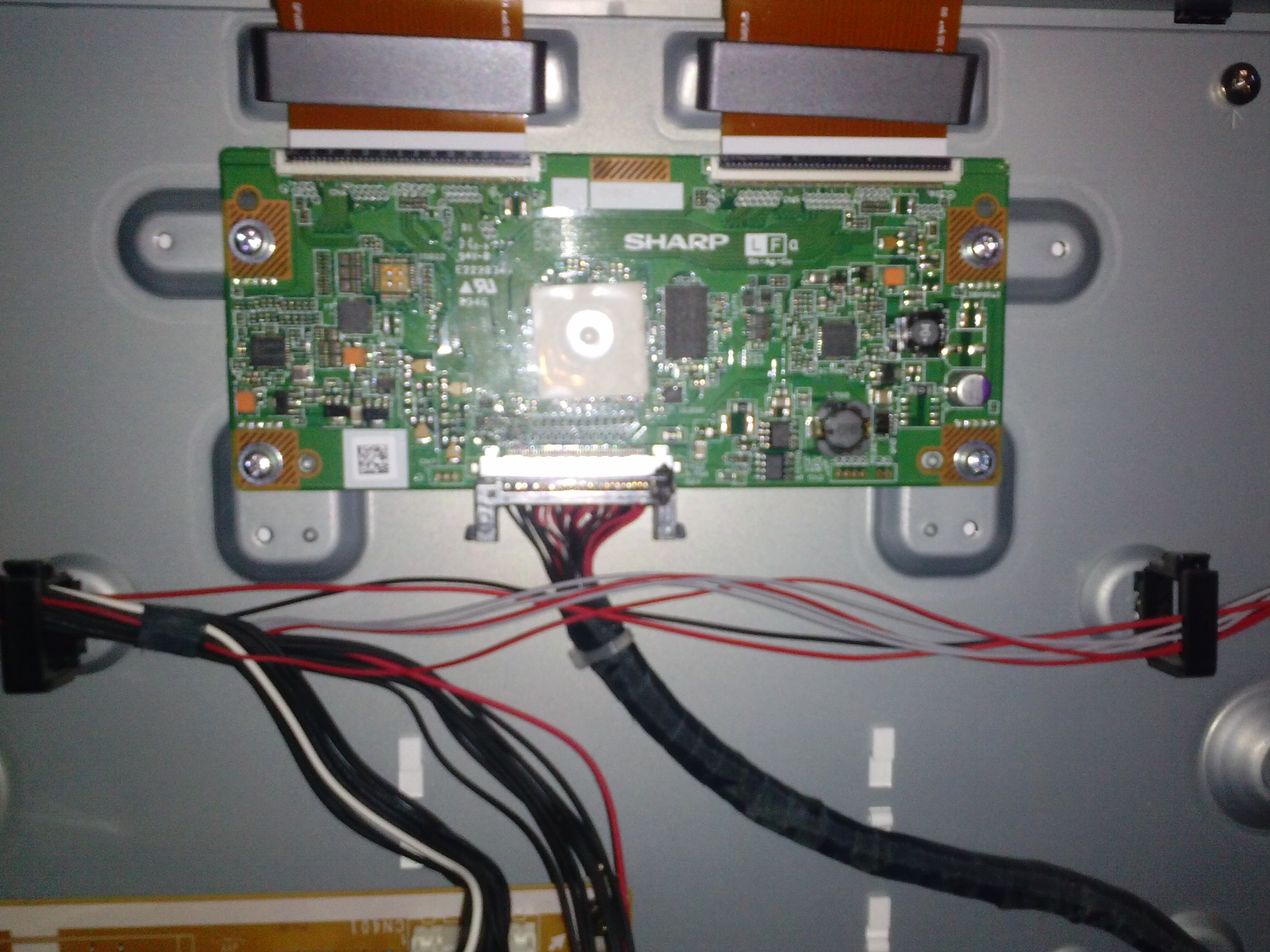

    I did went ahead and disconnected the T-con and turned it right back on.
    With the T-con disconnected the screen turns on just fine but this time it is solid black no lighter section as described above.
    Conclusion;
    I am betting on a busted T-con board. Truly hope it isn't display failure.

    Try having one ribbon cable between the T-CON and the LCD panel connected one at a time to see what you get on the screen. The SMD fuse on T-CON is good and getting 12VDC at both ends of the fuse with ref to the chassis GND?

      Hello there and thanks for your fast response.
      I tested the TV with the ribbons disconnected the closest one gave me the same line on the right the farther one gave me a full black screen. Exactly similar to what happens when the T-con is fully disconnected.
      I am also currently unable to test the SMD fuse I currently dont have a multi-meter.
      I have a close idea as to which one it is though.

        I have no recommendation for the meter, usually the one for electronics repair in the $30~50 range will be good enough for checking Voltages.
