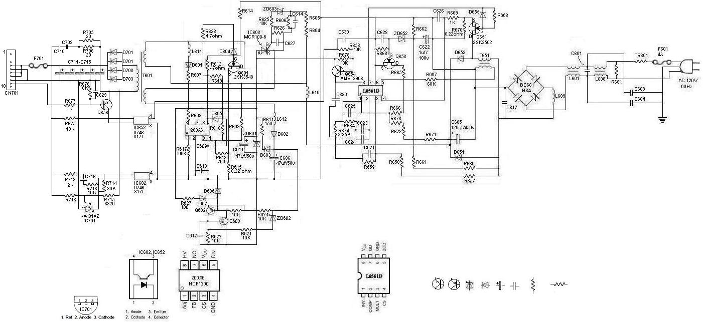

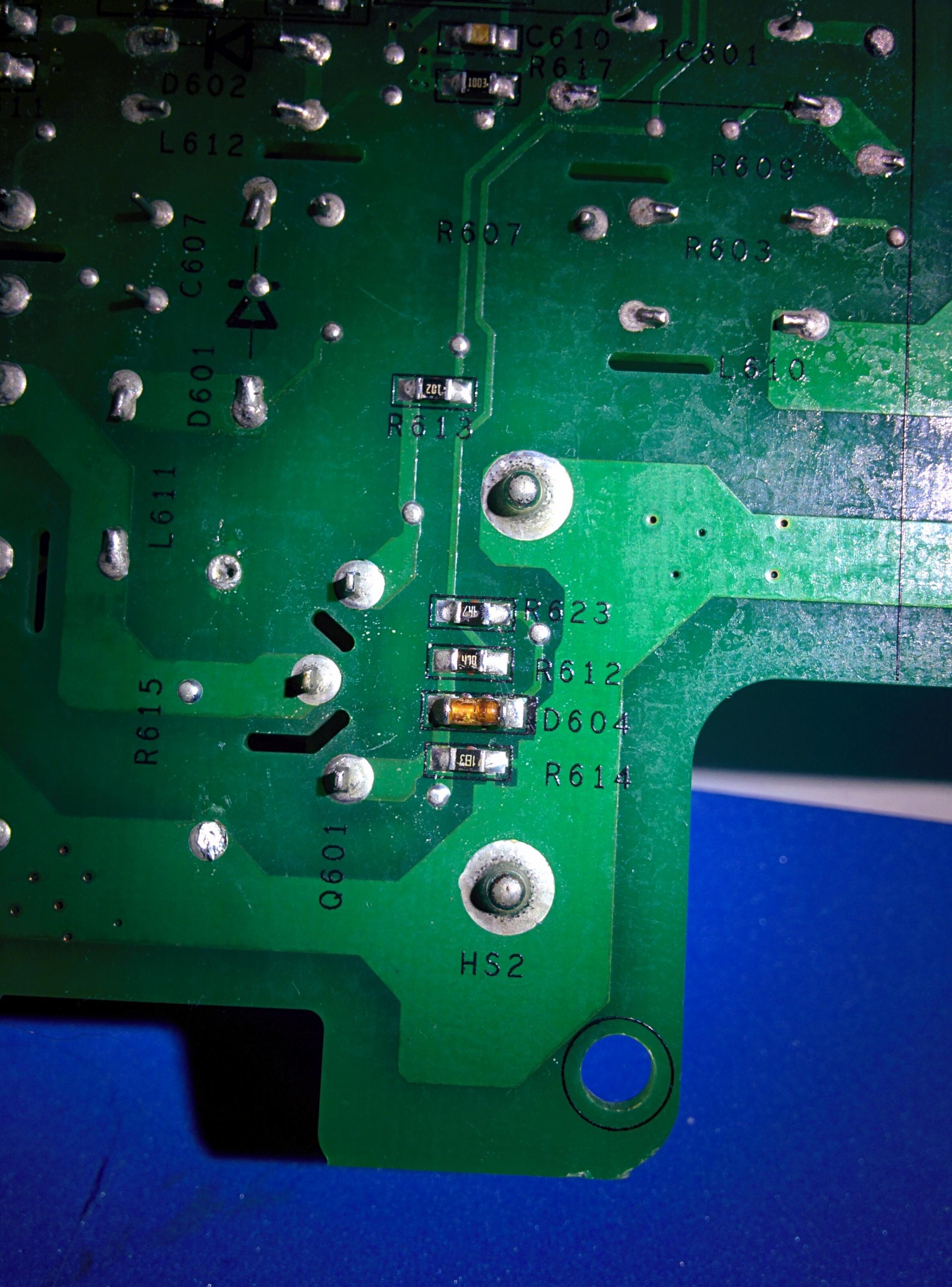

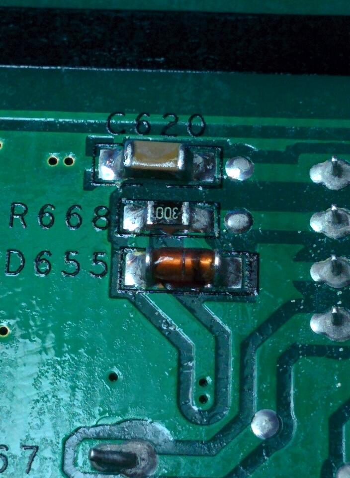

    looking for some help,
    does anyone know the value of these smd's D604, D6655, both faulty ? Are they zener diodes? I've included pictures of them

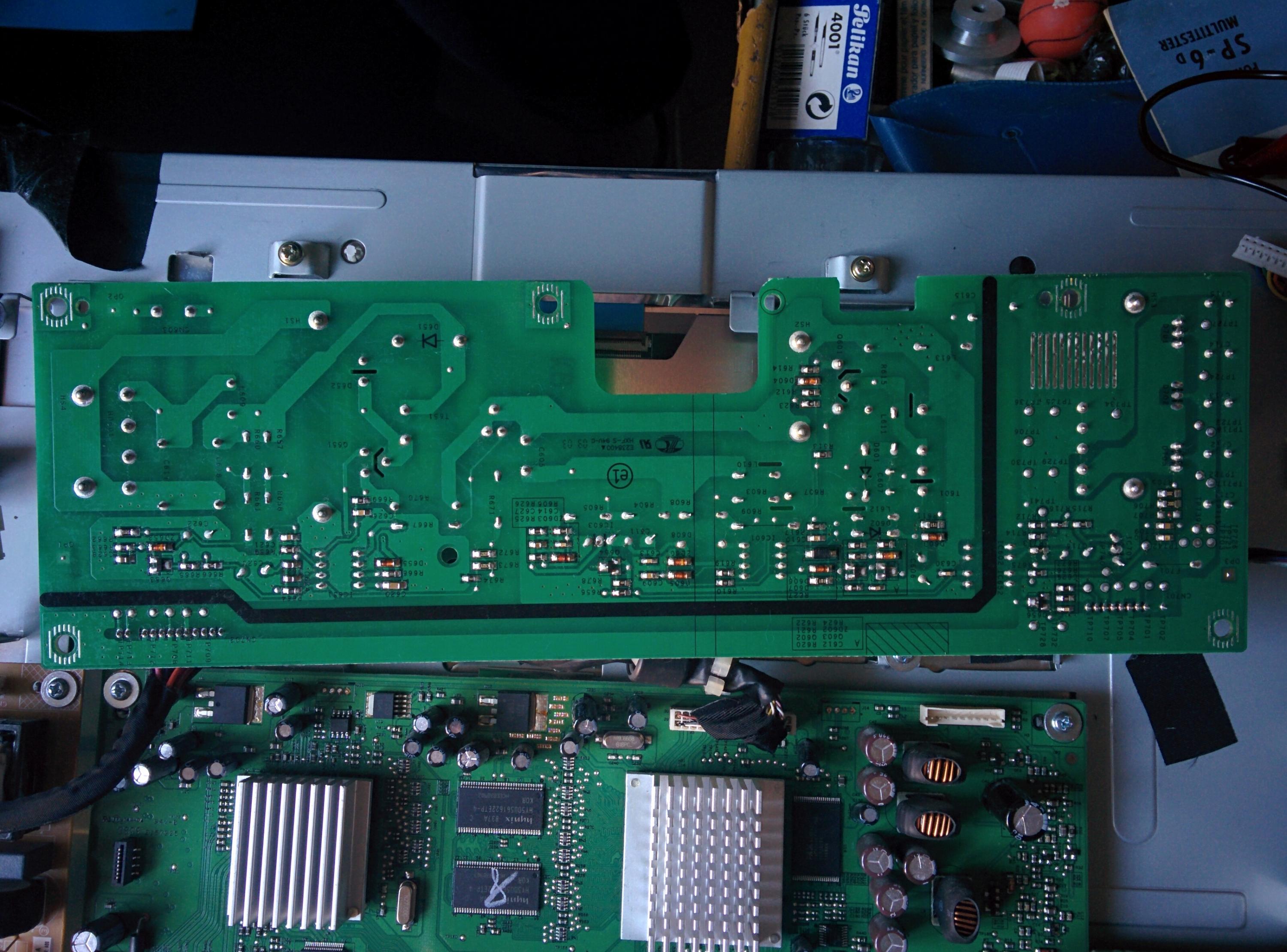

    They're mounted on the power supply board of a Dell 2408WFP.
    I was wondering also if anyone knows the values of the smd capacitors (which are unmarked)
    C709
    C710
    C629
    C630
    C610
    C609
    C613
    C614
    C627
    C620
    C626
    C624
    C623
    C621
    C628
    (many thanks bicycle6228 for the schematics).
    Many many thanks for any help as I don't have a ton of experience.

    they arent zeners, so probably a 1N4148 will work.
    • fzabkar
      • Mar 2009
      • 772
      Re: Smd diode code
      D604 and D655 are shunted by low value resistors. Are you measuring these diodes in-circuit?
      • jetadm123
        • 2169
        Re: Smd diode code
        As stj indicated, they are LL4148 diodes. These type diodes and ceramic caps almost never fail on these power supplies.
        • gipiv
          • Nov 2009
          • 12
          • Italy
          Re: Smd diode code
          Hi
          thanks to all for the replies. Very very appreciated !
          Yes I am measuring them still in-circuit (mea culpa !). I was going to remove them to test again and make sure they are okay.
          Does anyone know of a good reference for the codes of the smd capacitors I could check out to decipher the codes and perhaps complete the schematic.
          Thnaks again !
