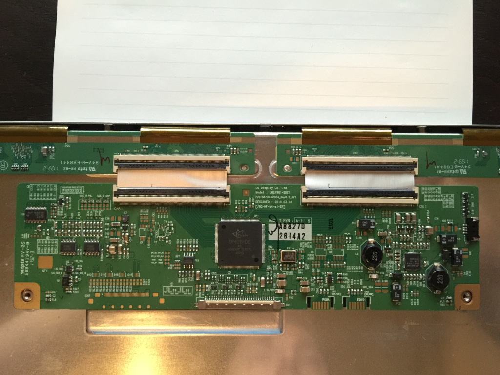

    Is this t-con issue?

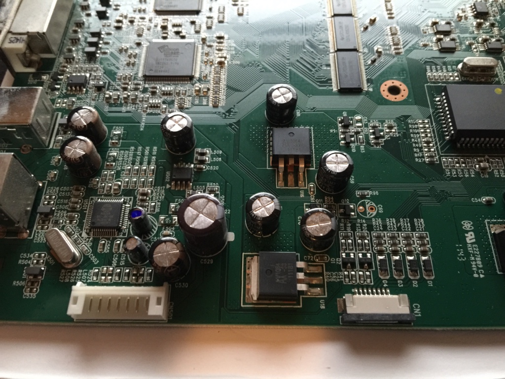

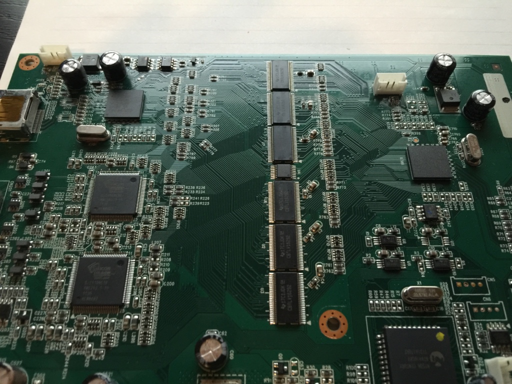

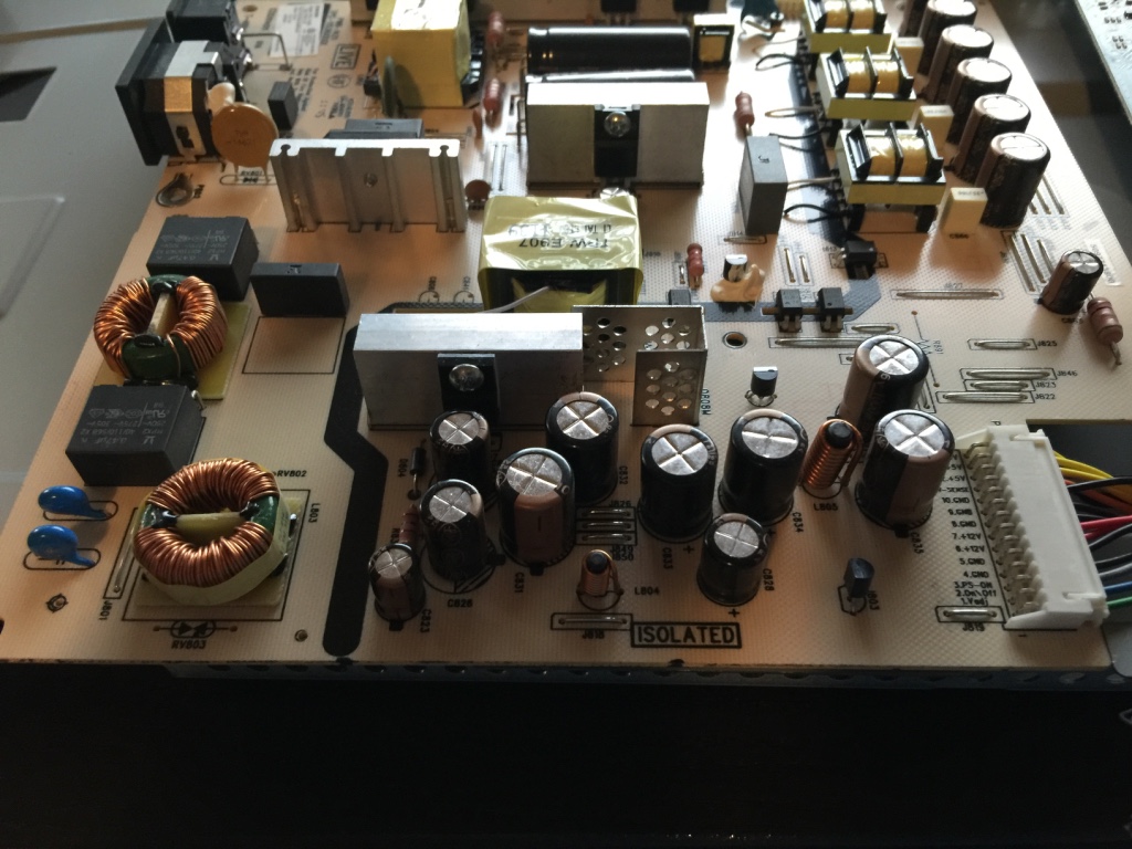

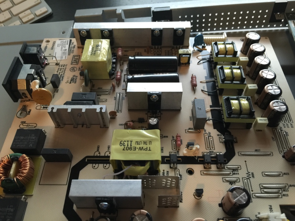

    Re: HP ZR2740w briefly show an image then turns off

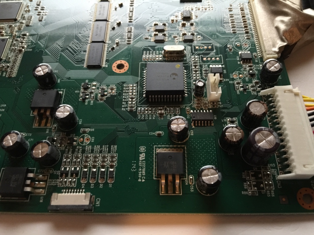

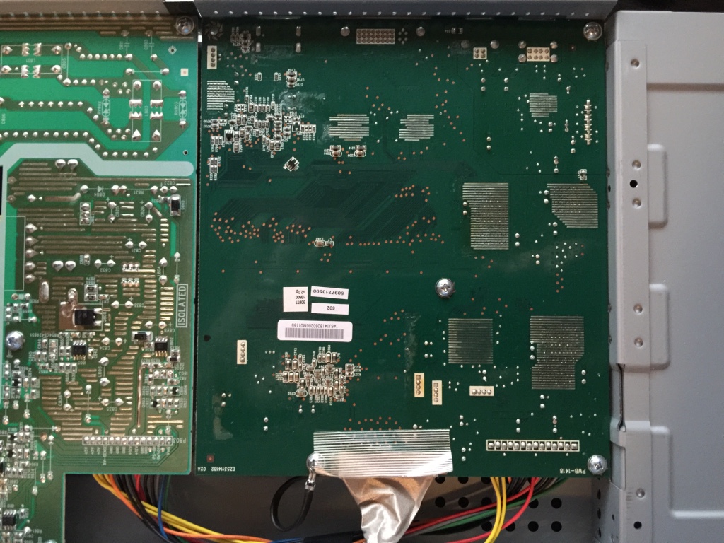

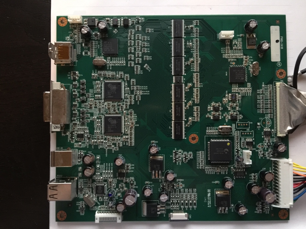

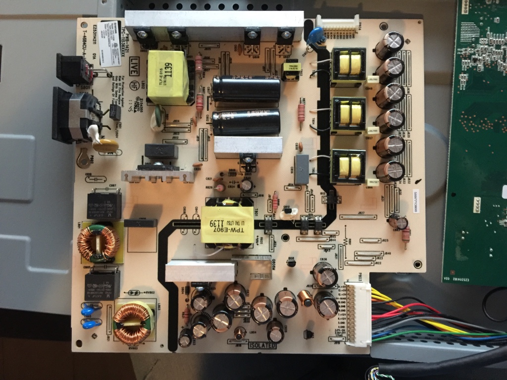

    How about showing the pictures of the boards so we can see what we are dealing with?
    • Gadgetfun
      • Jan 2016
      • 11
      • The Netherlands
      Hi Budm,
      Here are the images.

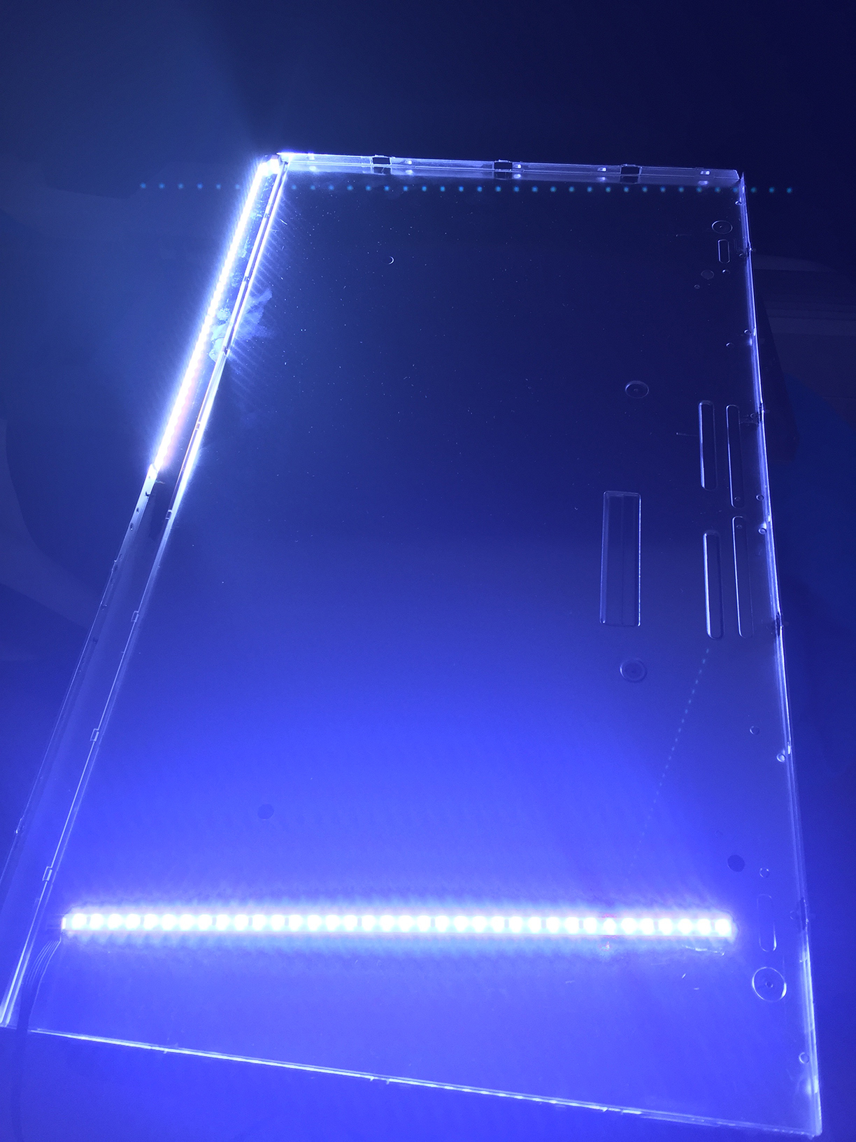

            So I need to stripdown the whole screen till I see the leds right?
              You should take Voltage measurement for each LED string first just to see what you are getting.
              Taking the LCD panel is the last thing you want to do, it is easily damaged.

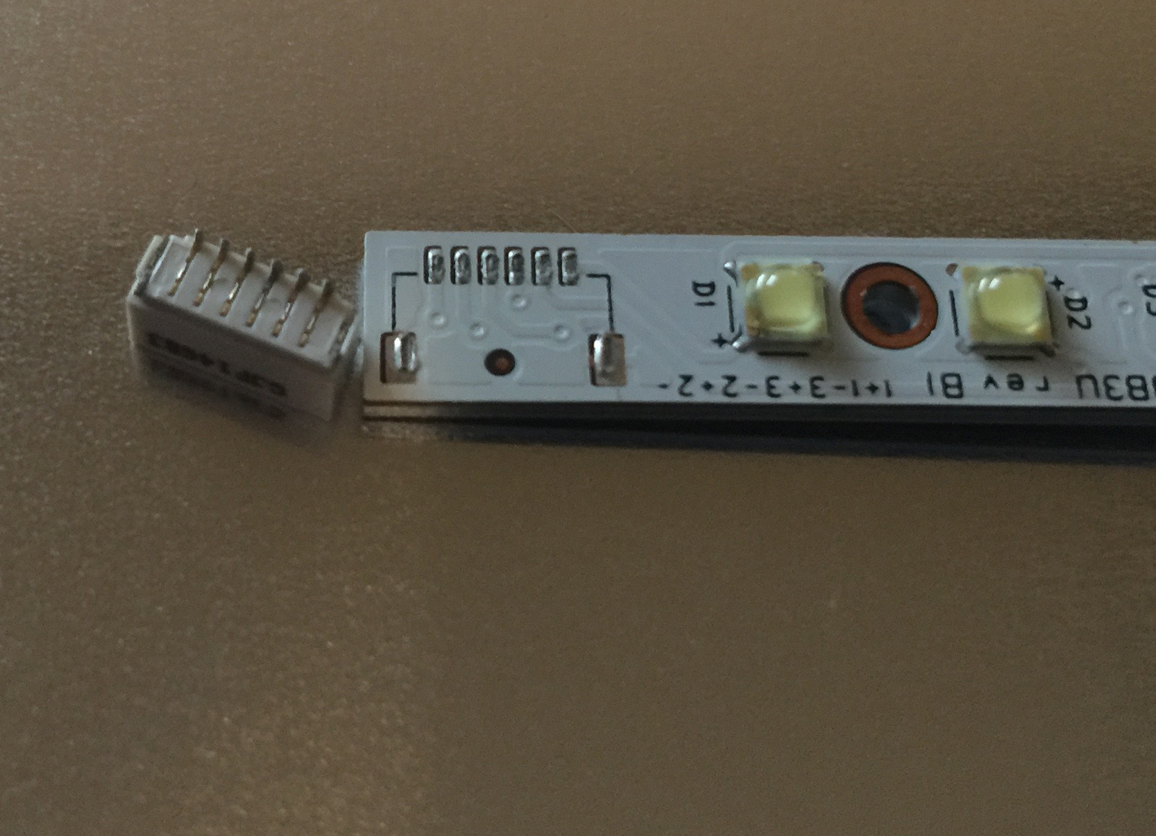

                I have dissemble everything and connected all together on the table. What happens is that there are two rows of leds at the bottom one left and one right. The Right one is not working. As you can see from the video is that for a short amount of time a image is displayed this is only from one row of leds.
                • Gadgetfun
                  • Jan 2016
                  • 11
                  • The Netherlands
                  See video demonstrating this.
                  Demo Video Leds
                    Aha lose connector.
                    • Gadgetfun
                      • Jan 2016
                      • 11
                      • The Netherlands
                      I also see that one led is broken a piece chipped off.
                        So you will have to check and see if that dead LED strip has one or more LED with open circuit or bad connection, the LEDs on the strip are connected in series so if one goes open circuit then whole strip will not light up.
                        Updated: you already found the cause of the problem.
                          Now I hope I soldered it correctly :P and the chipped led is hopefully working.
                            Woot!
                              Nice, I cannot see how that SMD connector came off the board like that.
