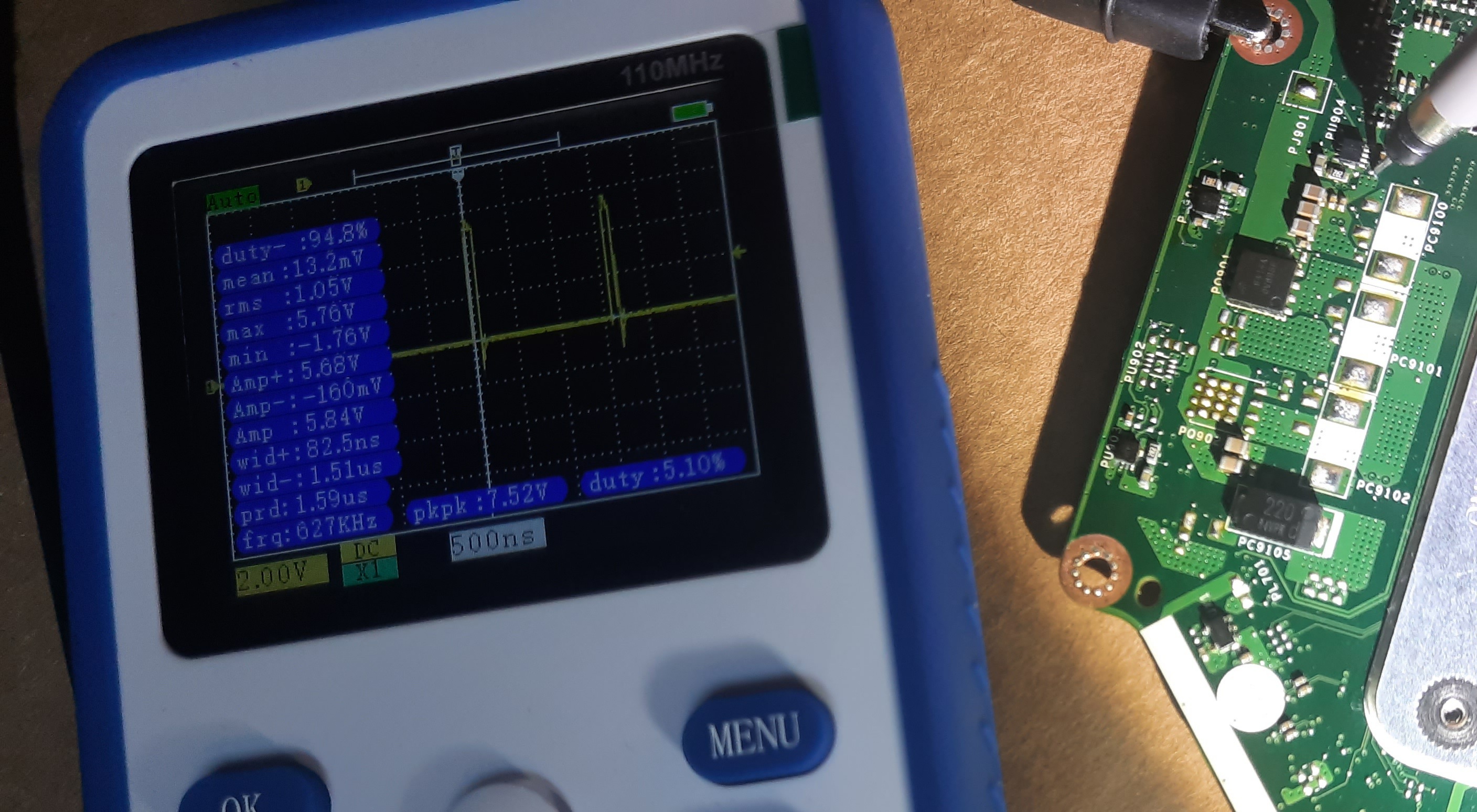

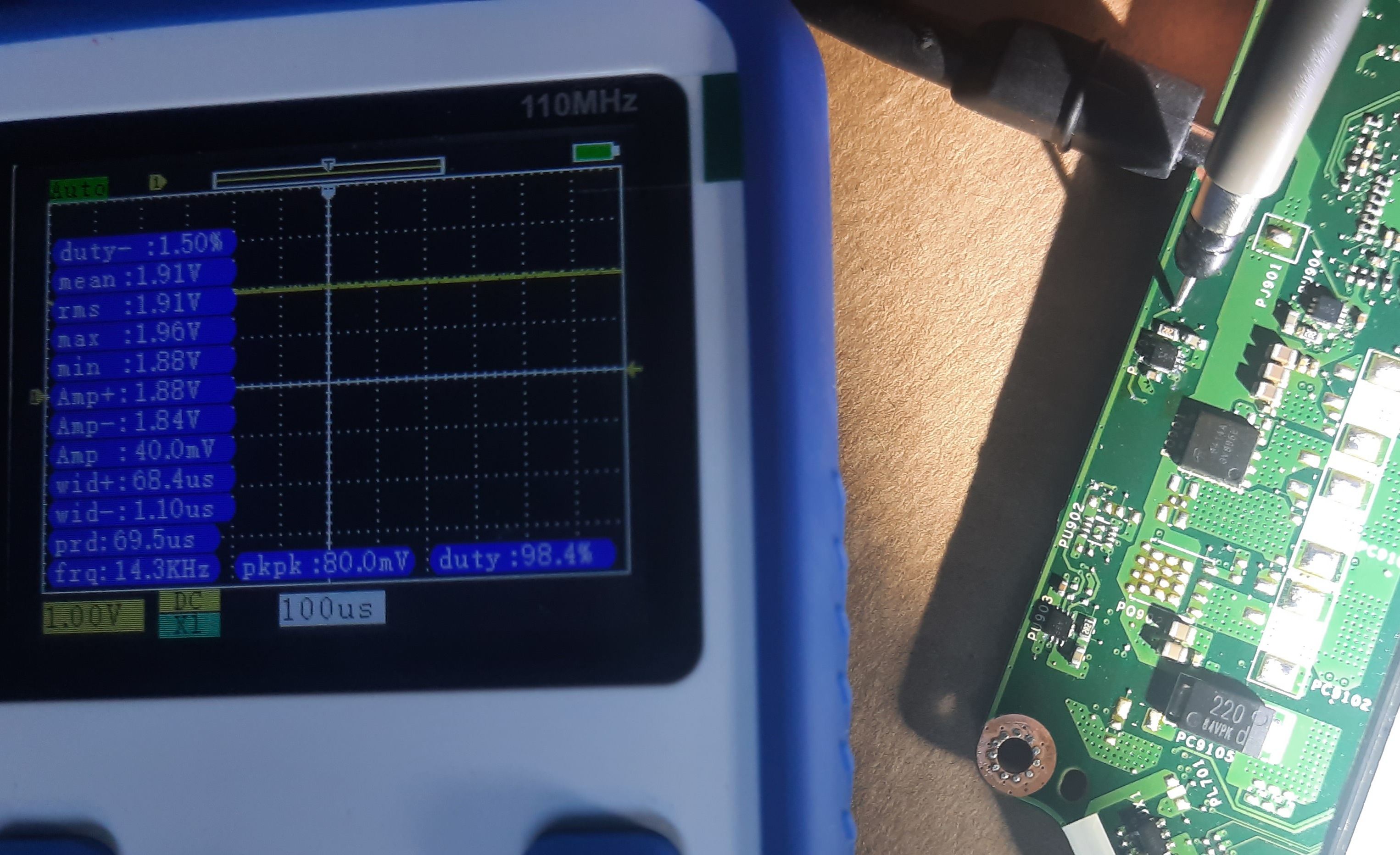

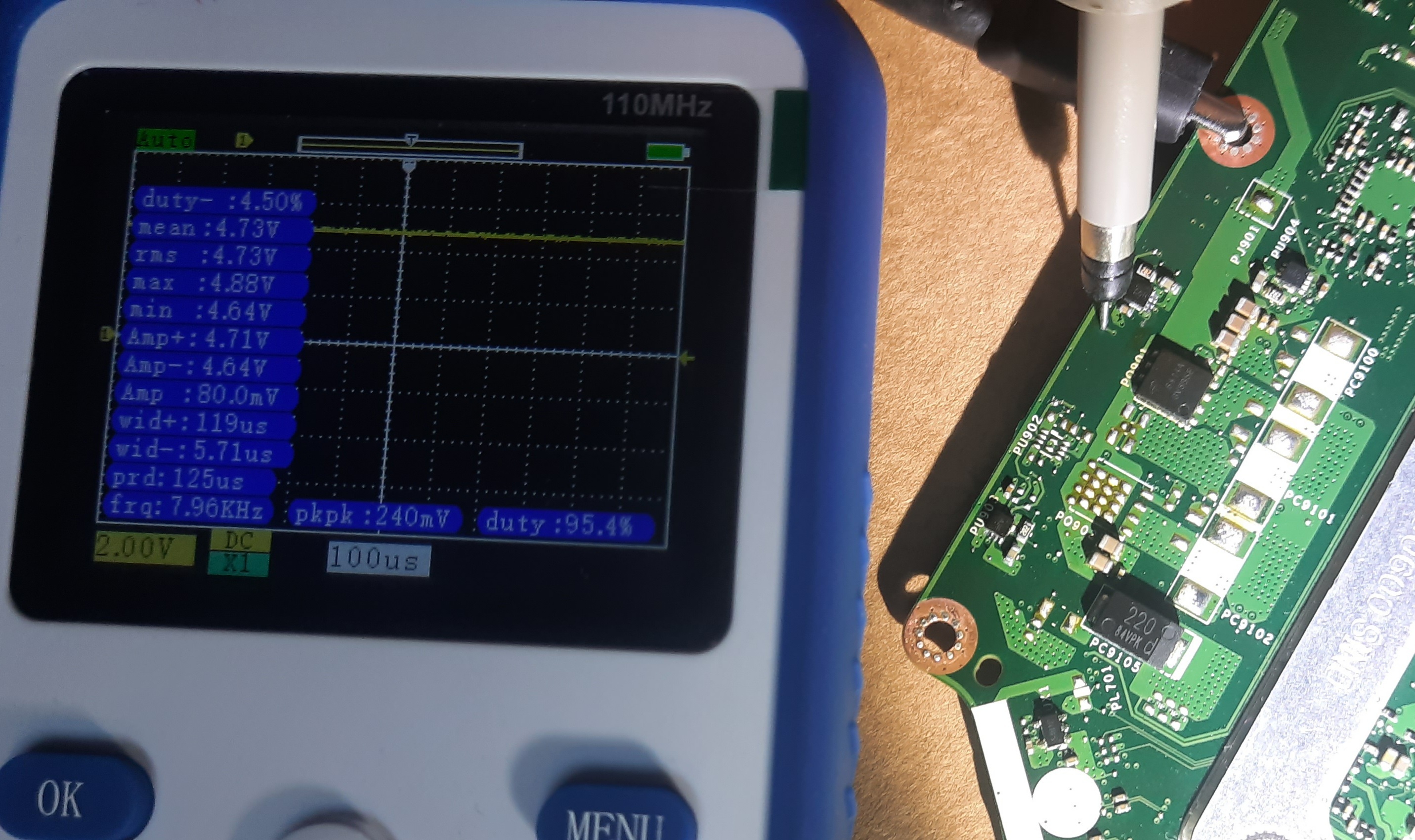

good afternoon.
need help.
ACER A315-53G C5V01 LA-E892P rev2A
the laptop turns on, but the display does not show.
the laptop came to me from another workshop. visually broken USB 3.0 and soldered BIOS flash drive.
I unsoldered USB 3.0 and flashed several different BIOSes, but it did not help.
+VCC_CORE 0V
+VCC_GT 0V
+VCC_SA 1.03V
+0.6VS_VTT 0.6V
+1.0VALW_PRIM 1.0V
+1.0V.VCCSTU 1.0V
+VCCIO 1.OV
+1.0VS_VCCSTG 1.0V
+1.2V_VDDQ 1.21V
+1.8VALW_PRIM 1.81V
+1.8VS 1.81V
+3VLP 3.27V
+3VALW 3.3V
+3VS 3.3V
+5VALW 5.18V
+5VS 3.3V
+RTCVCC 2.99V
+DDR_DRAMRST# 0.05V +AC_PRESENT 3.27V
+VGA_CORE_EN# constantly changing in range 0.3-0.5V
+VGA_CORE_PG 3.29V
+VGA_EN 3.32V
+VGA_GATE 3.30V
+PLT_RST# 0V
+PLT_RST_BUF# 0V
+PCH_PWROK 0V
+PSIS 0V
+H_CPUPWRGD 0V
+AC_ IN 3.23V
+EC_VCCST_PG 1V
+VR_ON 3.27V
+SIS_PWROK 2.23V
PL907 (+VCC_SA) 1.03V 22 Оm
PL904 (+VCC_CORE) 0V 5.5 Om
PL906 (+VCC_GT) 0V 8.5 Om
PU902 pin:
2 - 1.98V
3 - 4.97V
4 - 5.18V
7 - 0V
UC6 pin 6 - 1V
UC5 pin:
1; 2 - 1V
6; 7 - 1.81V
8; 9 - 1.81V
13; 14 - 1V
UQ1 pin:
3 - 3.27V
5 - 3.27V
1; 2; 4 - 5.18V
6; 7 - 3.3V
8; 9 - 3.3V
10 - 10.73V
12 - 11.18V
13; 14 - 5.18V
schematic and boardview links
https://www.badcaps.net/forum/troubl...-a517-la-e892p
https://www.badcaps.net/forum/troubl...ic?t=123072
