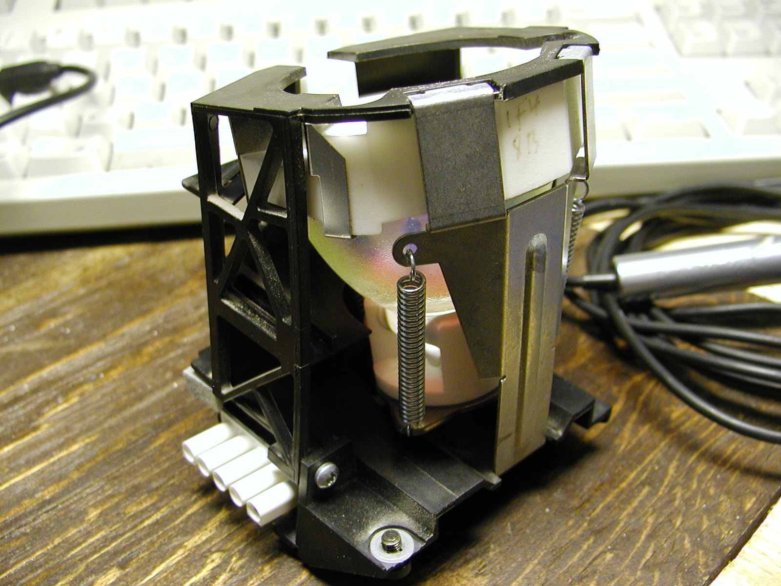

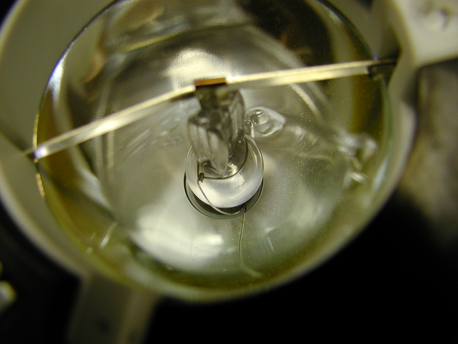

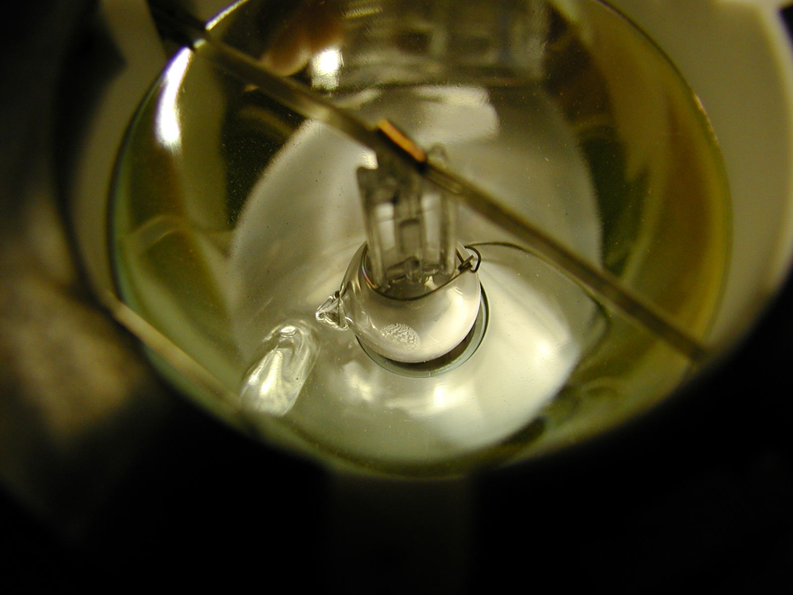

    This thing worked perfectly when I put it away a few months back.
    I tried to use it today and while the fan does come on the bulb never lights up
    I removed the bulb and looked at it and visually I saw nothing wrong with it.
    It only had 200 hours of use. do these bulbs die silently?

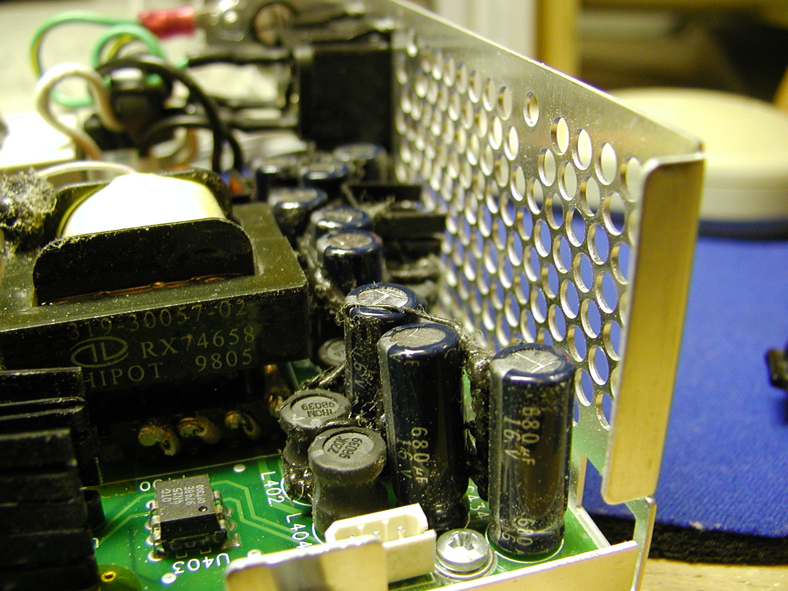

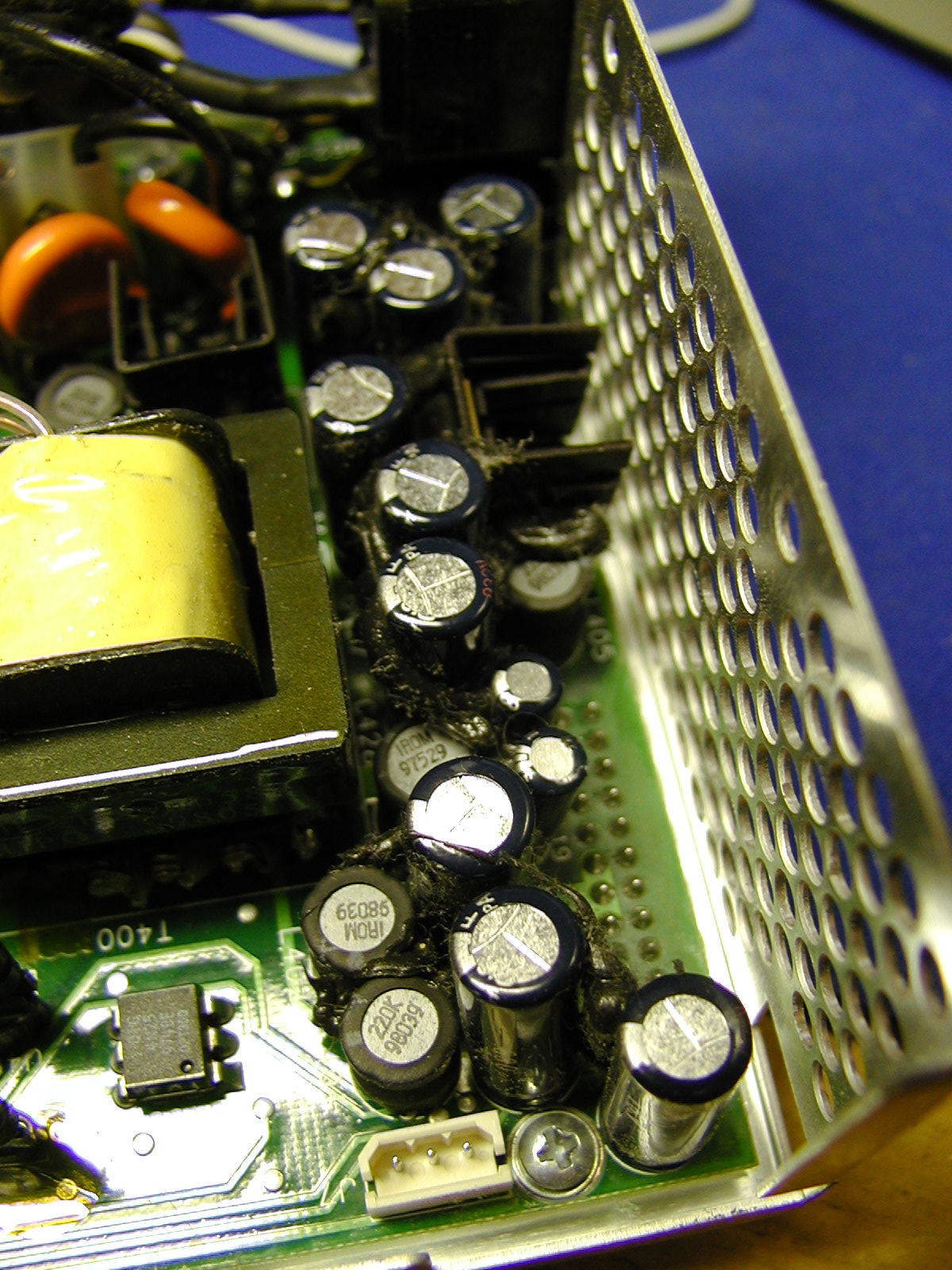

              Son of a bitch!
              Why the hell did they have to make it so that access to the PSU required removal of almost all the insides?
              Anyways, I have never been good at identifying caps. How are these?

                Re: InFocus LP425 won't light.
                Originally posted by pentium
                Son of a bitch!
                To be sure you void any warranty.
                Blue with grey signs and T vents ... they apparently seem Panasonic FJ because remember a lot yanz ones.
                Look for the Matshita M on them.

                  I see a silver M in a silver square.
                    So they're Panasonic. Still unsure about the series, but FJ are almost identical (color, font, vents): wait for KC8 or Pcbonez confirm though.

                      They look more like FC, FM or the FF ones I have here. The FJs that I have here have got a black sleeve with gold writing.

                        blue/silver i have seen on panasonics were hfq
                        these are not likely to be your problem.
                        logic or lamp driver/ignitor issue.

                            Most likely FFs, which are inexpensive silver-striped (not as low ESR as the gold-striped FJ) Pannies, widely available in Asia. They haven't bulged, so you can try replacing them with FC/FM/FK/FJ only if visual inspection reveals no other obvious problems.

                              Well the tops look pretty flat but I don't know if the bottoms have failed as that black rubber glue has done a great job of pushing the caps around.

                                Those caps are Panasonics I highly doubt that they have failed.

                                    Well the bulb looks just fine I know first hand what a cracked and burst one looks like.
                                    I had quite a few projectors where the original owner didn't know they had to clean out the filters on the bulb casings on the DLPs.
                                    What were the estimated hours on the bulb when you powered it up last?
                                    It may be possible that the projector isn't powering up because the maximum hours on the bulb were exceeded. It does this to prevent bulb bursting.

                                      The bulb was like 215 hours old.
