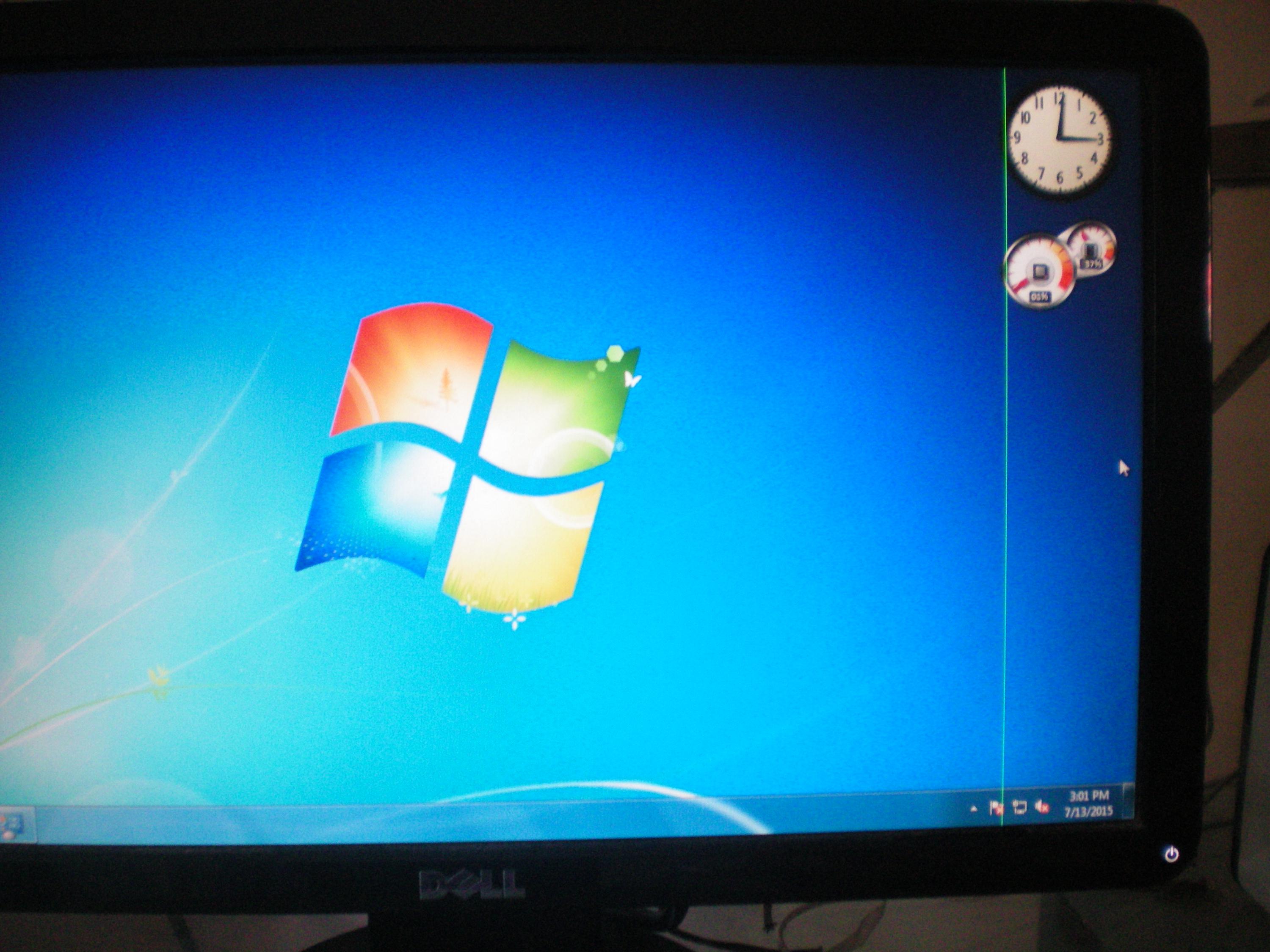

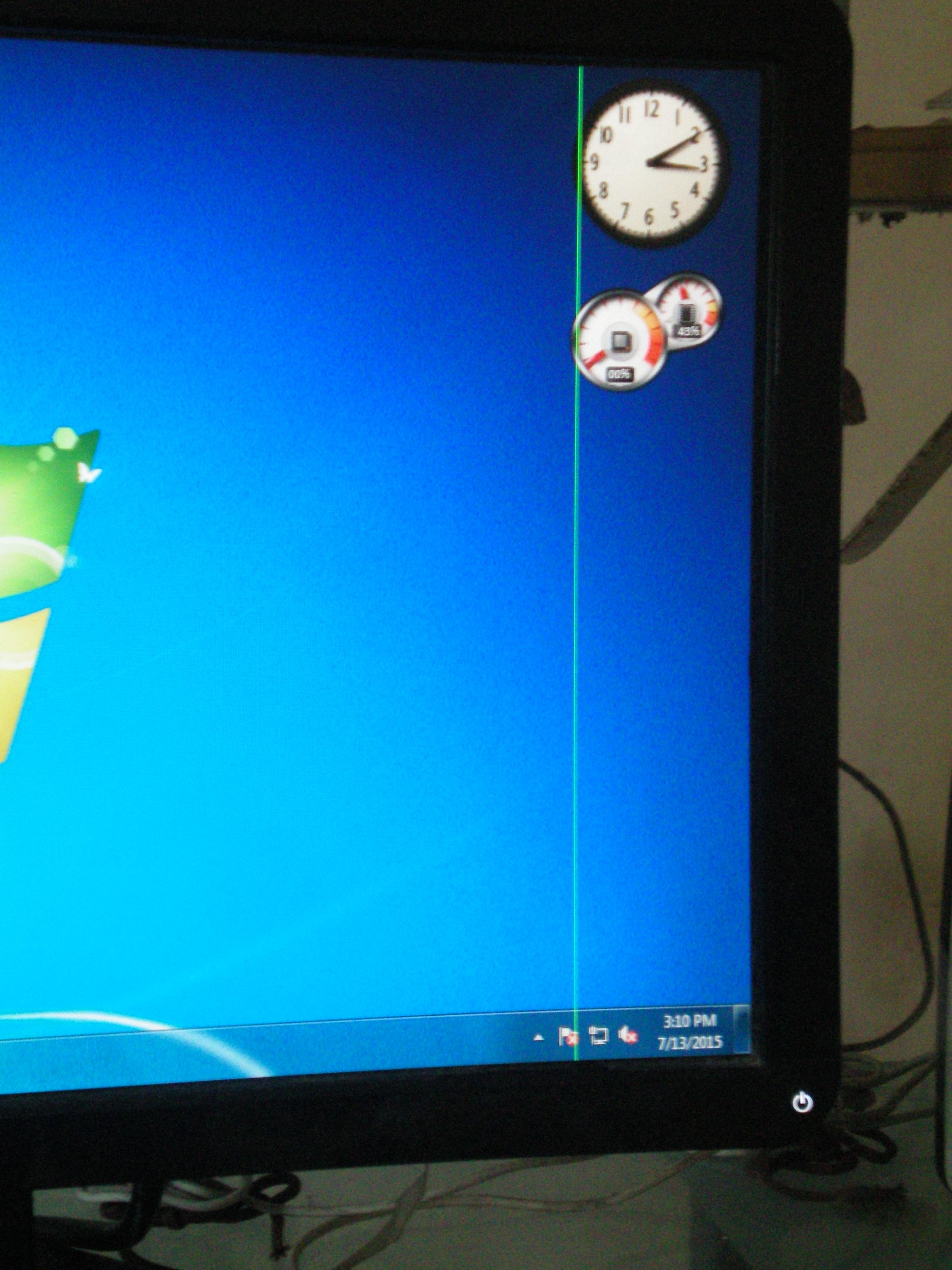

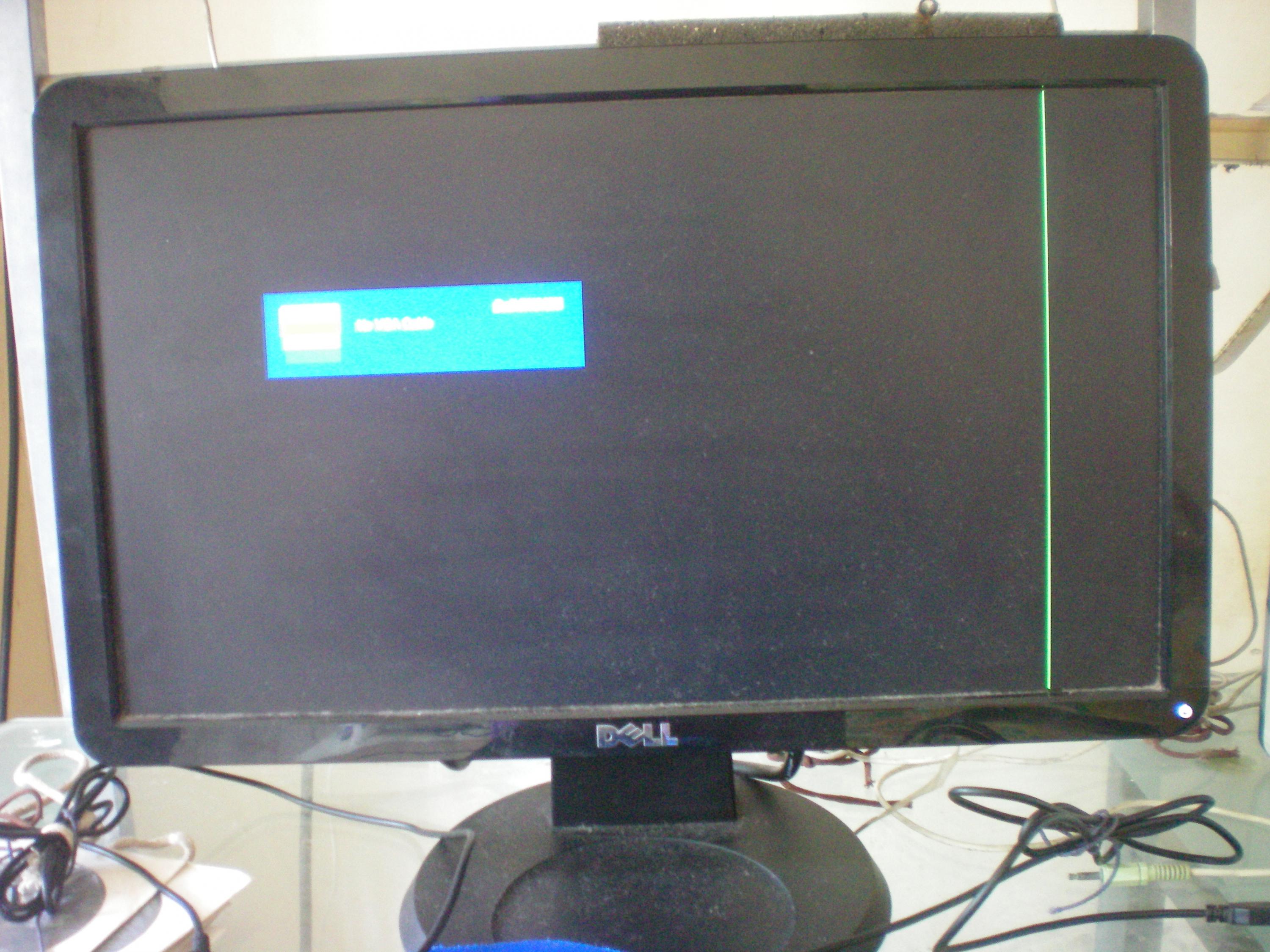

    I am getting a green vertical line on right side of Dell IN1910N flat panel monitor. It started suddenly a few days ago when I was using the computer now it just does not seem to go away. The line is there on the booth screen and continues to be there on Windows. The line is also there when the screen is not receiving a VGA signal. Is there any way I can get rid of this green line.

                      Here are the images please have a look.
                      • diif
                        • Feb 2014
                        • 6978
                        • England
                        Re: Green vertical line on right side of Dell IN1910N flat panel monitor
                        Yes, that does look like a tab issue. it depends on the design as to whether you can do anything about it but i'm suspecting not.
