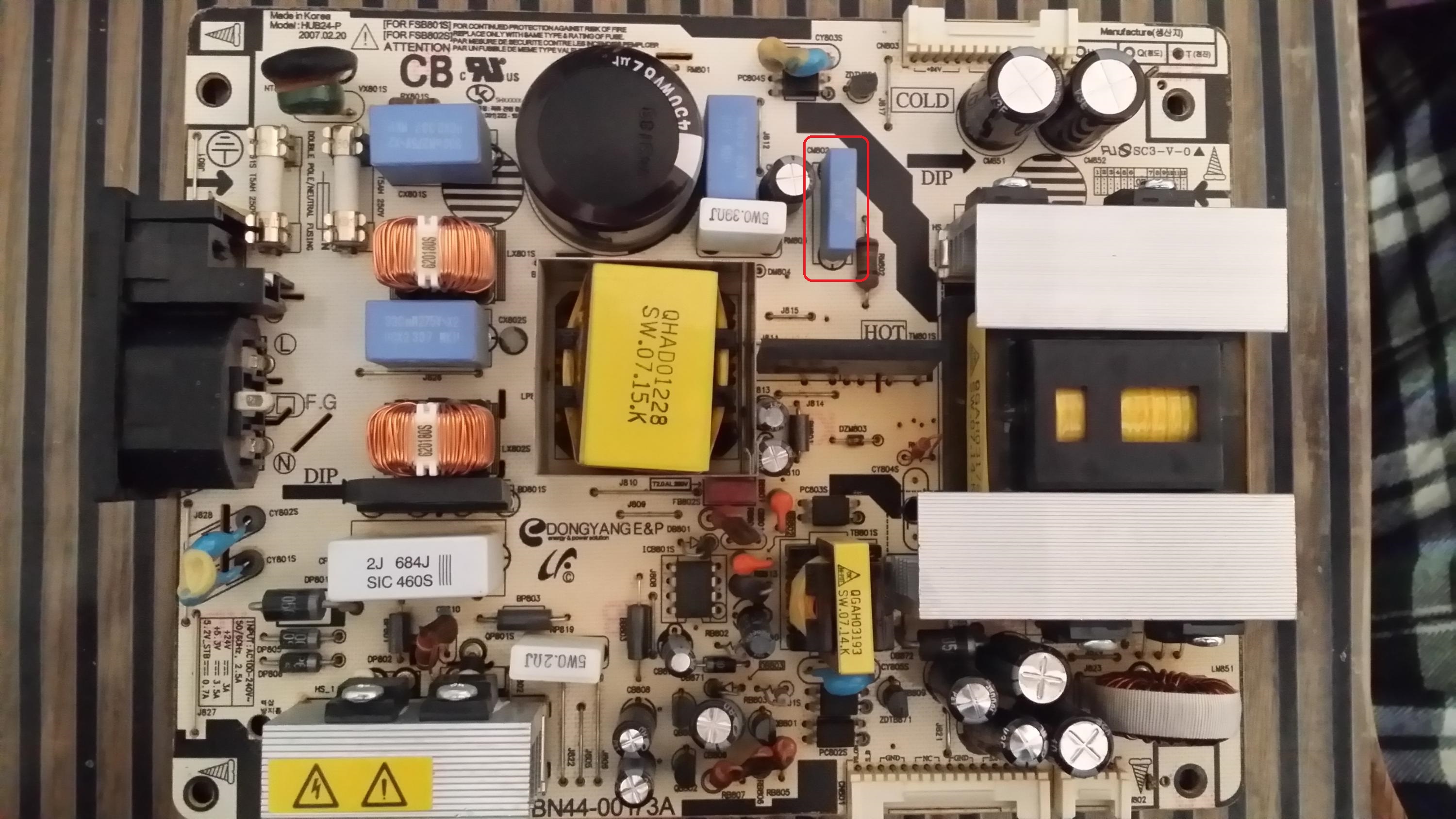

    Heya Badcaps!
    Fixed my last BW245 with the help of this forum, but now its been a few years and the second of my three BW245's has died, last one i fixed after some help with a full round of cap/resistor replacements on the power board... its been SO long and with no practice i dont remember how to do some of the tests and this one has different problems than my last...
    At the moment the monitor only turns on randomly like once a month or less, if i turn it off while its hot i can sometimes get it to turn right back on but the only times ive tried that was because it was Flickering so badly i could not even ignore it without an image on it, bright images flickered more obviously...
    So im assuming i have a problem with the power board lol -- i guess it could be with the lights/inverter board....
    68 ohm resistors tested as 67.1 67.2 67.7 ...tho ill replace them anyways with other parts
    the double white tube fuses on power board and the fuse on inverter started around 057 down to 001-000 with continuity test...
    That is as far as ive gone with the project, two of the SamWha Caps (CB809 & CB876) are seemingly bulging at the top, slight slant upwards, the same two that were bulging on the last 245bw that selldoor basically fixed with my hands lol... so i dont know if thats normal bulge or not but when i said that last time i was reminded that no bulge is normal so i guess those could be a problem but no ESR meter....
    Also yes, i just cleaned off the gunk/glue -- if i chipped a bit of the resistor's color off and can see the silver inside a little is that piece now bad? lil about mm sq piece broke off...

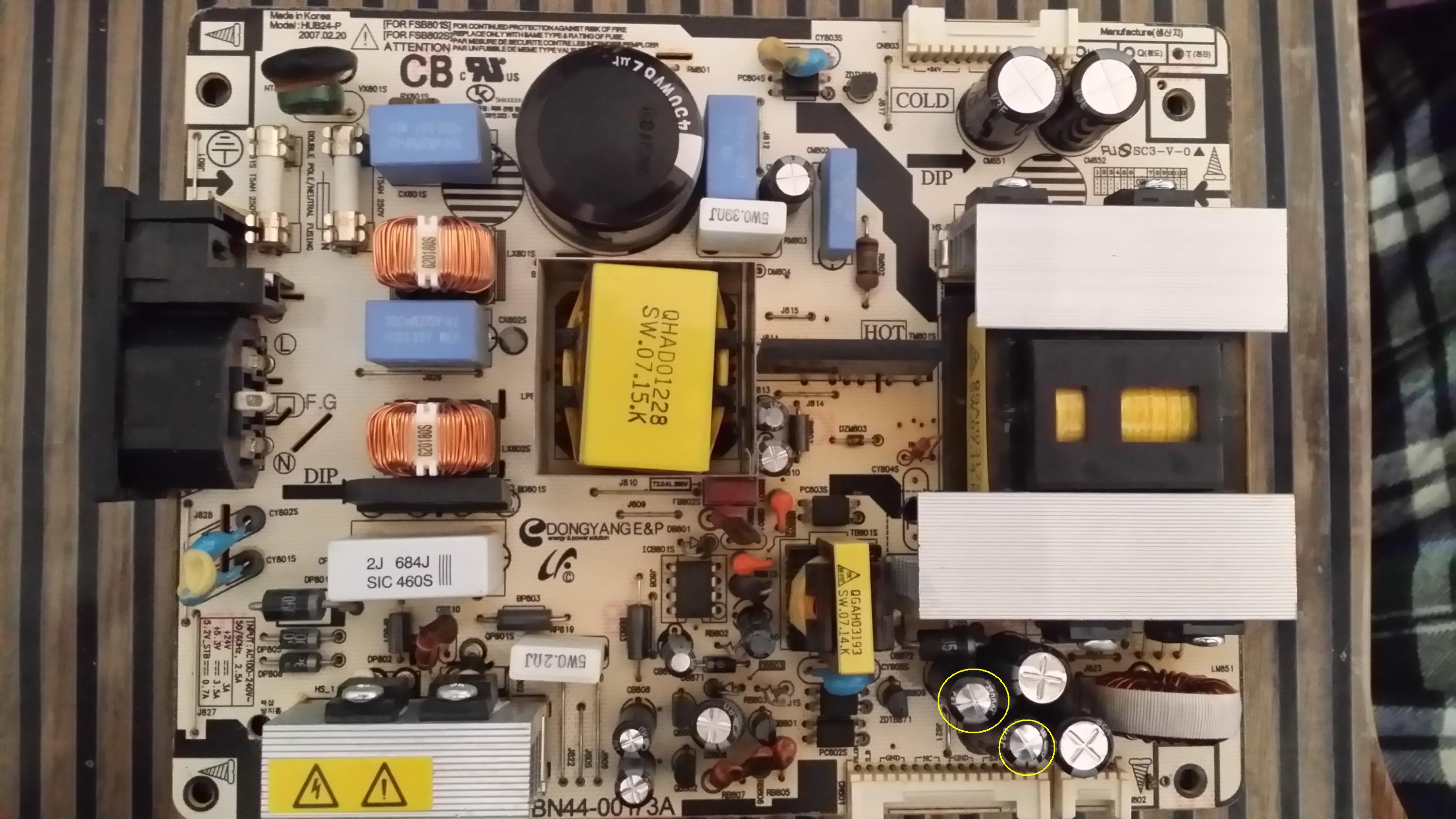

    I would start by replacing these 2 caps. they both look bulged. and are most likley bad.

      Yea thats CB809 and CB876 i mentioned bulging above.... Is it likely that those caps could be the cause of a flicker screen? i plan to replace all the caps and resistors but i guess i wanted to know if that would be a likely cause with the symptoms i mentioned or if it is likely to be something like the bulbs or maybe one of the other boards?

        Those 2 caps could definitely cause a flicker. Especially the symptom "if i turn it off while its hot i can sometimes get it to turn right back on" because even bad caps have a lower ESR when they are warm.

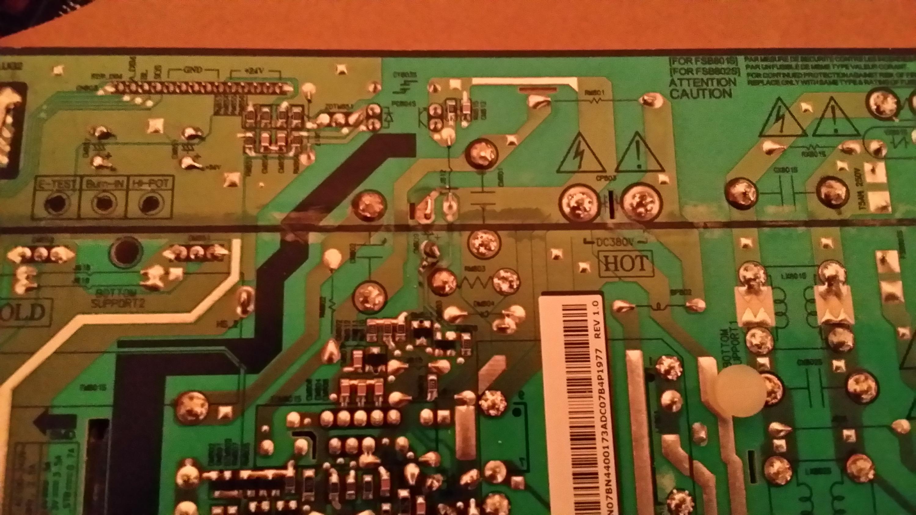

              Re: Samsung Syncmaster BW245 - Flickers when on, normally wont turn on, no blue light
              "68 ohm resistors tested as 67.1 67.2 67.7 ...tho ill replace them anyways with other parts"
              Resistors are fine, the bad one will show open circuit or very high resistance.
              Check the capacitance of the cap in red.

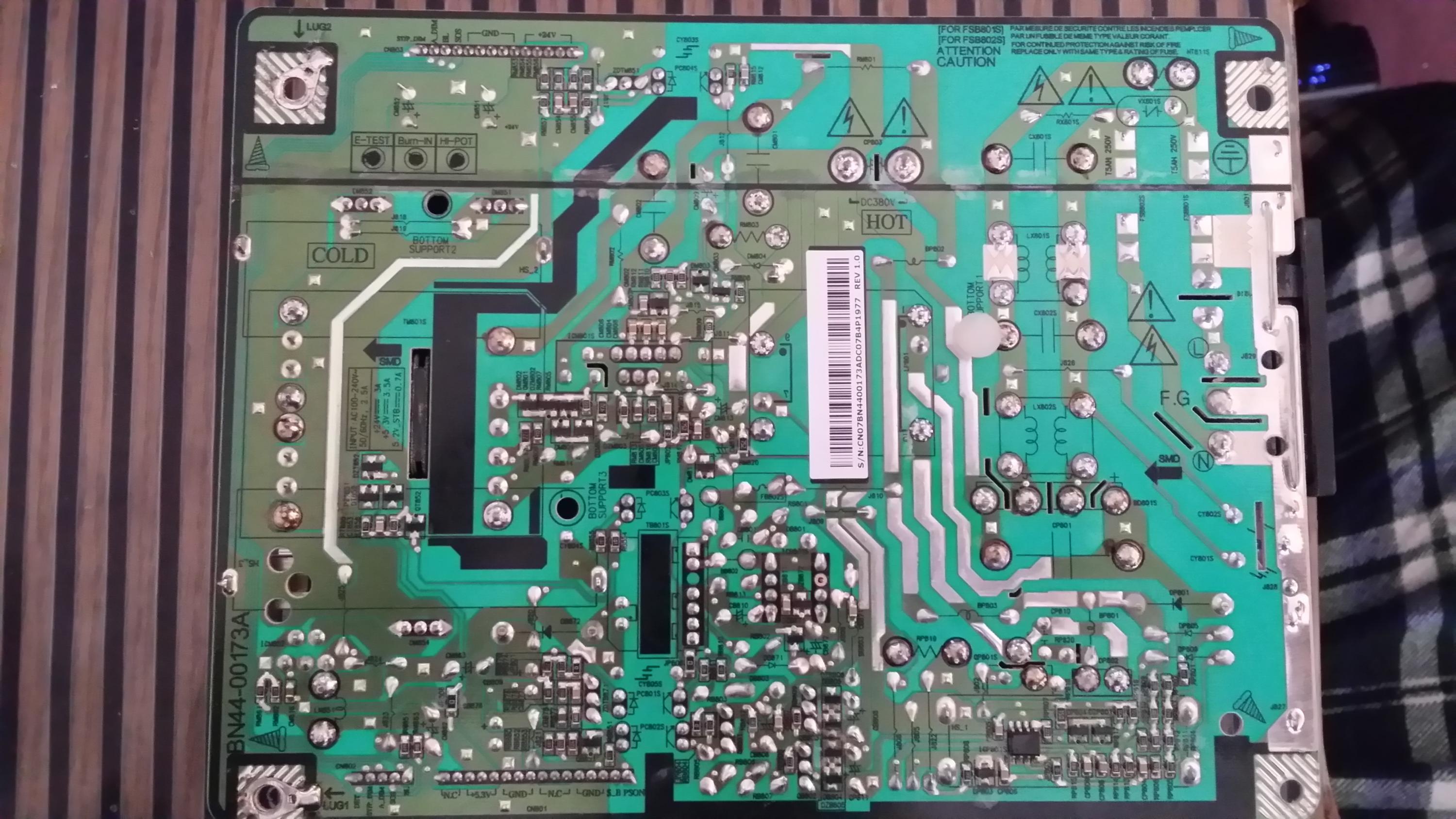

              You MUST also remove ALL those yellow glues that turned dark brown, they are conductive and corrosive, especially around the high voltage sections otherwise you will have more damages:

                Tried to find info how to do capacitance test and i couldn't find the setting on my multimeter that was being suggested, one of them showed the Continuity symbol reversed on the same setting so i tried that, result was 541 -- was that the correct way to test?
                Glue ive been working on sense first post, broke a chip of ceramic off a resistor trying to remove some making ~1mm sq of silver core visible, assuming that needs replacement? some of that glue is just impossible to remove, im tryin to soften/work it with ISO, the darker stuff is easier to get off (very brittle) and the more yellow stuff is pretty much impossible to remove without destroying the components...

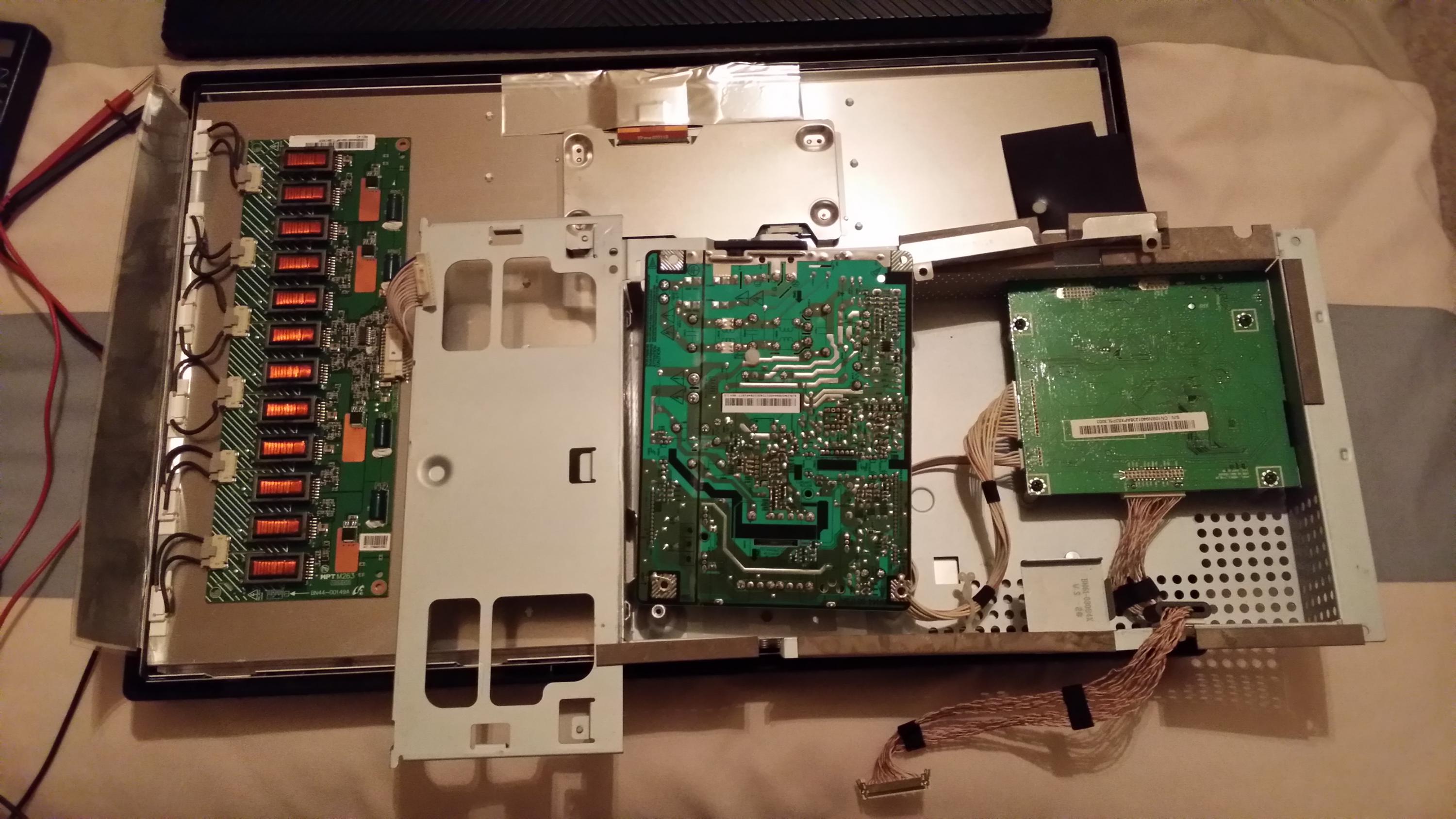

                          you better show the pictures of the boards and how they are connected together then.
                          • OberAgain
                            • Nov 2014
                            • 25
                            Here is picture of layout, ribbon going down off the board on right connects to LCD screen just behind where the power board sits
                            If i have the correct idea,
                            Inverter board - Power Board - Logic Board > LCD
                              "Inverter board - Power Board - Logic Board > LCD" That is correct, you do not need to have the cable (LVDS cable) from the Logic (main board) connected to the LCD panel for testing. The cable between the Inverter board and the power supply can also be left out for now. We just want to make sure we have all the correct Voltages at the connectors. You do need the switch board connected and a running pc with VGA cable connected otherwise the monitor will stay in standby mode.

                                    There is no problem using 25v caps. they can handle a bit more voltage if required but don't put any stress on anything. the 25volt caps may be slightly larger so they may not fit in some situations. but will be fine here. you could also use 16volt caps if you wanted. If you want to replace the 3 68Ω resistors go ahead. and clean off that brown glue as suggested.

                                      i havent made order yet, this was result to test.... one person said to only change those 2 caps, others have suggested to always change them all... im assuming changing them all would be smart while its apart and its cheap, i did it for the other monitor afterall... mostly wanted to make sure the problem atleast lie within those parts not something else like the bulbs or inverter board stuff...
                                      Going to make order now - hopefully ill get the parts and have it done this coming week
                                      My assumptions are that its just those 2 caps with how it still nearly works, it does still turn on once in awhile just flickers ect.

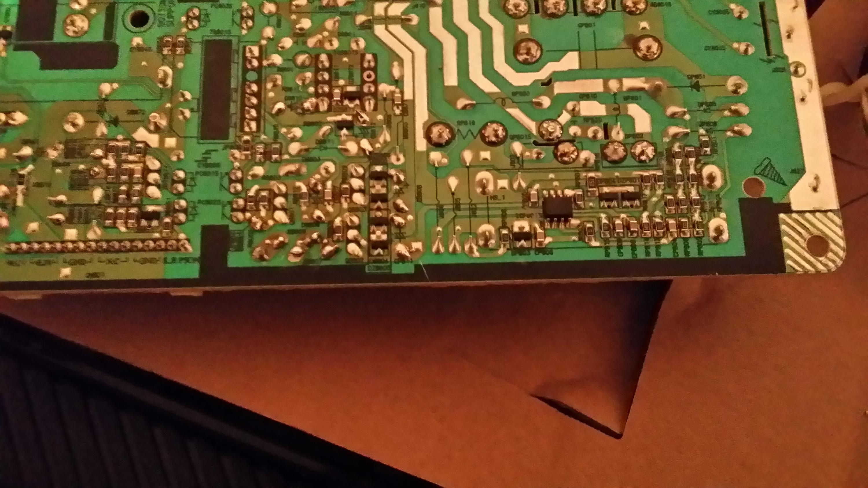

                                        Sooo, Had been sick then family was in hospital then i was in hospital yadda yadda ect... Finally got the parts and had a moment to work on project but i made a Big Boo Boo that i am not so sure i can fix... in one picture you can see where i accidentally ripped up the pad and my solder sucker just sucked that baby right up and into the bulb - now im not sure if i can fix this or not - Conductive pen i had was already rock hard (never even got to use the damn thing, didnt know it hardened if stored) and $25 for replacement at radio shack - whole board can be replaced for something like ~$65 so not sure if 25 to see if i didnt screw up elsewhere is alot... i changed ALL the caps/resistors on the board already and this area was the only major problem i ran into, the opposite lead to the one i ripped off is also slightly ripped up but its soldered to and still connected so i hope that one is alright...
                                        Also in the other picture, accidentally scratched across the black line/bar that goes around the edge of the board, not sure if it is part of the ground and if i have to do anything about it or if i can just ignore it...
