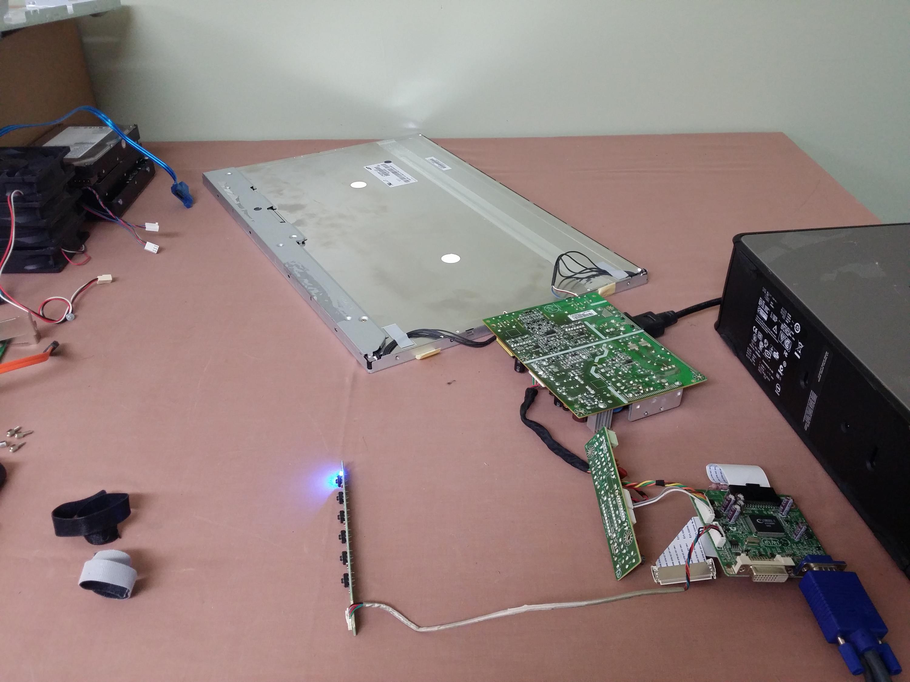

    Hey guys
    I have two of these monitors that come on then turn off within a couple seconds. However, if I disconnect the video (?) Ribbon cable and turn the monitors on they will turn on the back lights like they should and after a few seconds the amber light will come on indicating standby mode.
    Any advice for me or do you need more details? Just let me know.

    Pictures of the back side of the monitor that shows all the boards?
    Are you talking about the cable between the LOGIC/Main board and the LCD panel assembly?

      Yes, that's the cable I am referring to. I can get you pictures of the boards tomorrow if you like.

          So if the ribbon cable to the LCD panel is bot connected Dnd if you have MONITOR connected to running PC, the backlights will stay on and it does not go into STBY, right? If that is the case, to me you have something wrong on the T-CON board on the LCD panel assembly.

            The only way it will stay on is disconnect the video ribbon cable from the panel so there is no display when it's on. If I connect the cable to the panel it comes on once then goes off immediately and subsequent presses of the power button does nothing noticeable.

                I plugged it into a computer and as you can see, it is on. I guess it looks like a bad t-con?

                  Yes issue with tcon
