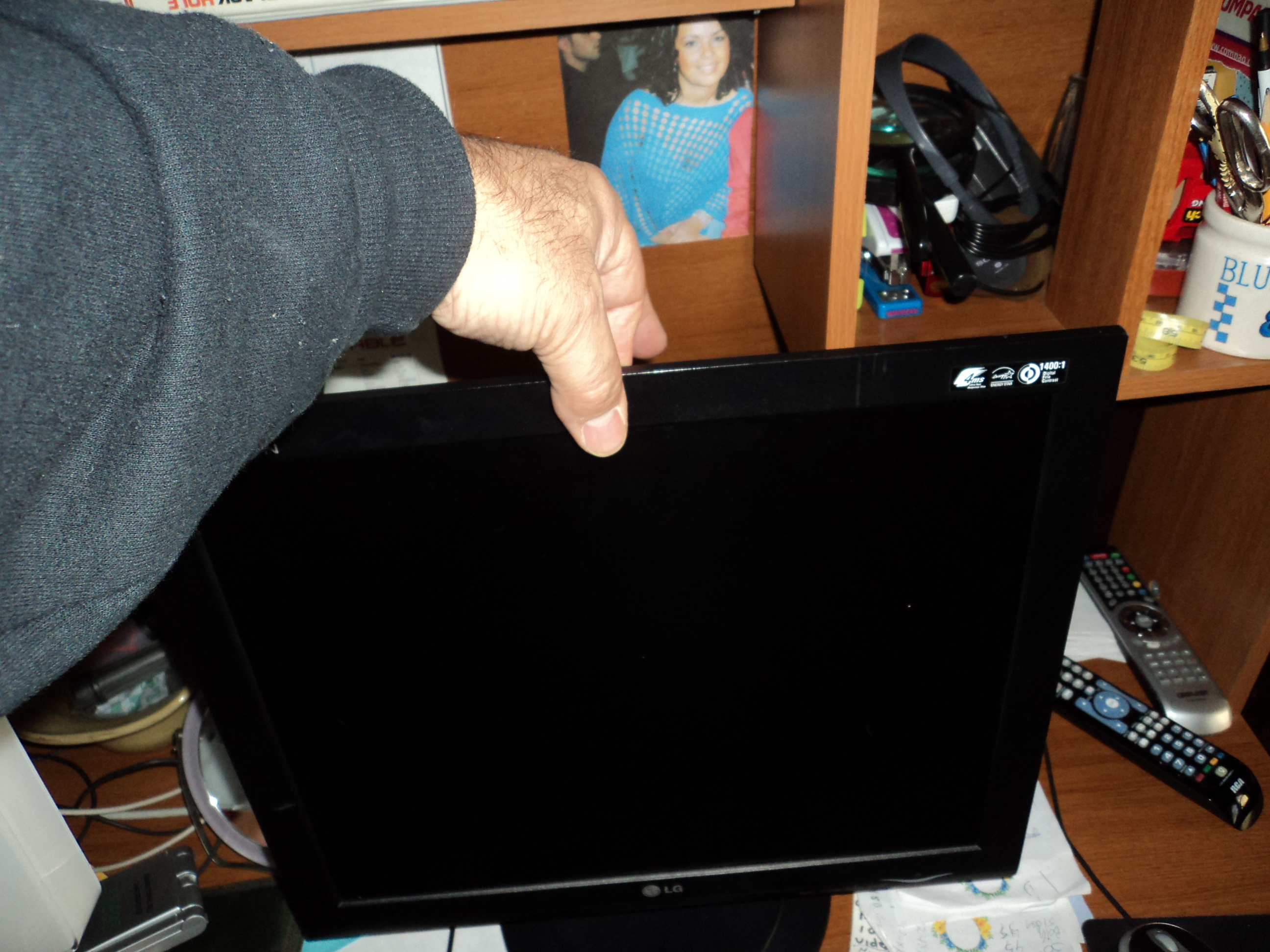

    Hi guys; I already posted in the computer forum but did not get any tips on this Monitor issue, may this is the right place to post this issue!
    I send new Pic how this intermittent fault goes away by pressing 2 fingers against each other in the middle top edge of the panel.
    Any help would be appreciated

    not sure but that's the same symptons you get with loose tab bonds on some lcd tvs.

      Thanks Bro, any suggestions on the fix? thanks

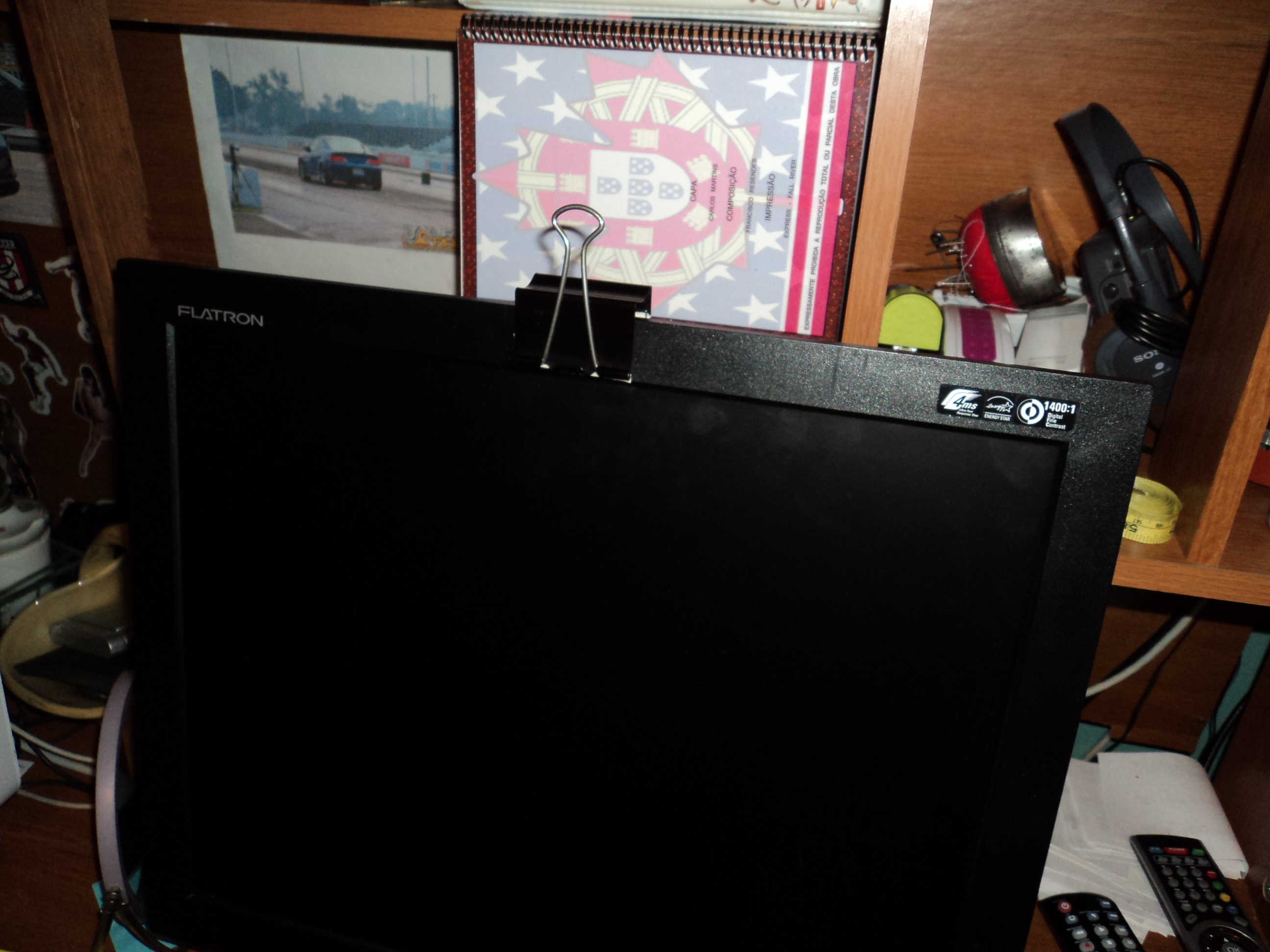

            could try putting something there where you put the pressure, for better contact, then reassemble, seems like loose contact in that section.

              Hi guys: check this out my permanent fix for the bonding issue if that's the case! check pic attach.
