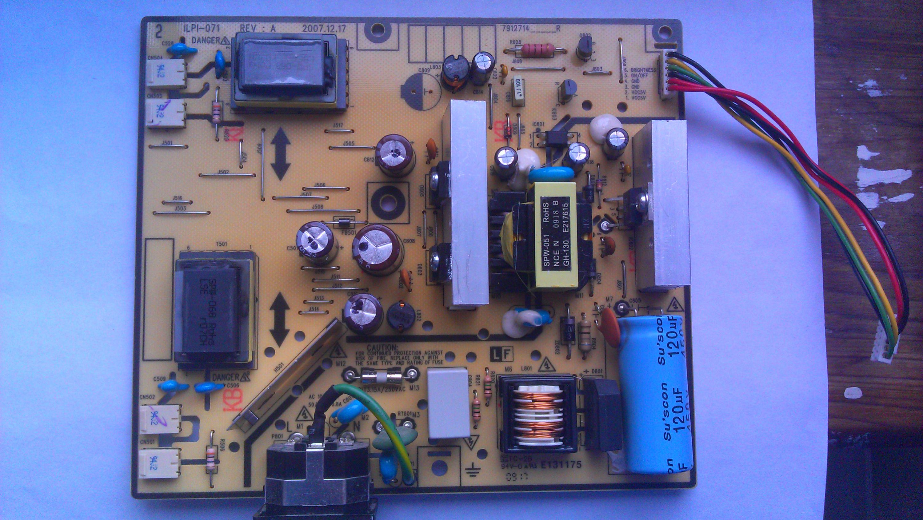

    I have problem with this monitor - when I turn monitor on, it works only few minutes (approximately 5-30 min) and then backlight turn off, LED lights green, picture stay on. I measured all electrolytic capacitors on power board and all are ok, but I only replace small 47uF capacitors with a little increased ESR.
    5V to logic board is ok, to inverter go 13.9V, on logic board are of course good voltages - 1.8 and 3.3V. I think the some ccfl tube is defective or only some wire had bad contact, but why it runs few minutes? Previously when I had problem with tubes it stays on only 1-2 seconds.. I add some photos when I arrive home. Could you advise me? Thanks for answer!

    If it all works except the back lights it could be heat related.
    Bad solder joint or faulty wiring to back lightwe will know better when we have good clear pictures- please post using manage attachments, not offsite.
    Test the voltage at blon pin when the lamps are on then when off.

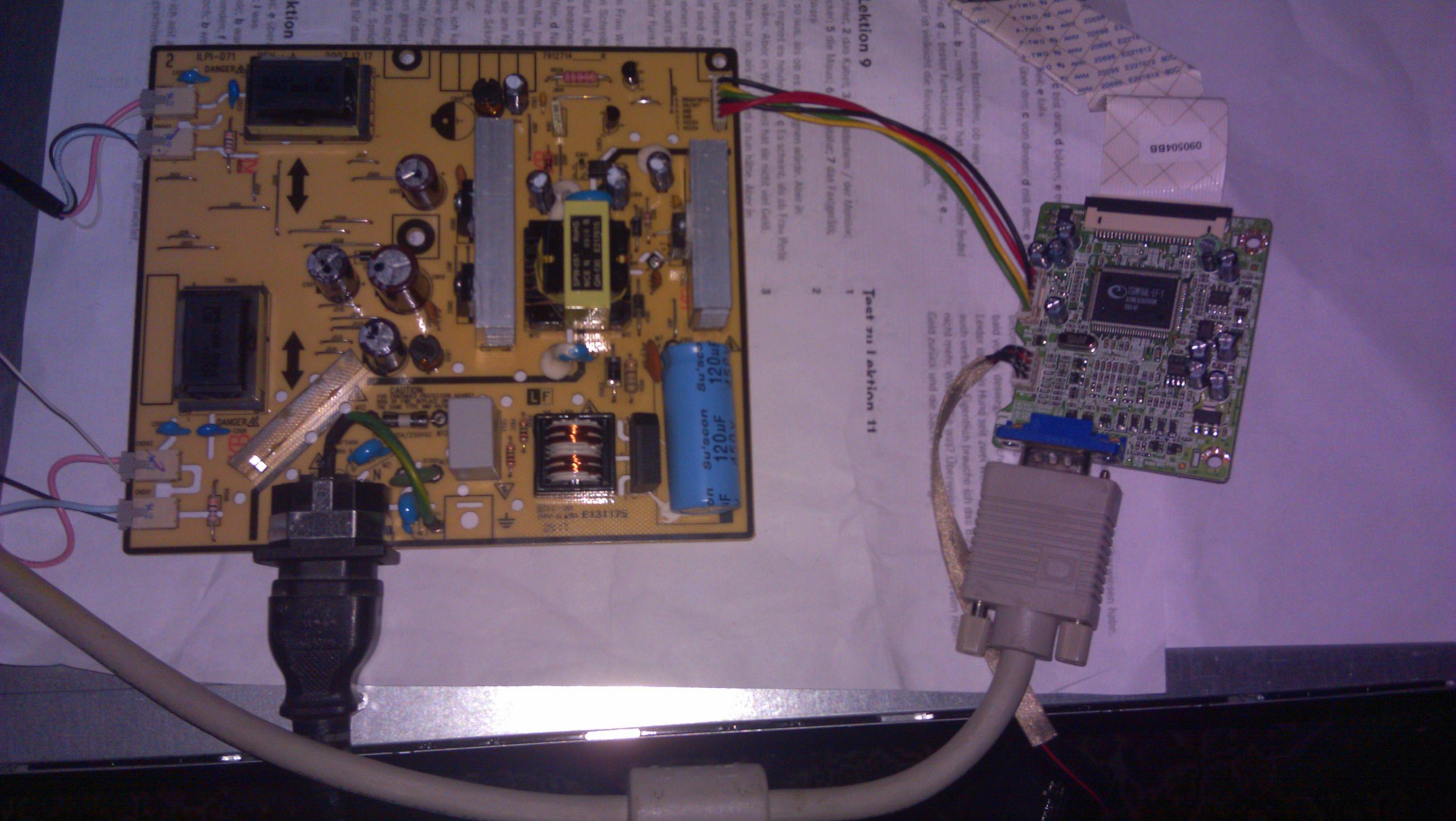

      Now I test it with unscrewed pcbs, without ground connected to case and it works approximately 1 hour. I test it for longer time tomorrow.

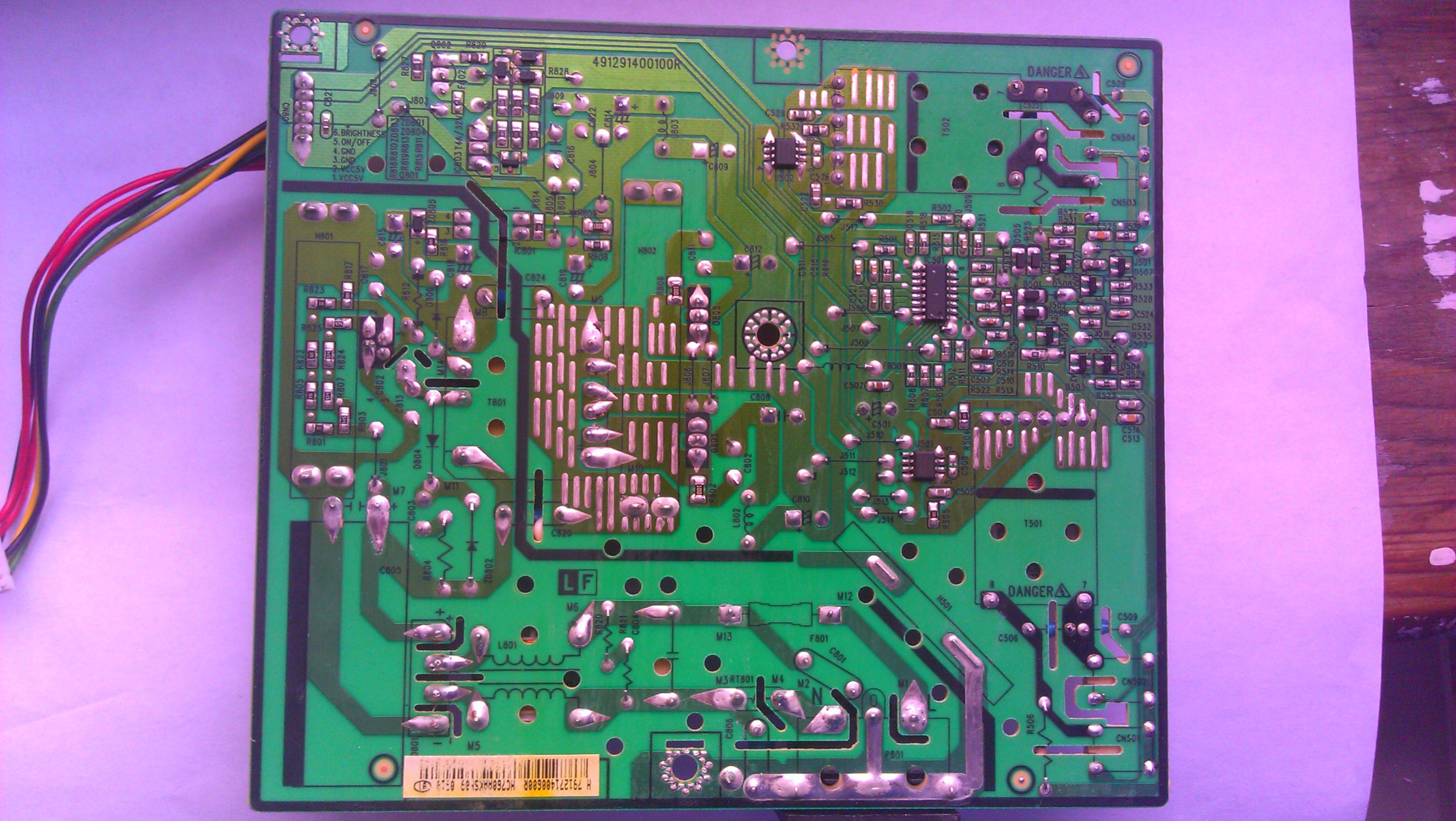

        I think the first thing to try would be to resolder all the connectors on both inverter transformers- better to remove the old solder and apply fresh. Do the same for the blue ceramic caps at the ends of the transformers.
        Have a close look with a magnifier at Pin8 on T501 looks cracked all round in the picture.

          I resolder it but it's not the problem. Today monitor runs 5 hours without turning off backlight. But when I screwed pcbs to case problem come back.

              I tried all what you write me, but not change. It works fine all the time, but only when GND is not connected to case..

                Is it the same if you only attach one board to the frame?
                If you set it up outside the frame and connect a ground point to the frame with a wire does it go off? ( trying to establish if it is the grounding that makes it go off or something else.
                Try it mounted on spacers/washers in case the board is bowed and touching the frame
                when hot.
