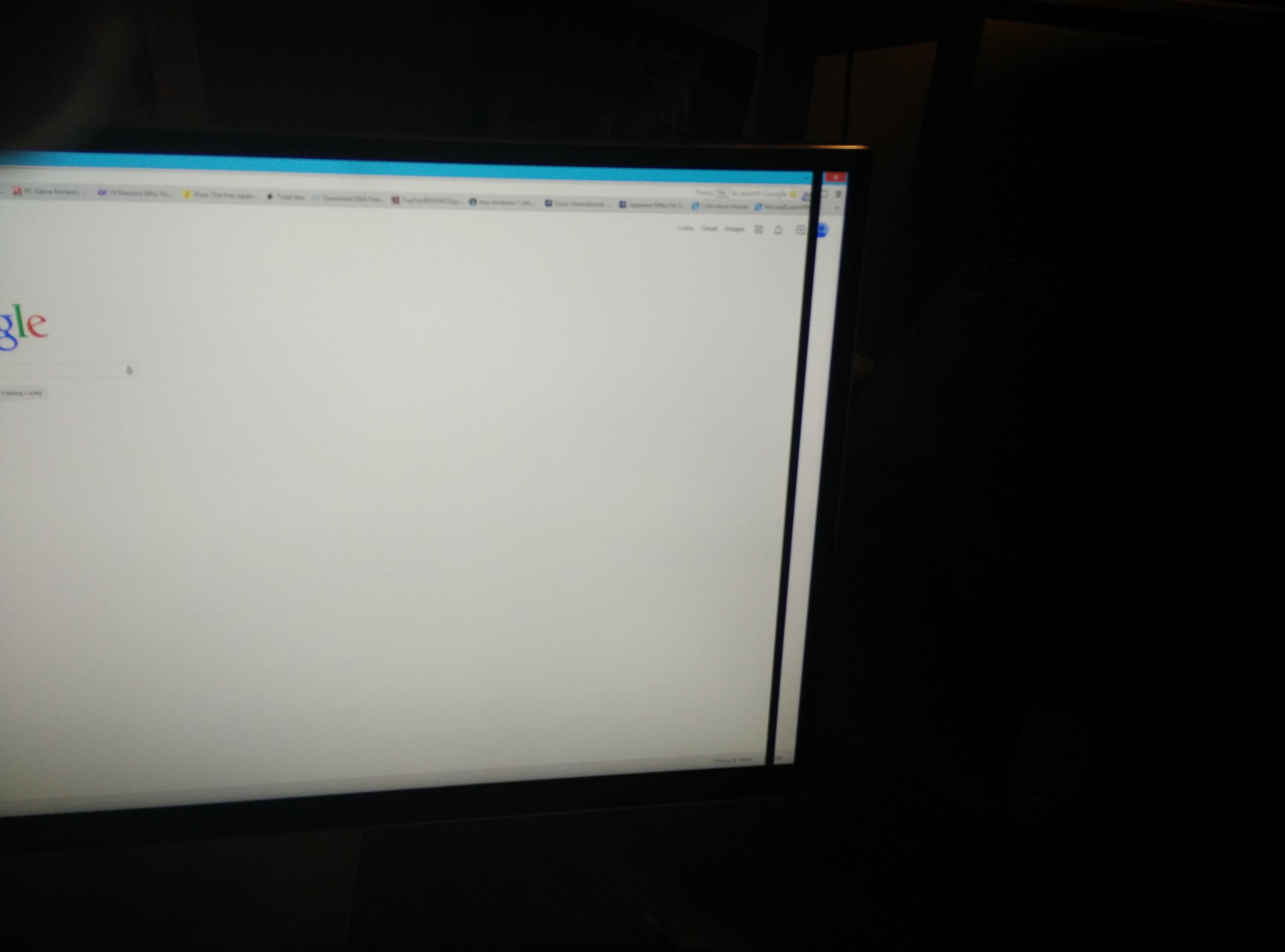

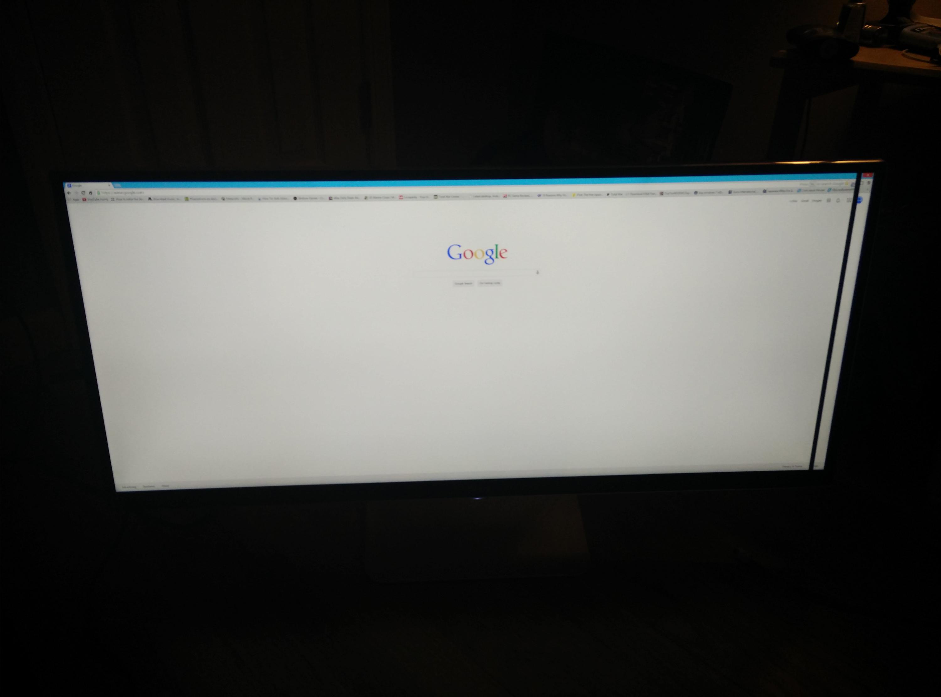

    My monitor seems to be having an issue. There is a black vertical line on the right side of the screen when turned on. Pictures will be provided. The problem does not lie with any of the cables as I have tried them with other monitors and the line does not appear on those. That leads me to believe there is an issue with the monitor itself. Need any professional help in diagnosing what the problem might be and if it can be repaired. Thanks in advance.

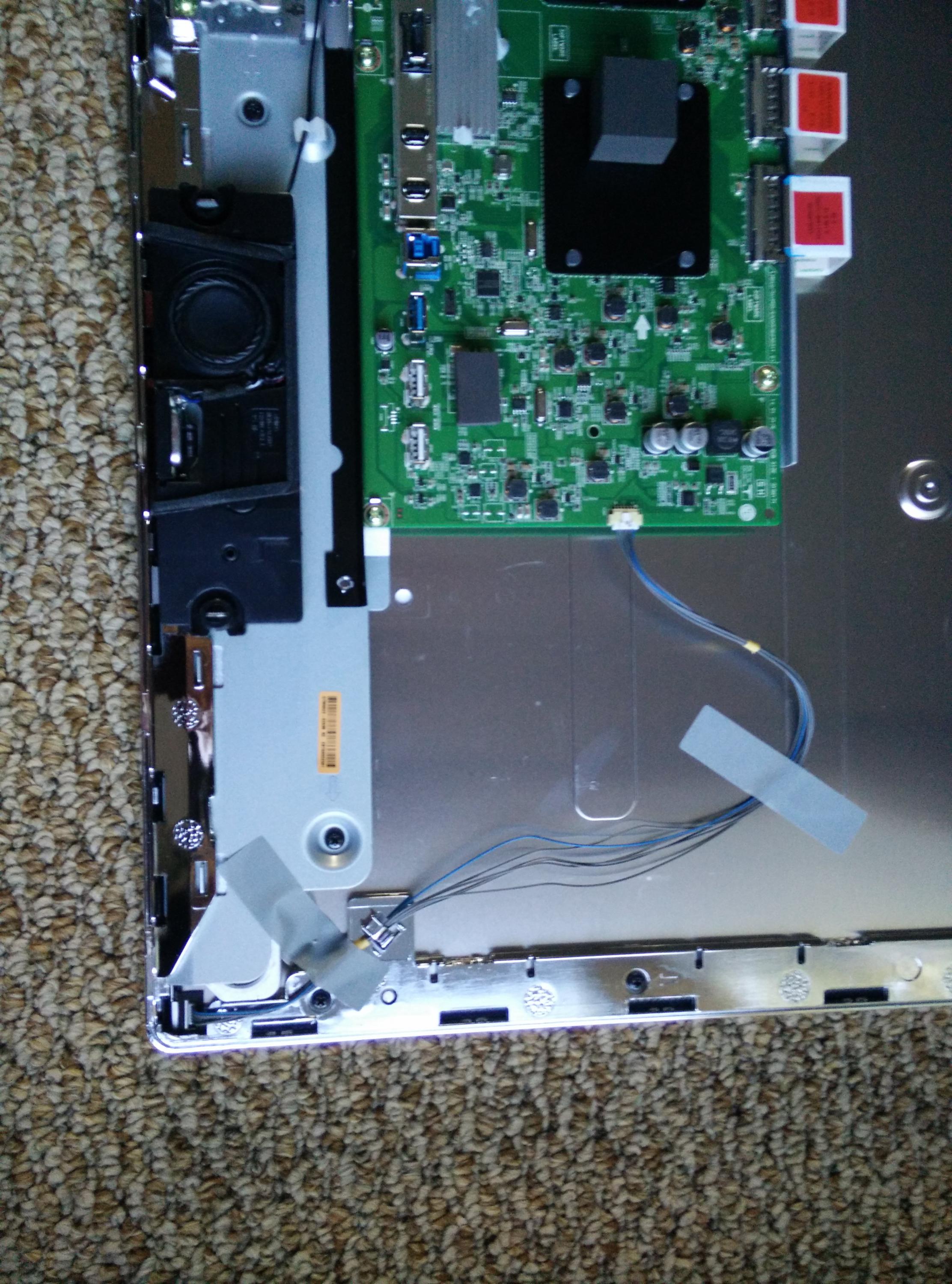

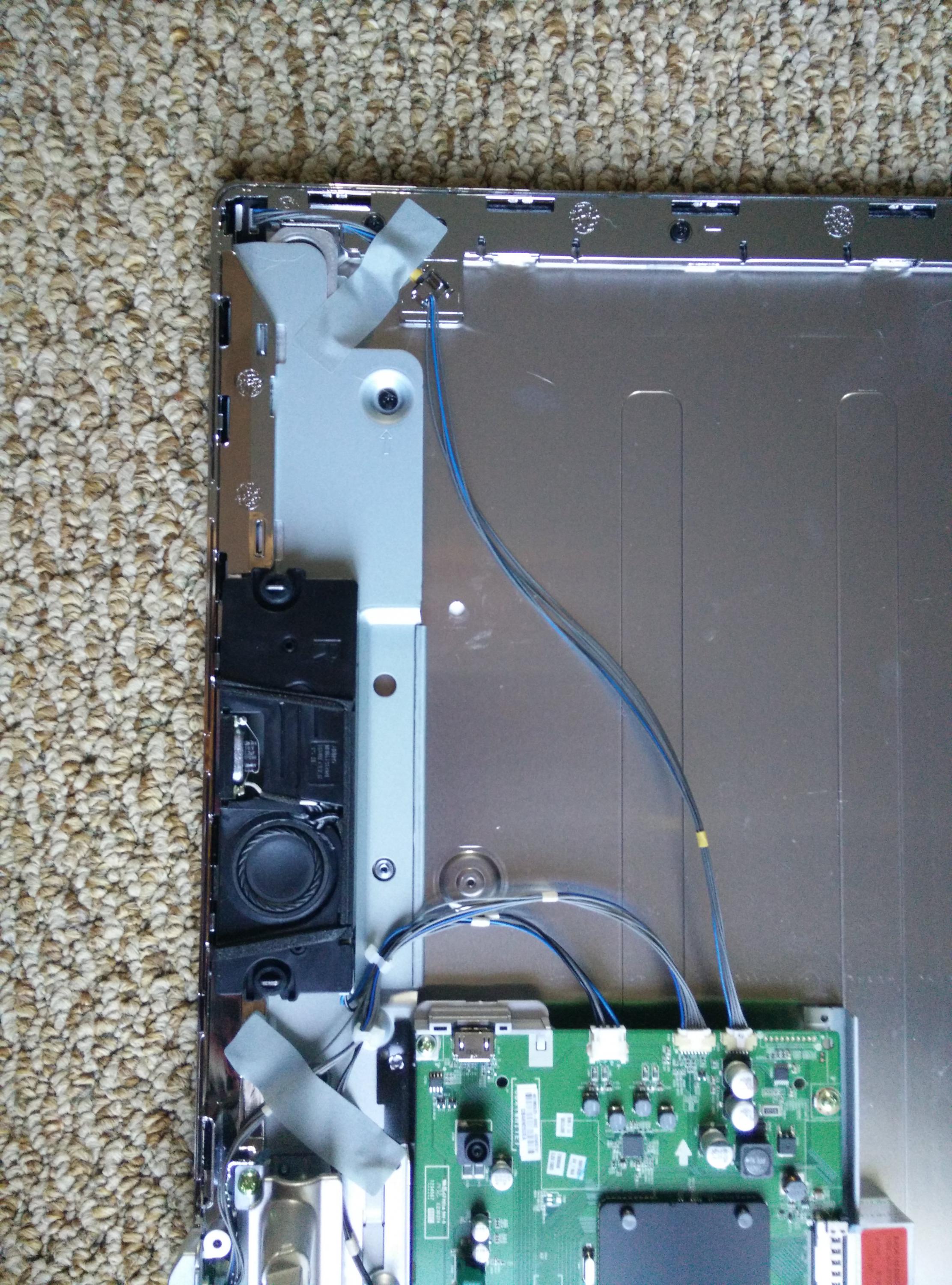

    If you are lucky it is a failure of one of the cables inside the monitor which connects the panel to the main board.
    Take the back off and post photos showing the insides so we can see how it's connected

      Re: lg 34um95 ultra wide monitor need help.
      that looks mostly like a bad panel do you have warranty

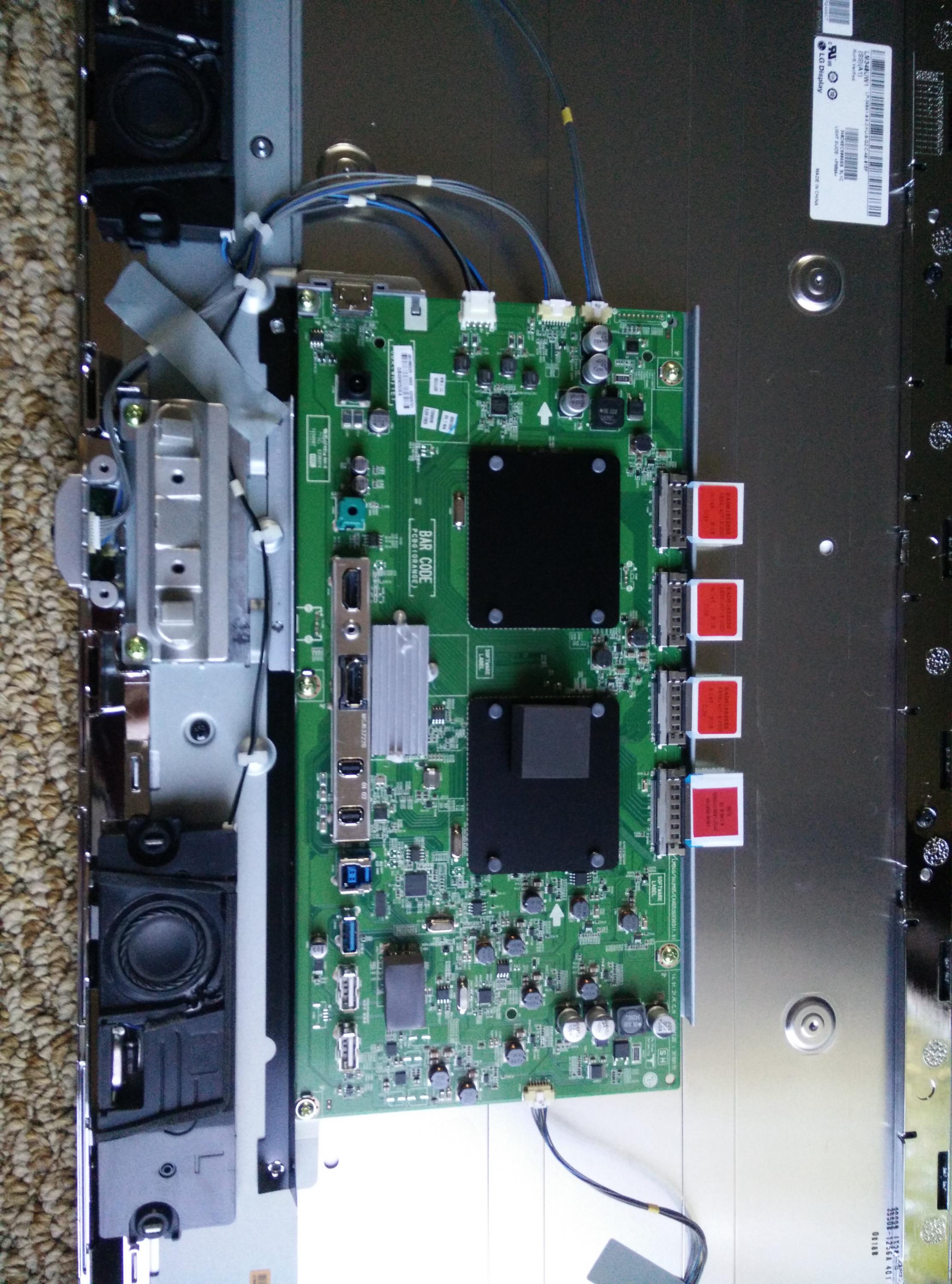

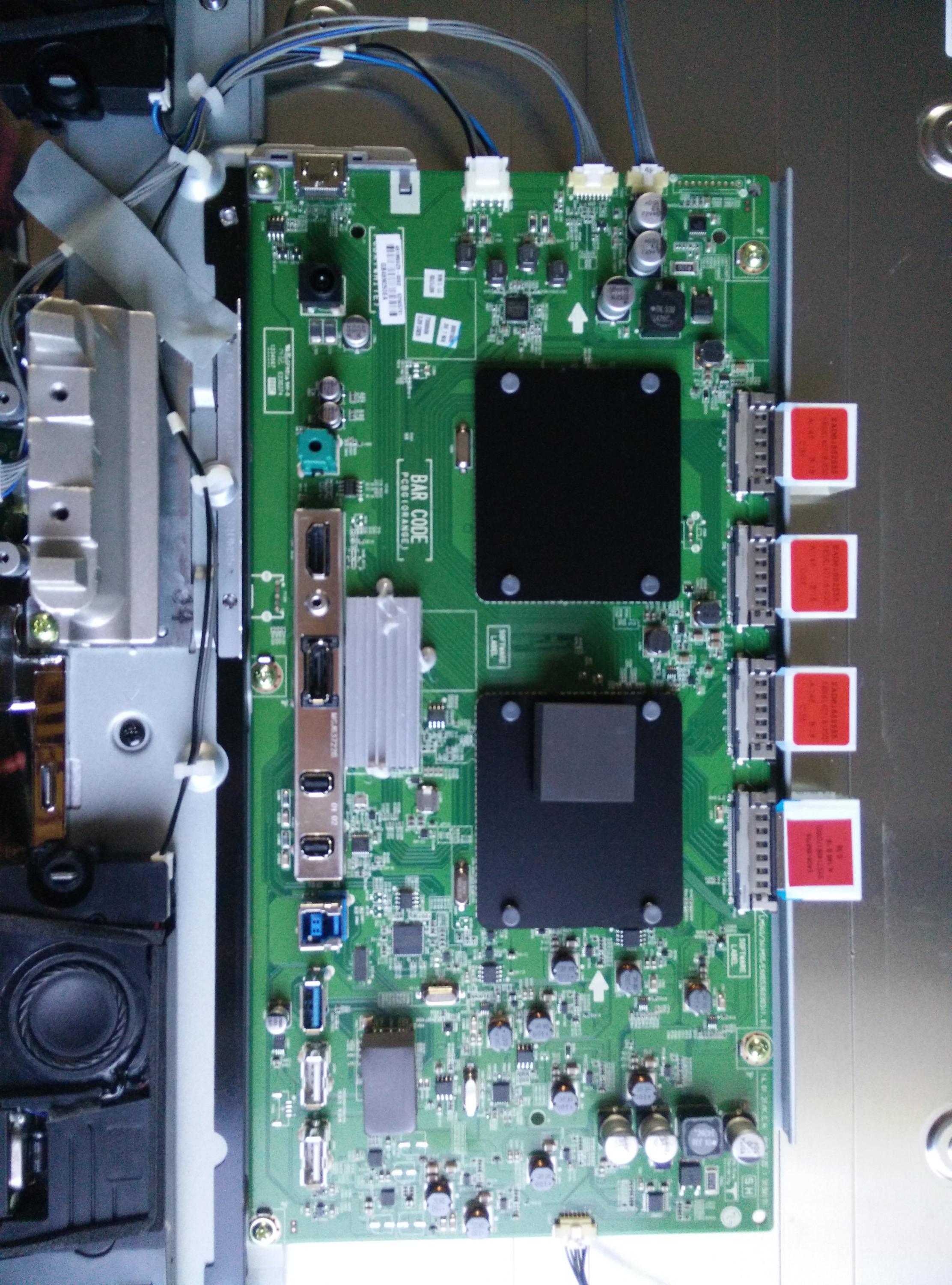

        Alright took some more pictures. By the look of it the board looks fine and so do the cables. Do you guys see anything different?
          Those 4 cables with red stickers on them are the data connections to the panel. You can try unplugging and plugging them back in in case there is a loose connection.
            Alright I jumped ahead and unplugged each cable one by one and plugged them back in . Unfortunately the line still remains. Any other ideas?

              Unfortunately I think it's probably a panel failure then.
              If it's the mainboard, it may be fixable, but I am not sure where to start looking. Someone else can hopefully provide some ideas or other tests you can try.
