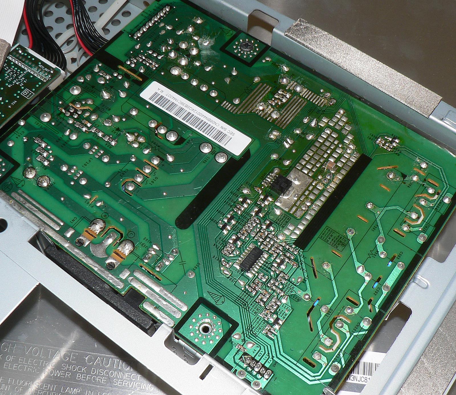

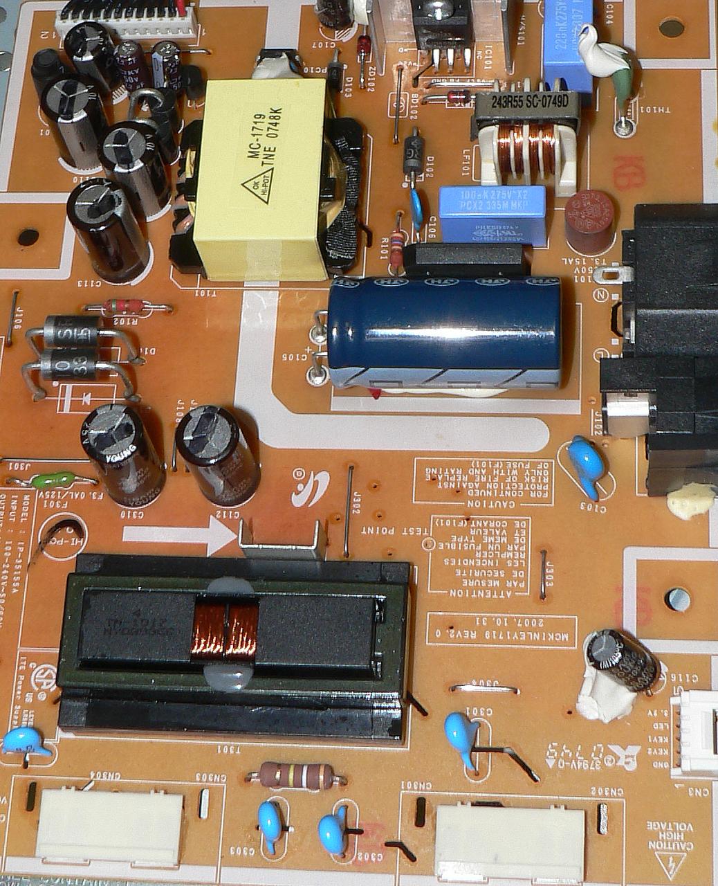

    Got this one with no 2 seconds to black but half a second to black. What I did so far:
    - checked all caps
    - checked inverter transformer
    - checked inverter trasistor STU309DH
    - checked fuse, output ceramic caps in the inverter
    - checked votlages under operation, everything seems fine incl. BL_EN
    - resoldered bunch of badly looking joints
    - tried different CCFL tubes
    The STU309DH has 7 V for a fraction of second on the drain than it slowly decreases to 0 V and again pulses to 7 V and goes down.

      LED stays on, can see image with light so problem is clearly in the inverter. Time for pics I guess? Oh BTW, inverter controller is OZ9939GN.

            I guess it is picture time.
            Have you tested the blue high voltage caps for leakage/shorts examined for cracks etc.

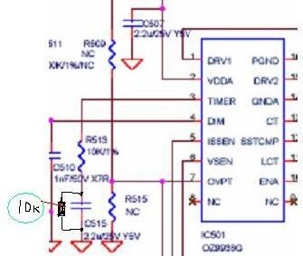

                  Just a thought - have you tried bypassing the protection circuit from pin 3?

                    I could I guess…that is some ordinary resistor, could be 0,5 W or 0,25 W? And what than, look for a smoke?

                      Re: Samsung SyncMaster 943BM - backlight only for half a second
                      Well, it is 0,25W regular, and should enable the inverter to work with a "tired lamp"

                            If you have had a shorted component, the fuse should have blown by now.
                            This trick can be used if you determined that the inverter is ok, and positively identify one CCFL with problem, and you leave it disconnected.
                            If you are willing to compromise, than you can consider this a temporary fix (dimmed brightness) i suppose.

                                I thought it was a fix mainly for a flickering bulb for example a bulb on its way out, although I did get someone to try it recently on a half second to black , but it didnt work.
                                What is does is it it doesnt operate on the signal that says the bulbs have not lit within a certain time giving a half dud or dim bulb chance to light as it extends the time to infinity. I think it is ok for a short test with a removable bridge or on a machine that is otherwise scrap as I dont know what effect a half working bulb will have on the inverter transformer. Probably kill it.
                                    And beside pictures, can you post the voltages on pins 2, 5, 6 and 10 (respective to GND) of the OZ9939 to see what protection kicks in ?
                                      5,13 v, 0,23 v, 0 v, 2,89 v
