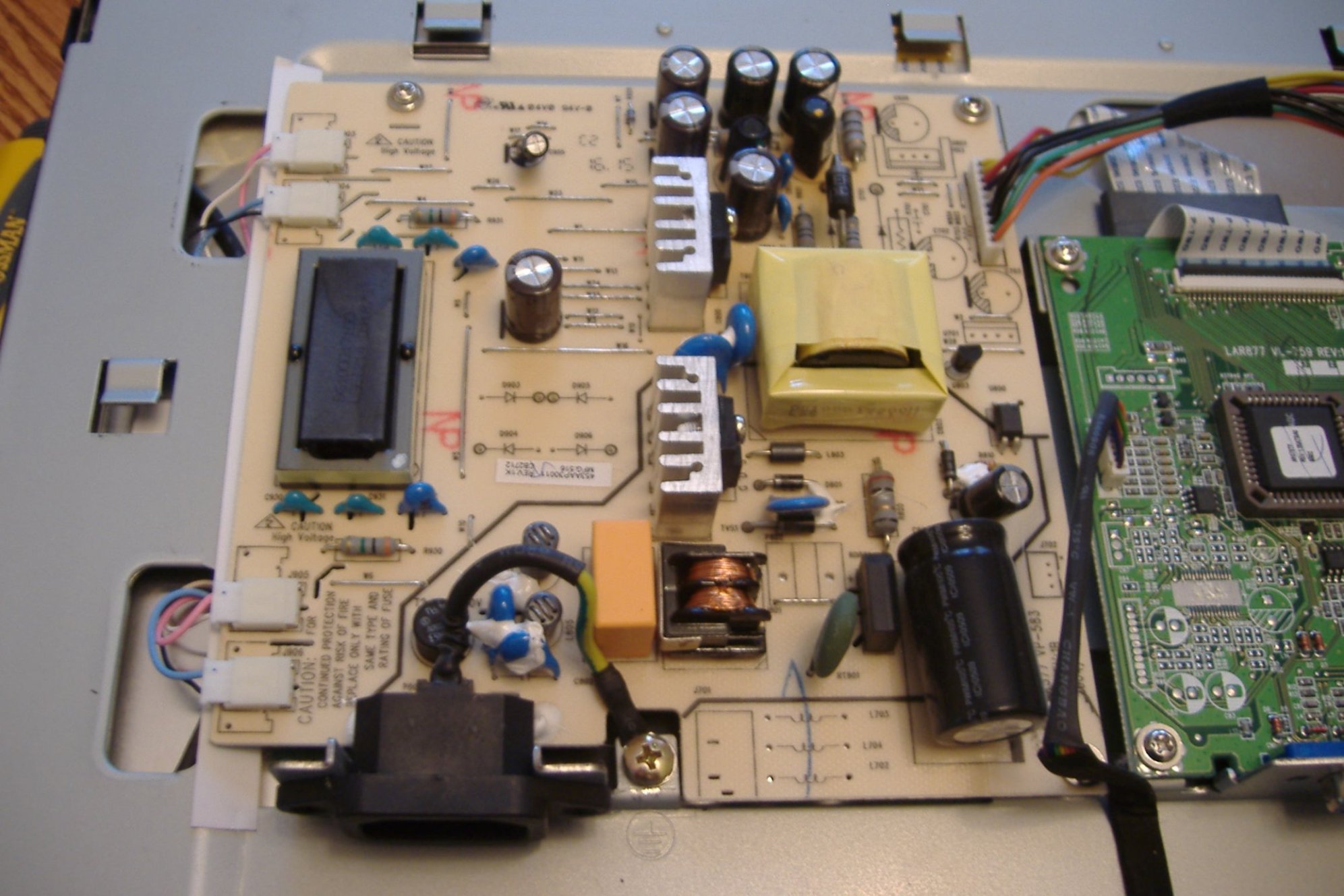

                  After a bit more research I found pics of a CCFL inverter from a samsung monitor. Am I right that they are a separate unit somewhere deeper inside the unit, maybe under the power supply?
                  Is it possible that the power supply is delivering faulty power to the inverter and that the inverter is OK?
                  I'm just wondering if something more might be wrong. Remember that I can't access the monitors configuration menu at all even when it seems to be functioning properly. Also I have the floating OSD that says "input not supported". I'm testing it with a standard 15pin video cable, it doesn't have DVI.
                  Are these symptoms of a bad CCFL inverter?

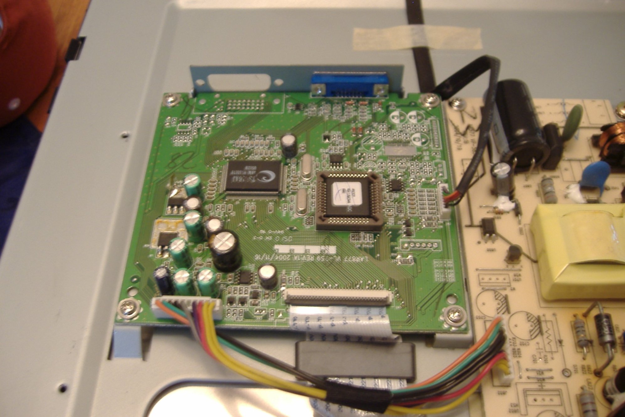

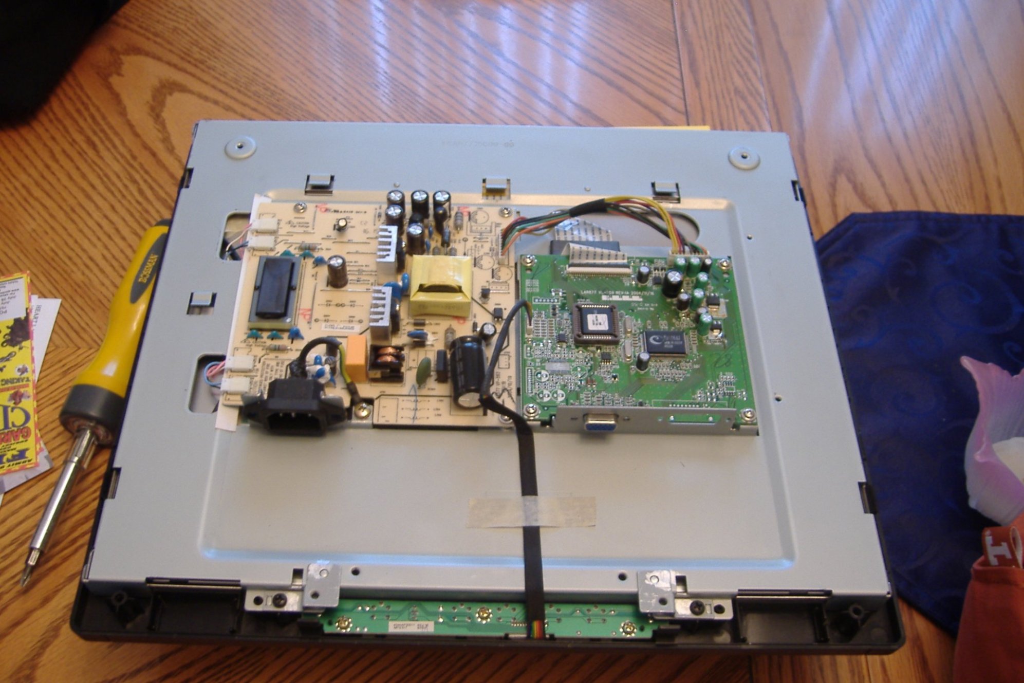

                    I have some pics of the inside of the monitor, I just don't see how to post pics on this forum.

                          Thanks galvanized,
                          Here are the pics,

                                        In that first picture the cap next to that large one is way crooked. Is it just badly soldered, if so that is sort of odd because all of the others are soldered properly flush to the board.
