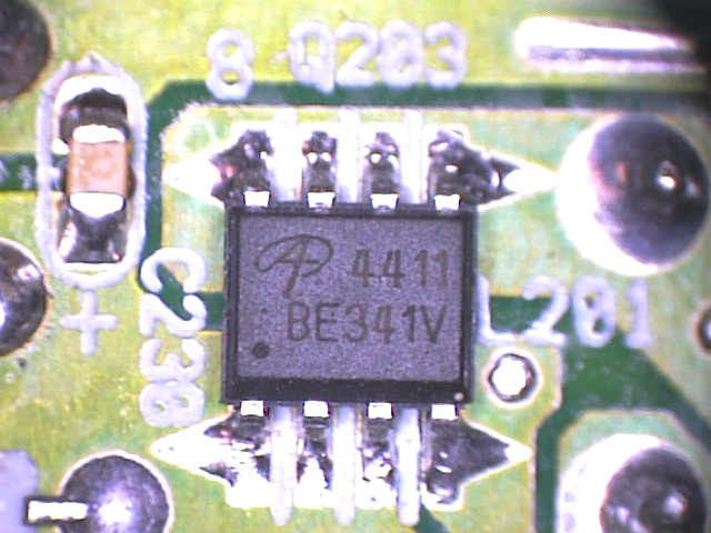

    Looking for information on BE341V transistor
    I have a Dell monitor with backlight problem. It uses a pair of BE341V transistors. I have not been able to find any information. I think one of them is bad. See picture attached.

    Re: Looking for information on BE341V transistor
    Is attached any help ?

      • 30956
      that's the part - change both.
        is not a transistor. and 'a dual mosfet
          mono fet P
