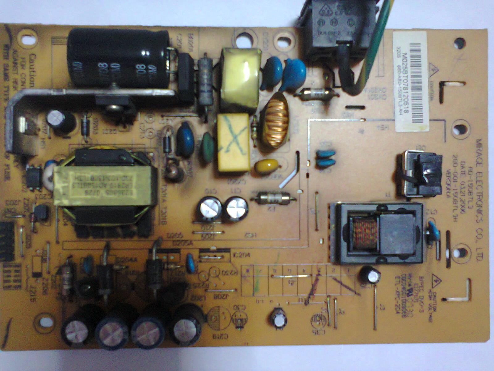

    Hi guys, new with this thing but i really want to make it work. I have attached picture of the board, i found one bloated cap but maybe the fuse is also busted. The problem is I do not know where it is. Can someone kindly point it out. Thank you.

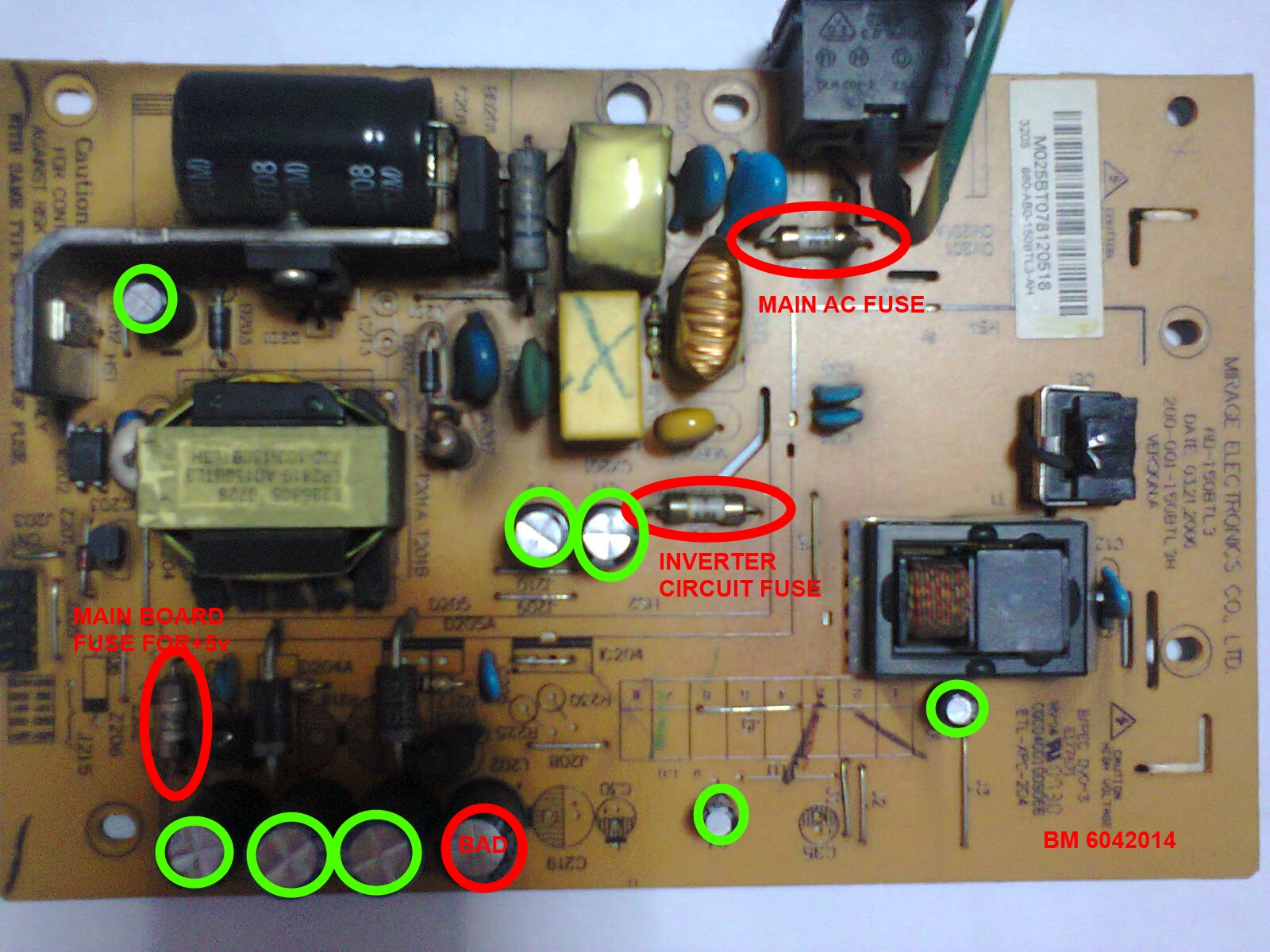

    It looks like there are 3 fuses. One is right next to the power socket - the axial device with silver ends and white in the middle. It is likely to be marked Fx (where x is a number) on the silkscreen.
    Have you checked to see if there is any voltage at all coming out of the PSU?
    How much do you know about repairing switchmode power supplies?

      Actually I have no experience repairing at all, but I can do basic electronics as long as I have help. Thank you

        *-You also have at least one faulty capacitor, the one on the end of the four in a row,cannot see the number.

          Suggest you start with reading this: http://www.repairfaq.org/sam/smpsfaq.htm

            So which fuse is blown? You should also replace the caps as a set.

              thank you guys will test the fuses and try to fix this
