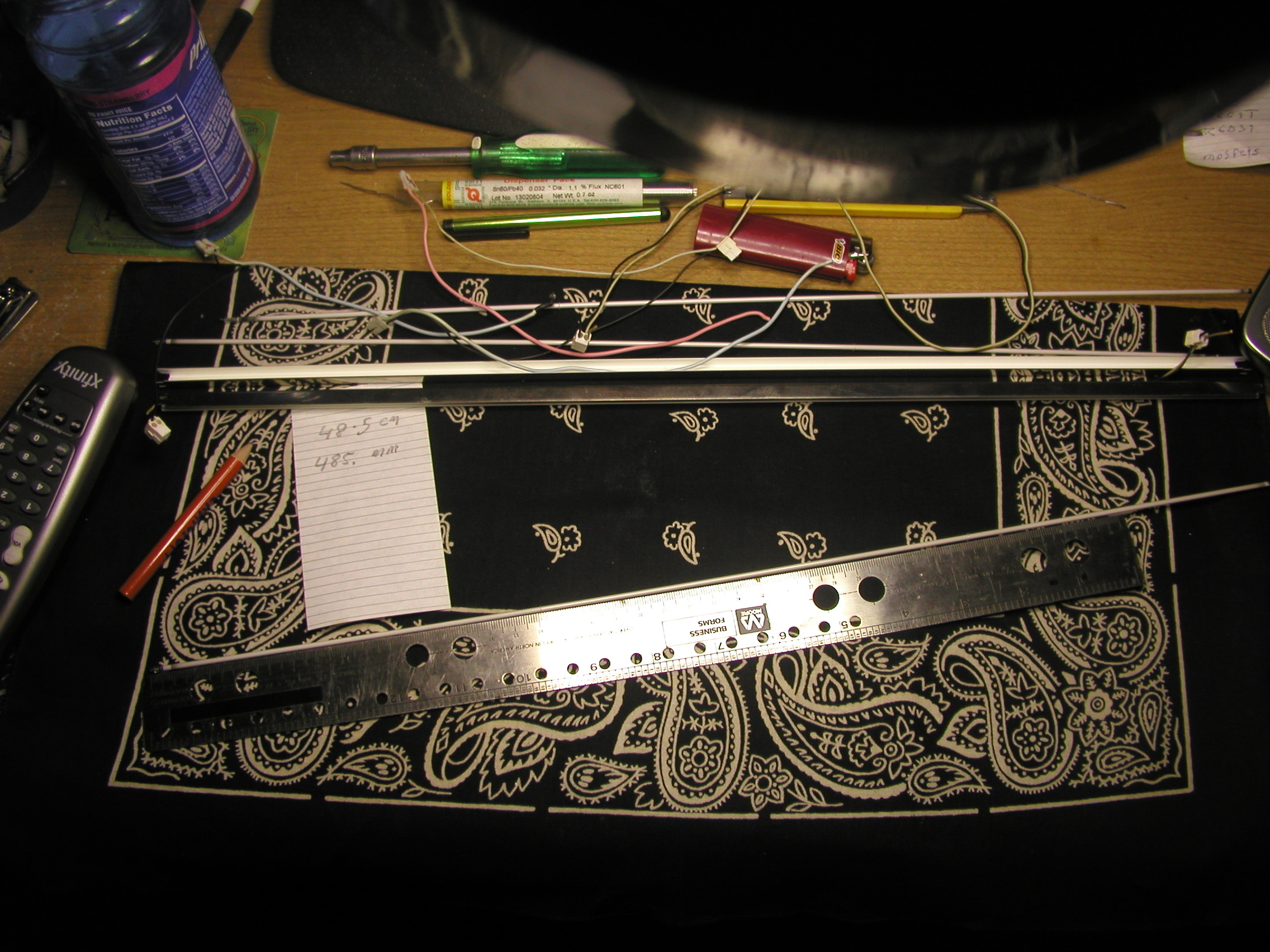

      I carefully disassembled the ccfl's, removed the wires and measured them.....
      But ccfl warehouse wanted $9.95 each for the 2.6 x 485mm ccfl,s so I bought the kit.
      It was a learning experience...... I broke one of the good ones
      Of course the burnt one survived the learning curve, but so did the two good ones
      I also hunted up the four E-Waste places here in town and I'm going to try to pick up a few dead monitors to gut the ccfl connectors out of...... I want to make three more test lights.
      Thanks Again

        Re: Viewsonic VX2235WM........ 10 Seconds to black
        9.95 for a tube?
        fuck they are expensive.
        the place i use charges about 15$ for a pack of 5!
        they are also charging $50 for 50tubes!
        and about 15$ for the led conversion kits.

          #44
          Originally posted by stj
          9.95 for a tube?
          we are in the US so we can't get the 2dollar chinese bulbs
          shipping across oceans makes a difference in total costs !
          I use to have a florida supplier that bulk bought from China and resold at better costs, but he is not doing it anymore

            #45
            shipping is included in that price.

              #46
              I did check that site but couldn't find the right size bulbs.
