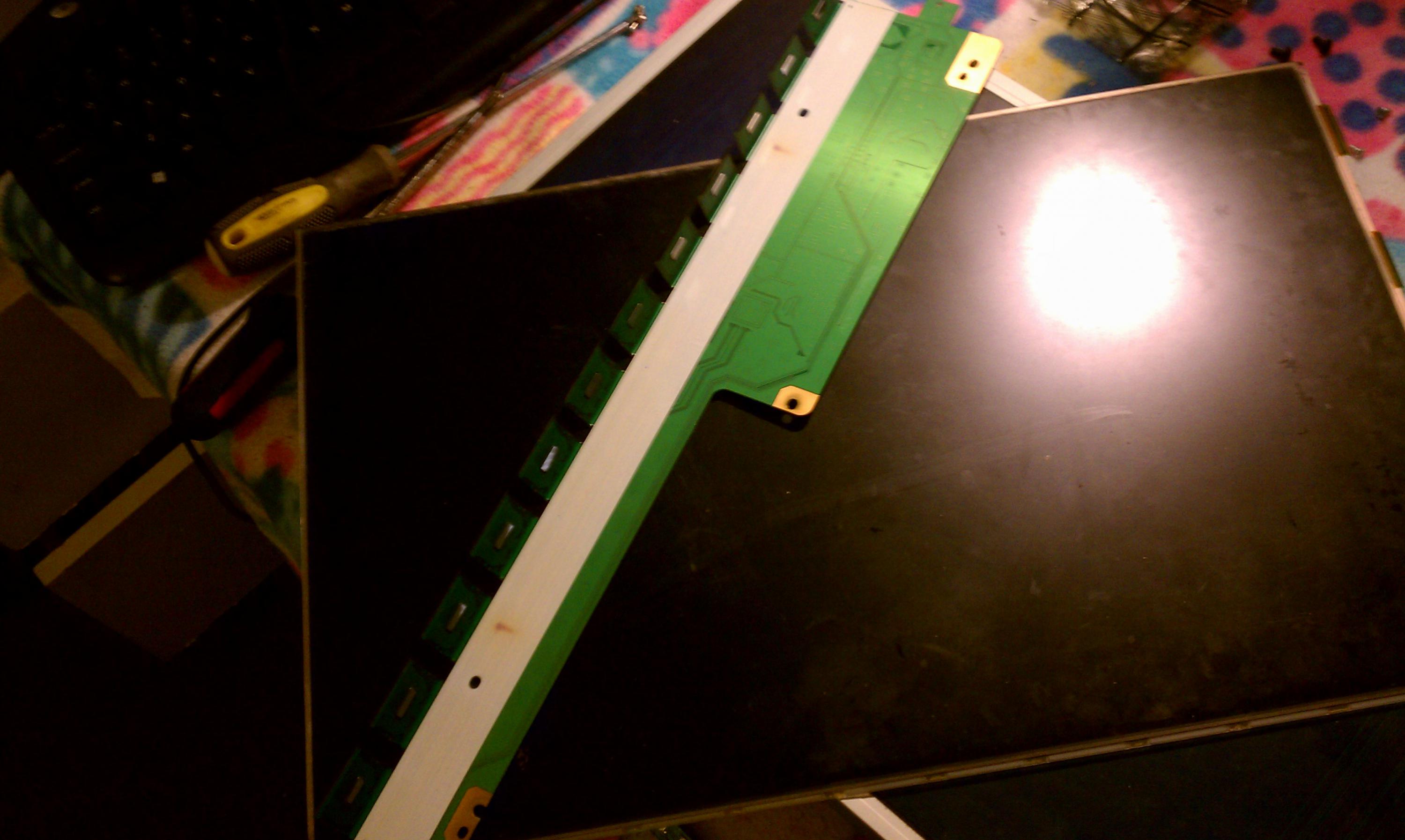

    the tubes arent in the foto's - they are on the end of the wires that plug into the invertor!
    btw - you should not have stripped it that far - good luck getting it together without dust trapped in it!

      i guess what im not understanding is that this part in the picture seems to me to be the only thing that can go wrong in an LCD screen since the rest of it is just some pieces of film and a plexi-glass. so whatever problem im having (white bar on the side, or turns off after 1 second) are related to these peices. so therefore, i have one thats cracked, one that turns off, and one that has a white bar on the left side, and i dont see how swapping these peices would do anything but transfer the problem with one LCD over to the other one?

        oh dang i see what u all mean by tubes now...jeez :/
        well in order to change the tubes i have to disassemble everything...these ones dont slide out all easy like...theyre screwed in and the screws are on the bottom under everything....
        Don't fear the repair...
          • 30979
          Re: DELL 2005FPWisplay goes black after 1 second
          2-3 small screws from the back are common,
          but once they are out, then it usually slides out.

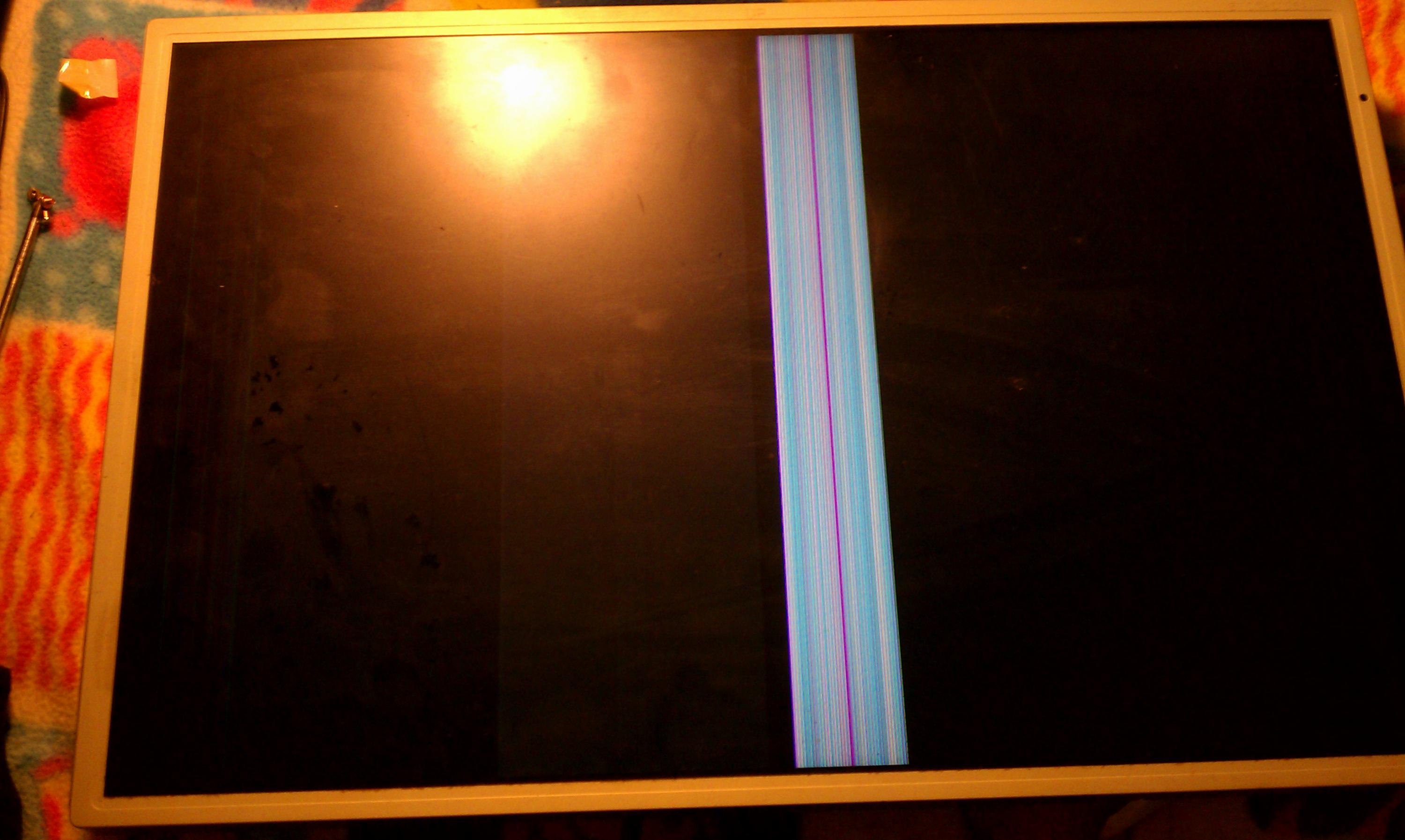

                        i swapped the glass from the one that was turning off, with the one that was displaying a bar, and i guess i wasnt gentle enough because now i got a corrupted display with lines coming down and i cant see any picture at all.
                        great! and the one that was displaying a bar... the logic board got seperated from the mirror glass when i was moving it. the glue holding those tabs came loose? im guessing theres no way to repair that...?
