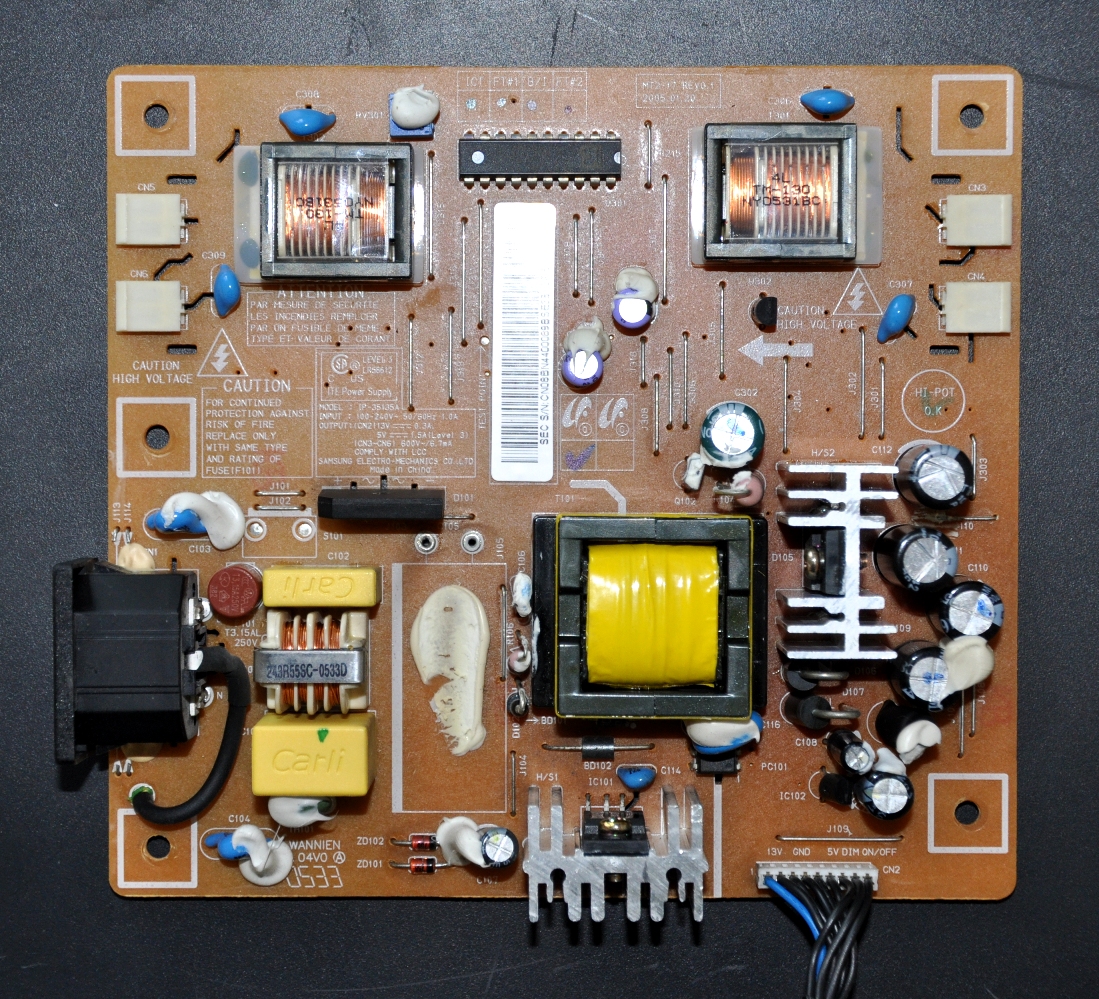

        OK here's a pic:

                      Did you check and replace the start up cap to the left of the SMPS ICI IC101 heat sink as shown in your picture?

                        Re: Samsung 913V blinking LED
                        I have no equipment to actually check the caps. The cap you're referring to is 47uF 50V and it hasn't been replaced yet. I don't have any such caps lying around and would have to order one specifically for this purpose.

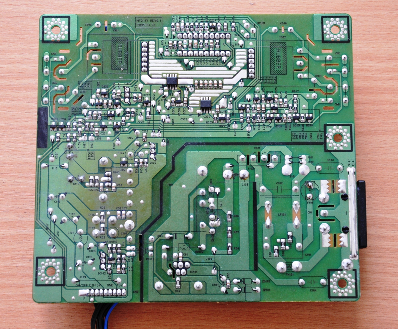

                                  If he can show good clear pictures of the bottom side of the board and the designator of that resistor, then we probably can trace out the function of that resistor.

                                    Here's the picture of the bottom side. Please ignore the half ruined fuse solder pad. I used wick to remove excess solder and it almost cost me the solder pad...
                                    The resistor in question is designated R106 and is soldered perpendicular to the PCB.
                                        Lift up one end of the jumper J308 (this will isolate the inverter power circuit from the power supply) and see if the 5V/13V become stable.
