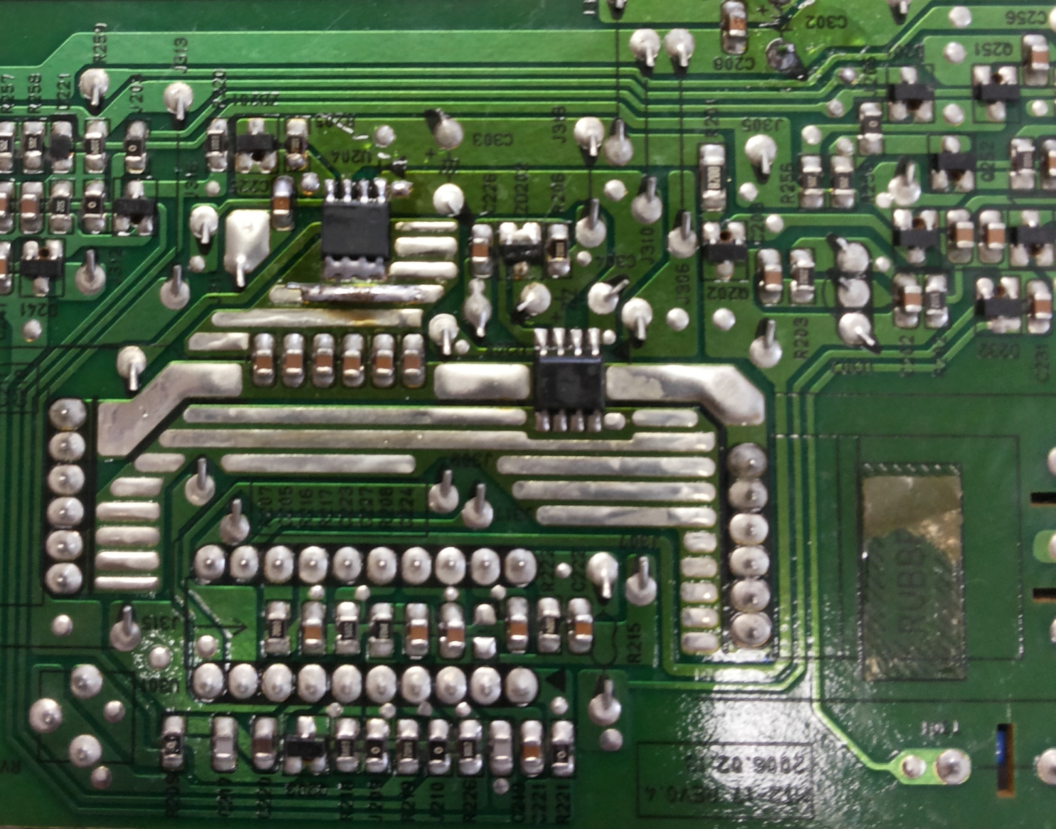

That means you need to check the MOSFETs (the two 8-pin SMD) which drive the inverter transformer. The 15.28 reading is about right without the heavy load (inverter circuit is not connected).
You need to check for S and D pins for shorts or very low resistance.
The 5V and the 13V are generated by the same transformer, so if the 5V is fluctuating, the 13V will be as well, the power supply was in shutdown/restart mode due to protection circuit detects over current drawn by the inverter circuit.Last edited by budm; 05-12-2014, 08:55 AM.Never stop learning

ok
then the transistors at U204 and or U205 may be an issue
what are the numbers on these two ?
and does your tester have an ohm settingComment
Re: Samsung 913V blinking LED
ok
if you remove the jumpers at j308 and j318 where they almost touch each other
then set your tester to say 20k ohms
check those two 4501gm by probing the 4 pins on the one side that are all on the large solder areas( all 4 pins are connected together so any pin will do on that side) to the pins on the other side one at a time and compare one transistors readings against the otherComment
disconnecting the jumper will separate where the power feeds each chip on the 3rd pin so that you do not get a false reading on that pin when comparing the twoComment

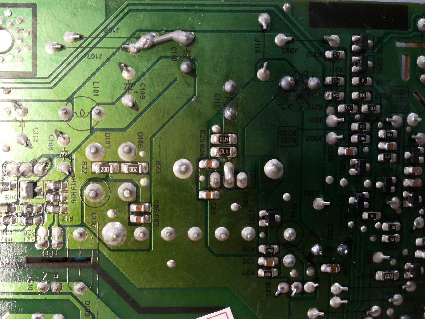

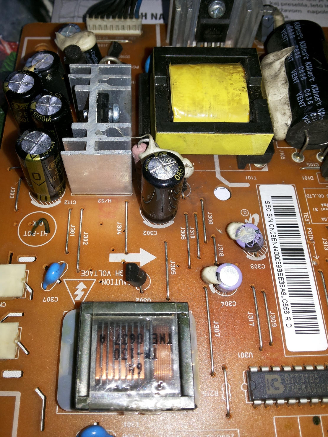

I gave up on fixing this for a while then I found a seller from China selling "seller refurbished" boards for quite cheap. I decided to risk it and ordered one. The unit is obviously used and there's dust on the transformer.
The refurbish job was done MacGyver style. They replaced all 820uF 25V caps with OST 1000uF 25V. A 330uF 25V Samxon was also replaced with a 1000uF 25V. Not only was this cap 3x the size of the original, it was soldered the wrong way! I only noticed this after I plugged in the power and it started smoking.
The back side of the PCB has another story to tell. They shorted all four pins on one of the MOSFETs. There's also a connection between one cap and one of the jumpers. Presumably whoever did the job, destroyed the solder pad or the via (just guessing).
The screen now works but I wonder, if it's safe to use as is.
ThanksAttached Filesif you find these attachements useful please consider making a small donation to the site
I hope you replaced that cap.
You can see that all the four pins are on the same copper trace, so they were "shorted" like that when it came from the factory. Nothing to worry about that
They probably lifted a pad there and just connected the capacitor lead to the closest solder pad, on the same copper trace. Doesn't look professional, but really is not a big deal.
Some of those solder joints don't look too good, I would resolder them.Comment
Yes, I replaced the dead cap with a 330uF 25V and the monitor works fine.
Thanks for the explanation. I'll resolder the joints on the caps just for some peace of mind.Comment
