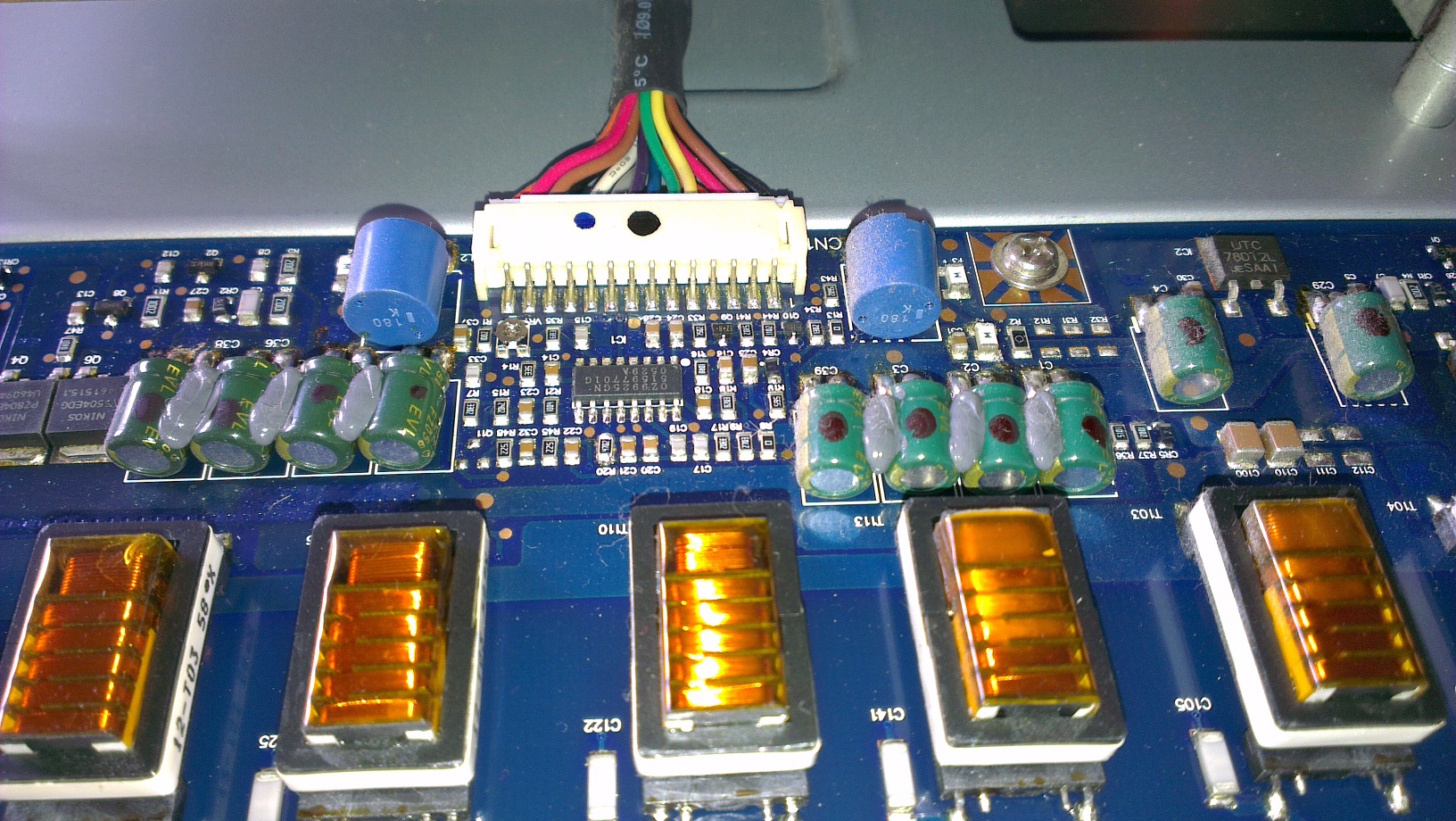

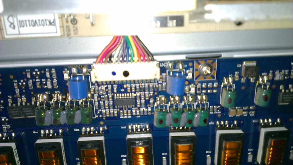

    please see uploads.

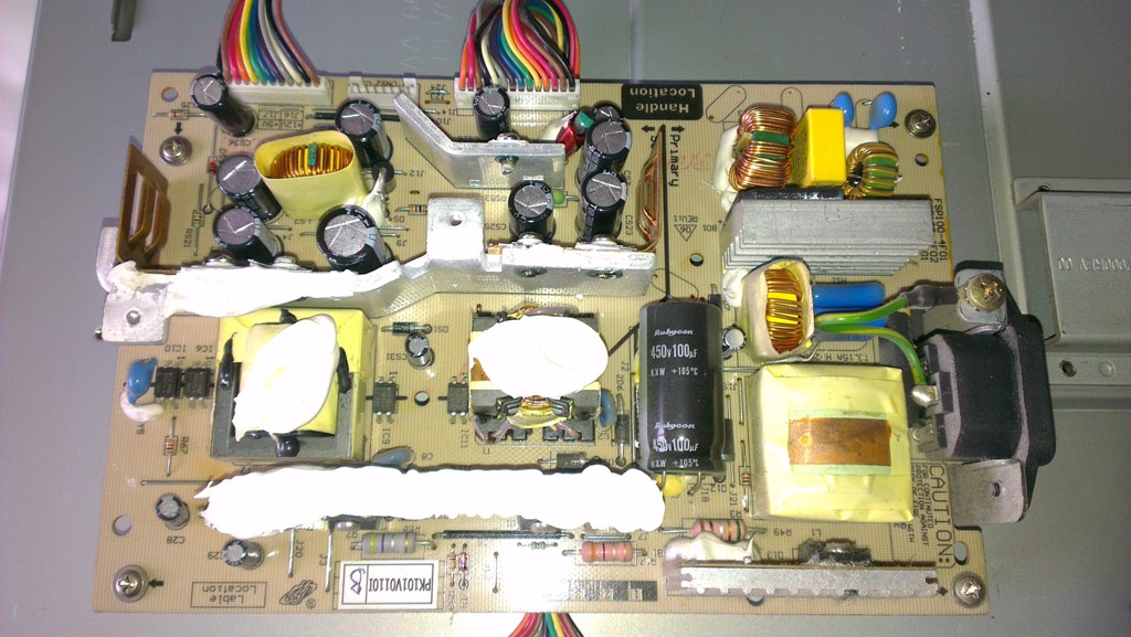

    I have already checked the F3 and F1 fuses.
    Caps dont look like they have burst.
    Ideas?
      Re: Acer AL2416
      Did you check the ESR of those caps on the inverter?
      https://www.badcaps.net/forum/showth...ghlight=AL2416
        Re: Acer AL2416
        The 4 caps on the one side of the inverter are starting to go. If you look close you will notice that they are a little darker green.
        They do not usually bulge on the tops. Usually the rubber on the bottom will start popping out first.
        There actually are 3 fuses
        F2 is usually the first to go, if that is ok, your transistors may be ok especially since you do see the acer logo. If the transistors were shorted and the fuse popped, you would not usually get to see the logo.
        Even if the fuse is not blown, you could still have troubled transistors especially on this version of the board.
        Try changing the caps first.

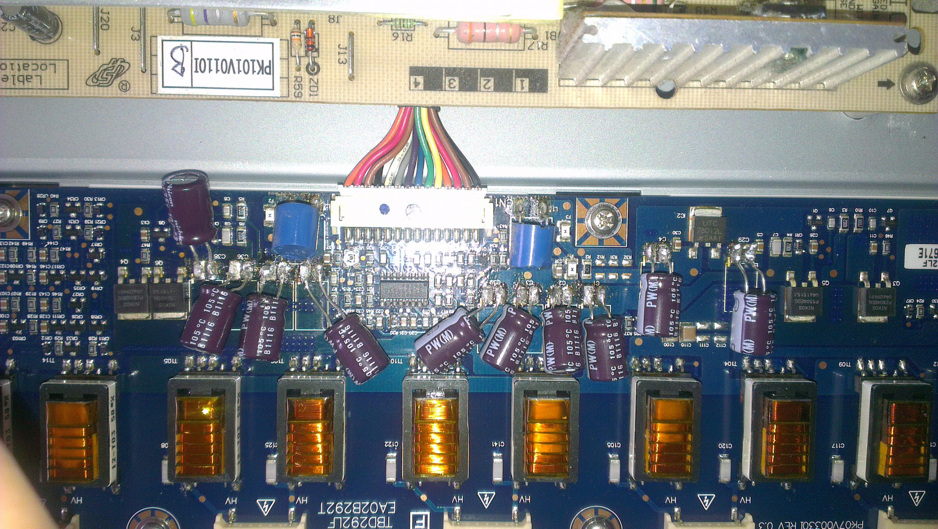

                      Its working! - Top man!
                      My soldering irons tip broke! but I still soildered on!
                        Re: Acer AL2416
                          Re: Acer AL2416
                          Not too pretty since you did not get the capacitors that I pointed out to you
                          those a 8mm instead of 6.3 which is why they do not fit right and they are also not rated as well in lifetime hours
                          But if it works for you ?? OK
