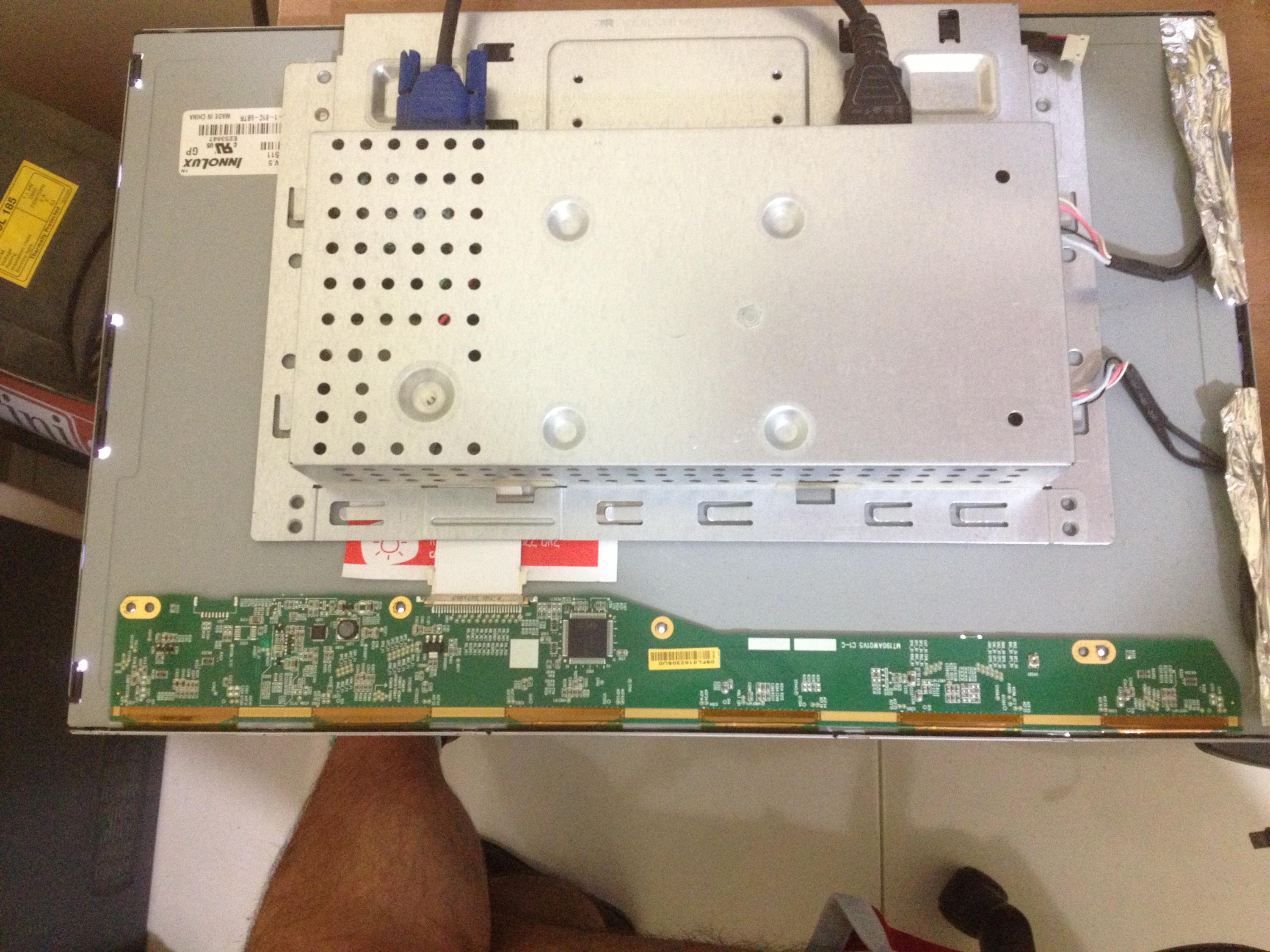

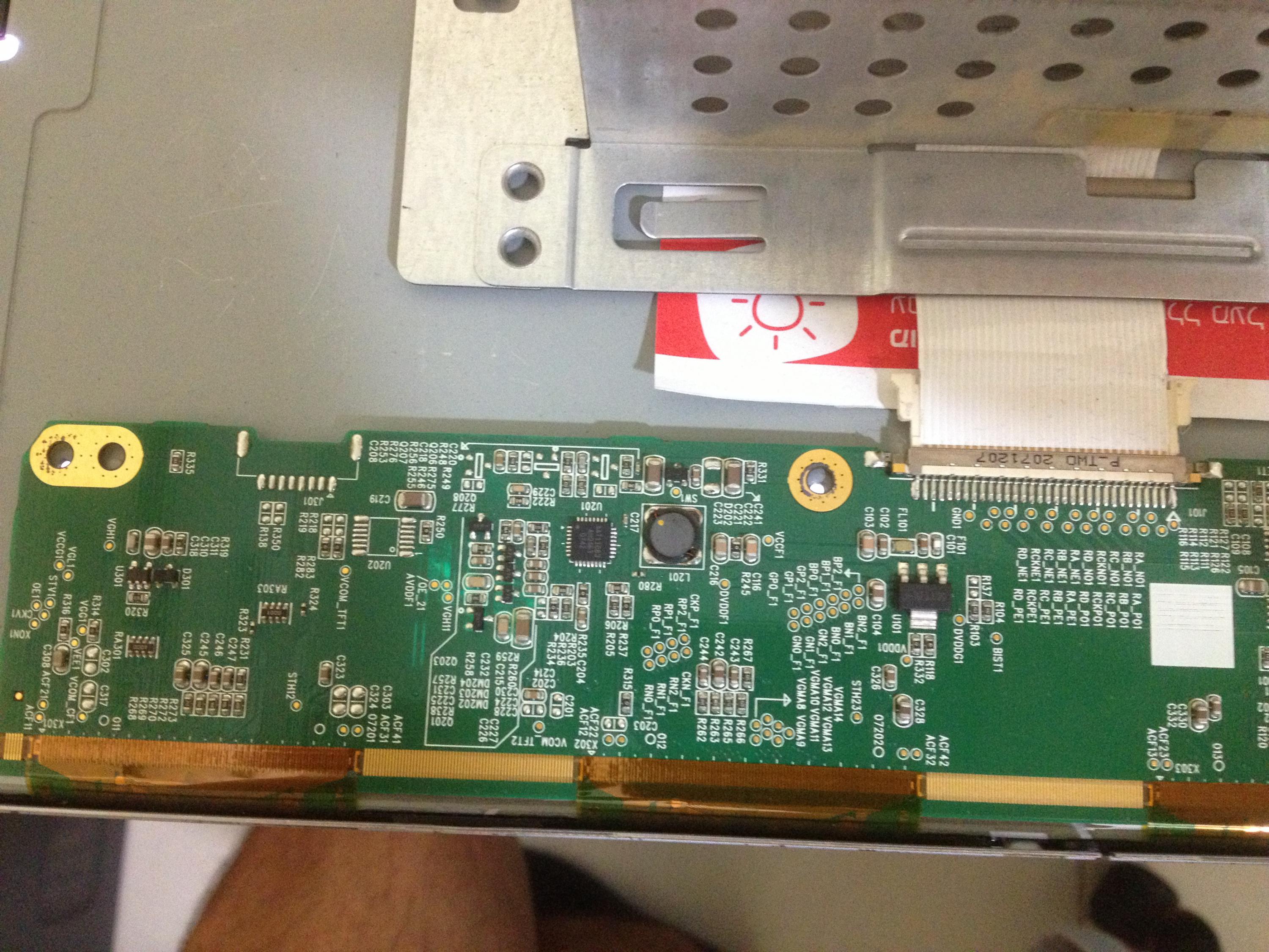

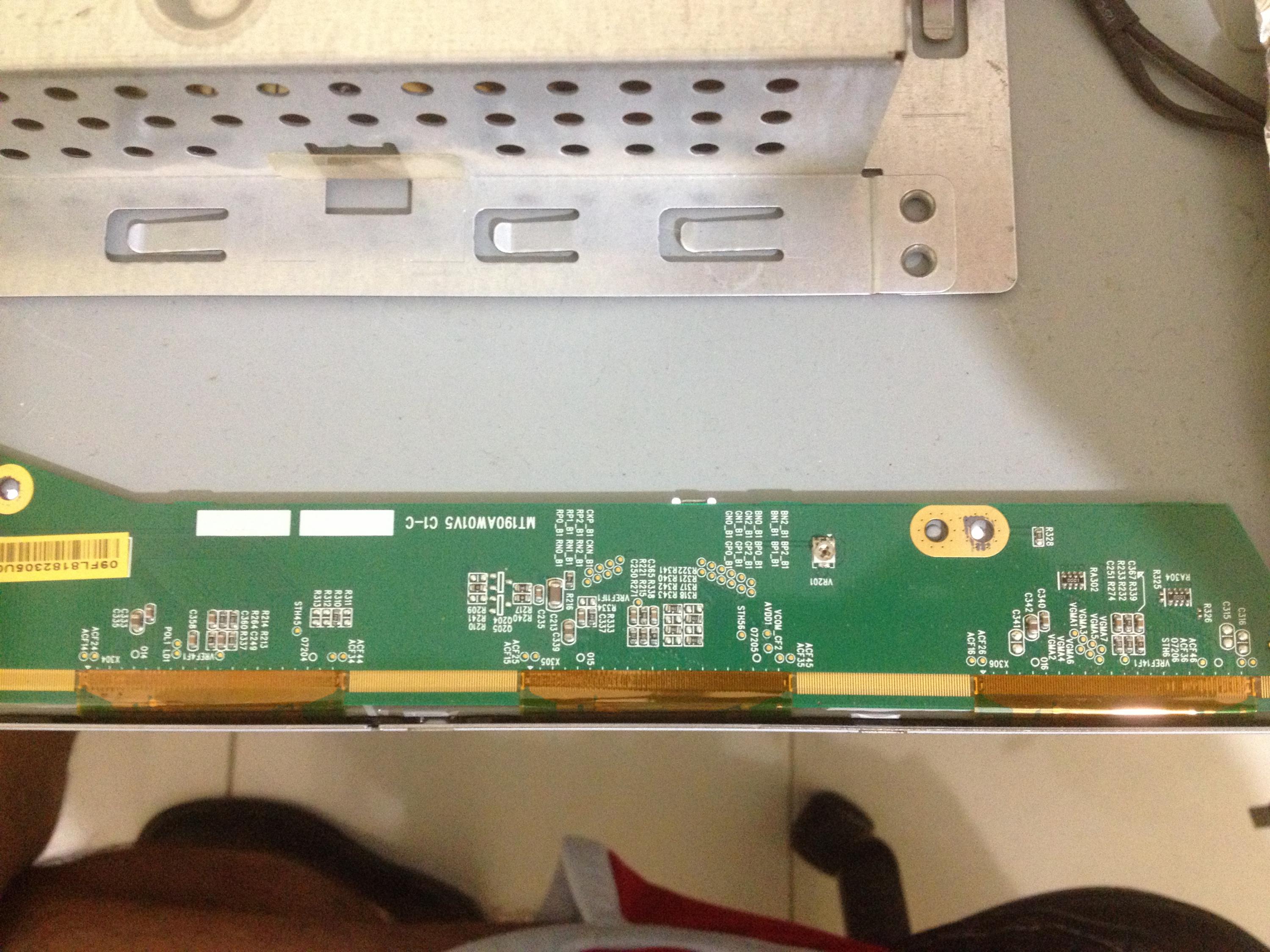

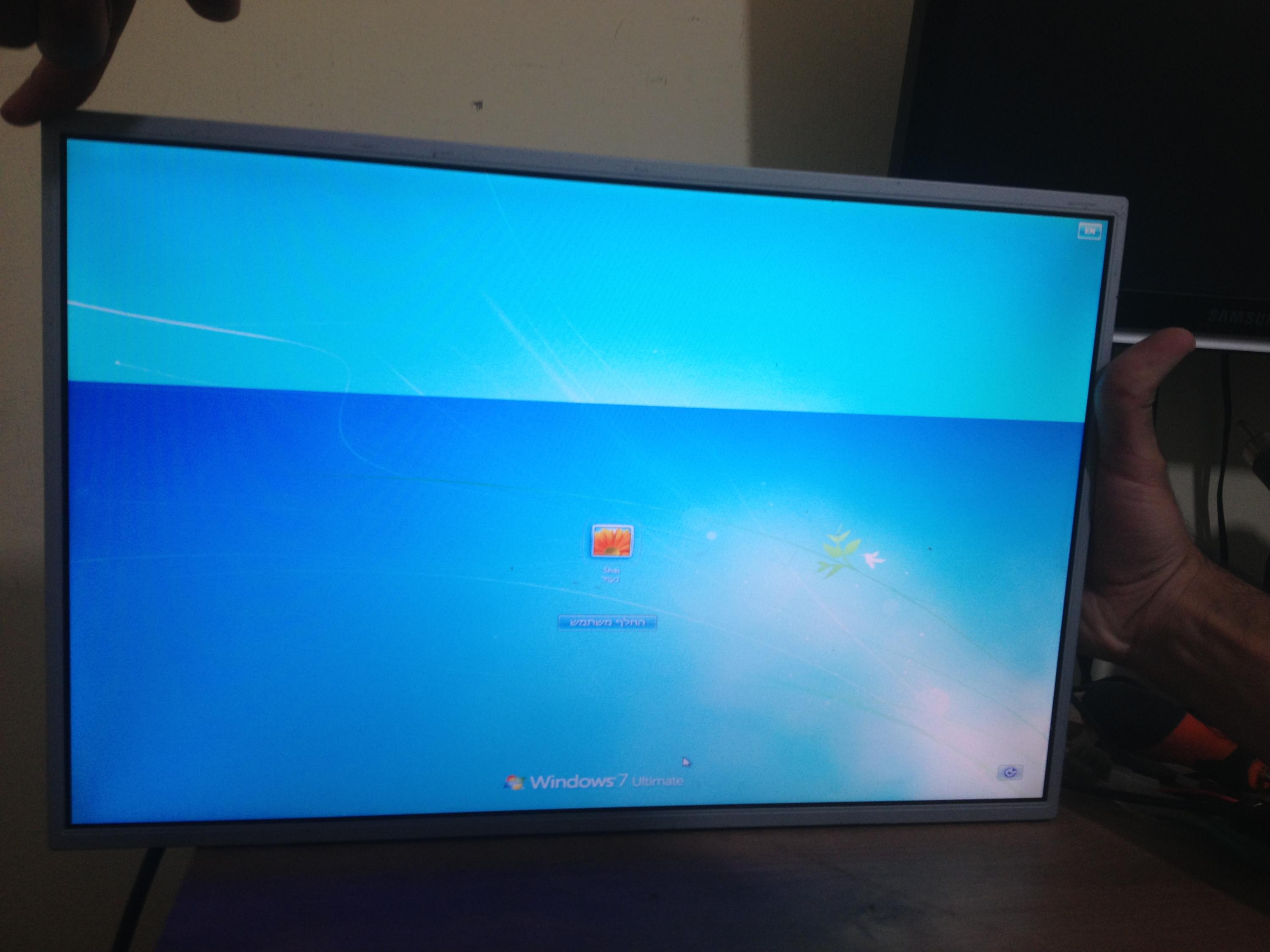

    Got this monitor with bad Tcon/Panel,
    it has a problem with the picture the upper side has much more light
    than the other.
    Tried a complete set of power supply and logic board and got the same result, so im positve its a tcon\ bulbs fault.
    any way of testing/repairing without openning the panel to inspect the bulbs?

    Re: LG flatron L92WS-BN Panel problem
    Certainly not the Backlights,so T-Con,which you probably will not be able to repair, and you may need another Screen.
