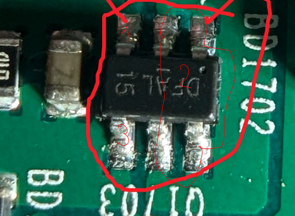

    Originally posted by lotas
    Does this transistor have all legs 1, 2, 3 shorted?
    I'll check now
    • grimreaper420
      • Sep 2024
      • 41
      #62
      yes! i checked the 2 circle highlight in diode mode in multimeter and it beeps and shows 0.000 on all 4 no matter which way i test in whichever combination
      • lotas
        • Jan 2016
        • 4512
        • Russia
        #63
        Originally posted by grimreaper420
        I'll check now
        You circle the entire transistor, and not one of the terminals, so you think what comes to all the terminals.
        • lotas
          • Jan 2016
          • 4512
          • Russia
          #64
          Don't you see that I circled 2 under the number (this is one conclusion, they are connected together by paths), and 1 and 3 are different conclusions!
          • grimreaper420
            • Sep 2024
            • 41
            #65
            ah i see. black probe on 3 and red probe on 2 returns 0.476v (in diode mode), otherwise everything else returns OL
            • lotas
              • Jan 2016
              • 4512
              • Russia
              #66
              It's working, but it's hard to check remotely with you, I'm already tired, check these points again, between 1 and 2, between 1 and 3 and between 2 and 3, what's the resistance.
              And also with 4 (1-4, 3-4).

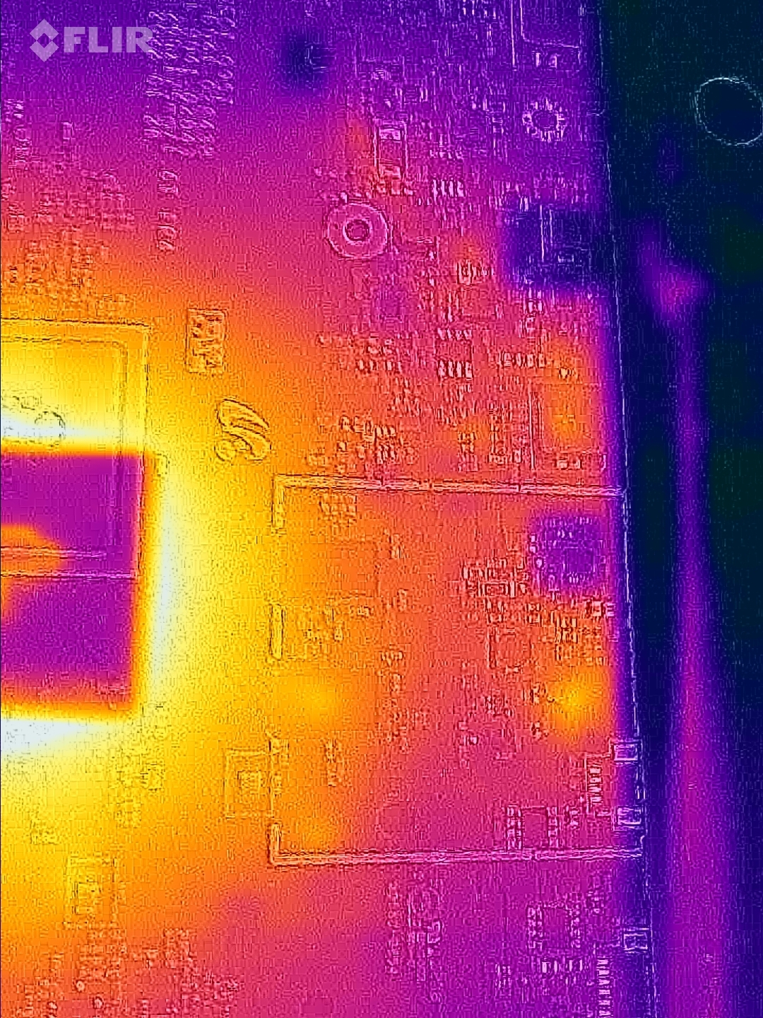

                            I bought a Lab power supply and thermal camera today. So that might help with diagnosing too?
                            • grimreaper420
                              • Sep 2024
                              • 41
                              #74

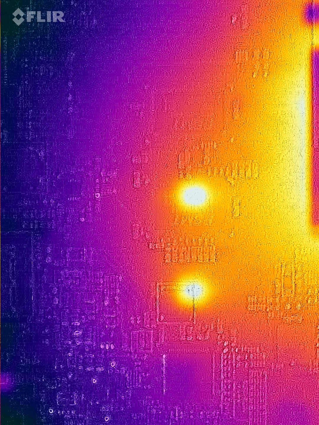

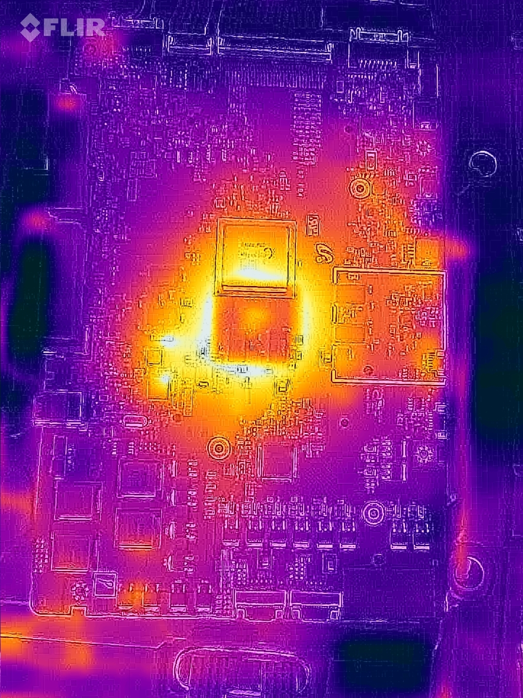

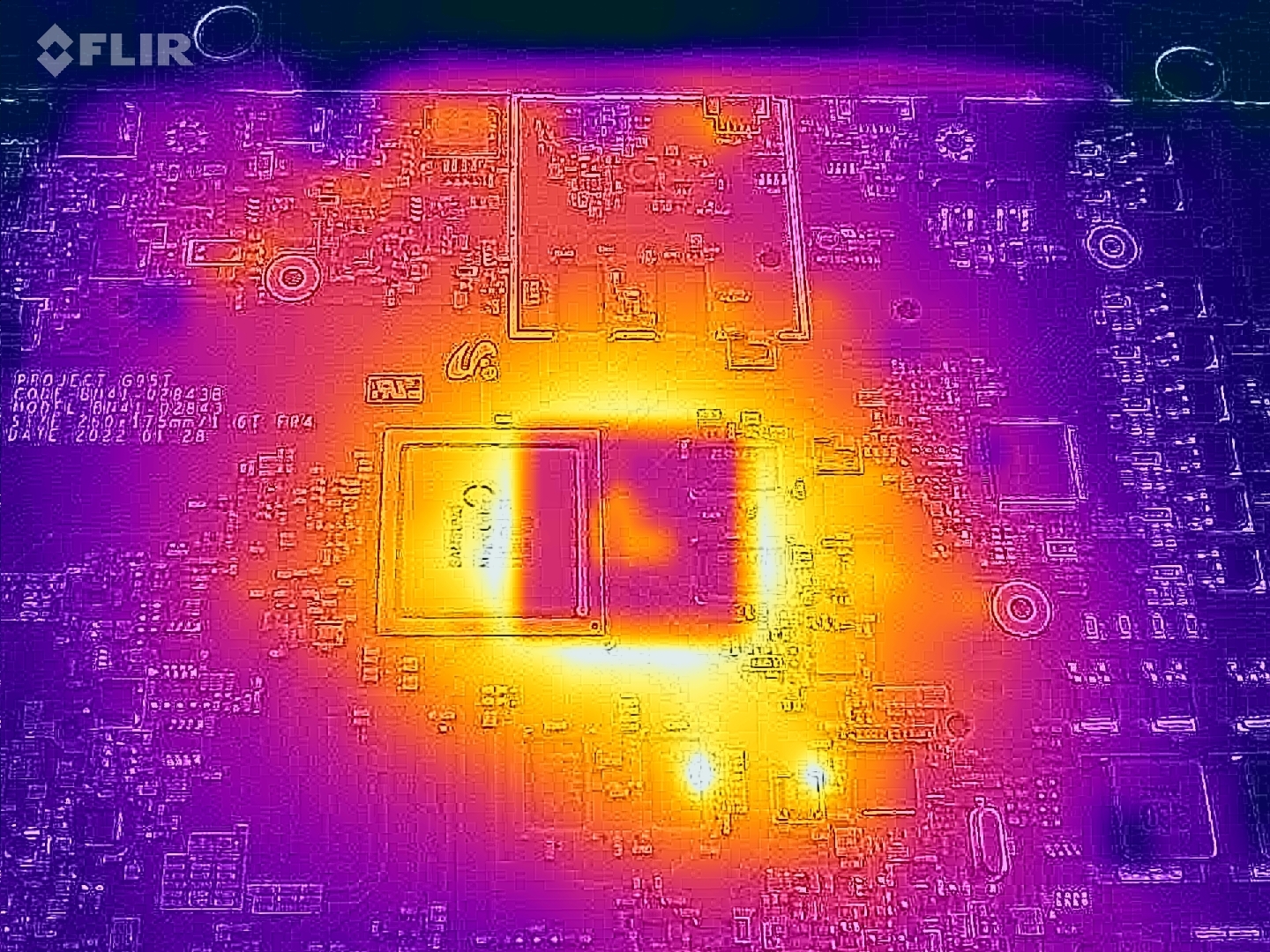

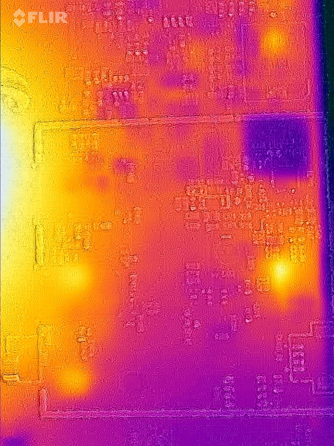

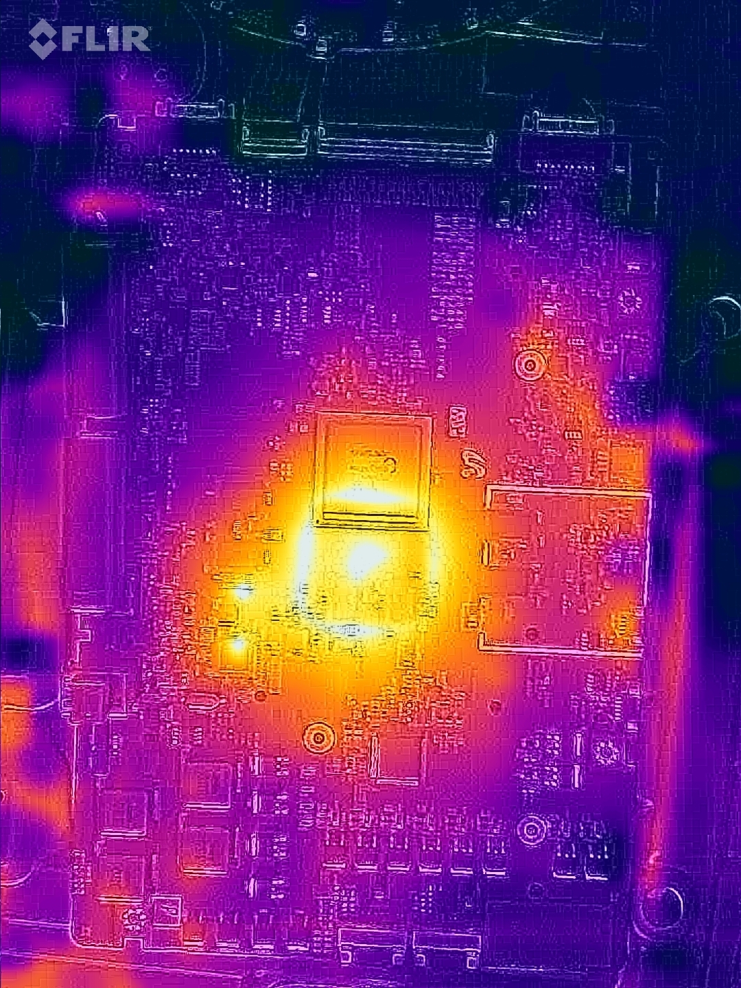

                              Just used the thermal camera, and can't see anything suspicious. I imagine, the other side of the board is not heating up because the fuse it blown, but weirdly the power button still works, so I'm not sure how its getting power if the fuse is blown.
