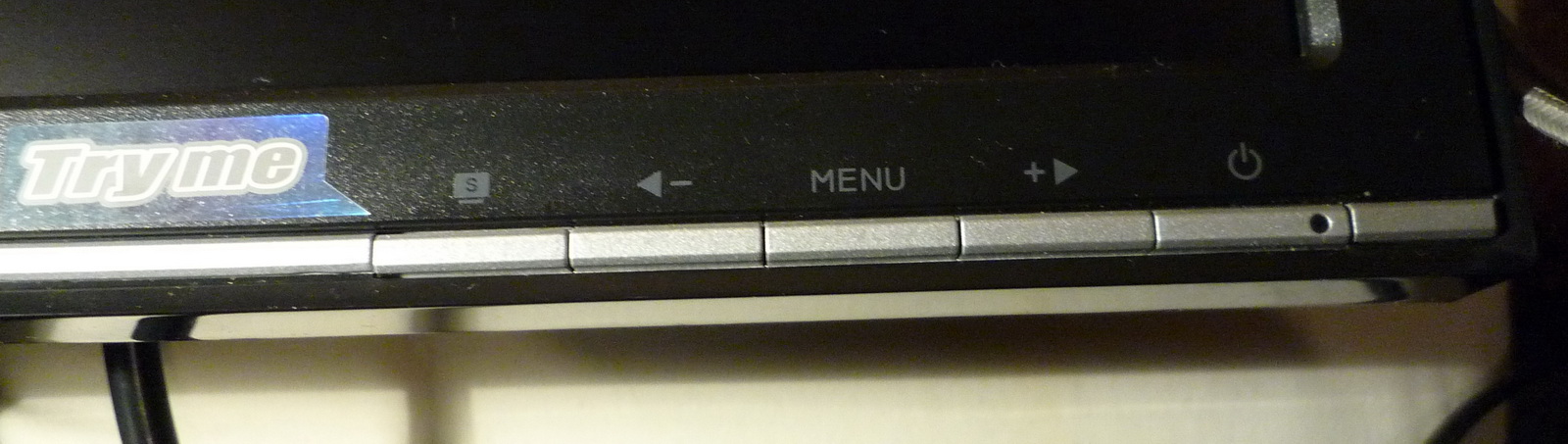

          You're right, there's what you wrote. Only thing that does something is button minus and button menu at the same time... it saying Enter and Right, but there's no Enter button. I tried the guides from Google, but nothin works.

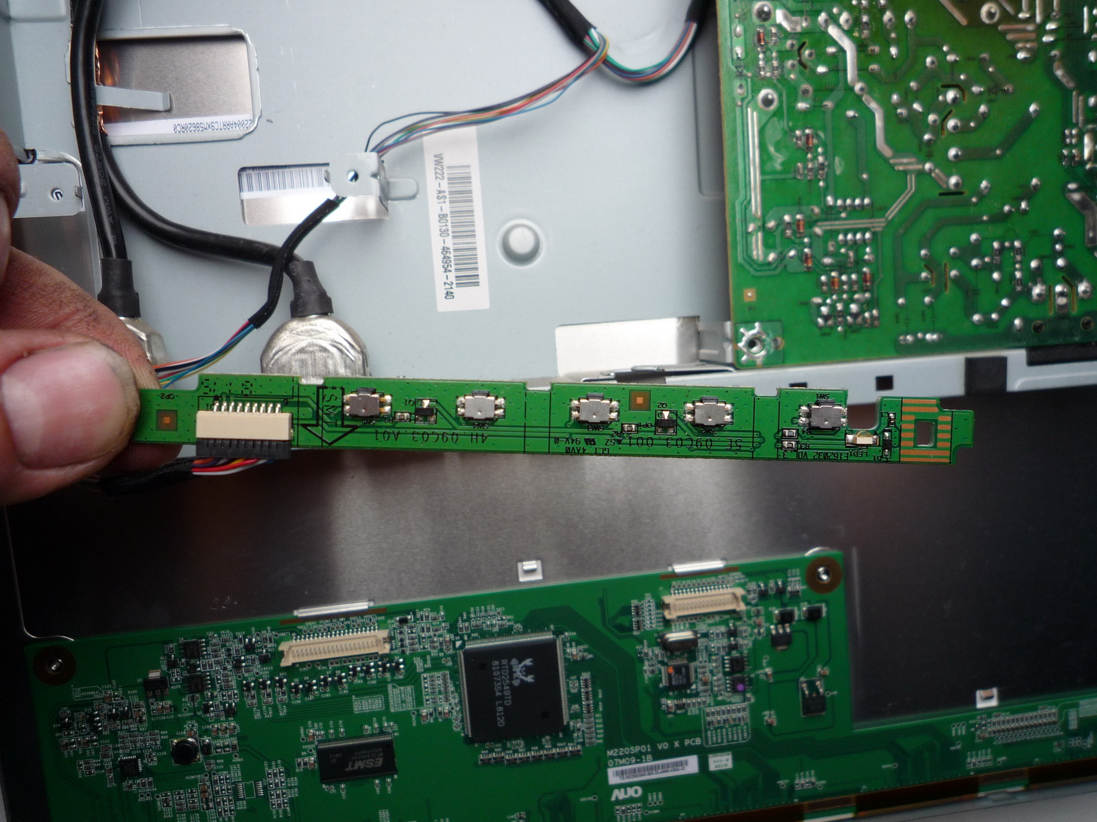

                      Well, the monitor isn't mine. Good idea with the user manual. The buttons are connected to the main board to pins (smaller white conn):
                      "Power" button - black wire, pin T1
                      "+" button - yellow wire, pin T3
                      "Menu" button - green wire, pin T4
                      "-" button - red wire, pin T2
                      "S" button - white wire, pin T2

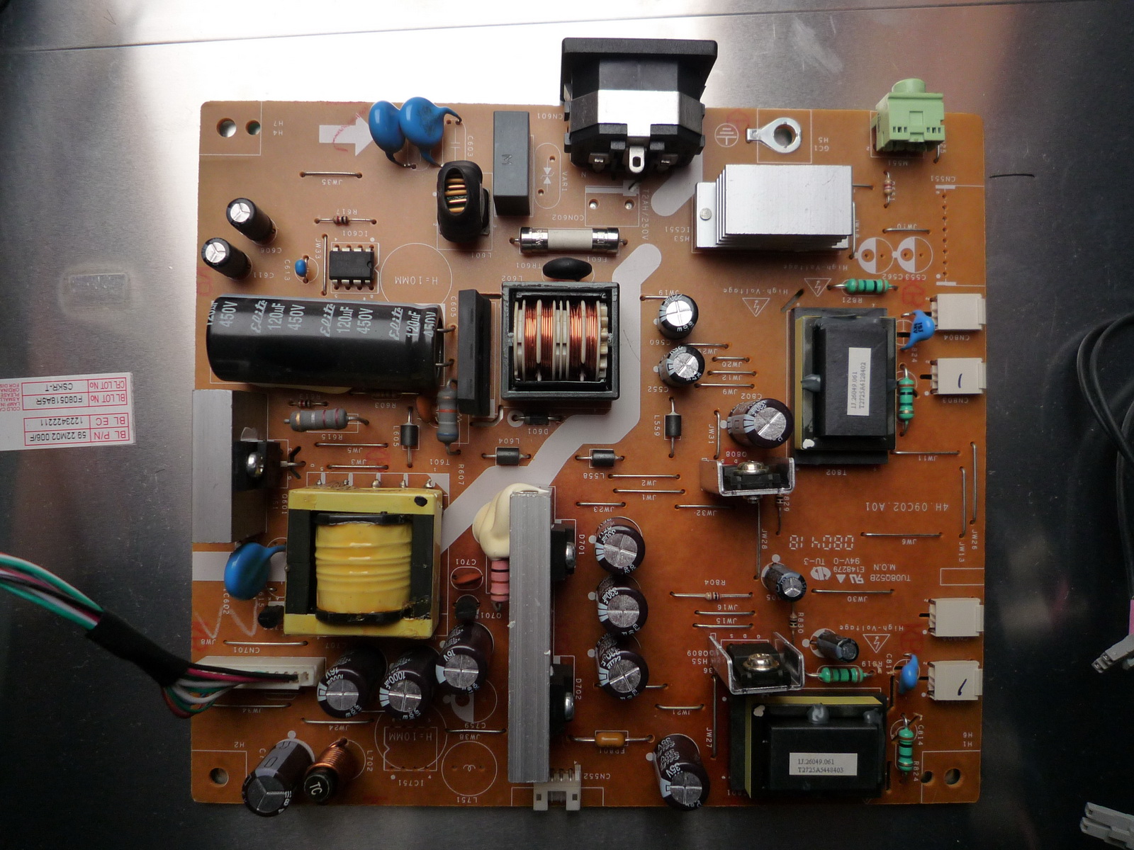

                      I also measured all voltage regulators, are ok.
                      Voltage "BLADJ1" - 4,42V
                      Voltage "BLEN1" - 2,73V
                      I'm trying to find the SM, but isn't easy.

                          Re: ASUS VW222U, burn-in mode has become activated
                          Good picture of the button board - did you say you tested each button and also tested at the connector. There a few posts on the www about these buttons sticking.
                          I can t see where it plugs into the main board did you miss that picture?
                          Attach button board instruction from user manual

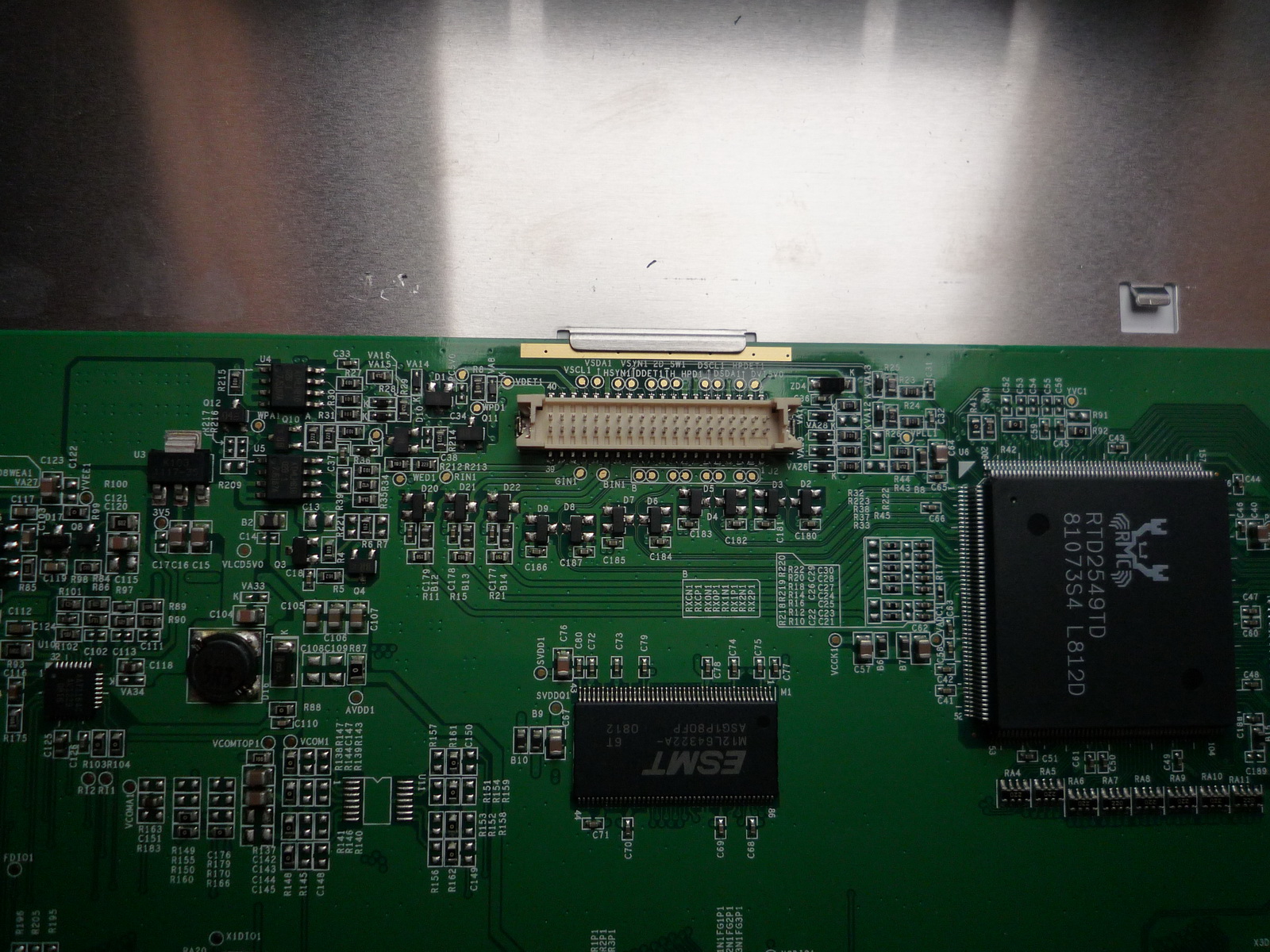

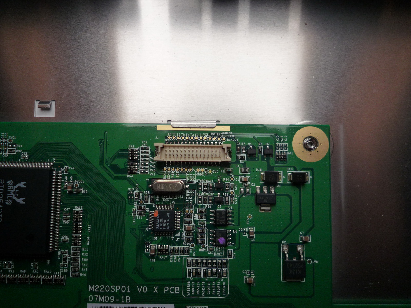

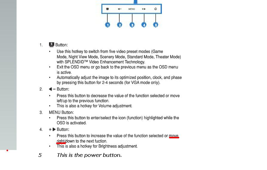

                              Button board is connected to the main board thru conn. on 3rd pic (close to this connector is Quartz crystal).
                              This manual I have.
                              according to it, the menu button = enter
                              and the + button = right.
                              Holding down the menu and power button for 7 sec. and then only menu button do nothing.
                              also
                              menu button and + button and power button at the same time (it say enter and right) nothing.

                                    i will risk to seem annoying but from what i remember you never said that you pressed
                                    Menu + > ... ok seems also obvious but you never said.
                                    if this doesn't change you can try esotic tries like resetting the user flash eprom, tell the part num. of all 8 pin chips on logic board, we can study if there's a method of forcing.
                                    I never done this, on an example datasheet i have found no clear info but i don't have read all well.
                                    • Phoenix83
                                      • Jan 2014
                                      • 53
                                      • Slovakia
                                      Here's all 8pin chips:
                                      U4 - ATMLH810
                                      U5 - ATMLH810
                                      U8 - ATMLH804
                                      U9 - ATMEL804 these one is marked with purple paint
                                      Menu + >, tried as first
