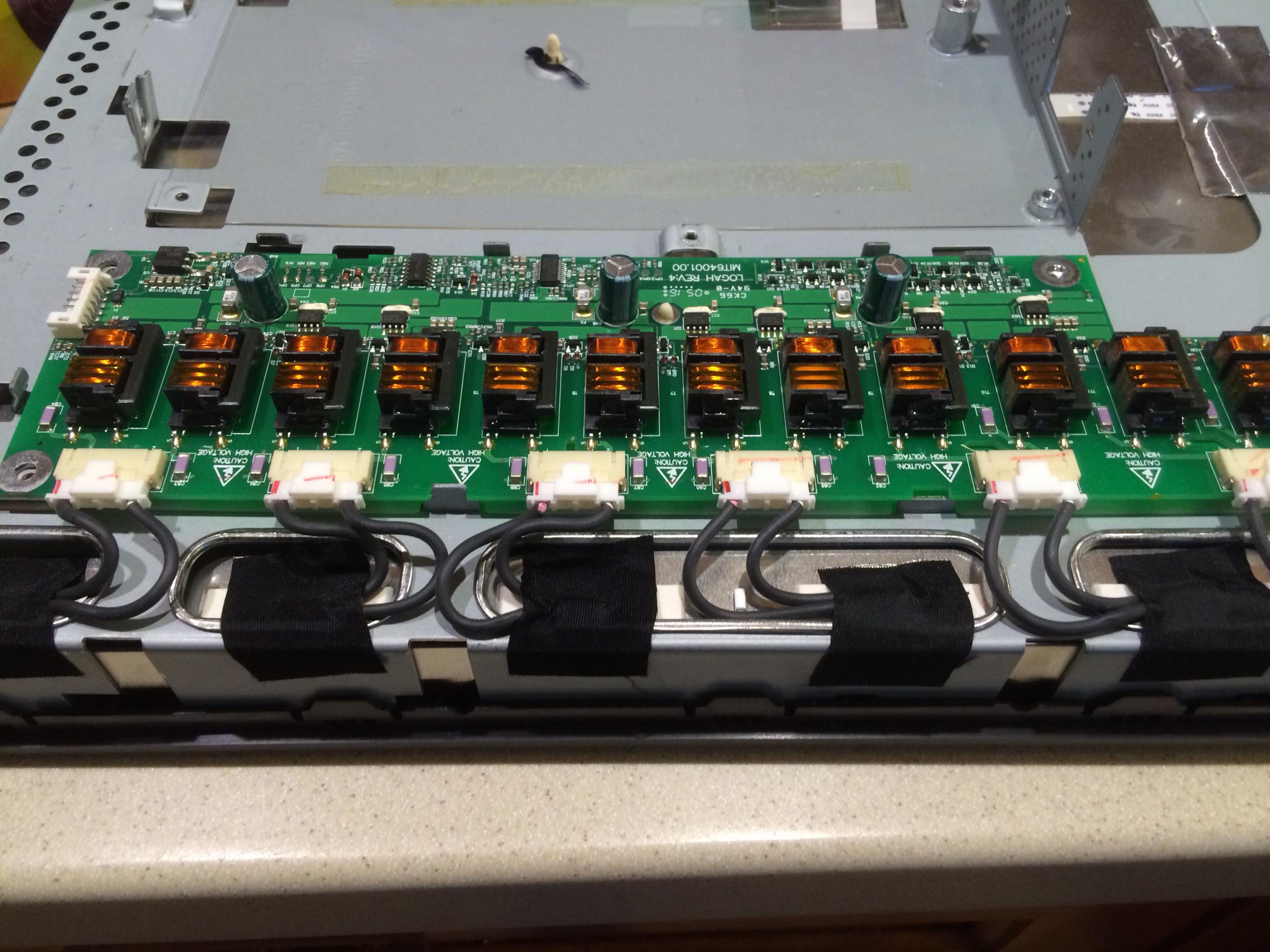

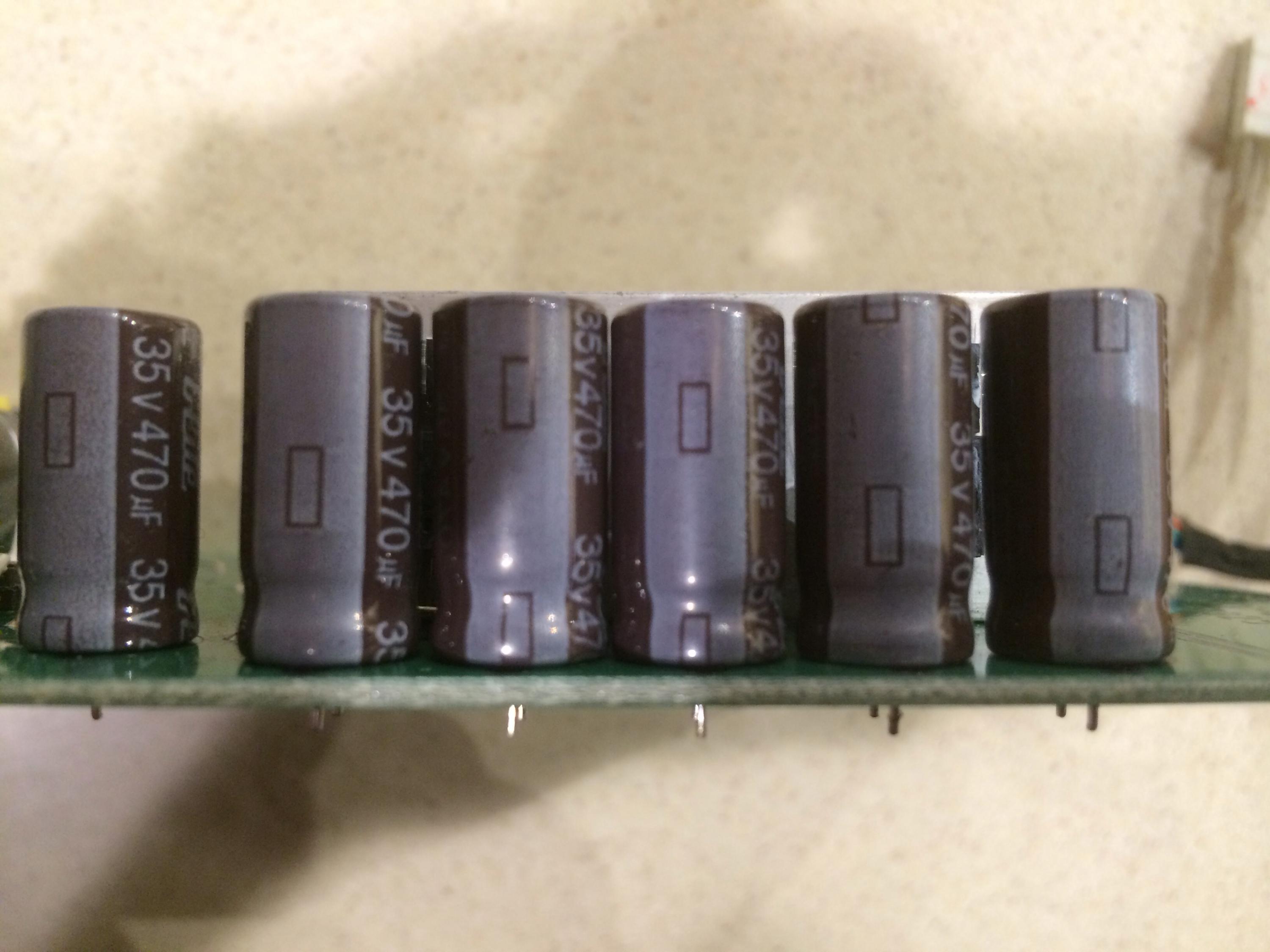

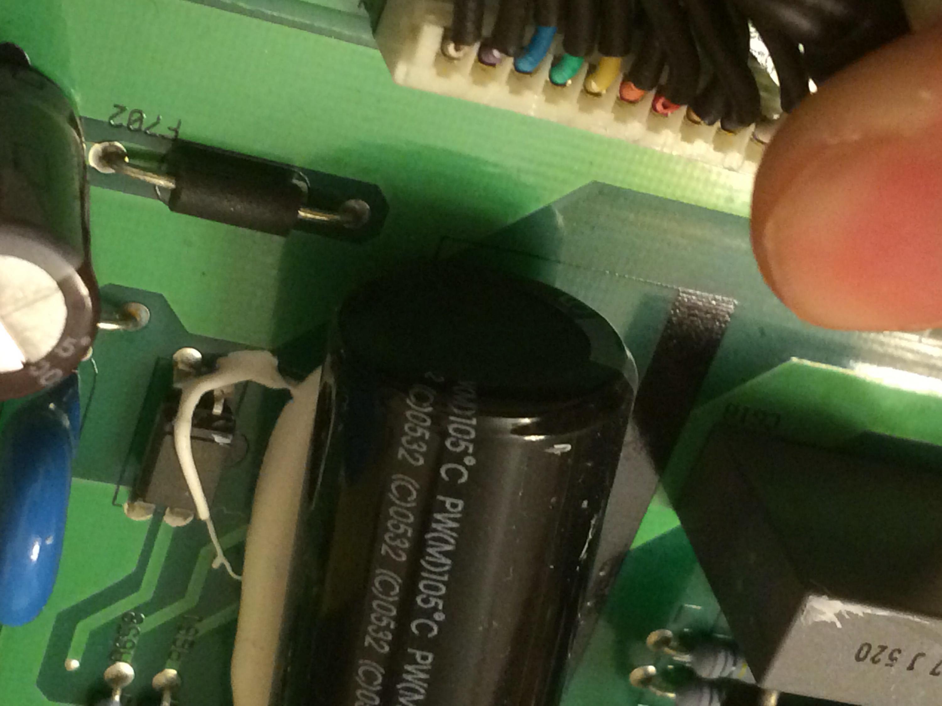

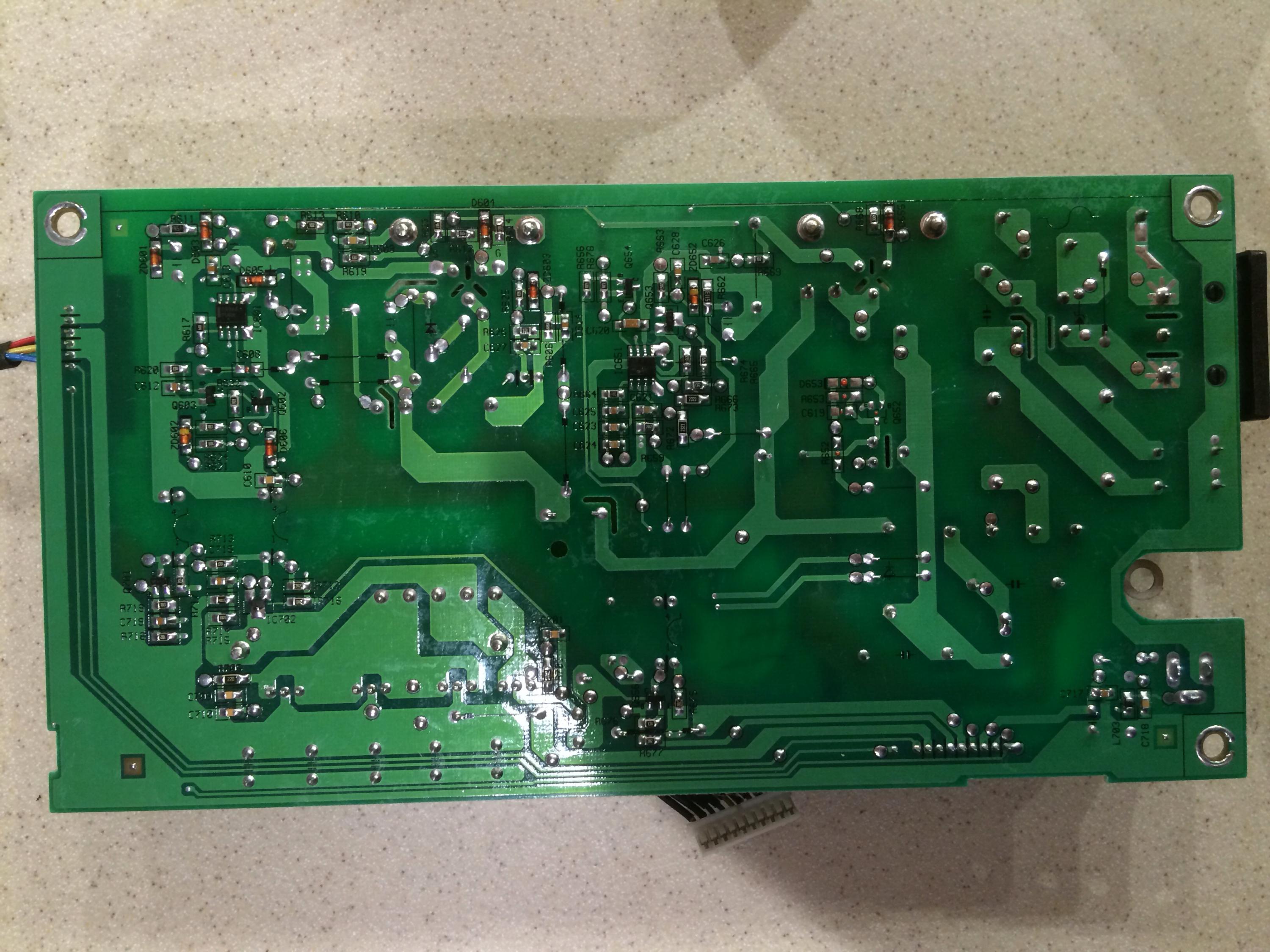

    I have a broken Dell 2405FPW. There is no sign of a backlight, an image with no backlight, and the lights on the front (power LED) do not illuminate. When plugged in there is a high pitched whine from the power supply. The caps are Elite and Lelon, but don't show any physical issue to me. I tried to measure the voltages that it gave to the logic board and the backlight board.

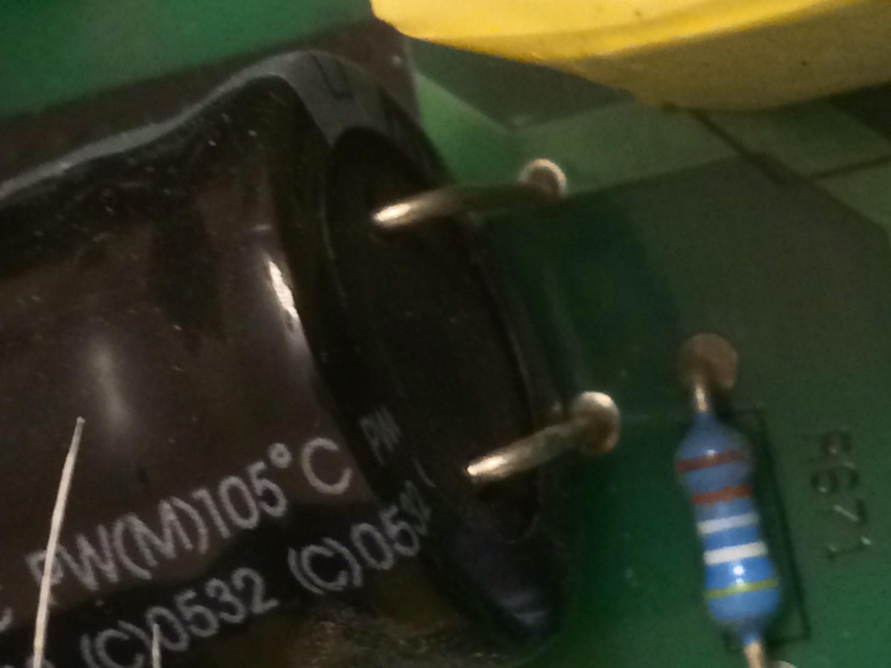

    The capacitors on the power supply are as follows:
    450v 120uf PW(M) Elite
    6x 35v 470uf EL(M) Elite
    2x 35v 47uf Lelon RGA A523(M)
    1x 100v 1uf Lelon RGA A523(M)
    1x 35v 220uf Lelon RGA A523(M)

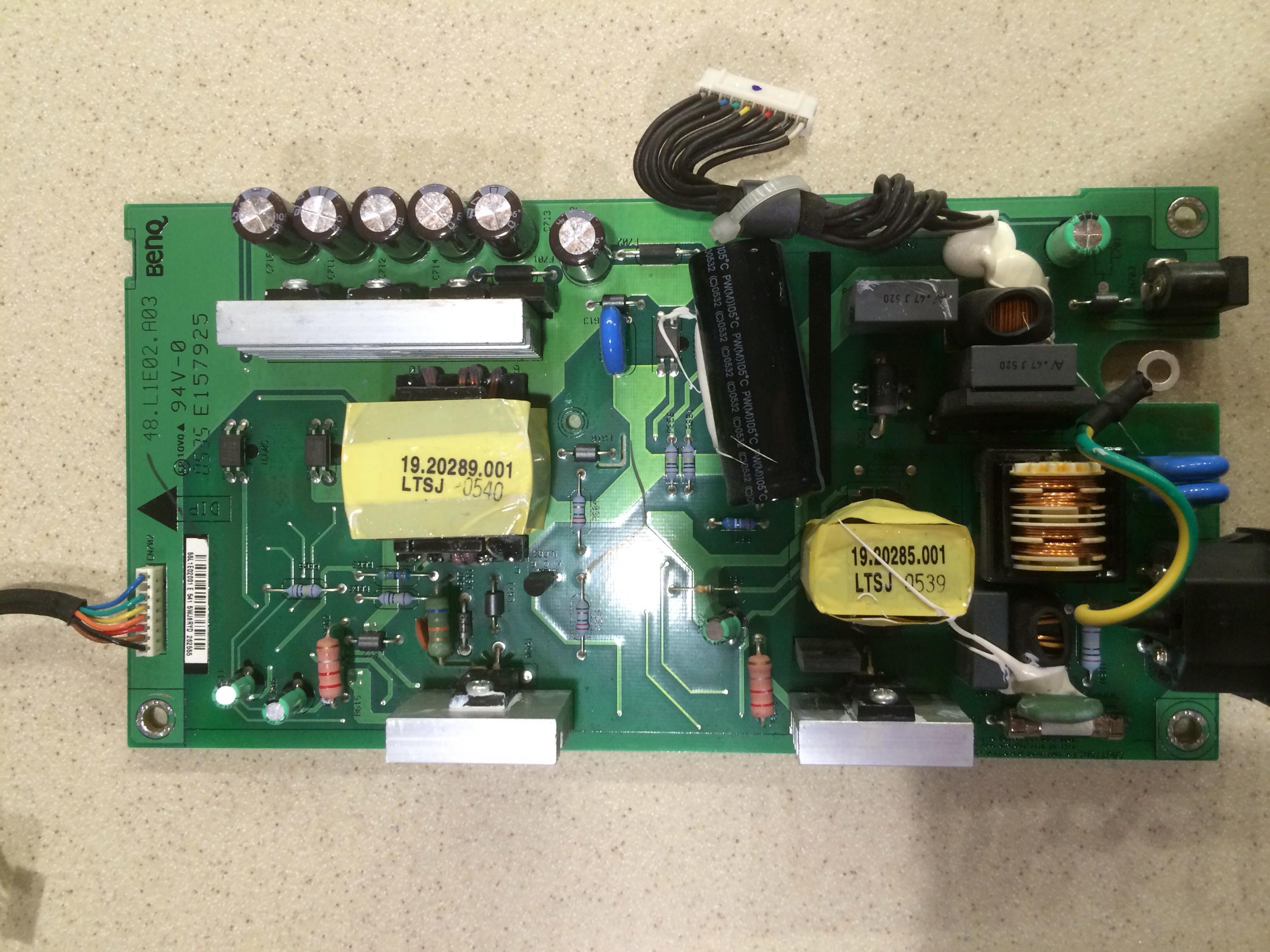

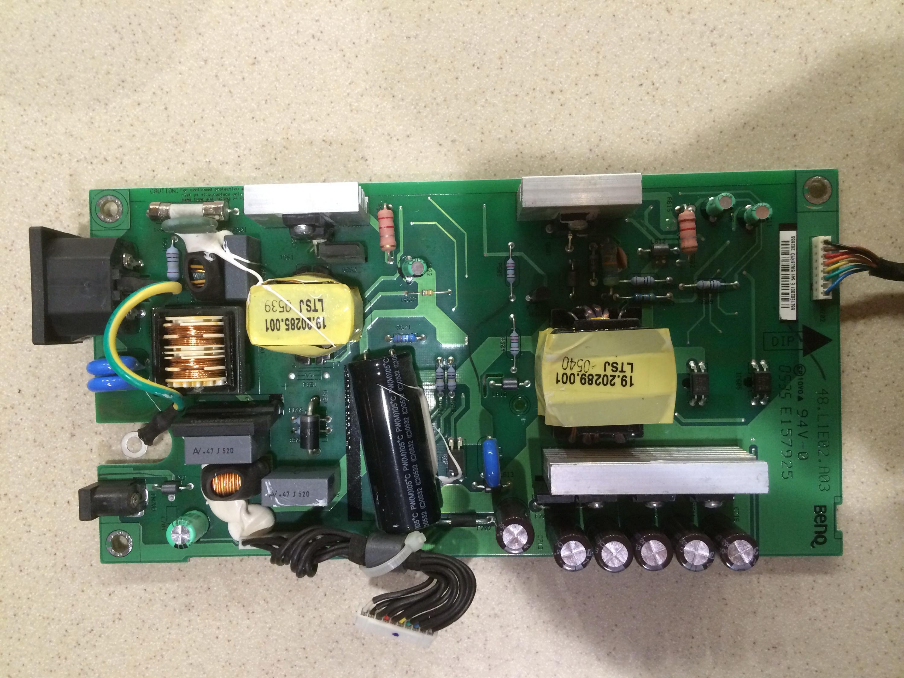

      Ill set the ball rolling- with a question. Are F701 and F702 fuses or
      ferrite - either way test them as fuses. No power to board.
      meter on ohms200 probe to each end.
      Did you have the boards all connected when testing at socket

          This may help:
          https://www.badcaps.net/forum/showth...FPW#post359898
          https://www.badcaps.net/forum/showth...t=Dell+2405FPW
          But your meter voltage reading does not seem right.

              Got an ancient meter working. F702 has no resistance, F701 has infinite resistance.

                ok - it will probably say on them or on the board what value they should be.
                I would order a few or a fuse holder that will take loose fuses.

                  F701, the faulty fuse, has the identifications printed face down. I have looked around this site and the only specification that I can find is that it is a 5 amp fuse. What do you think the voltage would be. I'll have a soldering iron soon so I could just desolder it and order it, but if you have an idea, I could order now.

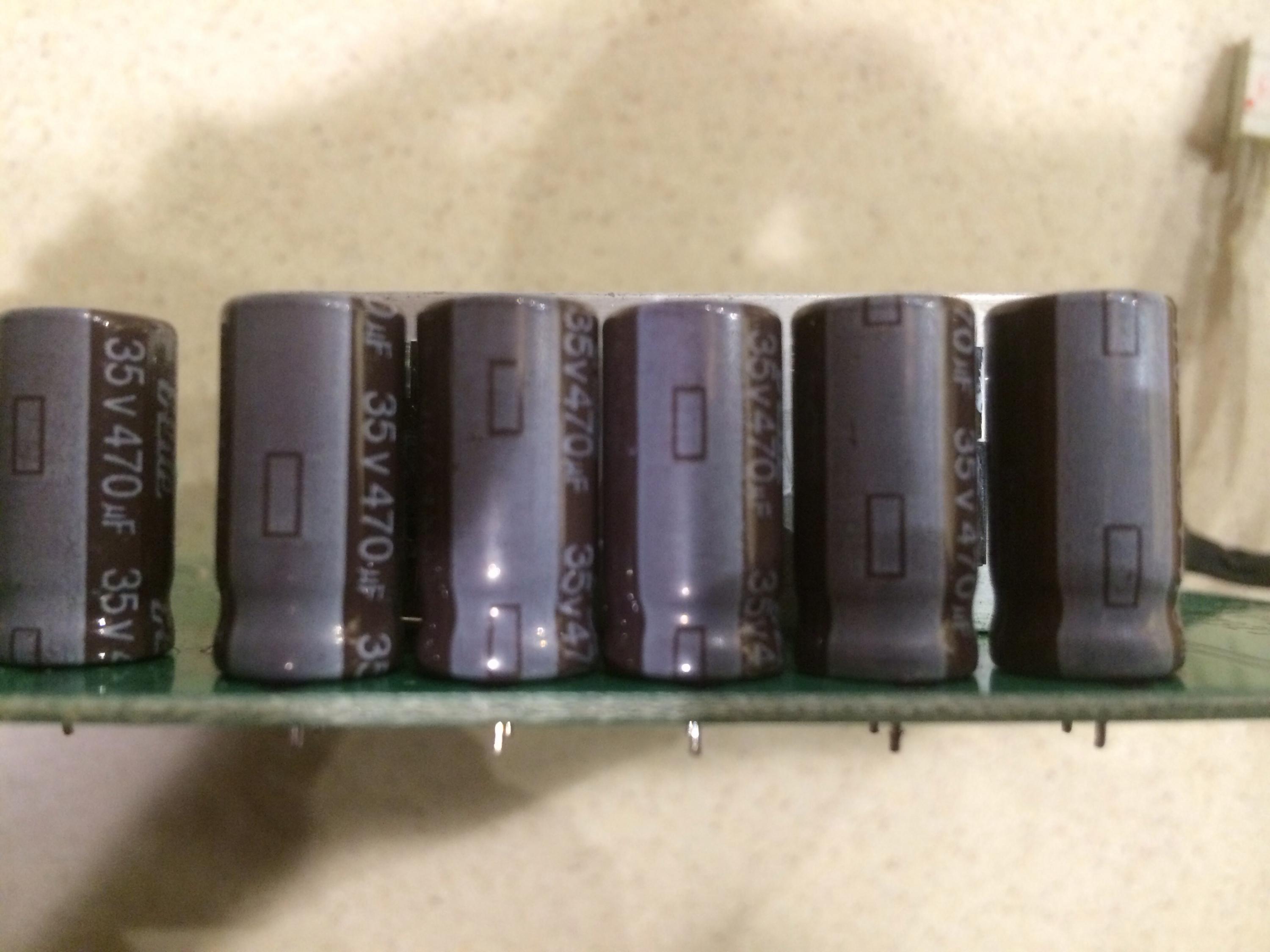

                  I ordered a bunch of capacitors a while back for this, but I believe that they might have too high of an ESR to be useful. The caps are as follows.
                  120uf 450v Nichicon PZ Series
                  470uf 35v Nichicon NHG Series
                  47uf 35v Nichicon NHG Series
                  1uf 100v Nichicon PZ Series
                  220uf 35v Nichicon VZ Series

                      Almost any nichicon is probably better than Lelon or Elite but if you can stick to panasonic FR FM or FC (from best to less best) for the small caps - the
                      big cap is ok.
                      Nichicon should probably be HN or HZ
                      Incidently the links you gave to digikey are not for the caps described??
