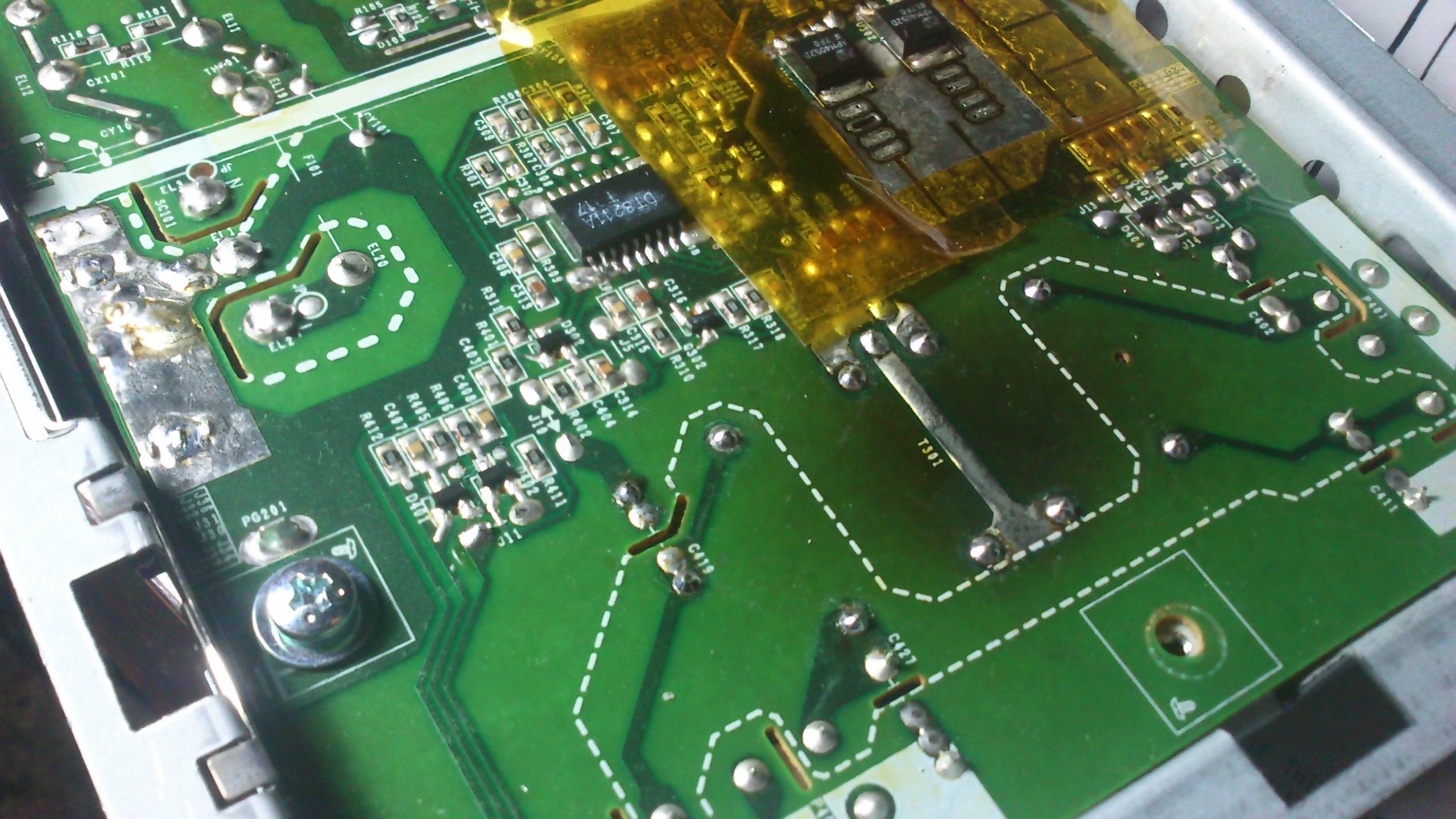

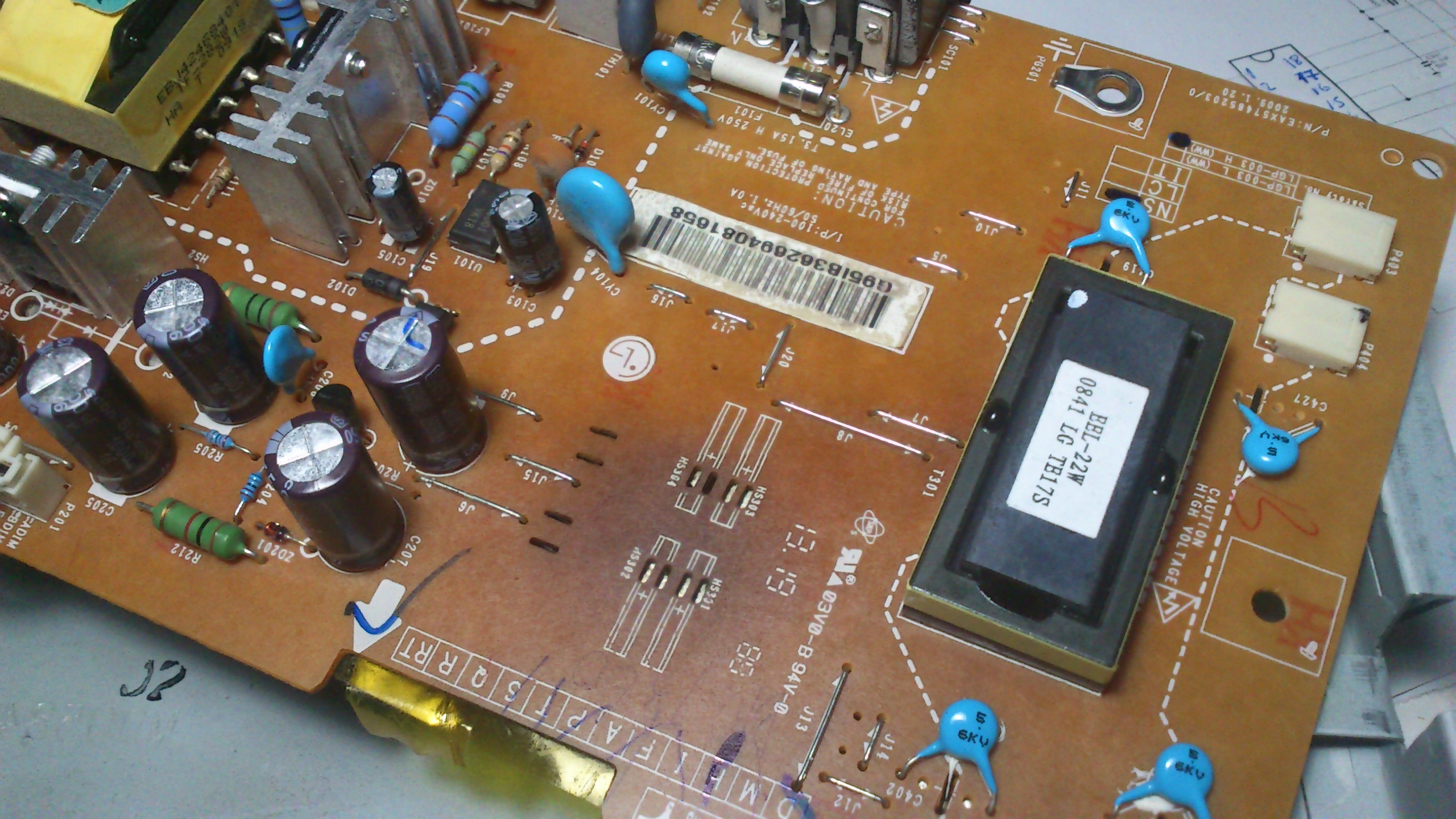

    This monitor faces 2 seconds to black problem.
    Image is still visible when direct light hit the screen, so the logic board seems to be ok for now.

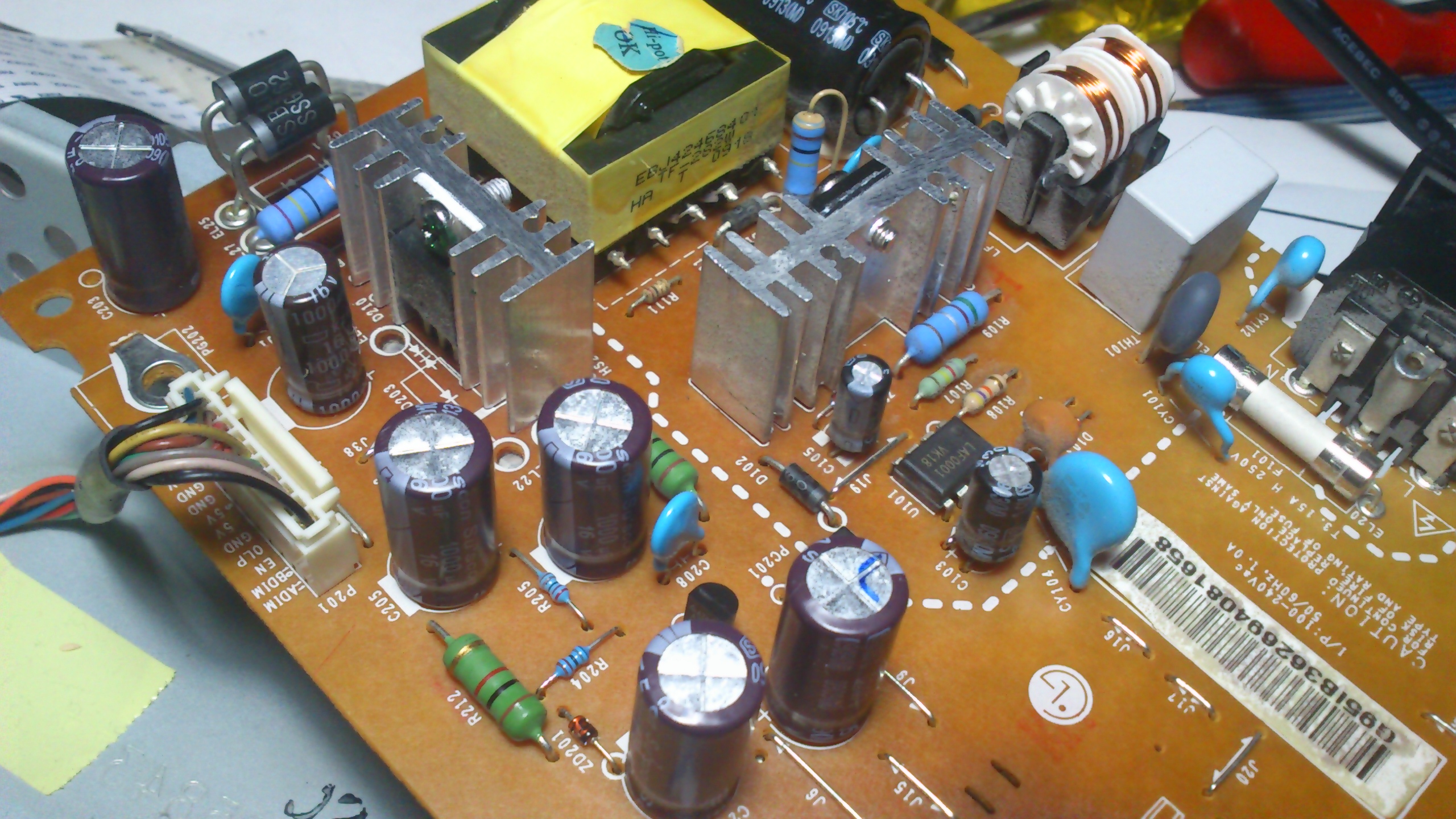

    --I have already checked the transformer. Both inputs and outputs ohms are ok. However I replaced it with a spare one. Problem persists.
    --CCFL are also good. I checked all 4 of them one by one, and all together with another inverter. Everything fine.
    --2 dual mode Mosfets are ok. Both measured and checked outside of the circuit.
    --Capacitors are all also checked. One of them was faulty and replaced. All other are good both with their capacity and ESR value.

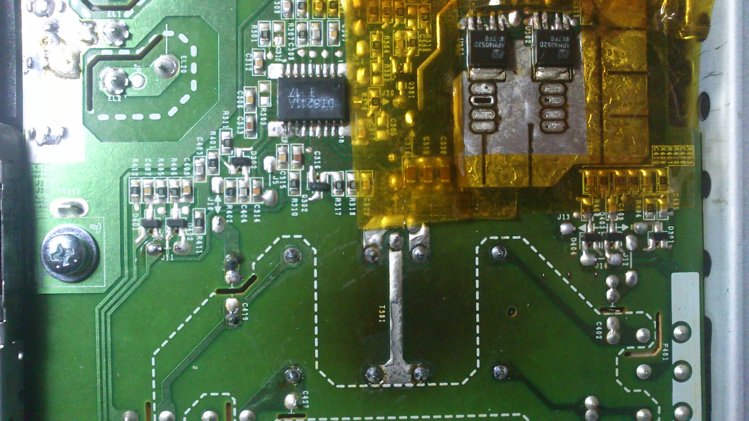

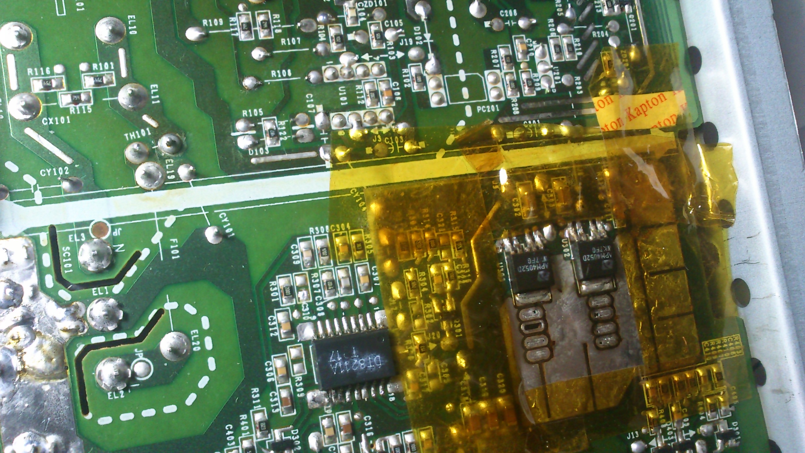

    I focused on IC DT8211 Light Inverter drive.
    Pulse at pin 7 is triangle and correct. It is on all the time when monitor is on.
    Pulse at pin 8, 16 and 17 seems ok but is off when monitor turns black. Seems as normal behavior because if the pulse at pins 16-17 stays alive then the HV will work and so does the CCFL.
    Some voltage at pins 1,6,18 is ok too.

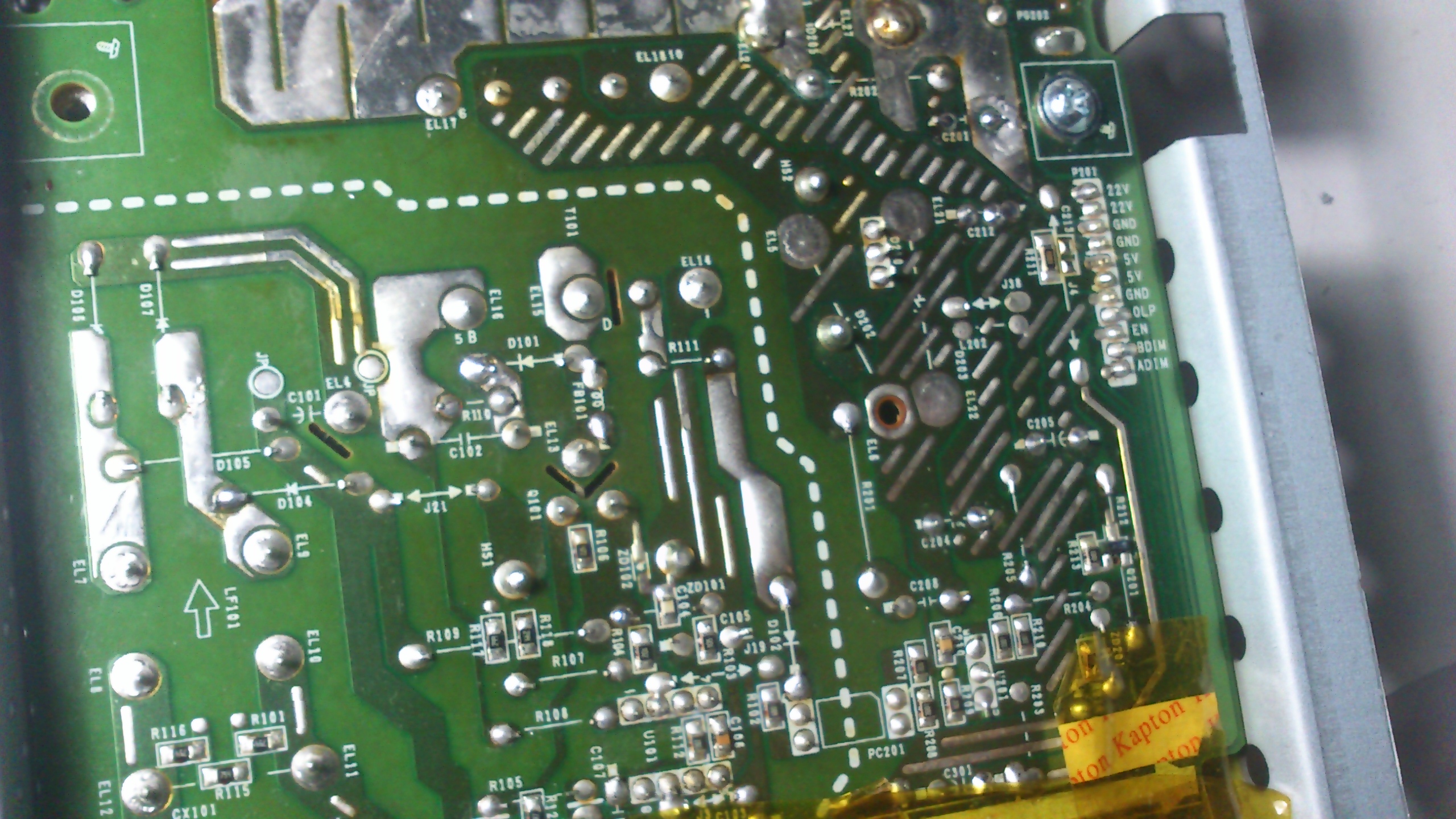

    I tried to isolate the feedback section of the IC. So i desoldered pins 10,11 as it seems at the photos. Stll the same 2 seconds to black problem.
    Is there any way to check if the IC is wrong? I don't know what else to check... I only missed the SMD resistors and capasitors (SMD diodes are checked OK)...
    Maybe there is something wrong with other power supply signals or probably the logic board? for example signals like ADIM, BDIM... any way to test them?
    Any help will much be appreciated. This schematic seems to be very close to W2053TQ as for the inverter part.(page 23)
