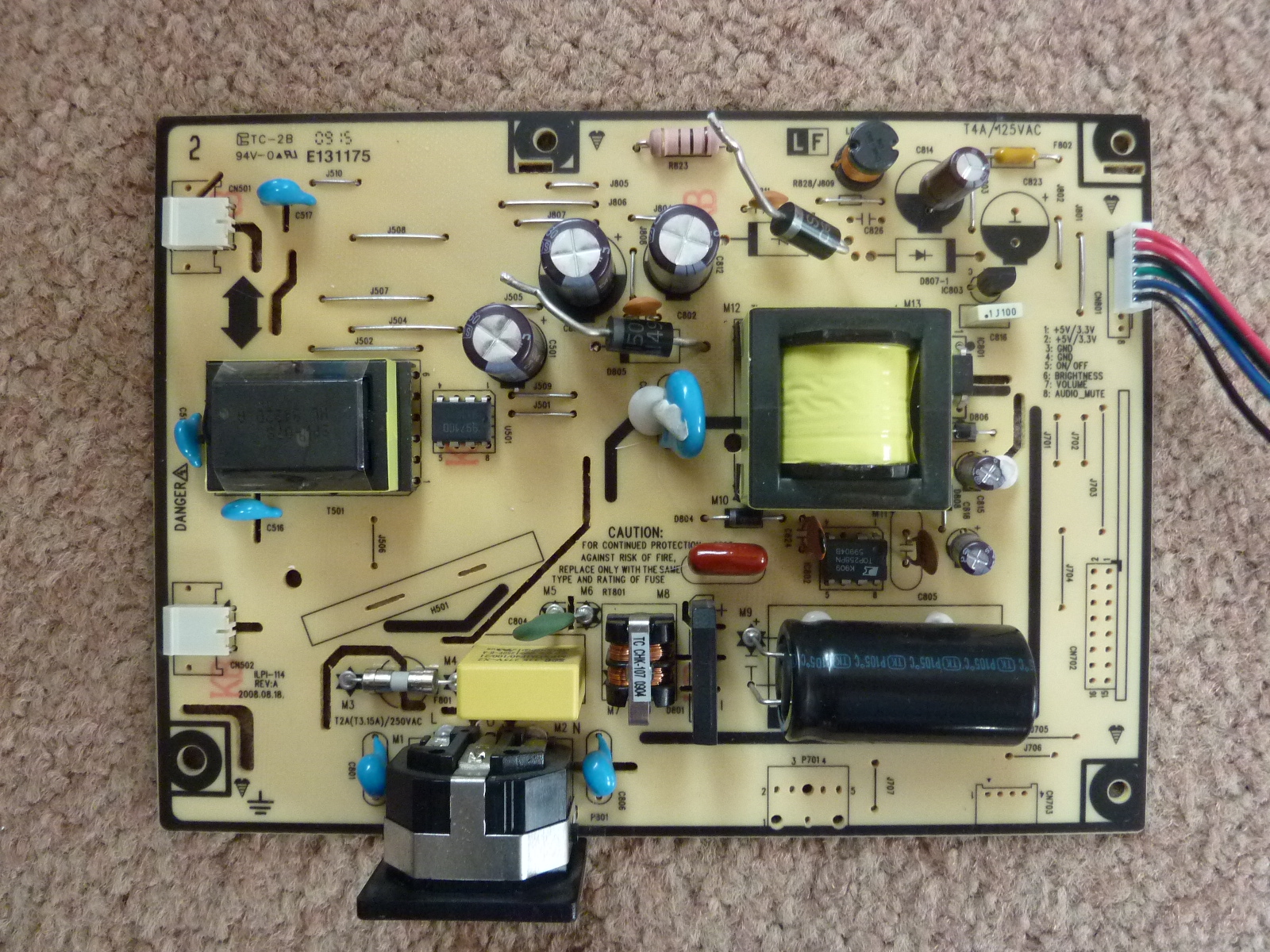

    LG W1941s strange problem
    I have a strange PSU fault on this monitor, the monitor turns on and works for about 5 mins, then the PSU shuts down (no power from the yellow transformer). After about 1 min the monitor restarts itself. and it just keeps doing this 5 mins turns off then 1 min turns on. I removed the Rectifier as shown in the picture and connected a test PSU to these point, the monitor works fine.
    So I think the fault must be with the main side of the PSU.
    I have already replaced the yellow transformer and the Rectifier but still have the same problem

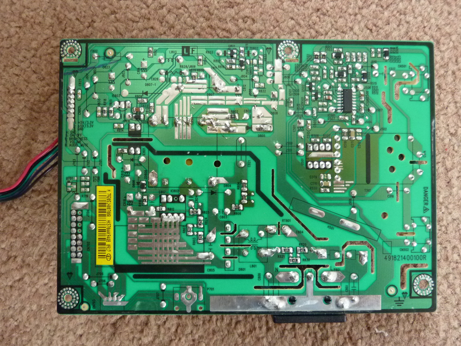

    Re: LG W1941s strange problem
    added more pictures
      Test all capacitors with ESR meter if you don't have an ESR meter replace all caps but the big fat one are those diodes test good.
        Yes the diodes are good, I have replaced all the cap still the same problem. I did replace the large main cap just to make sure.
          Try some freeze spray on IC802 when the monitor shuts off. If it turns back on right away, then the chip is likely overheating, or is defective.
            Thanks Ben, I have just tried the freeze spray and the monitor turns on right away. I will order a new chip and that should sort out the problem.
              I have got fitted the new chip (TOP258PN) and now working great.
