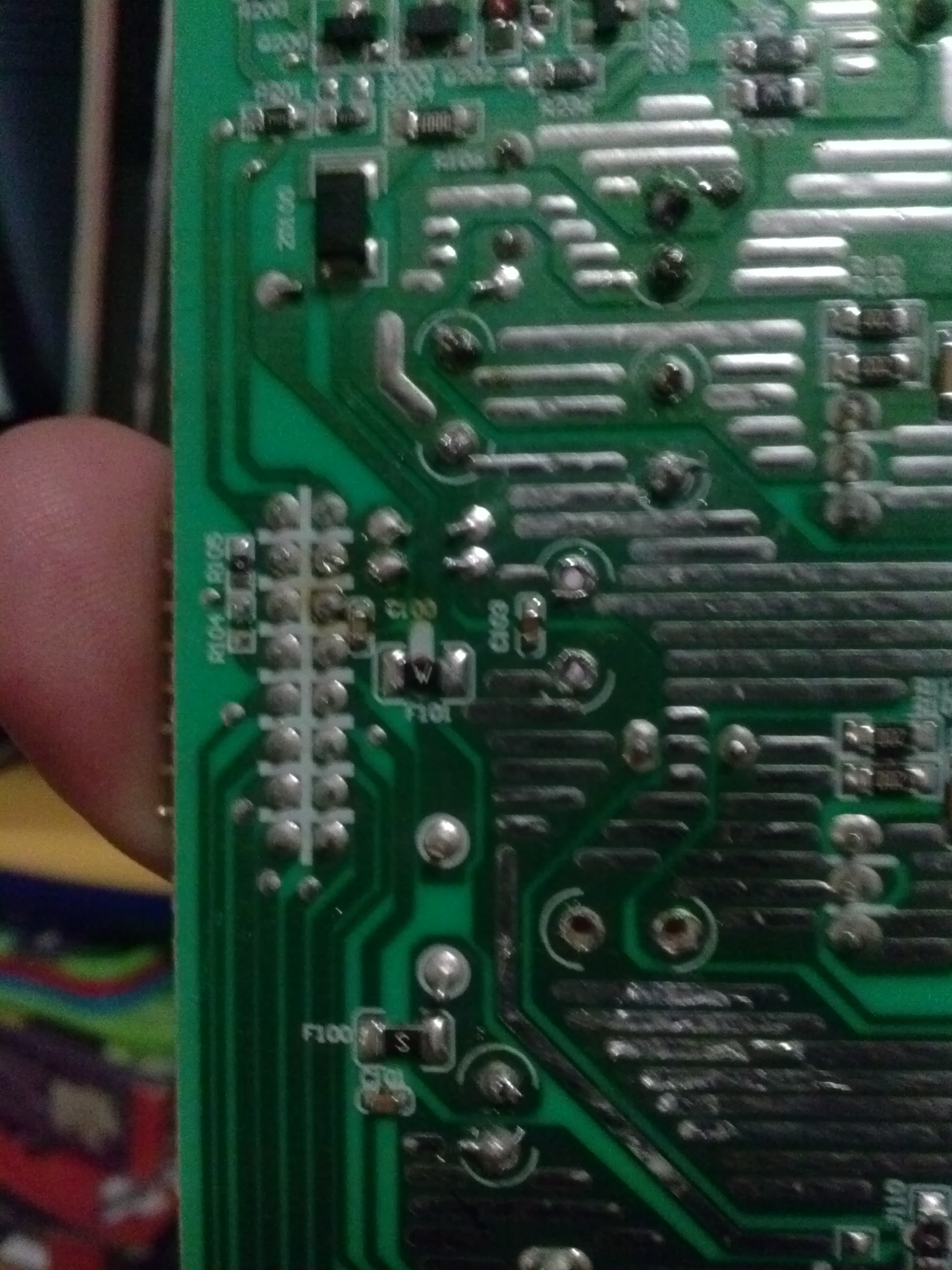

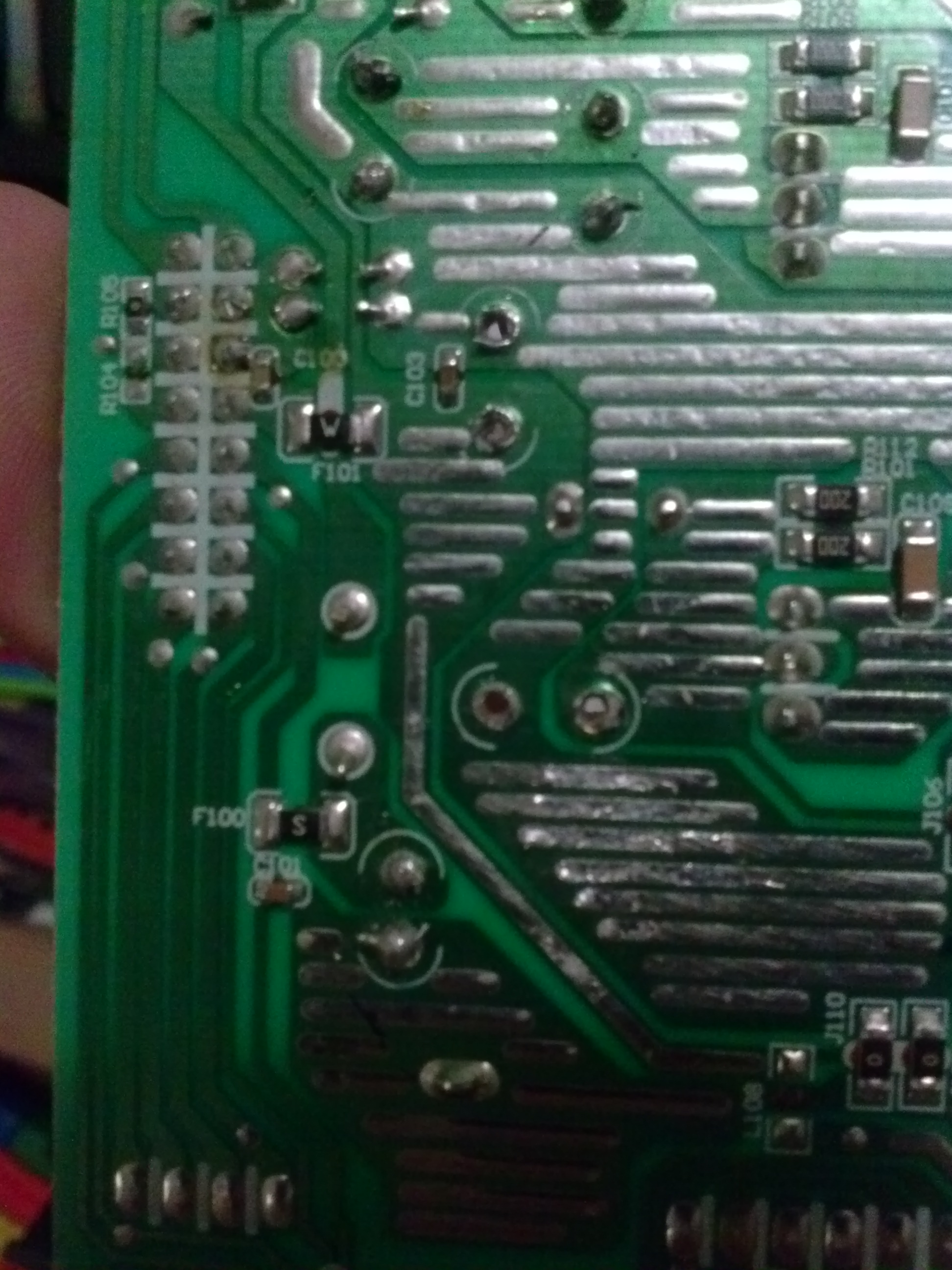

    How it going! My screen was having issue with flickering couple of days ago then on saturday all of an sudden I boot up my pc the bios screen pops up then i get a black screen the light is green so the pc is communicating with the monitor. I did all basic troubleshooting so I went researching the cause of the problem.
    I took apart my screen found both top 200uf was blown so i assumed it was just these to. I went to radio shack and bought two 200uf 35v ( i know I shouldn't use these just wanted to check if will temporarily fix my problem) but didn't work.
    I came across this site and I spent a few hours researching and reading up threads and posts. I tried to test the rectifier it reads 30-50 intermittently and check the big cap and is showing .2volts. I don't know it in doing it right. I'm using digital meter and is on 200 dvc. I'm posting pics as well please disregard the radio shack caps I desolder those already. I'm using 25watt solder I need a new tip is dirty n not soldering correctly. What type of solder is best to use n circuitry work just curious. I'm using a 60/80 I believe I'm at work just guessing.
    Any help is greatly appreciated I'm a dyi type if guy so I'm really doing want to buy a new monitor if I don't have too.

    First, you need good soldering iron, 40 Watts or more. Only 0.2VDC (should be 160~170VDC) on the main dc filter cap sounds like the main fuse is blown. Not quite clear about your rectifier readings.
    Diagram attached. There are SMD fuses on the power supply/inverter board and the MOSFETs that need to be checked.
    There are many threads on this DAC board, just search for it in this forum.

            Ok i found that f200 has 25v but f101 dont have any reading. next to f101 is c100 i tried to get a reading but shows nothing. in the vicinity it looks burnt i took some pics. also right below it i drop some solder on the tracer i try cleaning it up as best as i could. would it affect the circuit? Any input would be great.
