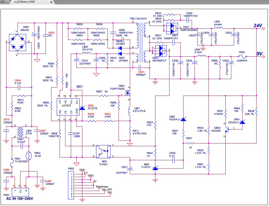

                                #35
                                Re: Dell 3008wfp PSU problem
                                This is a schematic of a VM2235wm-3.
                                It gives you an idea of what to look for. See the 24V rail as a rough guide to the 18V rail. Imagine D821 as D22.
                                As I mentioned before, continuity, when tracing out a circuit is your friend.
