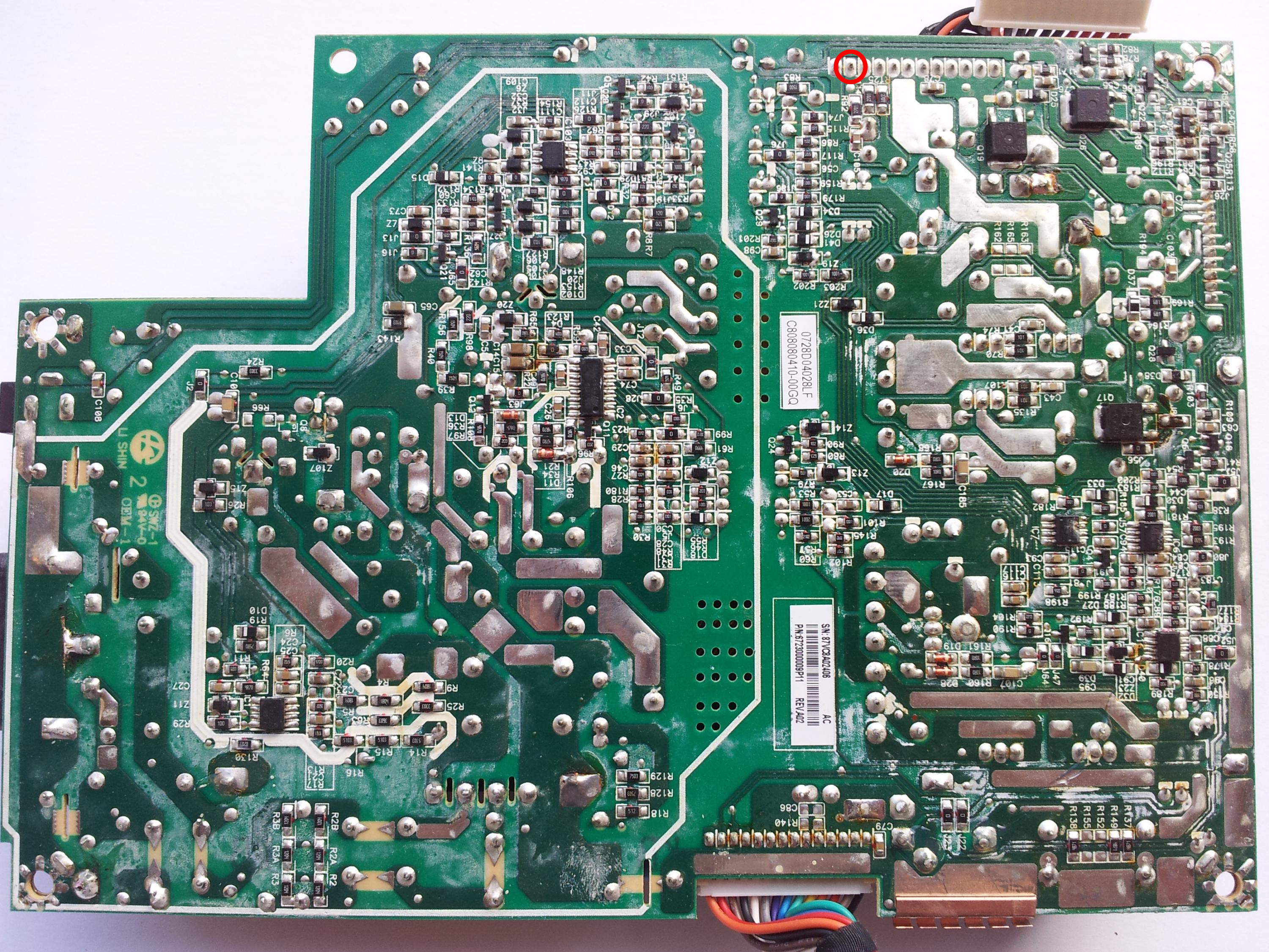

    Hi guys, I'm hoping you'll be able to help me fix the PSU in my Dell 3008wfp monitor.
    Symptoms: Will occasionally show a picture for about a minute then go blank. After this the screen will come on again each time and then quickly go blank (1 second). There is no picture and no backlight when this happens but the power light stays blue.
    I have confirmed it is definitely the PSU at fault as I've temporarily replaced it with a known working PSU and the monitor works perfectly.
    I have read the 3008 Schottky mega thread but I'm not sure it's the D22 diode that is at fault in my case as the power light stays on and it does come on (more like 2 seconds to black). The monitor is not dead to the world in my case.
    All components look healthy with the naked eye and Nichicon capacitors are used on this PSU. I thought maybe it could be a dry joint but my untrained eye couldn't find anything suspect.
    What can I do to fix this? I have soldering skills but only a lowly standard multimeter.
    Many thanks for any help

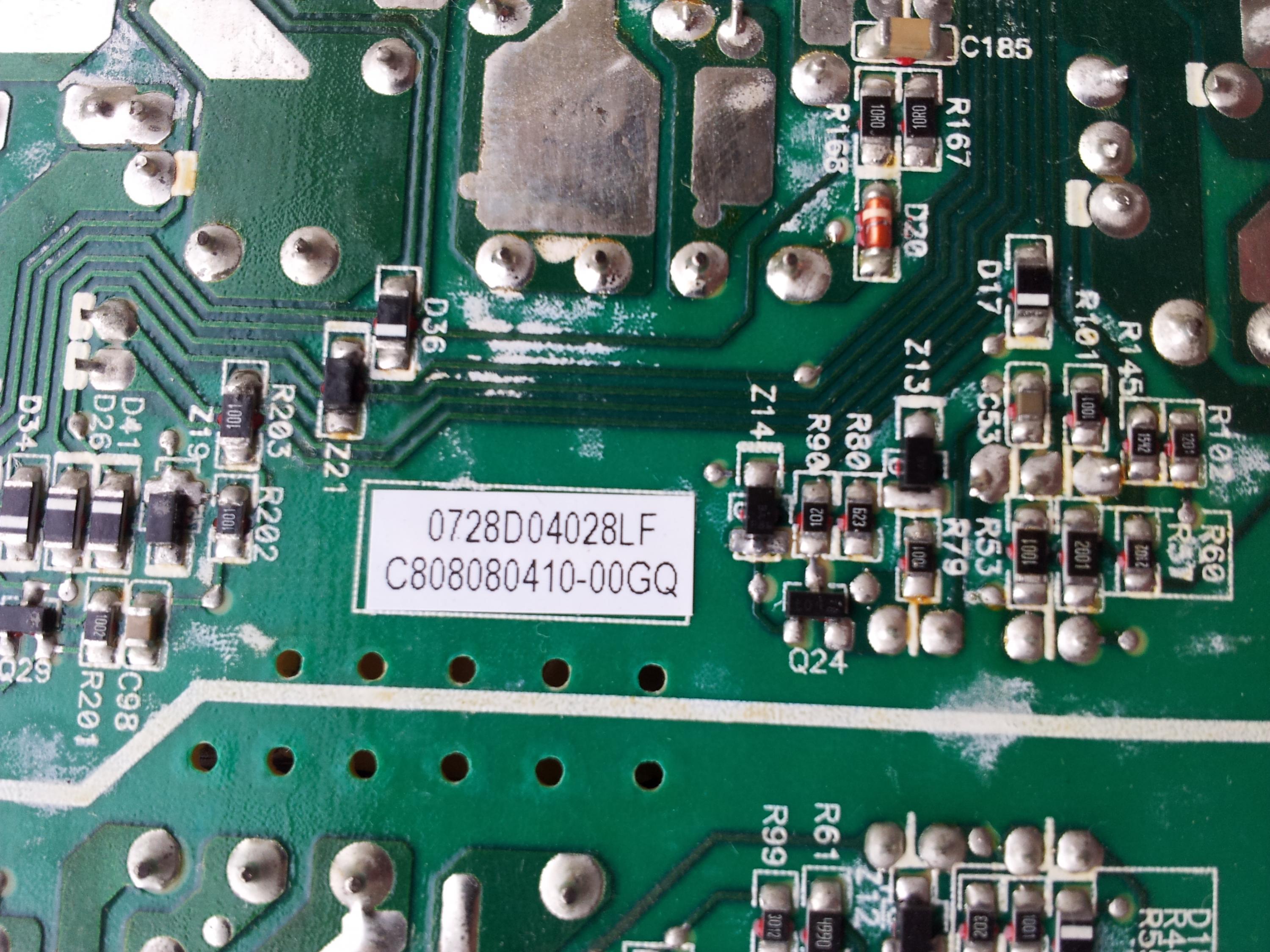

    This is a new one on me. It's good you have/had access to a known good PSU. That helps to narrow the problem down quickly.
    Excellent pictures. That really helps a lot. It definitely sounds like it could be a solder joint that is seperating as the board expands a little, due to the heat. I found what appeared to be tiny gaps on the soldering joints of 2 smd components. I circled them in red. D17 and especially D36.
    If that's not the problem then you'll need to diagnose which rail is going out. For that, what would help is if you get that good PSU; put it back in and take voltage readings on the outputs. If you need any help on that, just come back and ask.
    Hopefully its that tiny gap on one of those smd diodes. Unless I'm seeing things

      Thanks for the quick repsonse lumberjack. You must have eagle eyes to spot that! I will reflow those joints tomorrow and get back to you with results. They seemed ok to me but I am no expert. A lot of the joints seem a bit dull and I am aware this PSU gets red hot. I can take closer photos of particular part of the board if you'd like? I have access to the good PSU and can run tests with it as required.
      Many thanks.

        Your welcome leapius. I think it's also possible on those smd diodes that there is a stripe on the cathode side that is giving the appearance, or an optical illusion, of a gap.
        BUT..... if you could get a jewelers loop or some type of high powered magnification I would go over all of those solder joints with a fine tooth comb. Because your symptoms sound like a solder joint that is seperating due to heat expansion of the pcb. *cheers*

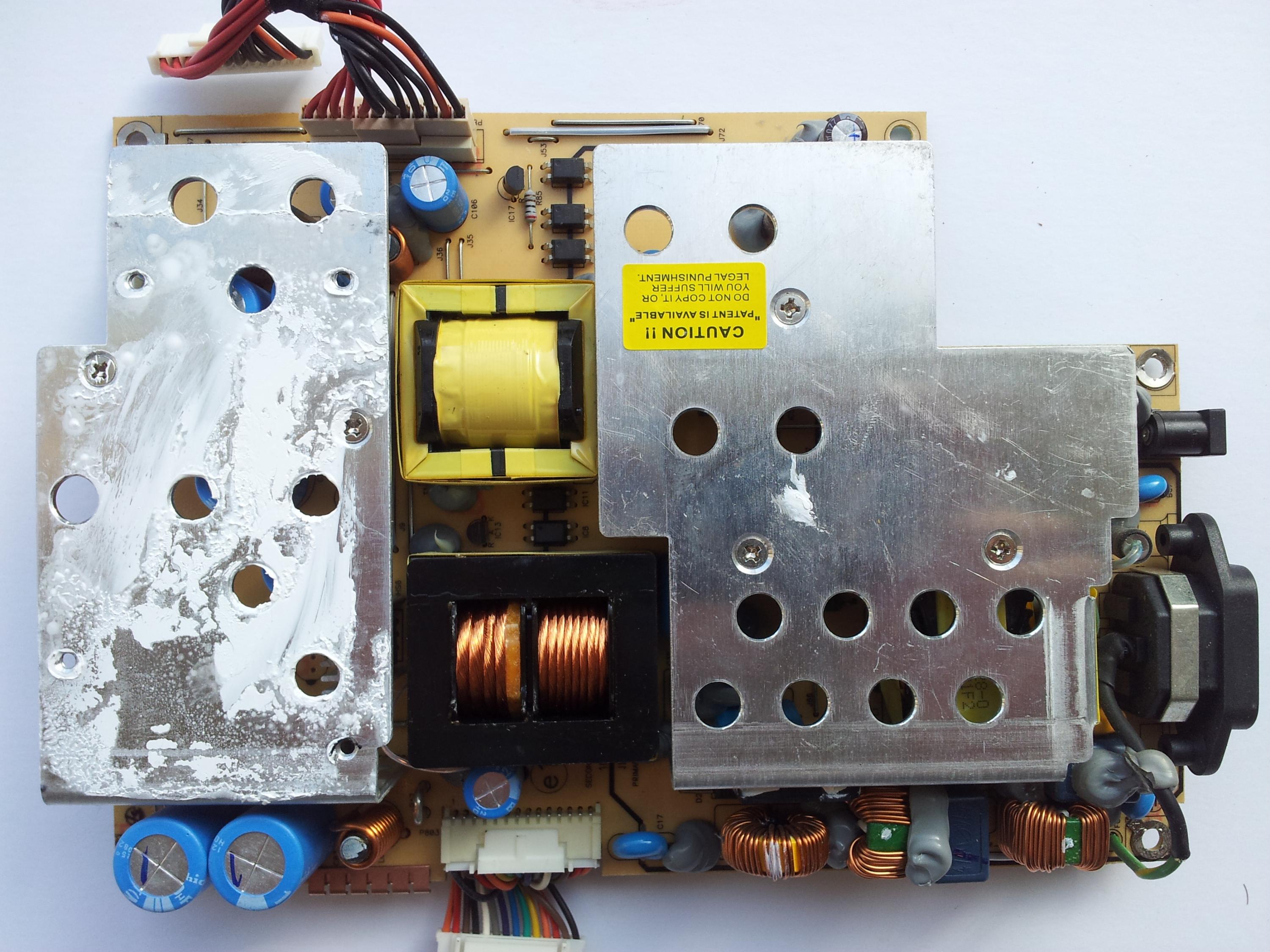

          Excellent photos.
          Long shot. On the back of the pcb there seems to be a lot of white residue. This could be a reaction of some sort of flux with humidity? It is best to remove it by using isopropyl alcohol and clean toothbrush. If left on long enough it will eat away at the traces.
          See
          http://mrmodemhead.com/blog/fluke-77...per-corrosion/
              That's interesting RC. I just checked an extra PSU I have for the Dell 3008. It absolutely does NOT have any traces of white residue. Even with magnification.
              The top side uses the white thermal paste on the heat sink. Unless maybe somebody got some on their fingers and transferred it to the bottom side? If its that same salty type of corrosion you linked to, that would be a tough one.

                        Lumberjack - I took a closer pic of D17 and D36 (see attached) I think the solder is ok on second look.
                        • Lumberjack777
                          • Dec 2010
                          • 464
                          Re: Dell 3008wfp PSU problem
                          So it was the stripe on the cathode side. Not a gap. I kinda figured on second look. That would have been too easy!
