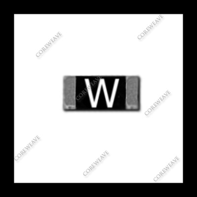

    Hi, i am enclosing a picture of the surface mount fuse i need to replace on the Acer AL2516WB computer monitor.
    THe marking on the fuse is either an "M" or a "W".......i dont which........
    Anyone have any ideas?

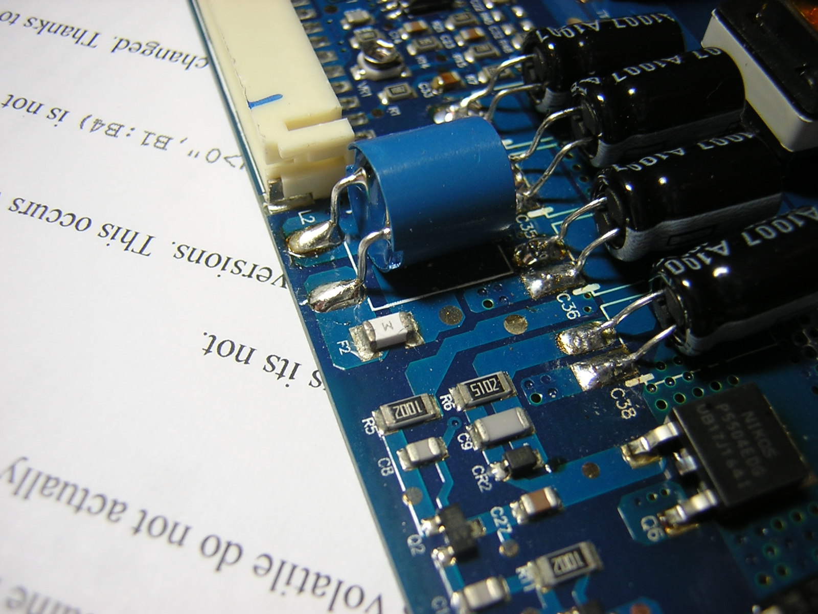

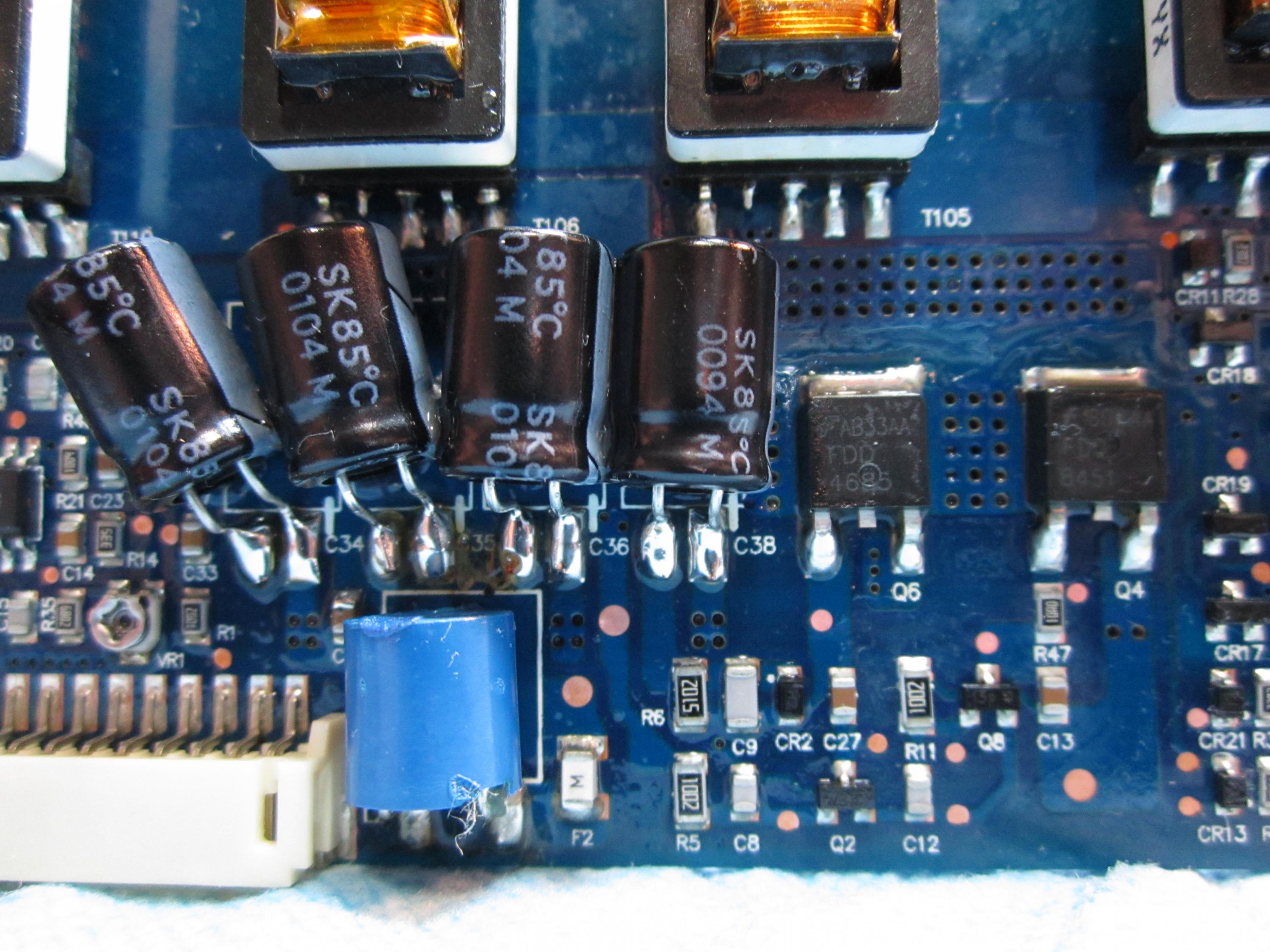

          There was a little controversy over in the megathread on that. After a couple clear, close-up pictures; it was determined to definitely be an "M".
          I'll attach one here. The guy only used 85C replacement caps though
          I think I found the fuse you need at digikey. Besides the rating, the size on these is also important. http://www.digikey.com/product-detai...9-1-ND/2870082

              The "M" fuse is actually a 1.25A but most people use the 1.5A that I have seen. Plus its easier to find.
              I'll post a picture of the "W" (4A) fuse and you can see that the ends of the letter tilt outward. You definitely want to use the 1.5A

                      I replaced the fuses on the inverter boards of both my 2416's with 1,5A types. I had some difficulty obtaining SMD types, so I used fuses in a resistor type casing instead. The wires on both ends made it quite easy to solder them in place, I just followed the PCB traces and soldered them to the respective components.
                      BTW: there are 3 fuses on the inverter board, so give the other ones a test as well. If you haven't done so already, that is.
                      Do yourself a big favor and take Budm's advice at heart: check if the mosfets are OK first. Your painstakingly soldered new fuse(s) won't last very long if one or more mosfets turn out to be shot after all. And if they indeed are kaputt, you'll have to replace all 10 electrolytic caps as well. Even if they are OK, it can't hurt to replace the caps anyway.
