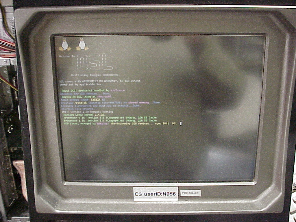

    this has become a big cause of failure in many lcd's.
    not uncommon to replace every one of them in a unit.
    samsung and viewsonic seem to be the worst offenders.
    i get a ton of industrial displays in that died of this issue.
    here is one example.most folks would have a heart attack when told the cost to replace this unit.

    Is that the finished product? Don't see anything wrong, though it's hard to tell w/ your reflection.

      yes thats the after shot.
      had before and the pile of dead caps pics but a damaged the disk by sitting on it.
