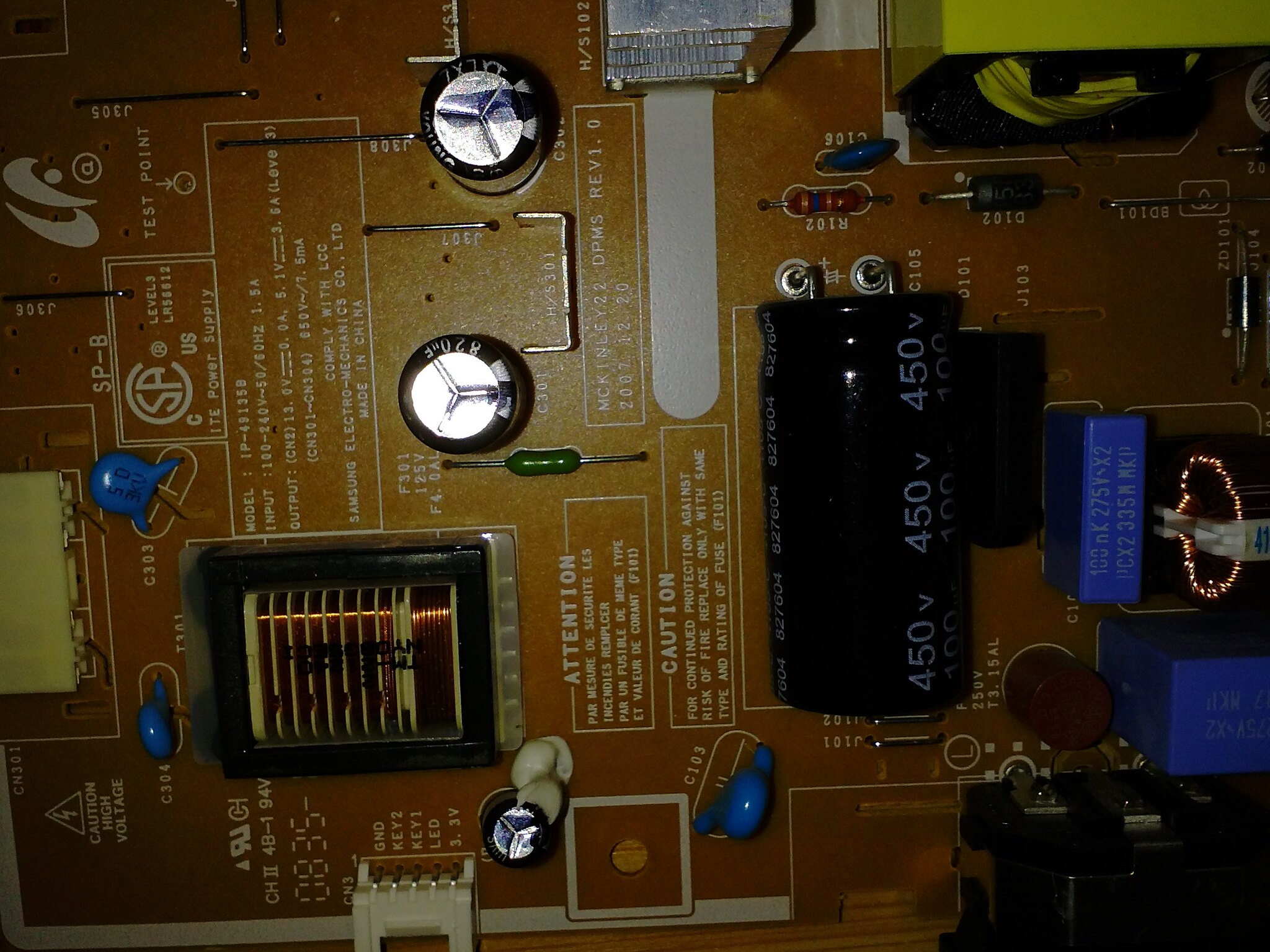

                                      Here is the pcb. The capacitors look fine to me but I am no expert. I see no bulge or leaking. Just some marks that look like felt pen on the top.
                                      The bright is just my camera flash.

                                        Since the problem is fuzziness, and video problems....and you have power, video, and backlights, we can assume your power supply board is ok. The problem probably lies in your main board. The one that the video plugs into. Locate retiredcaps guide on testing voltage regulators. That's a good place to start. That's a common problem on the main board and would cause the problems you are seeing.
