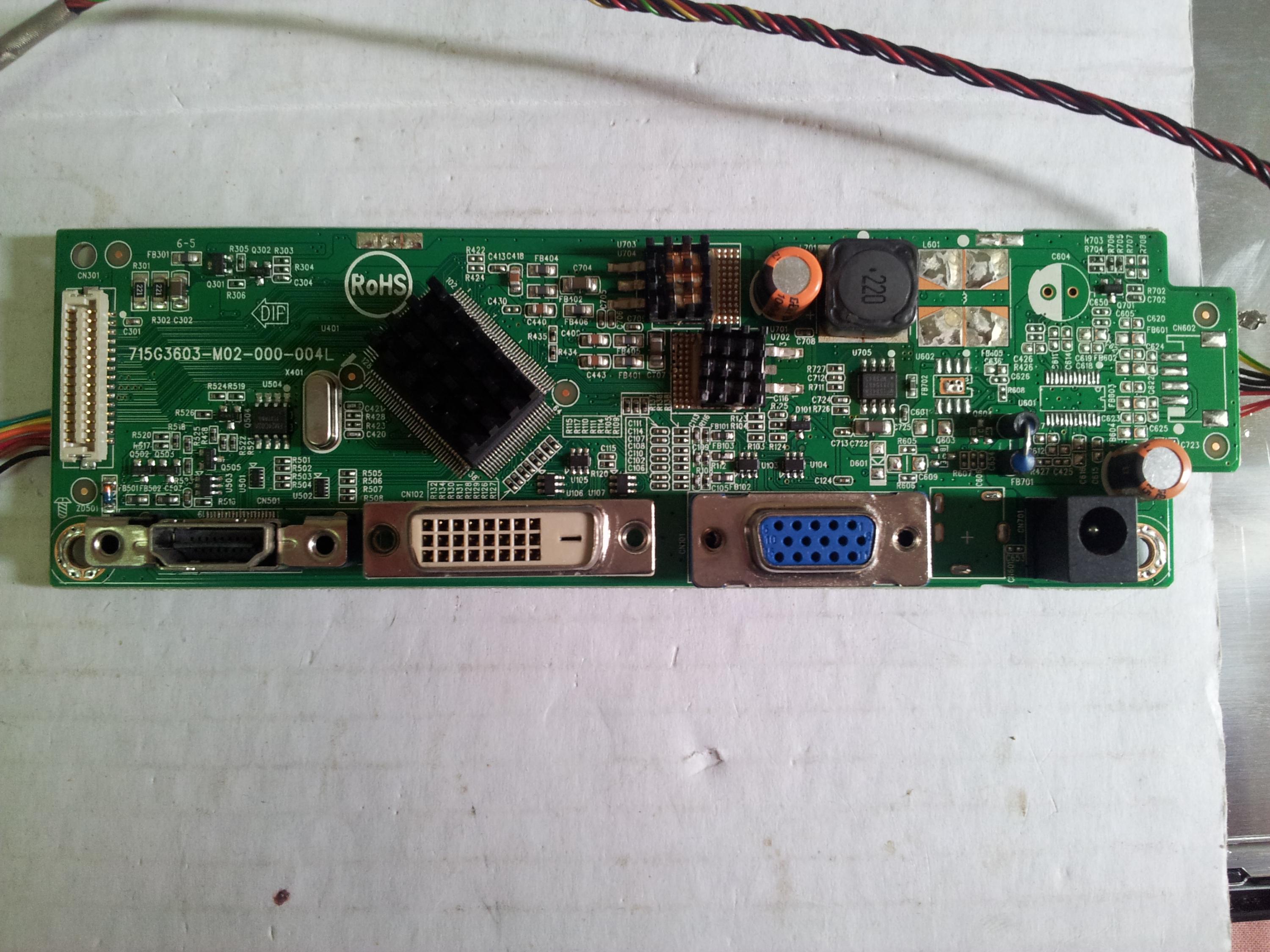

    Hope you guys are doing well. I need some advise on the below repair. This came as faulty to me.
    Model : Acer S231HL LCD LED Monitor
    Symptom : No power & No LED light up

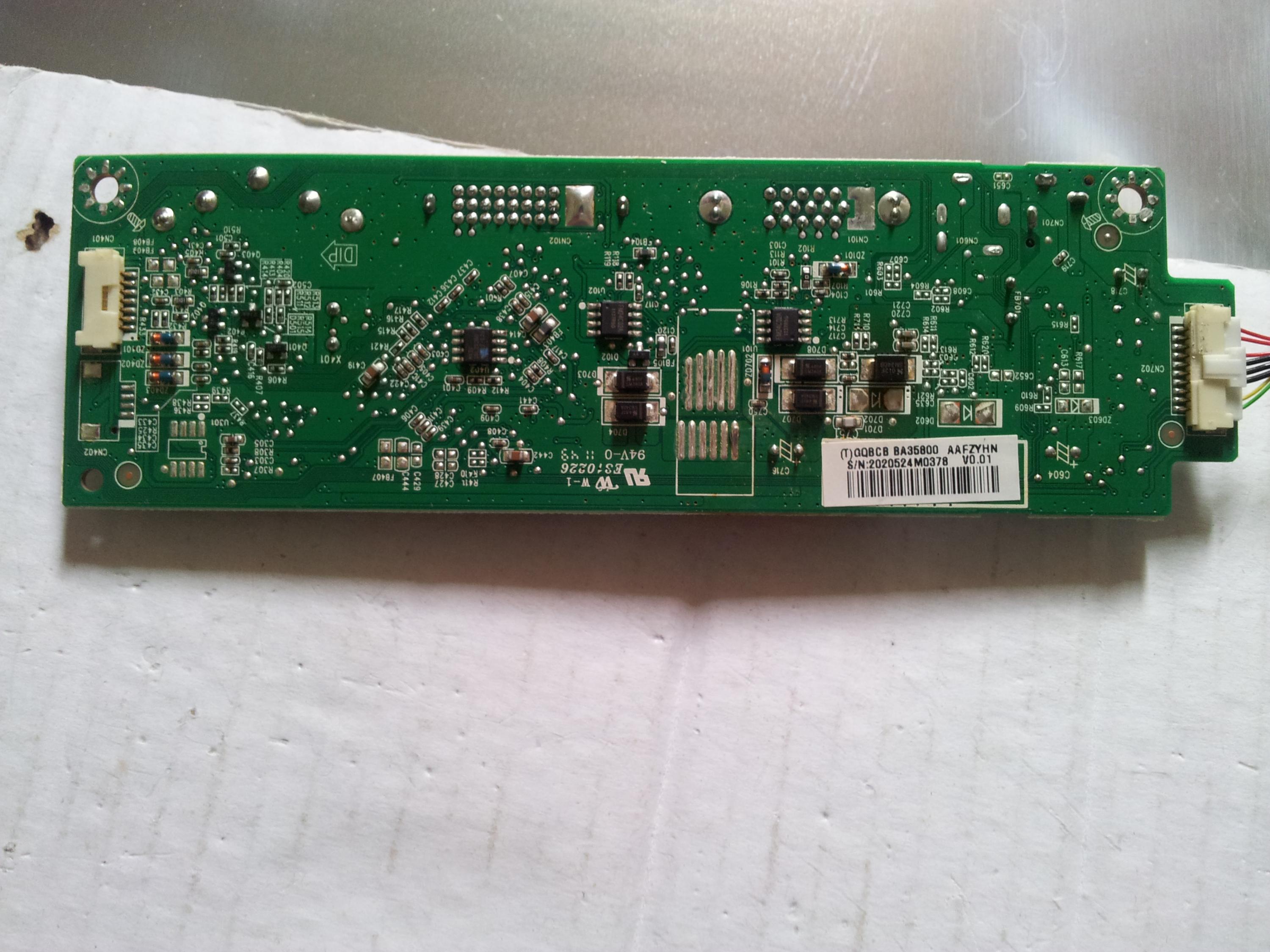

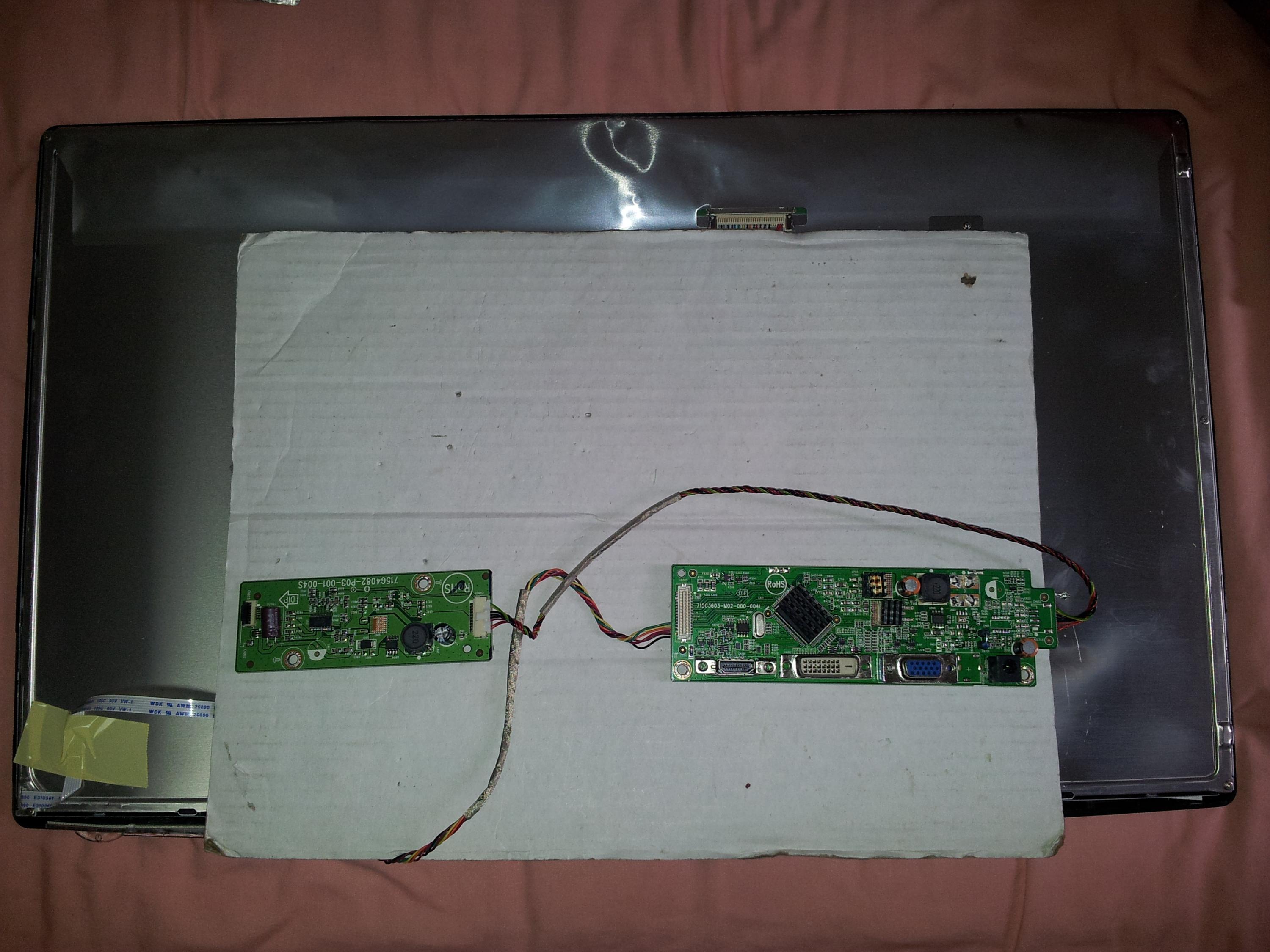

    Included 19V external power adaptor was measured to be producing correct voltage. Disassembled and saw 2 PCB boards but unsure what are they called. Lol. Pictures attached.
    Cross reference to this thread, I am wondering whether the Step Down converter MP1584EN (datasheet) (U705) on this board 715G3603-M02-000-004L is faulty and need to be replaced? Or am I troubleshooting at the wrong section/board of the faulty monitor.
    Measurement taken on U705 with respect to Gnd (screw pad of the PCB) with the other board plugged in
    Pin 1 (SW) = 0V
    Pin 2 (EN) = 2.7V
    Pin 3 (COMP) = 2.1V
    Pin 4 (FB) = 0V
    Pin 5 (GND) = 0V
    Pin 6 (FREQ) = 0V
    Pin 7 (VIN) = 19V
    Pin 8 (BST = 5.2V
    There is also no shorting when measuring ohms between all the pins to Gnd (Pin 5) and also between Pins 1 to Pin 7 or Pin 8. As for ZD702 ohms measurement the multimeter shows 1161 ohms between one side and 1 when the probe is reversed. Other zeners and diodes also produced no shorting across their respective legs.
    Appreciate your opinions whether I should be zooming in & replace the MP1584EN or other components, which I might overlook, should be checked as well.

    U701/702 and U703/U704 look like two voltage regulators. Measure each and report their readings.

        Refer to datasheet and figure 3 and 4. Both give a "typical" application schematic.
        1) My guess is that R711 and R727 might be the voltage divider connect to FB.
        a) What are the values of R711 and R727?
        b) Measure them in circuit and see if they match the markings.
        2) SW is connected to a diode, an inductor (L601)??, and capacitor (orange one or C750 backside?).
        a) An inductor should read less than 1.0 ohms.
        b) See if C750 is shorted.

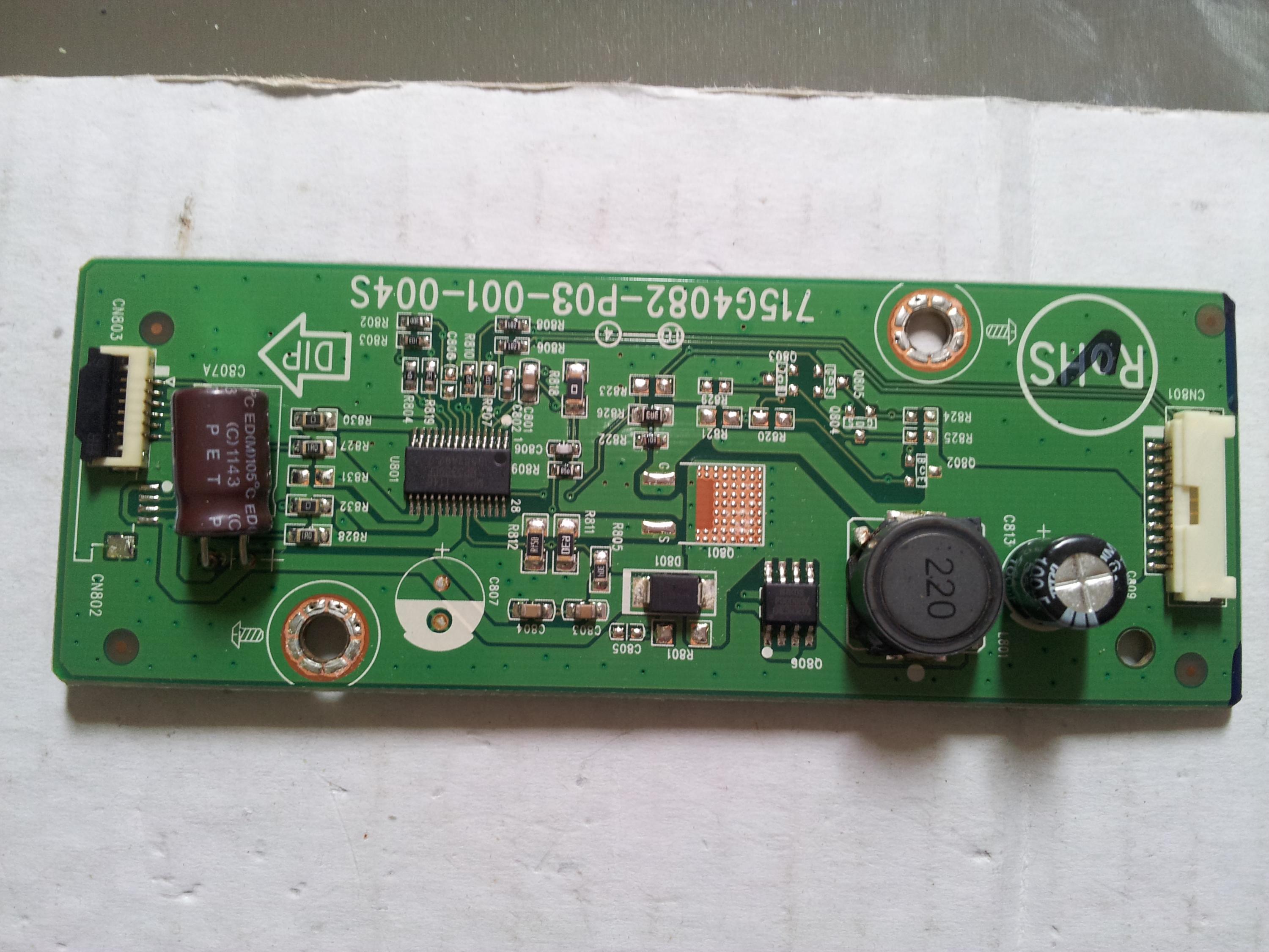

          Re: Acer S231HL LCD LED Monitor - No power
          Are you getting 19vdc on the two legs of the C109 next to the round inductor on the LED Backlights power supply?
            @retired,
            1) R711 and R727 are connected to Pin 2 (EN)
            a) R711 = ohms keep rising; R727 = 28k ohms
            b) unfortunately i could not see any markings on them
            2) SW is connected to L701
            a) L701 = 0.06 ohms
            b) C750 is not shorted
            @budm
            Did you mean the SMD capacitor C809 on the other board? If yes, then 19V is present across it. FYI, C813 (to the left of inductor L801) is also having 19V across it. thank you
