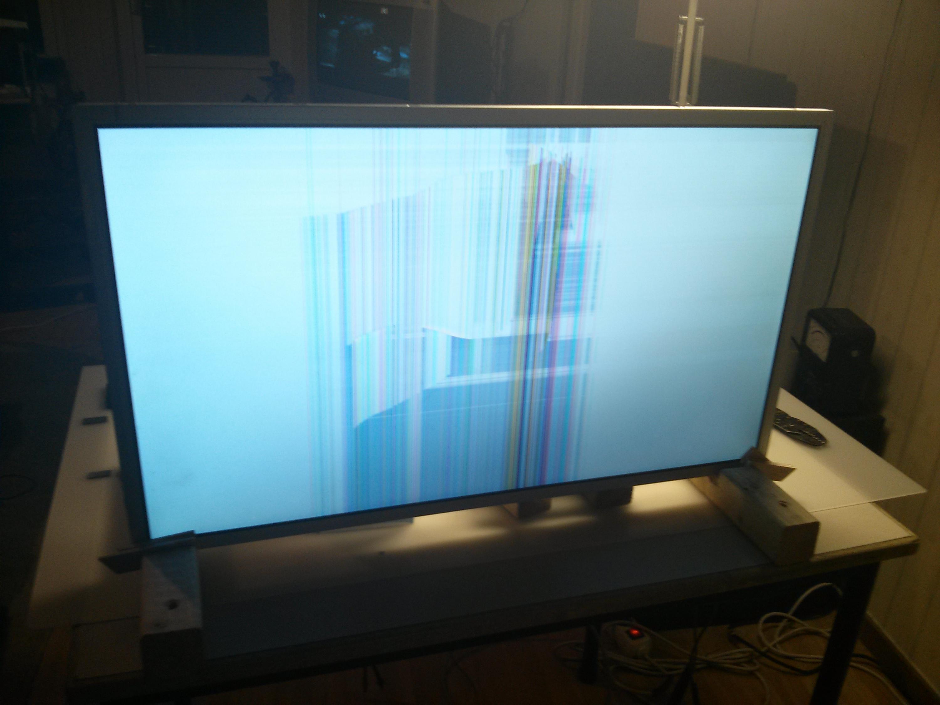

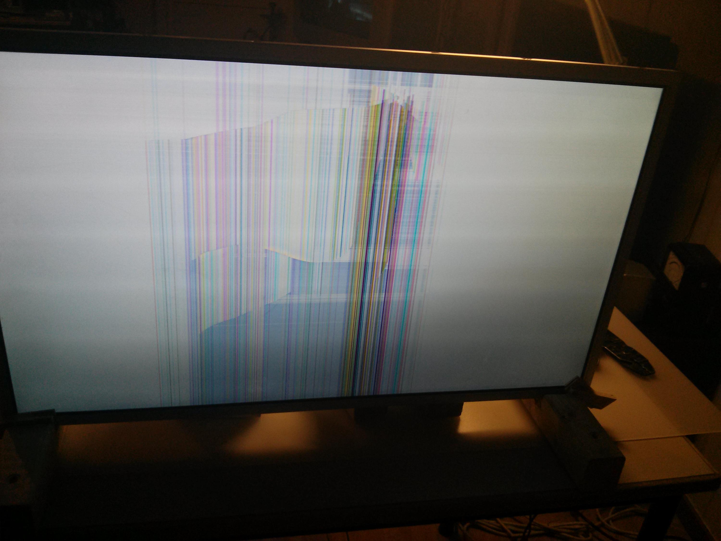

    hey everyone i have this pc screen from philips I get a bright vertical stripes in the middle of the screen maybe ten centimeters wide, as you can see in the picture which I enclose if I can transfer the images hope someone can tell me what the problem is
    very grateful for all the help

    The panel is probably bad

      Thank you are you shure or just guess
        Re: Philips Model 273E3L Vertical stripes
        Was the screen hit by a hard object?
          No it is not so the man says that it becames like that when he start it last time
            It sure looks like cracked screen.

              +1 on cracked screen.

                +2 Cracked internal screen

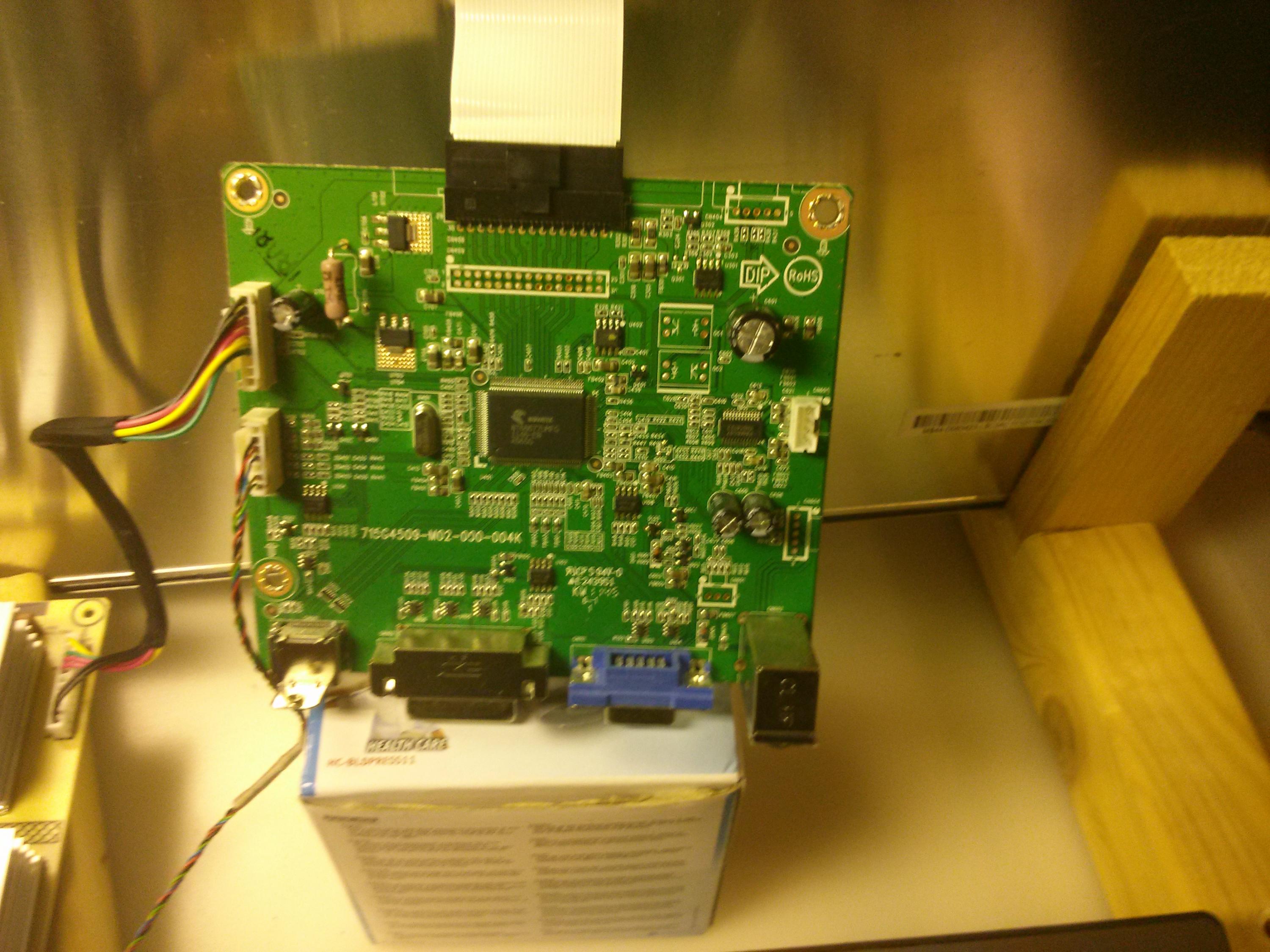

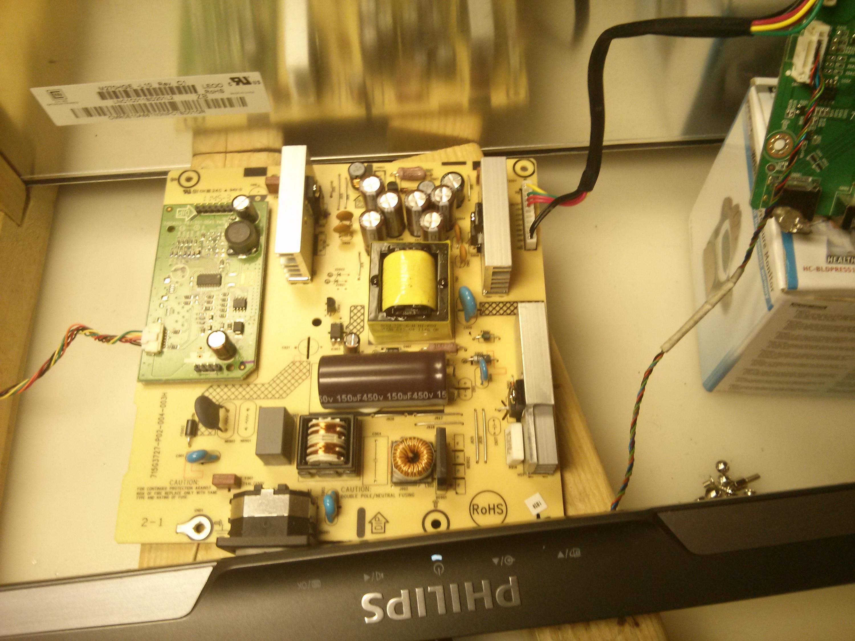

                  oj Pentium4,budm,retiredcaps and Selldoor has spoken then it have to be definif diagnos.it is very easy to check since the set is allready open i“all check it this afternoon and let you know thank you

                    Yes it is absolutly as you all say it is cracked screen thank you.i will try to sell the rest or maybe find an other screen lol

                        I think his son messed at home and he did not know
