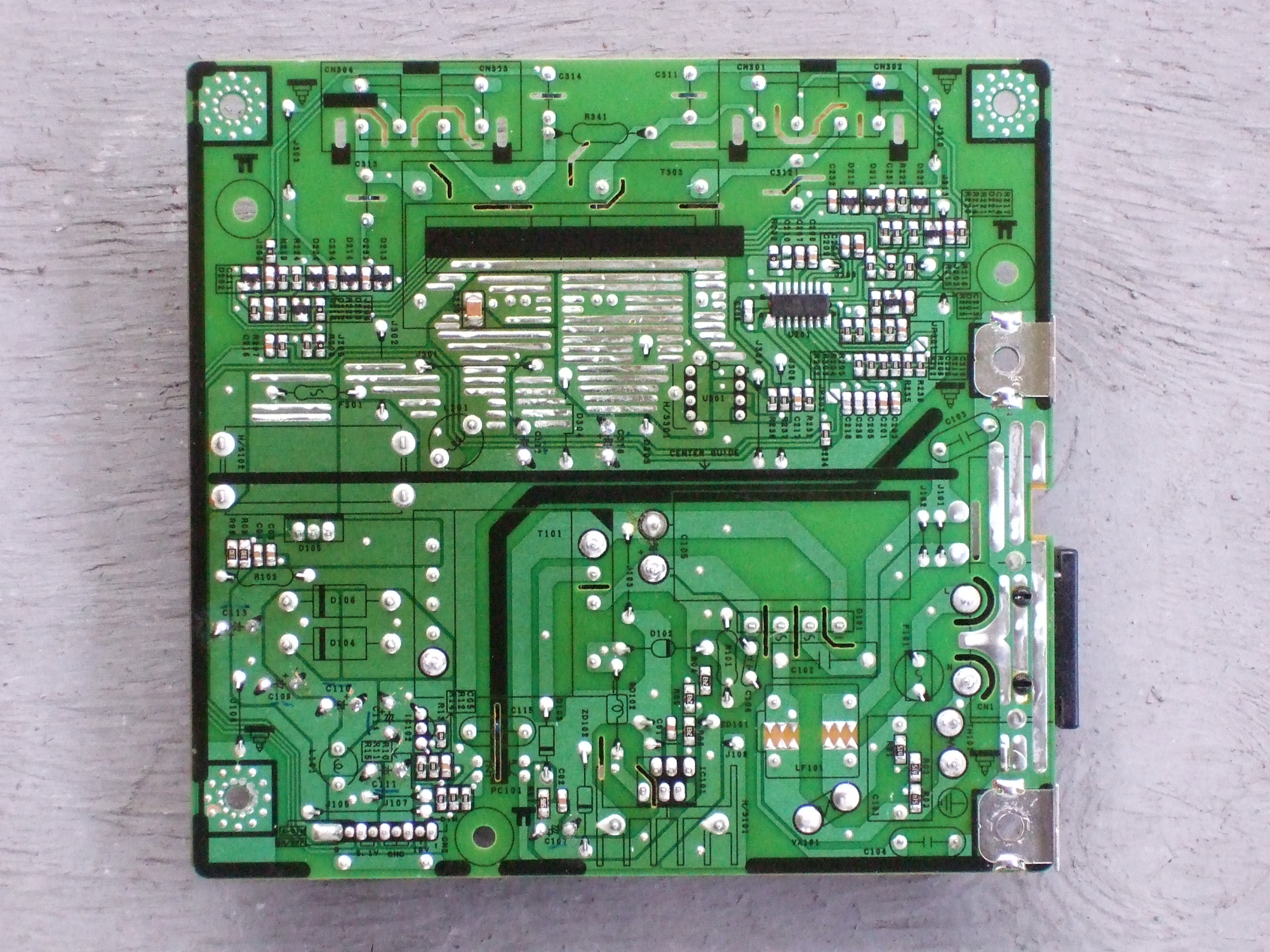

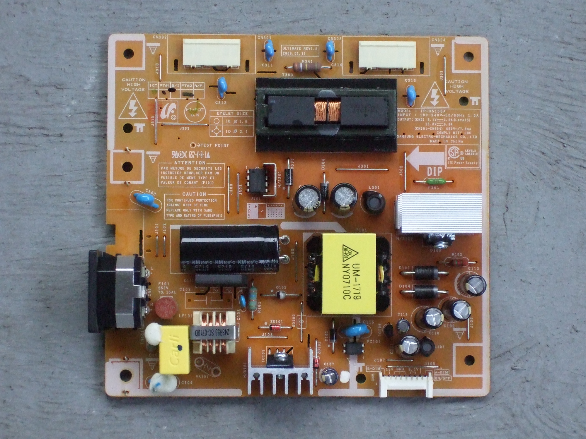

    Dear experts,
    I have been to many other hobbist/expert forums but only this one exhibits such helpfulness and wealth of knowledge! (Troubleshooting electronics remotely is a hard thing to do!) This is such a great forum and I congratulate and thank everybody who has contributed.
    So here is another newbie's (typical) story:
    My friend wanted me to help fix a monitor as titled, exhibiting the "2 seconds to black" symptom, with the video still visible under flashlight. I opened it up, replaced all the caps with new low-ESR ones, but it became worse: now the backlight doesn't even come on, and the video signal is gone! Only the blue power LED stays on for 2s and then flashes slowly at about 1 flash per second.
    Now having "gotten my hands dirty" I want to get this monitor fixed, and so hoping you folks can give me some ideas! I have already done the following (according to the sticky thread):
    - Replaced all the radial electrolytic caps except the main filter (big) capacitor
    - Checked the resistance of all the MOSFETs (no shorts), fuses (no opens), and transformer secondaries (identical resistance); I "assume" all are OK.
    Suggestions are welcome!! Attached are PSU board photos.
    In advance, a big THANKS!
    Kevin

    Re: Samsung 940NW - 2 seconds to black - now just black!
    What are the DC voltages at CN2 (connector)?

        • selldoor
          Slow Learner
          • Dec 2010
          • 7870
          Retiredcaps will want to see the voltages on every pin on the connector list the results with the Pin descriptions alongside. Also do the test twice once when plugged in
          and then when switching on have your lead on the on/off pin and see if it changes.
          Another quick test WITH POWER OFF for 5 mins. Meter on 2000ohms test S1 to S2 and S3 to S4 on attached pic

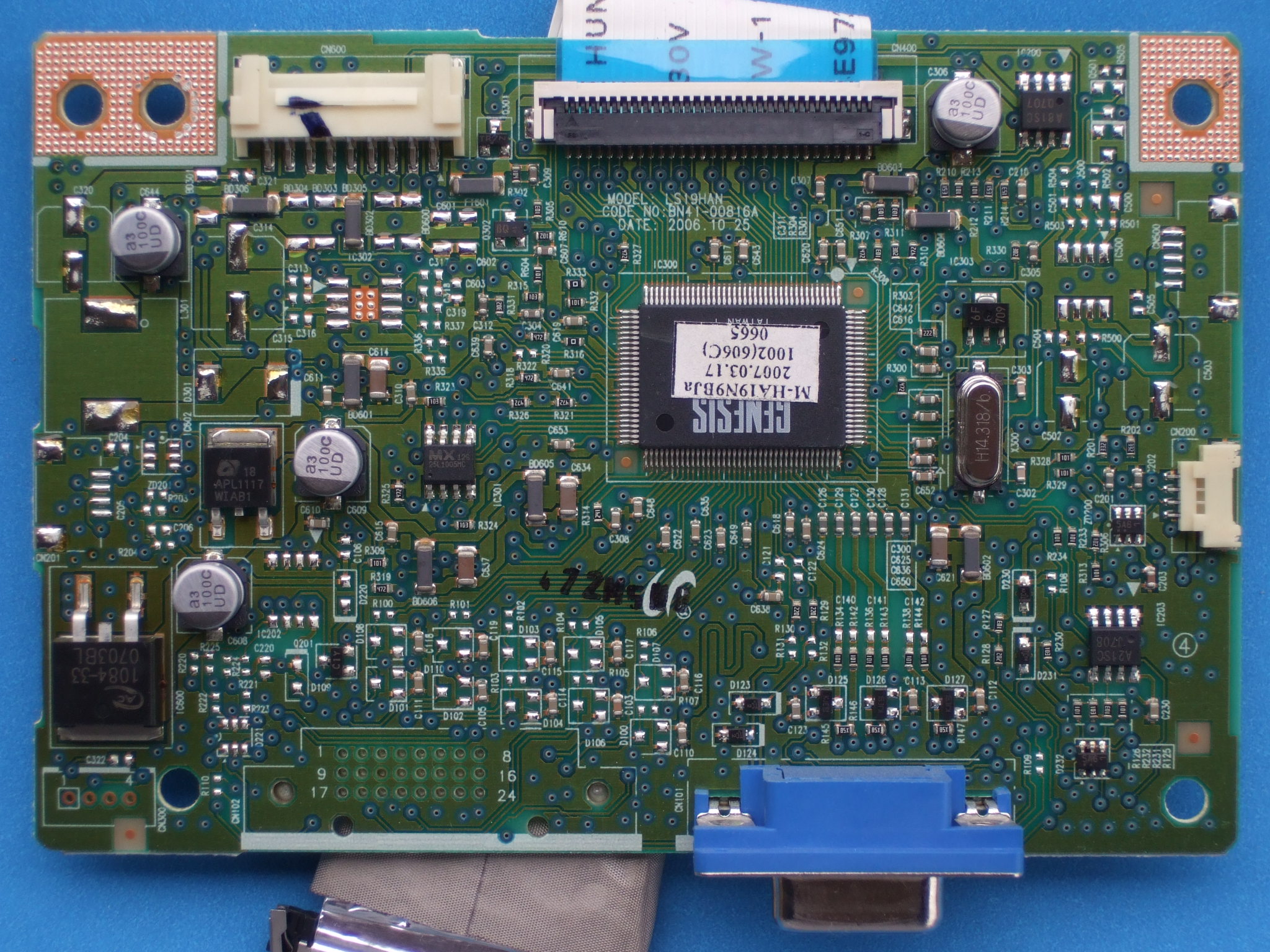

                    The voltage regulator guide was interesting read. Somehow I didn't venture to this one but read the "2s to black" only.
                    The main board photo is attached. The readings are as follows:
                    IC600
                    1084-33
                    0703BL
                    PIN1: 0 V
                    PIN2: 3.28 V
                    PIN3: 5.12 V
                    IC602
                    18 <-- Edit: this number apparently tells us which voltage version.
                    APL1117
                    WIAB1
                    PIN1: 0 V
                    PIN2: 1.78 V
                    PIN3: 3.28 V
                    IC303
                    6F
                    709
                    PIN1: 3.28 V
                    PIN2: 0 V
                    PIN3: 3.15 V

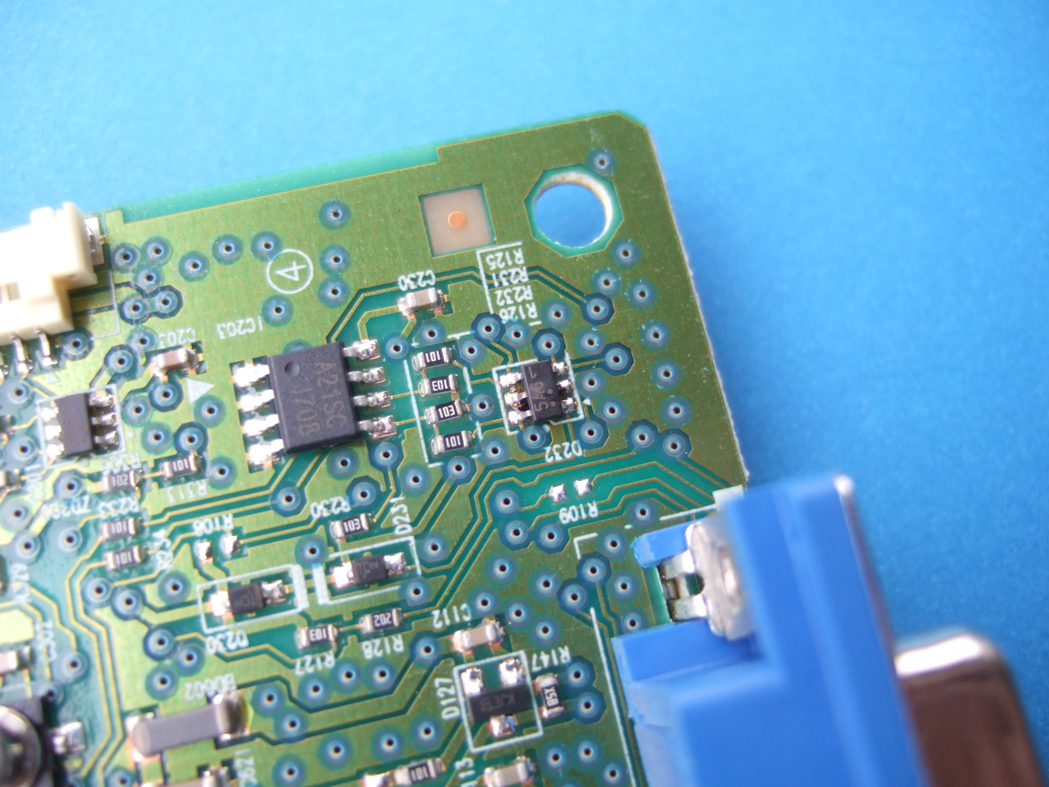

                    While looking at the board closely, I found something VERY INTERESTING! The component D232 seems swollen, cracked and have brown/black stuff oozed from the bottom... photos also shown. I wonder what this is... I'm guessing 3 diodes in one package, perhaps?
                    • sabre504
                      • May 2010
                      • 449
                      • United Kingdom
                      D232
                      diode-tvs;mmqa5v6t3,
                      5.32/5.6/5.88v,24w,s
                      • kktlam
                        • Jan 2013
                        • 27
                        Impressive! Thanks sabre504.
                        • retiredcaps
                          • Apr 2010
                          • 9271
                          It definitely looks bad. You can test it in circuit to see what the readings are.
                          edit: sabre504 found it was I was searching around.

                          • retiredcaps
                            • Apr 2010
                            • 9271
                            You should have 8 readings for the test by following the datasheet provided by sabre504.
                            Use the diode test mode on your multimeter and report all 8 readings.
                            --- begin sig file ---
                            --- end sig file ---
                            • kktlam
                              • Jan 2013
                              • 27
                              I'm not entirely sure which 8 readings: do you mean forward/reverse measurements at each anode/cathode pair?
                              • retiredcaps
                                • Apr 2010
                                • 9271
                                Yes. See datasheet for the pinouts.

                                • kktlam
                                  • Jan 2013
                                  • 27
                                  Here we go. The first number is red probe on PIN 2/5, the other number is reverse ie black probe on PIN 2/5
                                  PIN2/5 to PIN1 = open,open
                                  PIN2/5 to PIN3 = 046,047
                                  PIN2/5 to PIN4 = 068,071
                                  PIN2/5 to PIN6 = 832,open
                                  I was reading the the multimeter's user manual: is it correct to interpret these numbers as diode at PIN1 open, diodes at PINs 3 & 4 shorted, and only diode at PIN6 is good?
                                  • retiredcaps
                                    • Apr 2010
                                    • 9271
                                    Correct.
                                    • kktlam
                                      • Jan 2013
                                      • 27
                                      I'm thinking of replacing this diode package. Seems hard to find - may be I'll look for it in other broken monitors. Meanwhile, is there anything I should check? I'm a little worried that something else is causing this voltage limiter to blow - I think it acts like a fuse.
                                      • retiredcaps
                                        • Apr 2010
                                        • 9271
                                        Seems hard to find
                                        This looks to be an equivalent
                                        http://www.digikey.ca/product-detail...0-1-ND/2531527
                                        Get 2 or 3 at 55 cents each.
