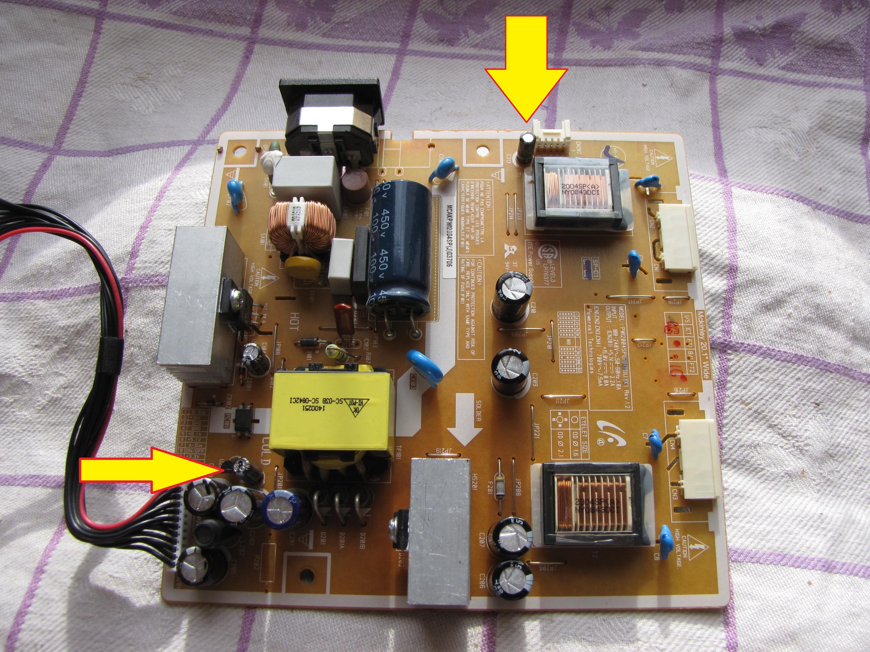

        Hi (again)
        I have replaced almost all the caps on the PS and things are much much better now, BUT still i have seen it restart at least once, though it is much more stable now.
        The capacitors that i haven't changed are the little ones 10uf 50v cap and the one above.
        just wanted to ask, can those little guys cause big trouble? what are their role?
        Thanks !!

          Re: Samsung Syncmaster 220T - flickers.
          Hey,
          i need help please.
          i want to order a new power supply for this monitor.
          My board model is PWI2004SP(J).
          The board i can find availible is PWI2004SP(G).
          http://www.ebay.com/itm/Power-Board-...item27bd3e9041
          are the compatible? can i buy PWI2004SP(G) and it will work?
          they look identical.
          Thanks in advance.
              yes it will fit since it is the same specs actually
