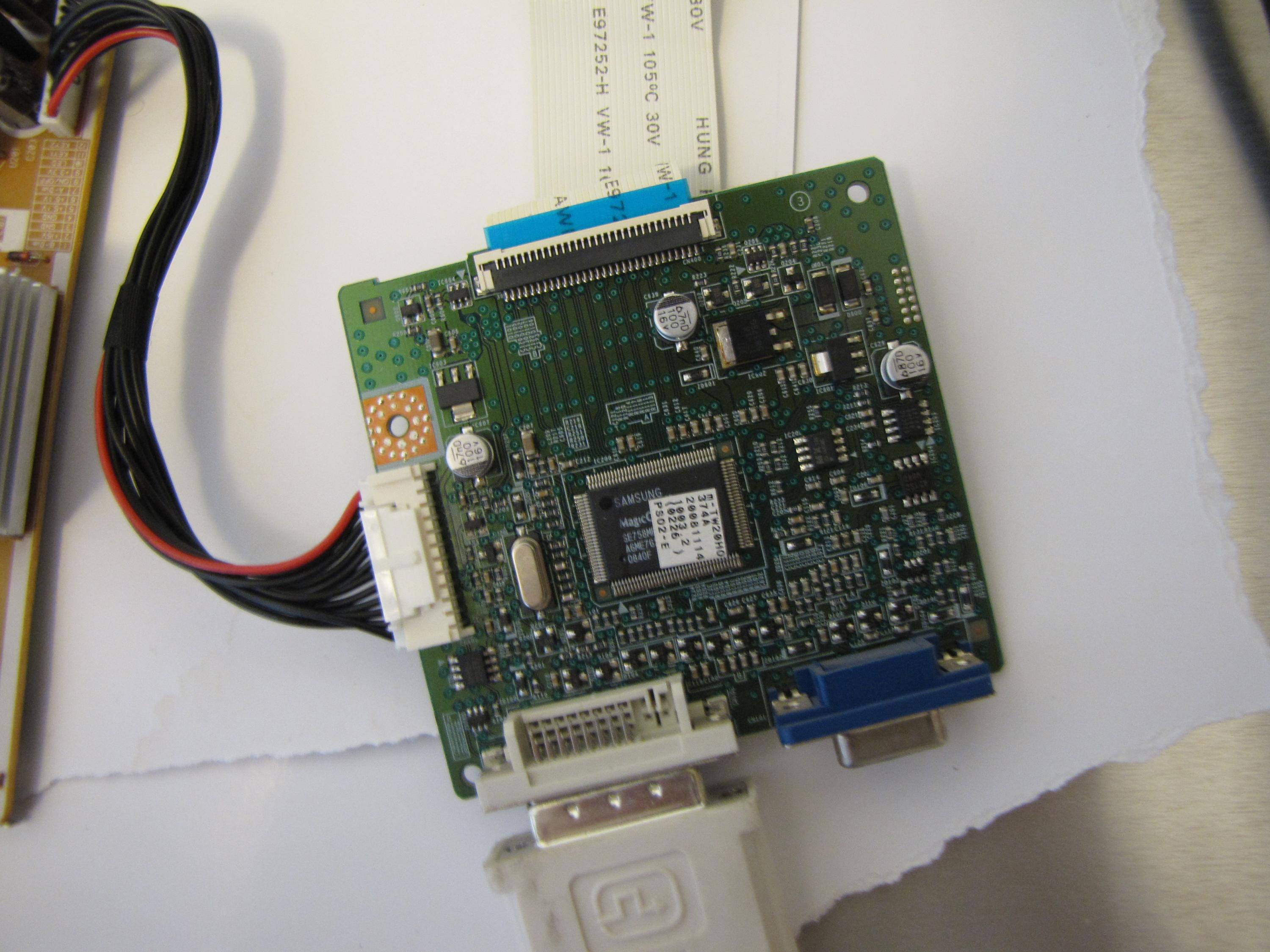

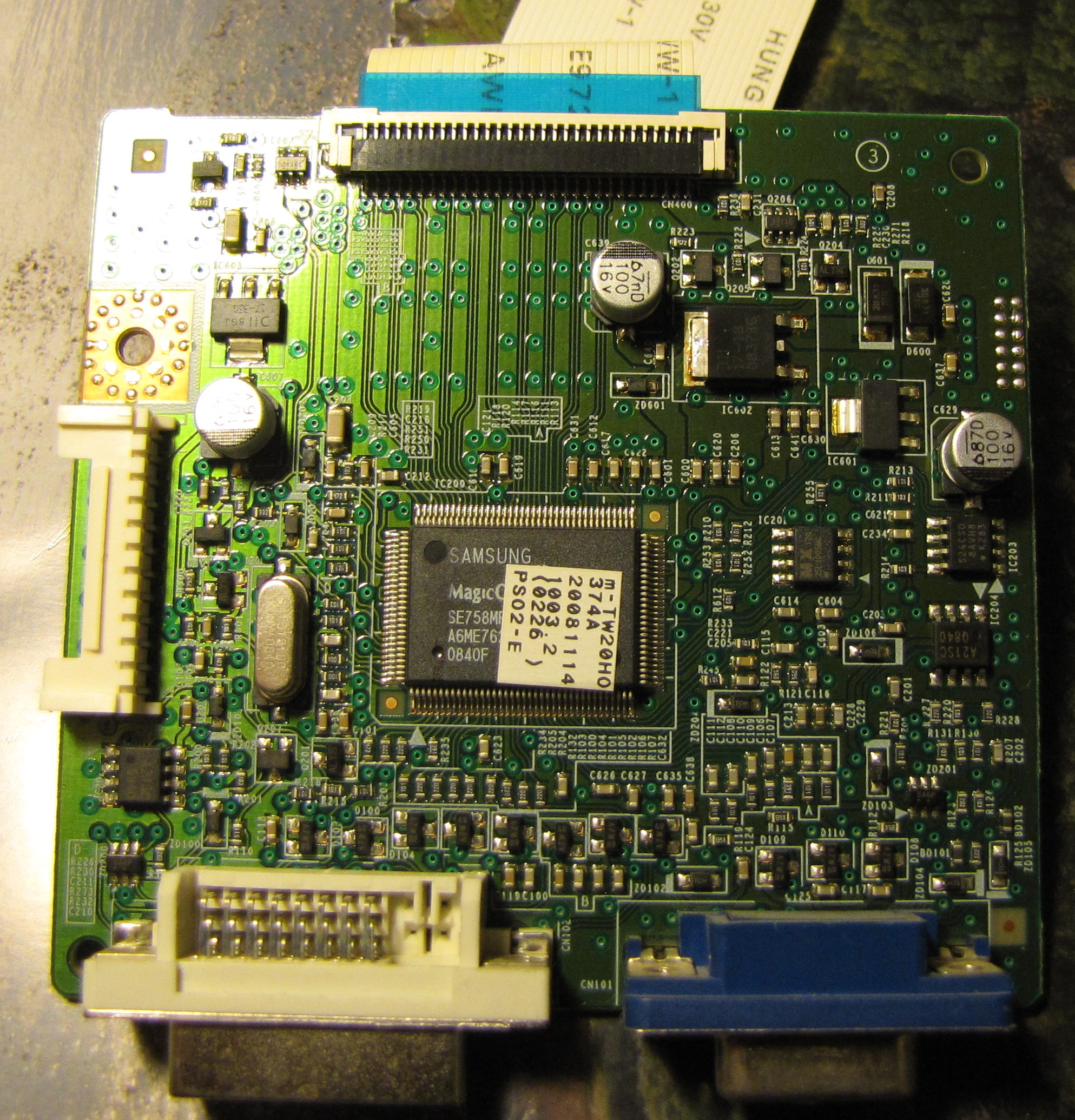

              Re: Samsung Syncmaster 220T - flickers.
              here are TCON pics,
              about the caps - most Rubycon (yes, from eBay -fake? ) and some unbranded.
              even if the caps are not top quality - can it cause failure even when they are new?
              just did a test - connected the panel to a known working PSU - worked good. so the culprit lies in some bad PSU component. how can i test the inverter transformer? and what does the high pitched noise from MSPS transformer indicate?
              many thanks for helping

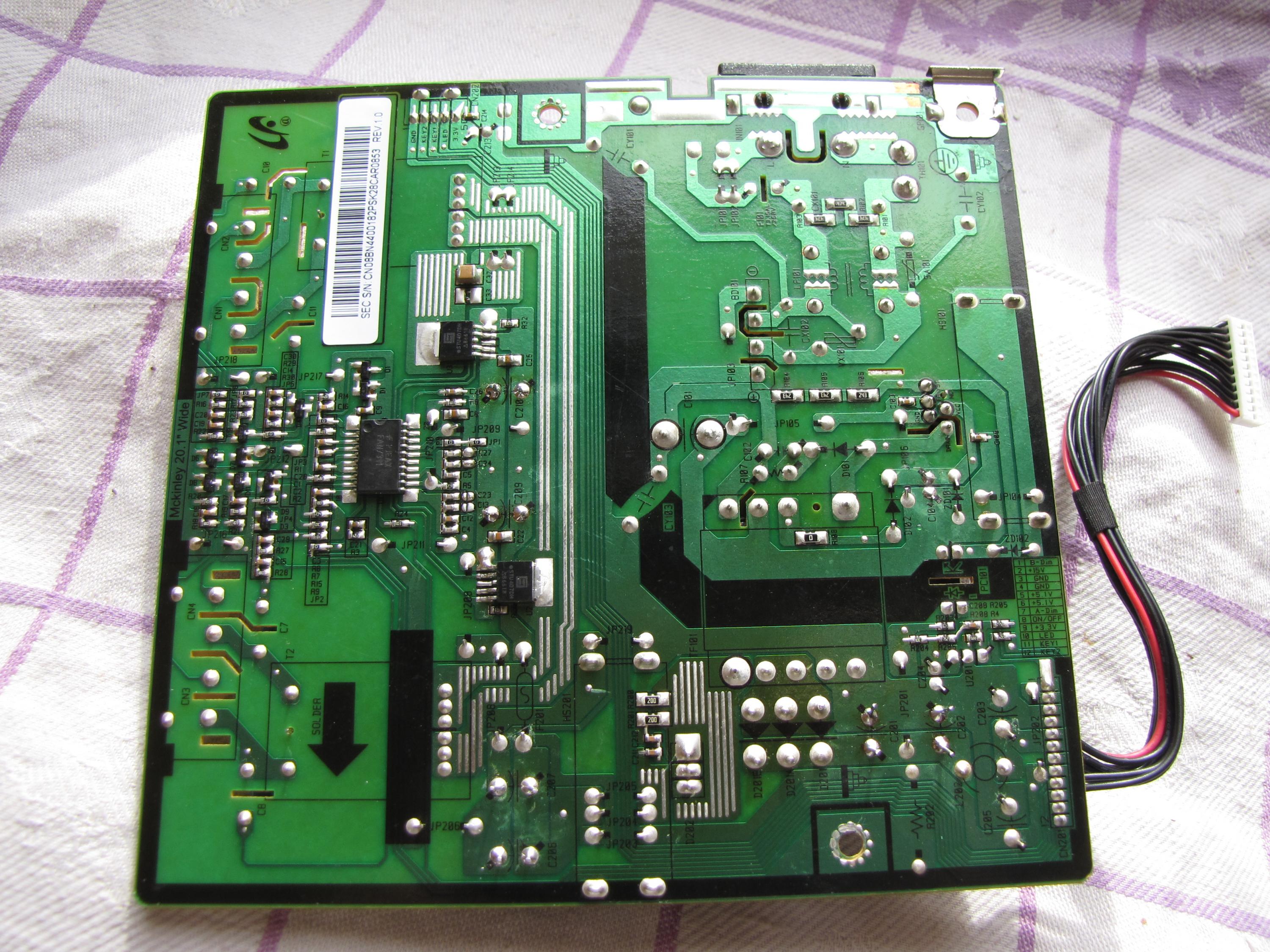

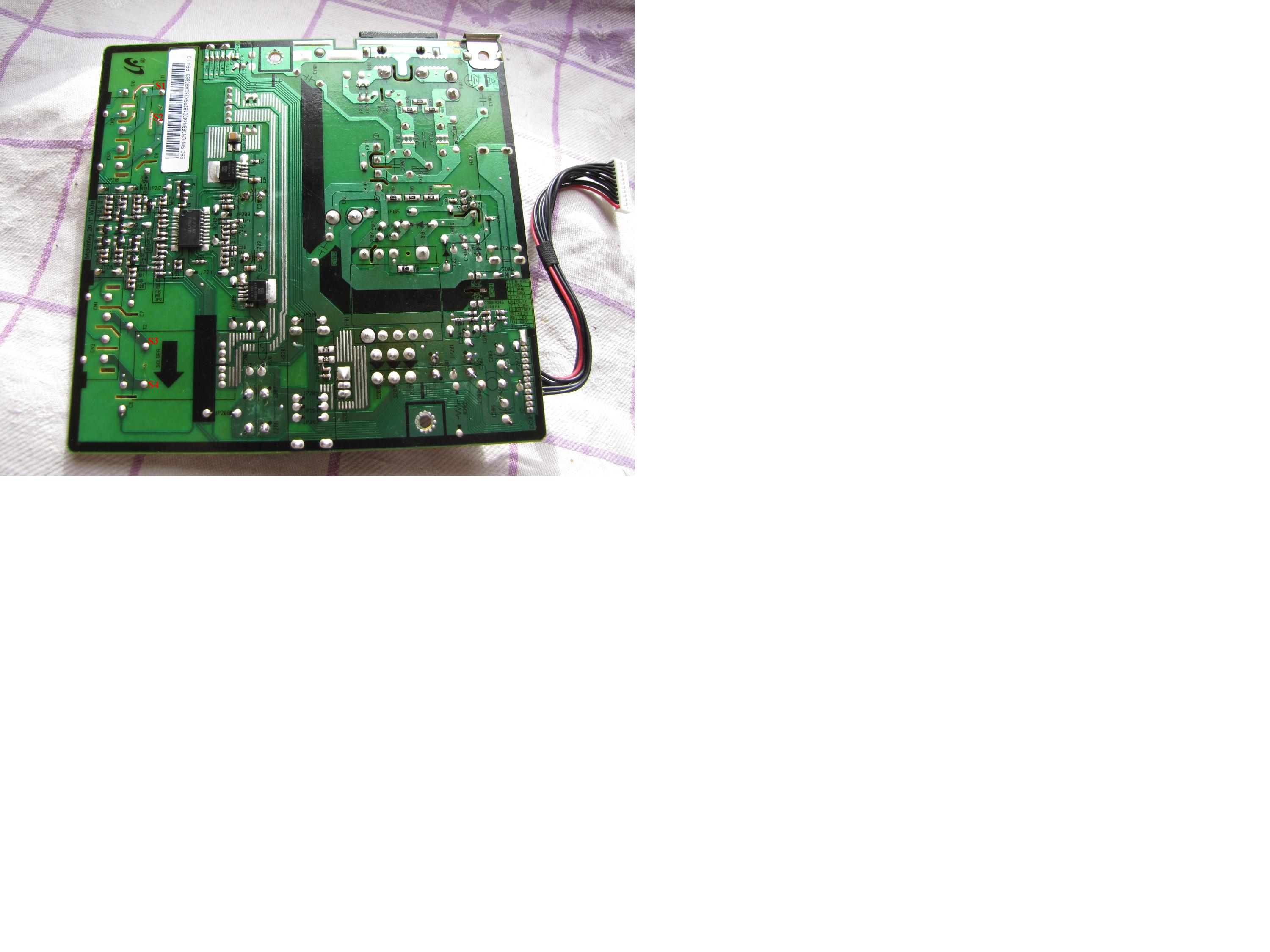

                    Ok Inverter transformer test.
                    Power OFF board doesnt need to be connected. Meter on Ohms 2000
                    Test S1>S2 and S3>S4 as marked on attached.

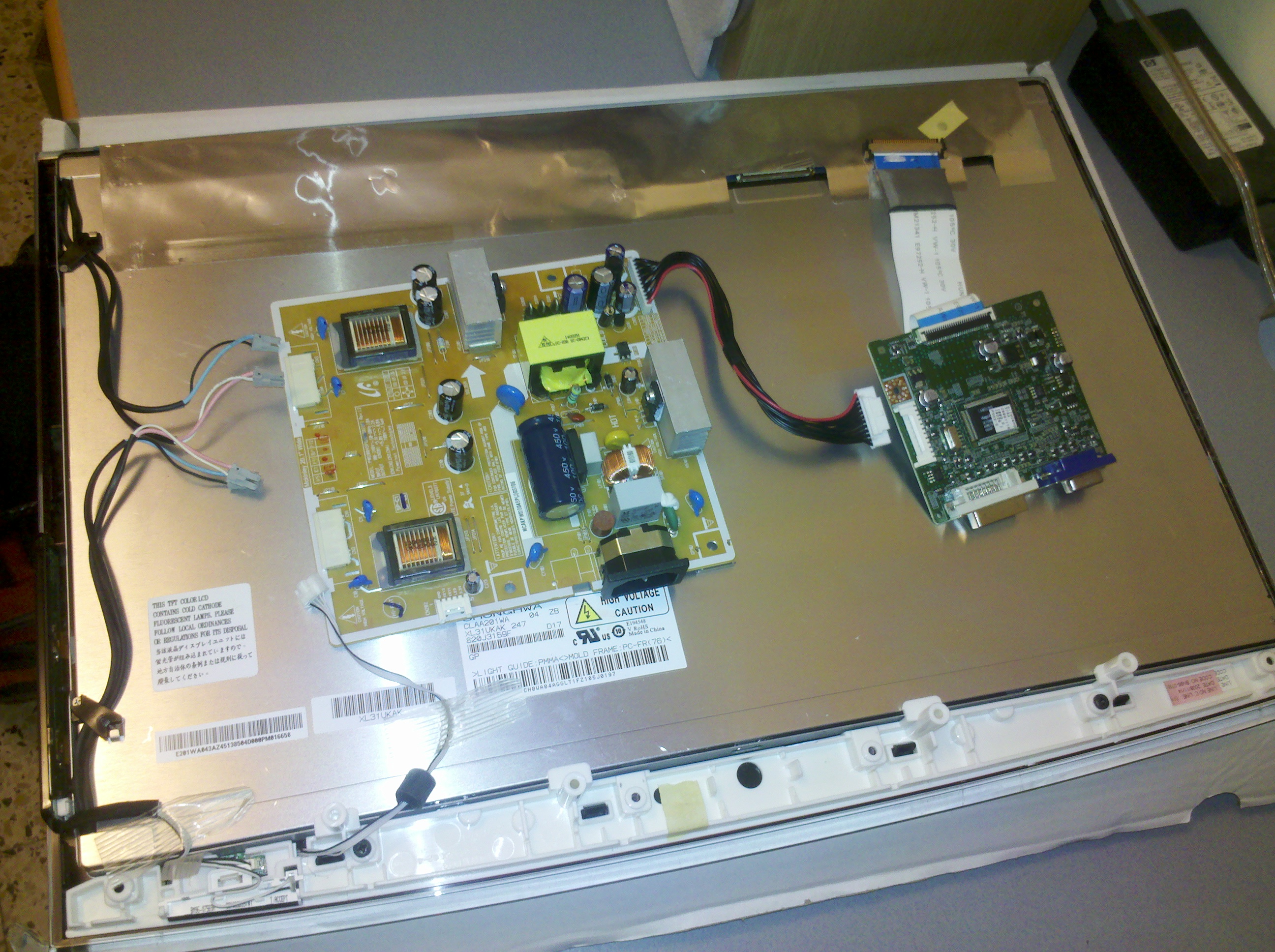

                          i see, just punctuation misunderstanding
                          i am posting a picture of the whole set.
                          if you mean the LVDS cable then it's attached directly without additional boards.
                            ok well next thing to test might be the stu407DH transistors on the bottom of the power board.
                            Datasheet is here
                            http://html.alldatasheet.com/html-pd.../STU407DH.html
                            and testing method (for shorts) is here. This is an excellent guide for 2 seconds to black written by retiredcaps start at post19 there is a section on mosfets and transistors.
                            https://www.badcaps.net/forum/showthread.php?t=10419.

                              some new info: the signal that is marked on the pic (on the TCON it's printed BL-EN and on the PS the same pin is labeled ON/OFF).
                              i noticed that when light goes out this signal drops from 2.7v to 0v.
                              so apparently the PS is getting a command to turn backlight off ?!
                              maybe the problem is in the TCON?
                              i am thinking maybe to cut the wire and give it a contant voltage and see if it helps. should i ? maybe better ideas?
                                  I just want to be sure about the direction of this signal.
                                  Can you tell for sure that this signal is originated by TCON and going into the PSU?

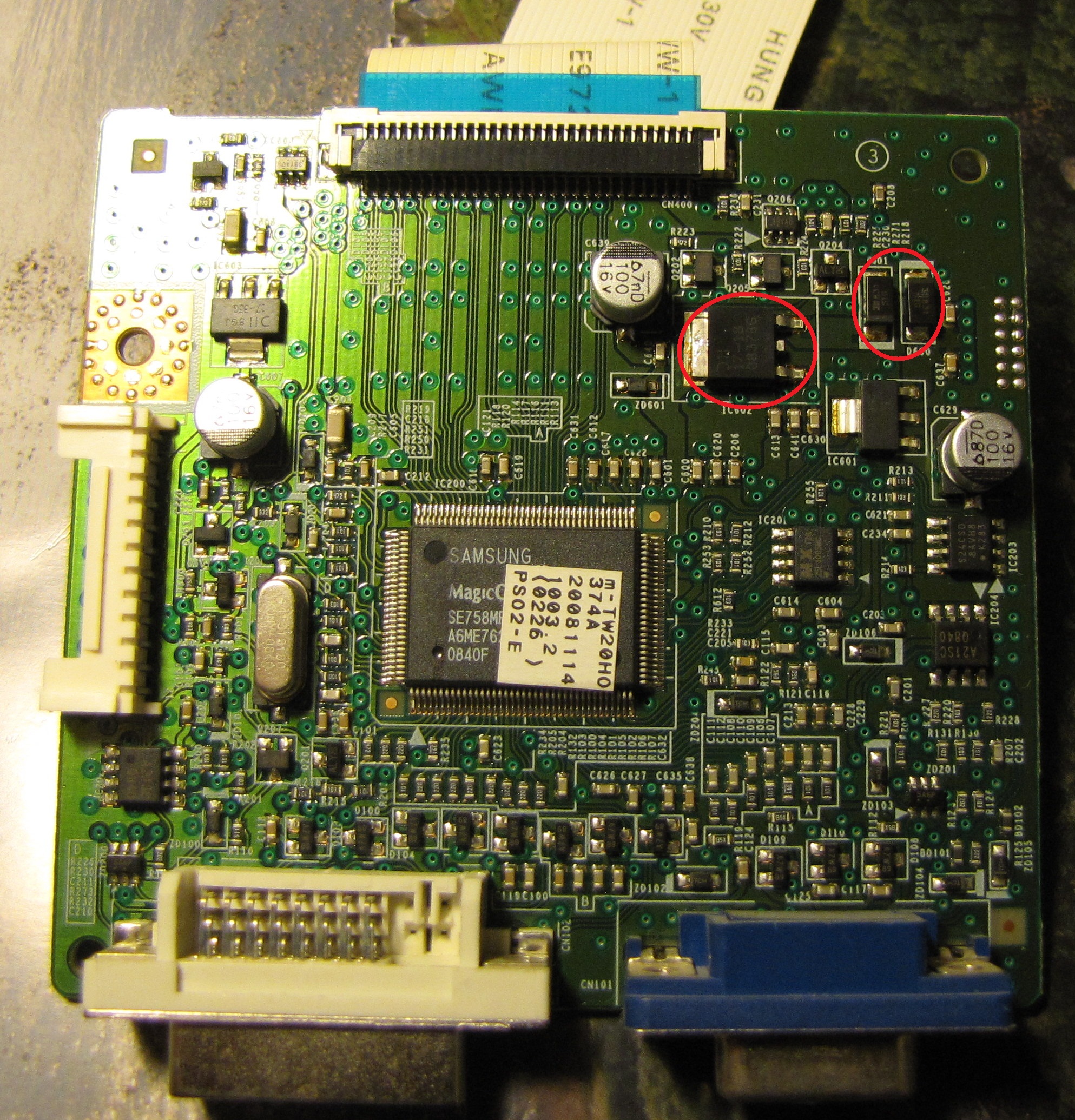

                                  some more findings:
                                  i have found the two diodes and the regulator (all circled) to become quite warm though the output of the regulator is ~1.8v and looks stable.
                                  • selldoor
                                    Slow Learner
                                    • Dec 2010
                                    • 7870
                                    No I am not sure either - can you trace back from pin 8 on the psu to see where it comes from/to
