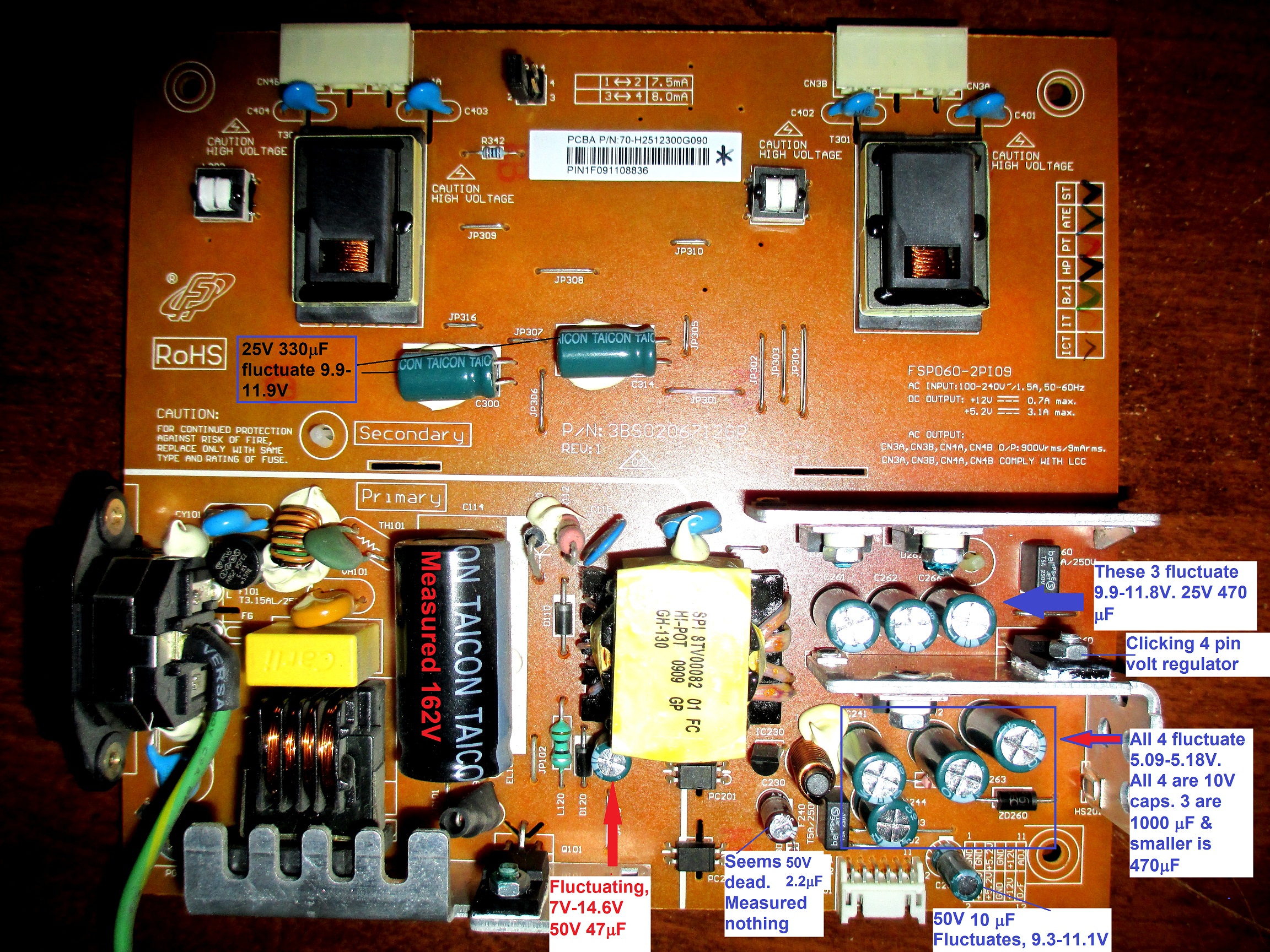

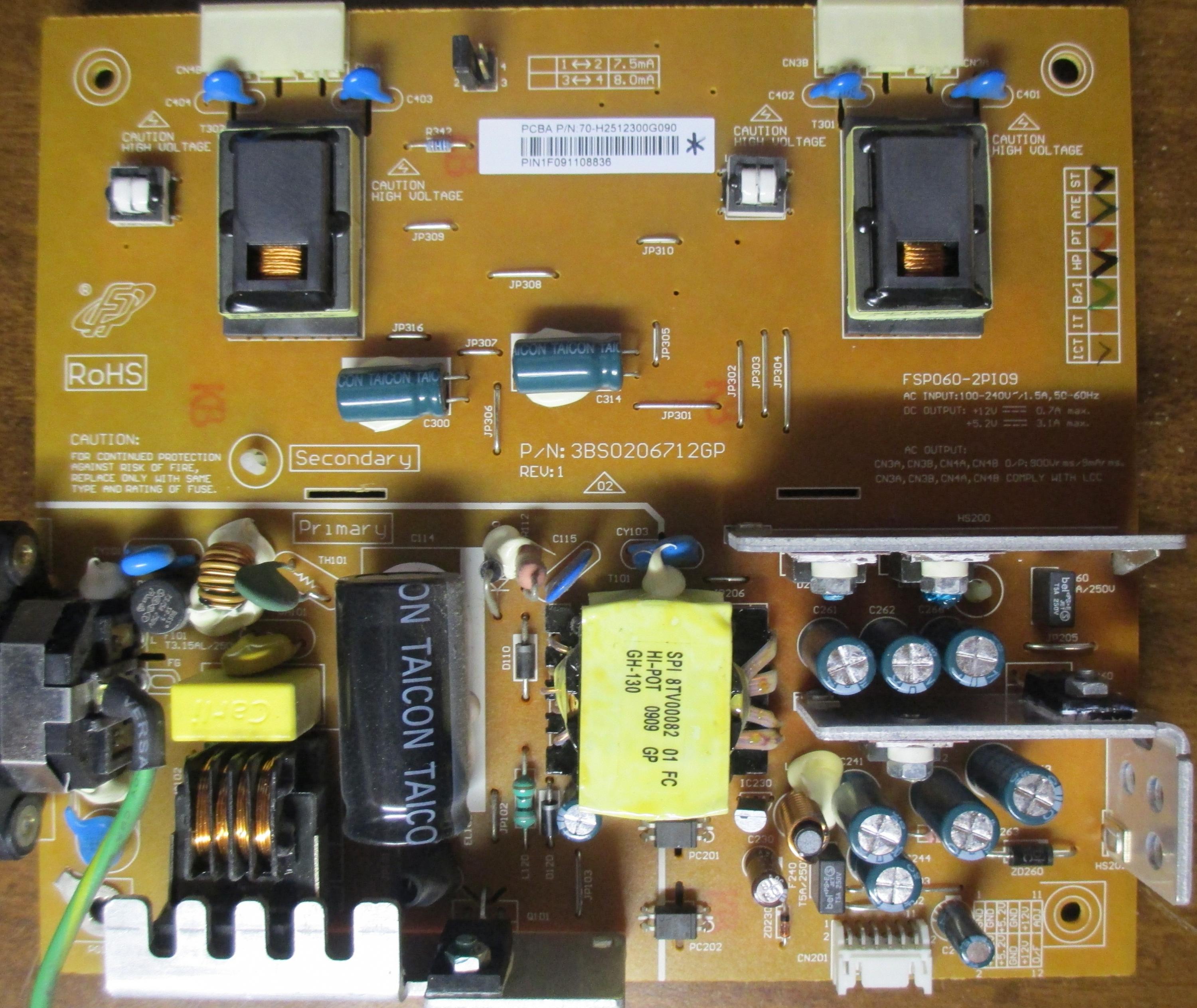

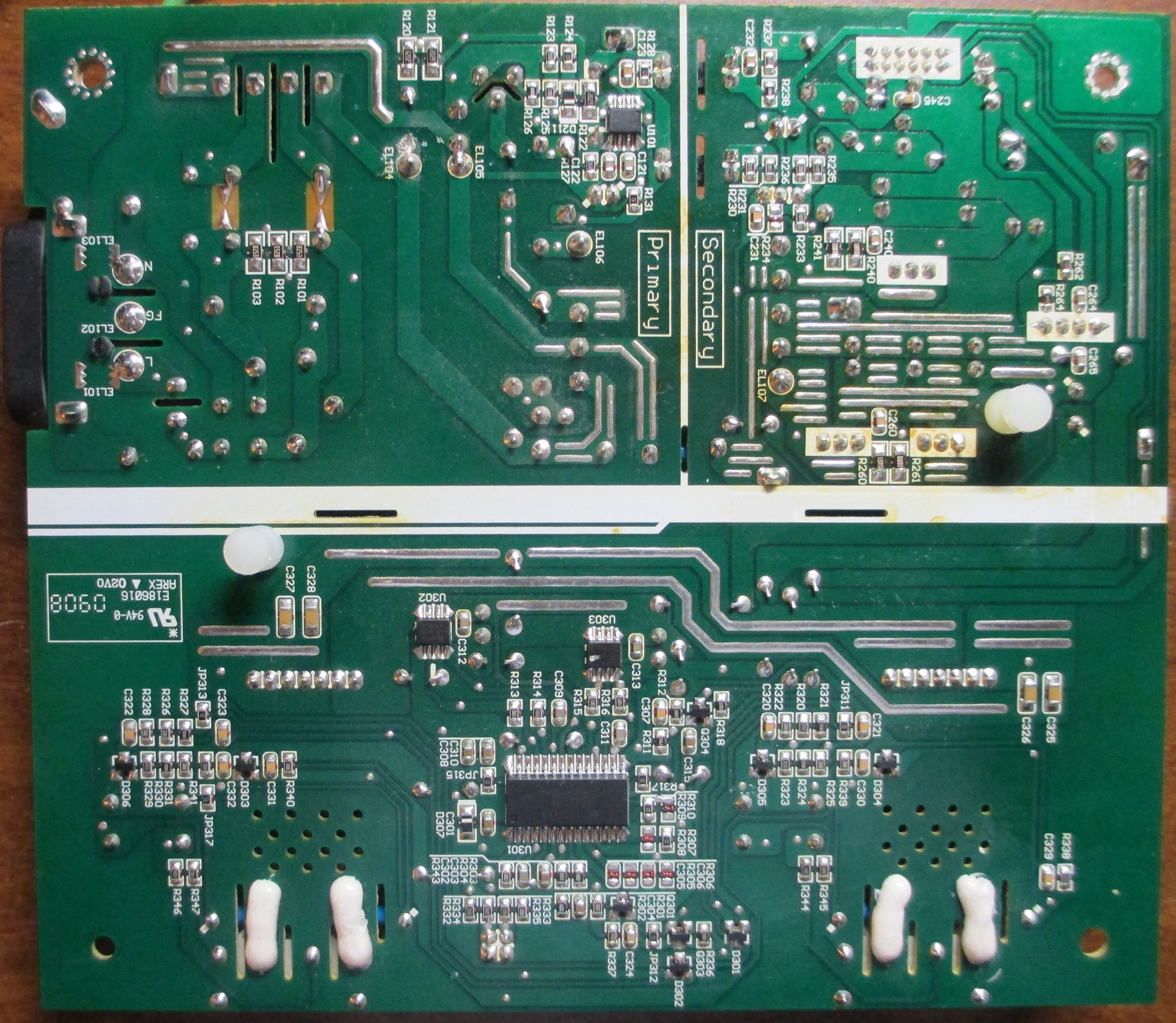

    Hello Everyone,
    I saw another thread with similar problem, but no solutions yet. I thought I would post my pictures with my findings. Badcaps community helped me fix one of my HP monitors, so I thought I would ask for help fixing Hanns-G.
    Monitor turns on, display stays on for 1-3 seconds and the monitor goes to sleep with amber light on where the power button is. Sometimes the monitor would work for a while after sitting unplugged for few hours.

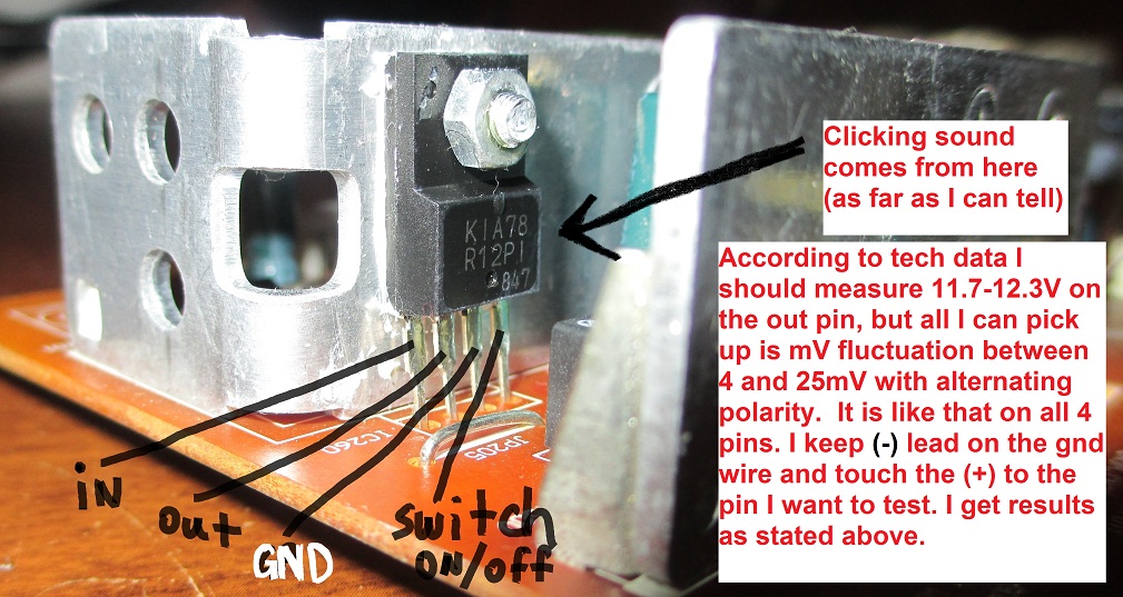

    I took the monitor apart and heard some clicking sound coming from one of the voltage regulators. I believe it is 4 pin voltage regulator. It is hard to tell with 100% accuracy.
    I have very limited knowledge in electronics, so if you see something that I did wrong please let me know. Your help is always appreciated.
    Please see the pictures for more info.
    Thanks,
    Leo

    Clicking implies
    https://www.badcaps.net/forum/showpo...8&postcount=21
