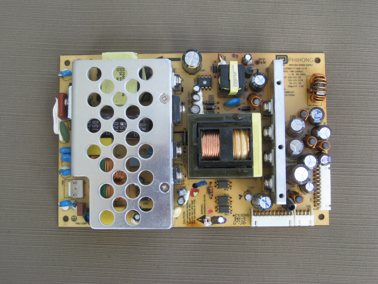

    Hanns-G HG281D issues
    After reviewing all the posts re. no power and the associated symptoms, I replaced the caps on the power supply board. Surprisingly, still no power. What would the next step be ?

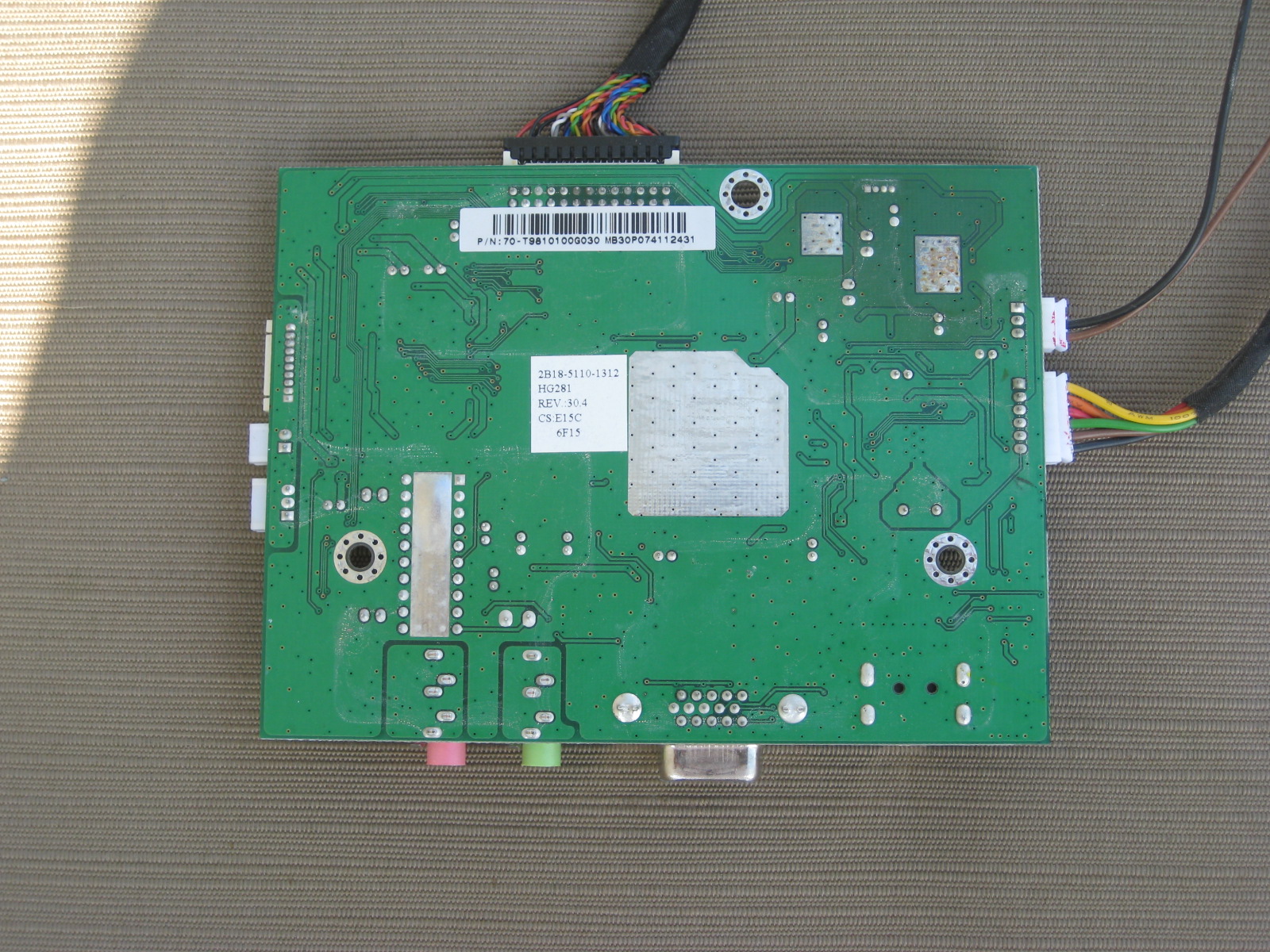

    Re: Hanns-G HG281D issues
    what main board in it! if vx2835 r3.1 has a known issue with c124 an c126, replace them!

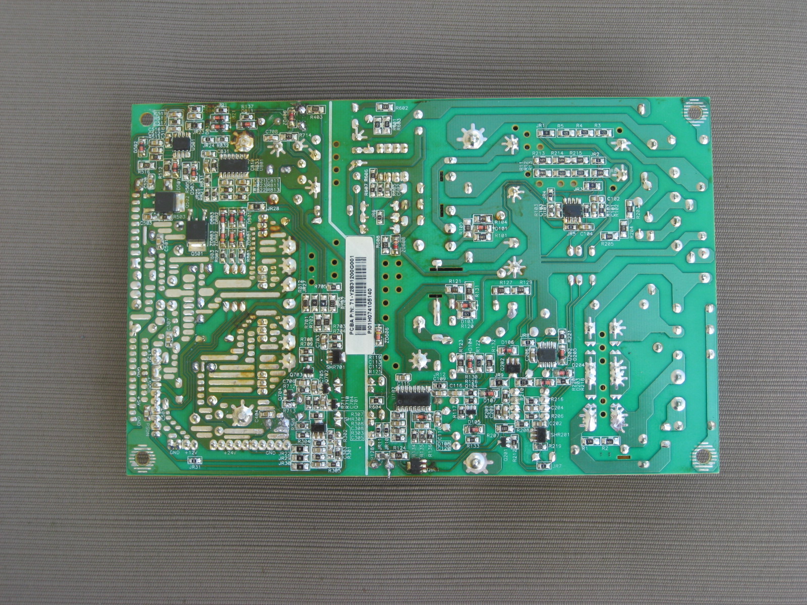

            Doing this the right way ...
            I re-capped the power supply board after the monitor was increasingly difficult to power on and finally wouldn't turn on at all. I measured the voltage at CN5 and the voltage fluctuates around 5v and is not stable. I don't see +12v on CN7. No blue or amber light.
              The 5V should be steady,suggest you plug the Power supply into the mains supplyAND have NO other Boards plugged in, and then measure for the 5v output from the board
                    From the company (not eBay) website the caps that I replaced were :
                    qty 1 1000uf 35v capacitor
                    qty 2 1000uf 25v capacitors
                    qty 1 1000uf 10v capacitor
                    qty 1 470uf 35v capacitor
                    qty 1 470uf 25v capacitor
                    qty 1 470uf 10v capacitor
                    qty 1 22uf 35v capacitor
                    qty 1 10uf 50v capacitor
                    qty 1 2.2uf 50v capacitor
                    Of course, I see that the complete kit has 14 (not 10) caps and at one point I did have to choose which of (2) caps to replace. They all look to be Nichicon.
                    Something else, I didn't realize how delicate the etchings were for one cap (c114) until it was too late so I munged one of them. And I assume that's a pretty important one also. Probably now need a new PSM board unless I can fix that ...
                      follow trace to find were ya can solder a wire onto post pics makes it easier!
                              Check for bad solder joints on the caps you replaced. Since you damaged the solder joint on C114, try soldering a wire from the damaged lead of C114 to the next solder pad that was connected to the damaged pad of C114.
