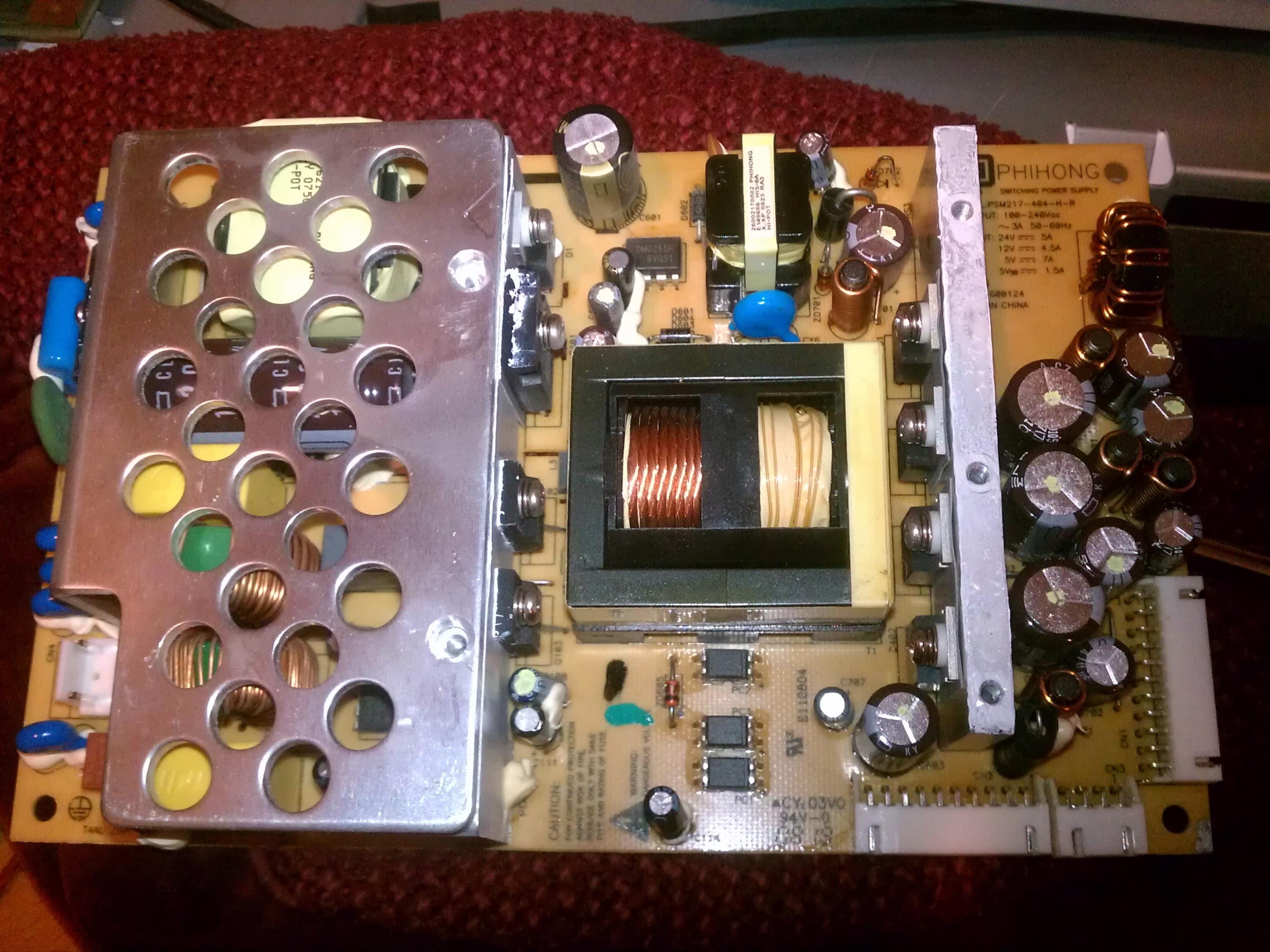

    After reviewing all the posts re. no power and the associated symptoms, I replaced the caps on the power supply board. Surprisingly, still no power. What would the next step be ?

      I'm new to these boards. My Hanns-G HG281D just up and died yesterday. No power and no blue light indicating power. I bought it over 3 years ago and it now out of warrant.
      My model is HG281D PBUFK11.
      After going over the posts here I suspect the caps are bad. My question to someone here is I also see some white stuff that kind of looks like dried glue on or near the caps and am trying to determine if it has come from the caps or not. It is all over my board in spots near almost all electrolytics and ceramic caps. Honestly, I've never seen stuff like this and am wondering if this is normal glue to hold the parts or leakage from the caps. Any suggestions are appreciated. All the electrolytics seem normal, with no bulging.
        It is normal glue. Nothing to worry about. In the main megathread, I have extensively helped people with this monitor, read through it on how to measure the voltage.
        It contains almost every problem seen with this monitor.

            I re-capped the power supply board after the monitor was increasingly difficult to power on and finally wouldn't turn on at all. I measured the voltage at CN5 and the voltage fluctuates around 5v and is not stable. I don't see +12v on CN7. No blue or amber light.

              The 5V should be steady,suggest you plug the Power supply into the mains supplyAND have NO other Boards plugged in, and then measure for the 5v output from the board
                All the caps or just some. What brand and series did you use for replacements?
                The very first poster in the megathread, Mishannya, had the same problem with fluctuating 5V standby.

                  UPDATE - I ended up just replacing all the caps in the switching power supply and it seems to work. Although, it initially acted weird, the screen going black after being on for 10 seconds. then shut down. I then re-seated all the connections and tried again and it has started up the last couple of times I've tried it. I'm worried that maybe the main logic board might be flakey when it heats up so I'm doing a burn in test right now to see if it dies again.

                    From the company (not eBay) website the caps that I replaced were :
                    qty 1 1000uf 35v capacitor
                    qty 2 1000uf 25v capacitors
                    qty 1 1000uf 10v capacitor
                    qty 1 470uf 35v capacitor
                    qty 1 470uf 25v capacitor
                    qty 1 470uf 10v capacitor
                    qty 1 22uf 35v capacitor
                    qty 1 10uf 50v capacitor
                    qty 1 2.2uf 50v capacitor
                    Of course, I see that the complete kit has 14 (not 10) caps and at one point I did have to choose which of (2) caps to replace. They all look to be Nichicon.
                    Something else, I didn't realize how delicate the etchings were for one cap (c114) until it was too late so I munged one of them. And I assume that's a pretty important one also. Probably now need a new PSM board unless I can fix that ...

                      follow trace to find were ya can solder a wire onto post pics makes it easier!

                        Well, I spoke too soon!
                        The monitor worked for about 4 days and just up and died again tonight! Now every once in a while the power indicator will blink bright blue once or twice and then go dark. This is now after having replaced all the caps on the power supply. When I attempt to power it on, nothing happens.
                        Any suggestions?

                            So last night I got fed up and left the monitor in what appeared to be in the off position. Black screen and no power light. Then I come downstairs today and find the monitor on and the power light glowing blue and my monitor displaying a web page. So, at this point I'm perplexed. I've turned on and off the monitor several times and it appears to be working fine now except the VGA input does not work any longer, only the HDMI input. Any ideas what may be happening now?
                              Re: Hanns-G HG281D issues
                              Check for bad solder joints on the caps you replaced. Since you damaged the solder joint on C114, try soldering a wire from the damaged lead of C114 to the next solder pad that was connected to the damaged pad of C114.
