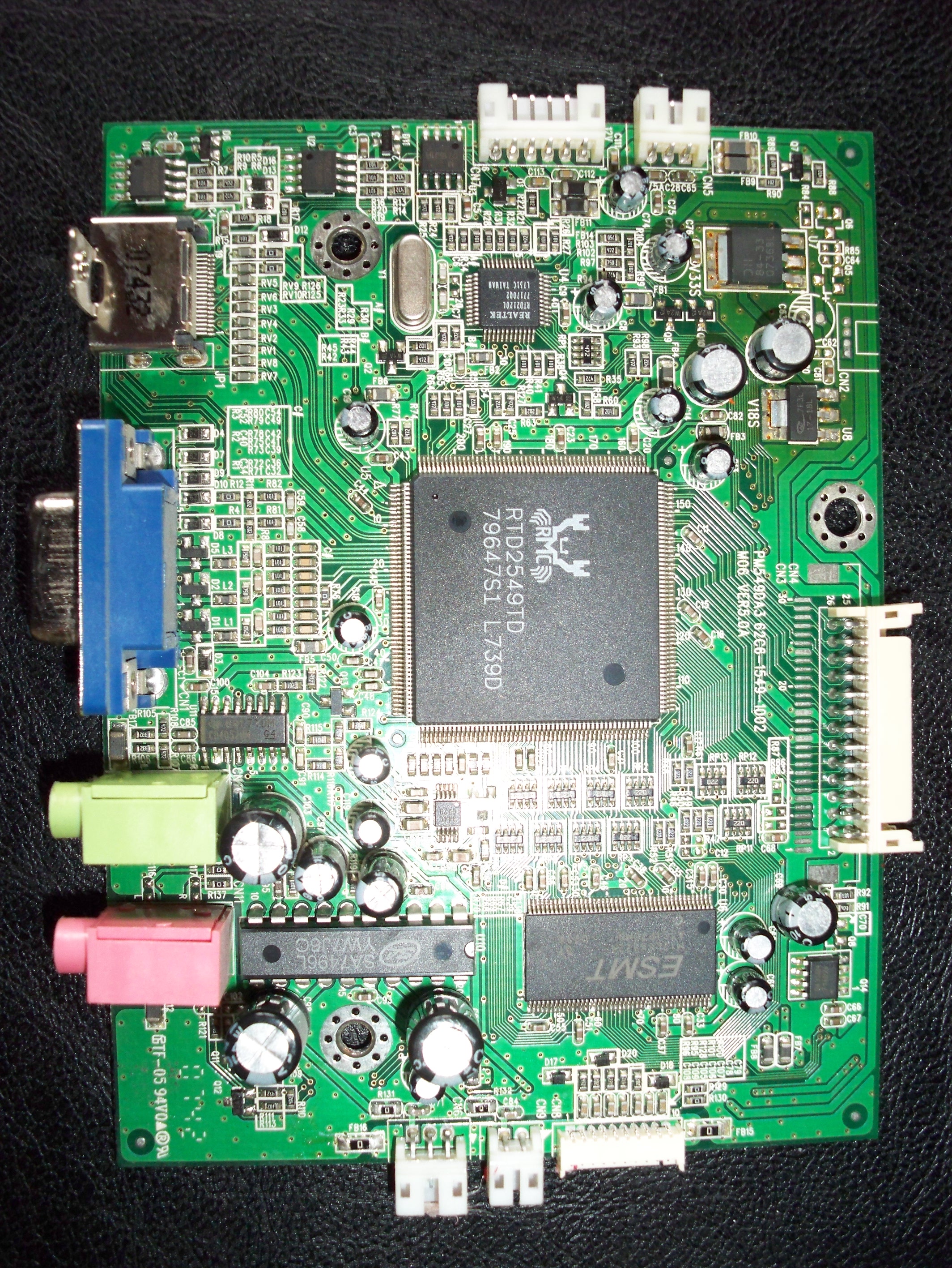

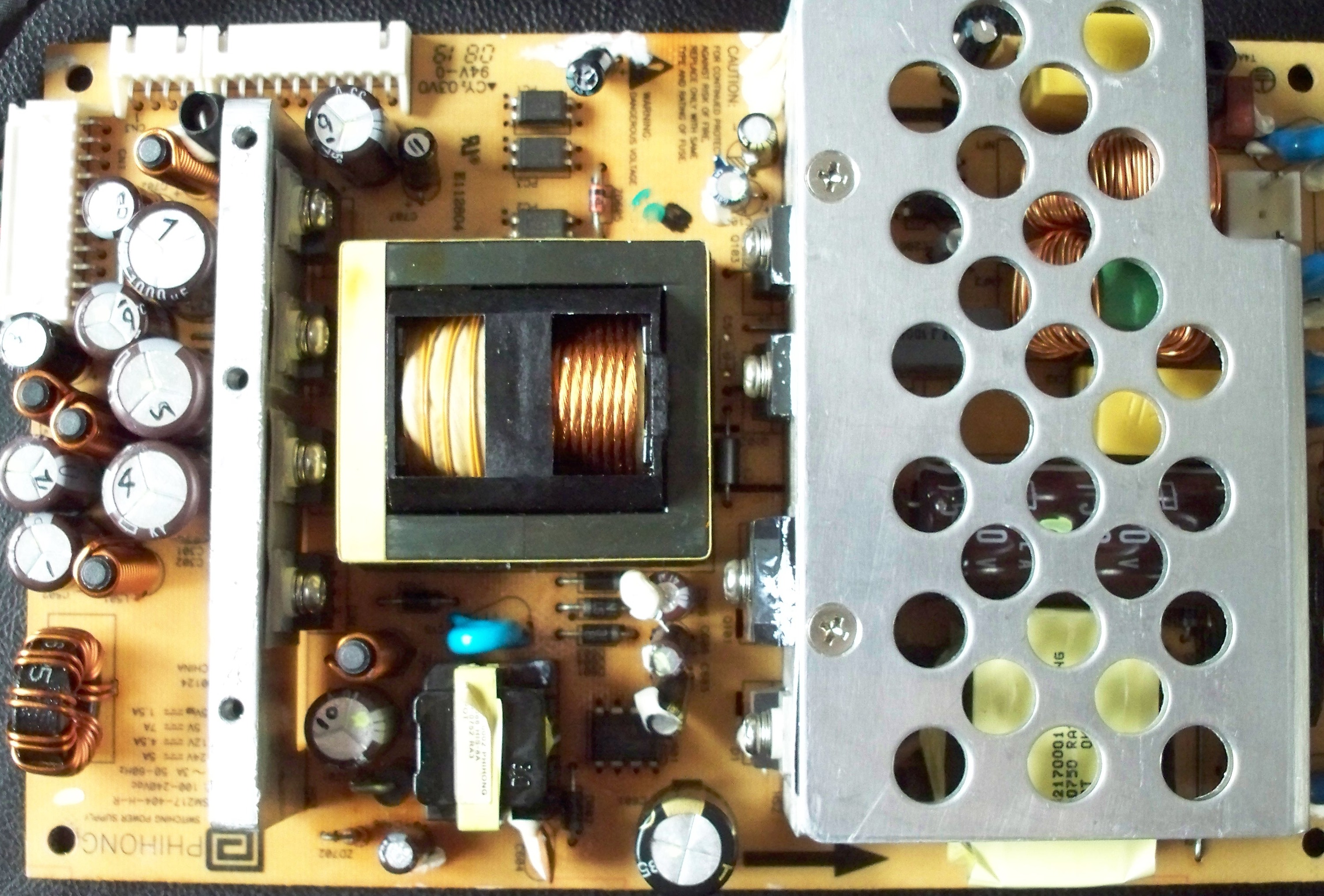

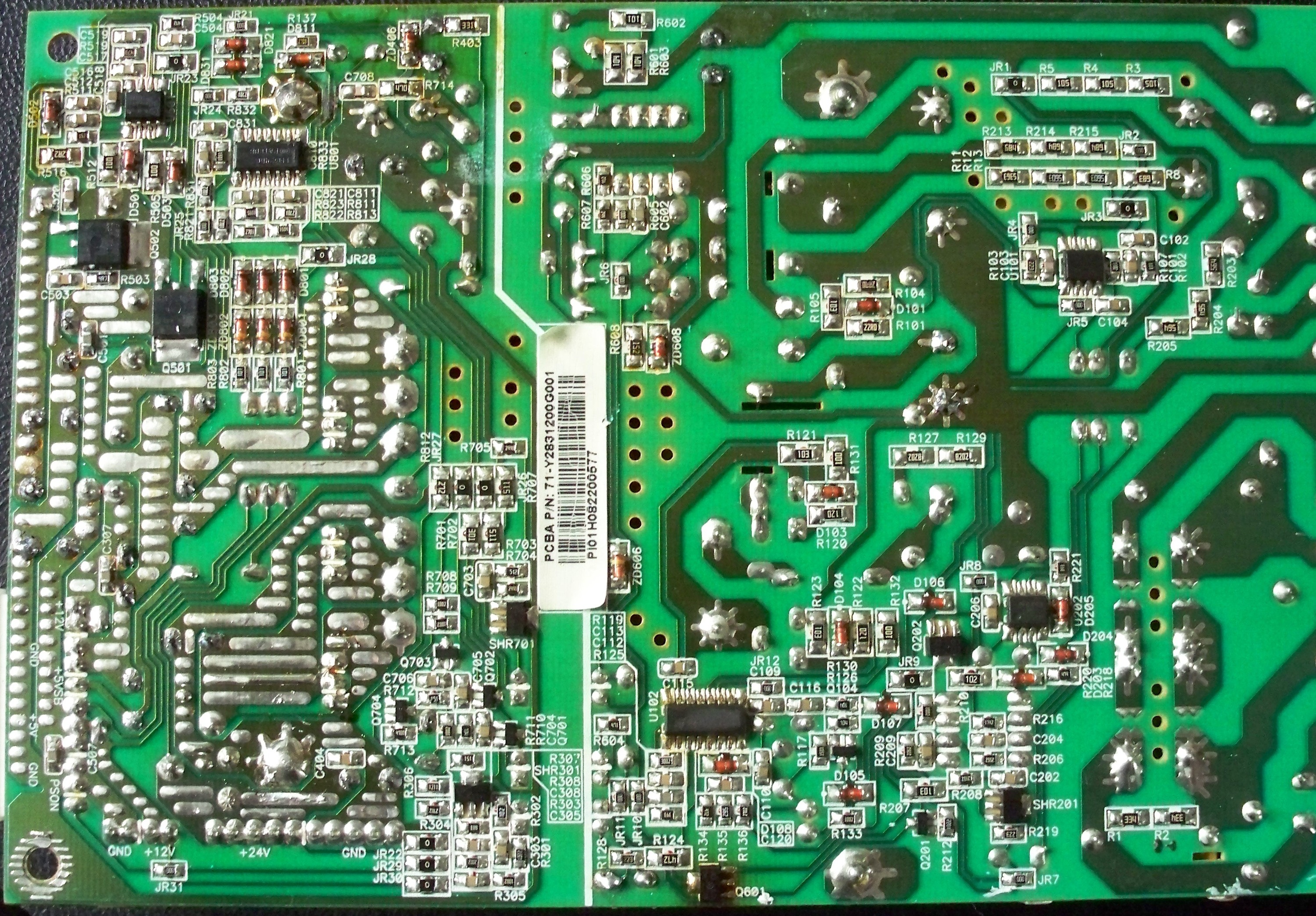

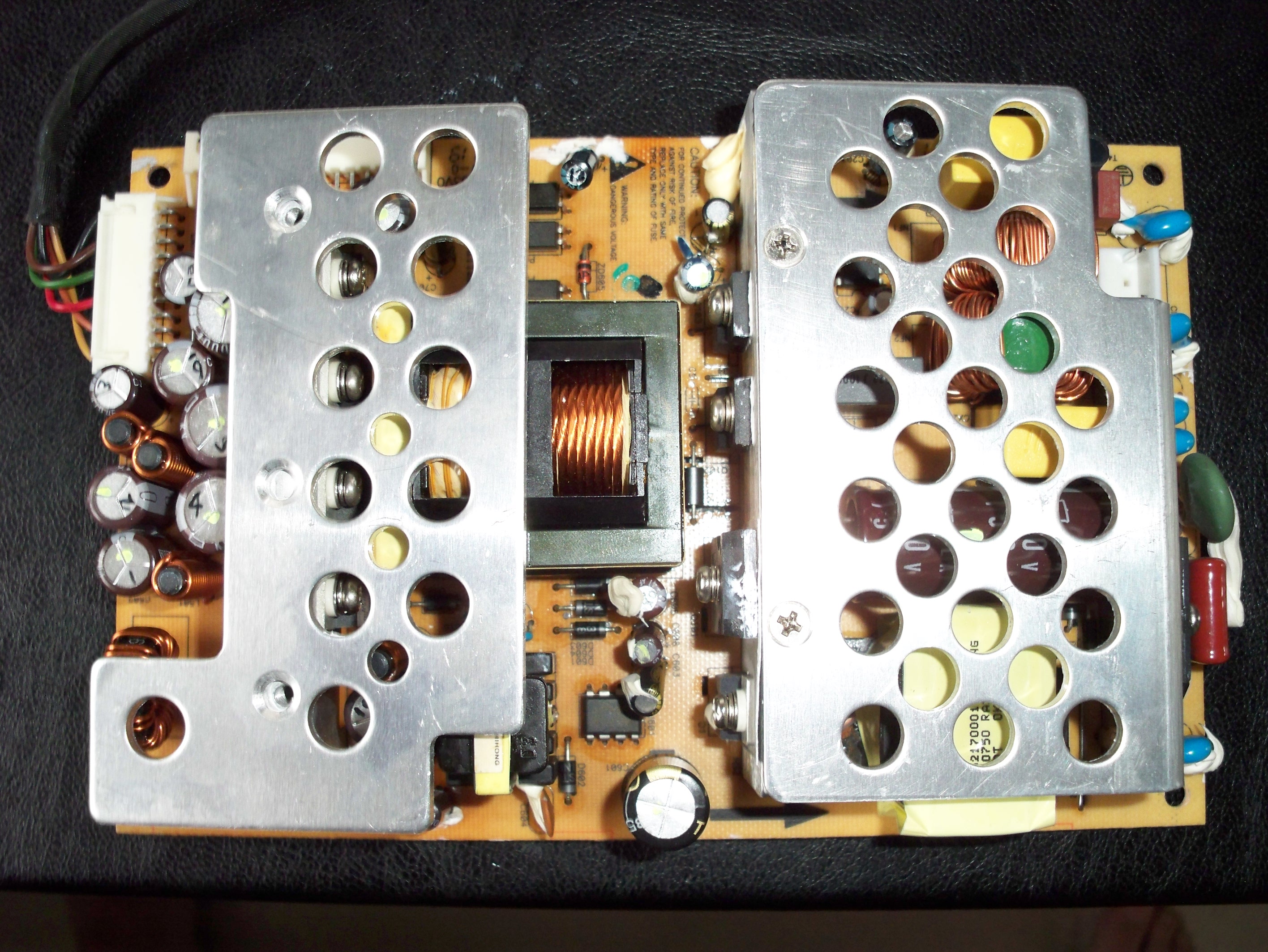

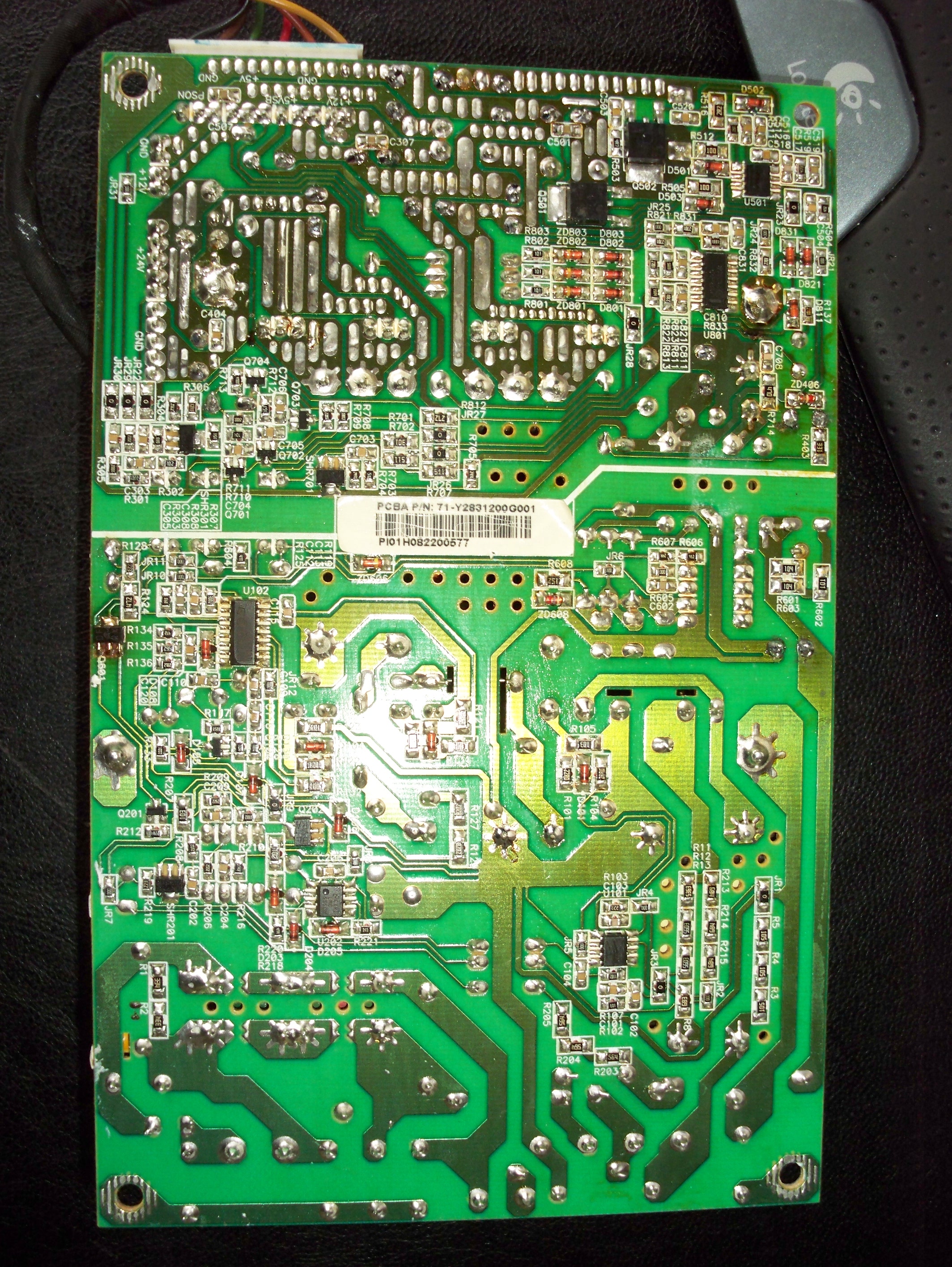

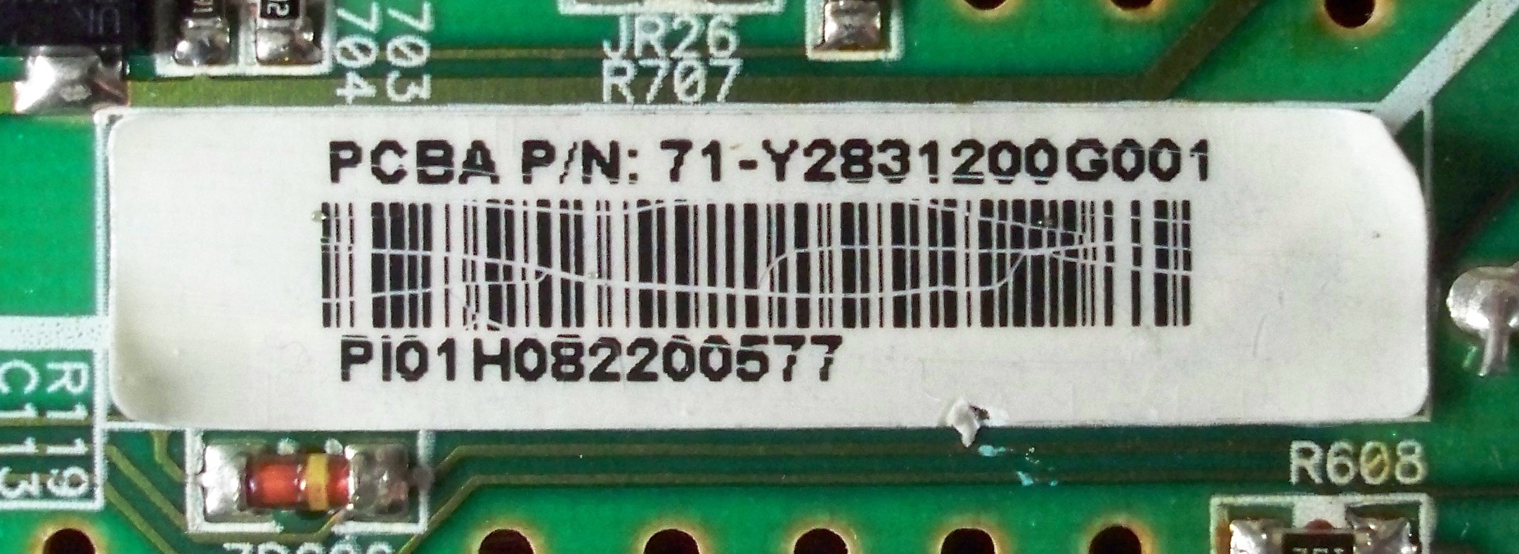

Hi guys, Feeling a complete idiot at the moment, fixed the distorted video and switching off after 10 secs, with replacement caps on the video signal board
After 1 hour of trouble free testing, unplugged mains and started to rebuild.
after i disconnected the lead from PSU to Inverter board it grounded out ( i think) and i heard a loud discharge noise.
Since then Blue led flashing only.

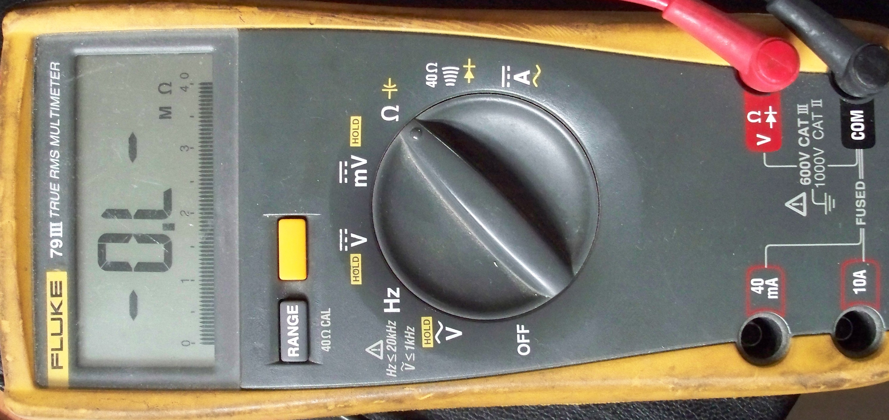

Checked all the main capacitors recommended for replacement elsewhere, all measured in limits with Fluke multimeter, uf seem all OK.
have 5v but no 12v or 24v, inverter board not lighting up. Flashing blue LED only.
Are there any people out there with some checks to do?.... HELP
read a little about startup capacitors, but have i popped something more serious?
No obvious signs of damaged componants etc
I have a background in electrical/electronics but feel stupid after fixing this unit then damaging it ...aaarrrrghh
